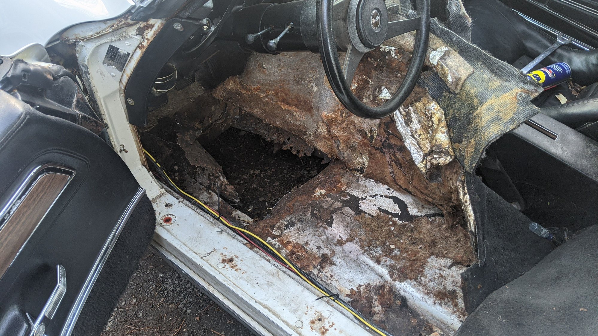

the underside of the car has serious rust on the floor boards
i will had to take care of that, its rusted through to the carpet on the drivers side really bad and just starting on the passenger side.
its not too hard to peel back carpet and weld in some sheet metal

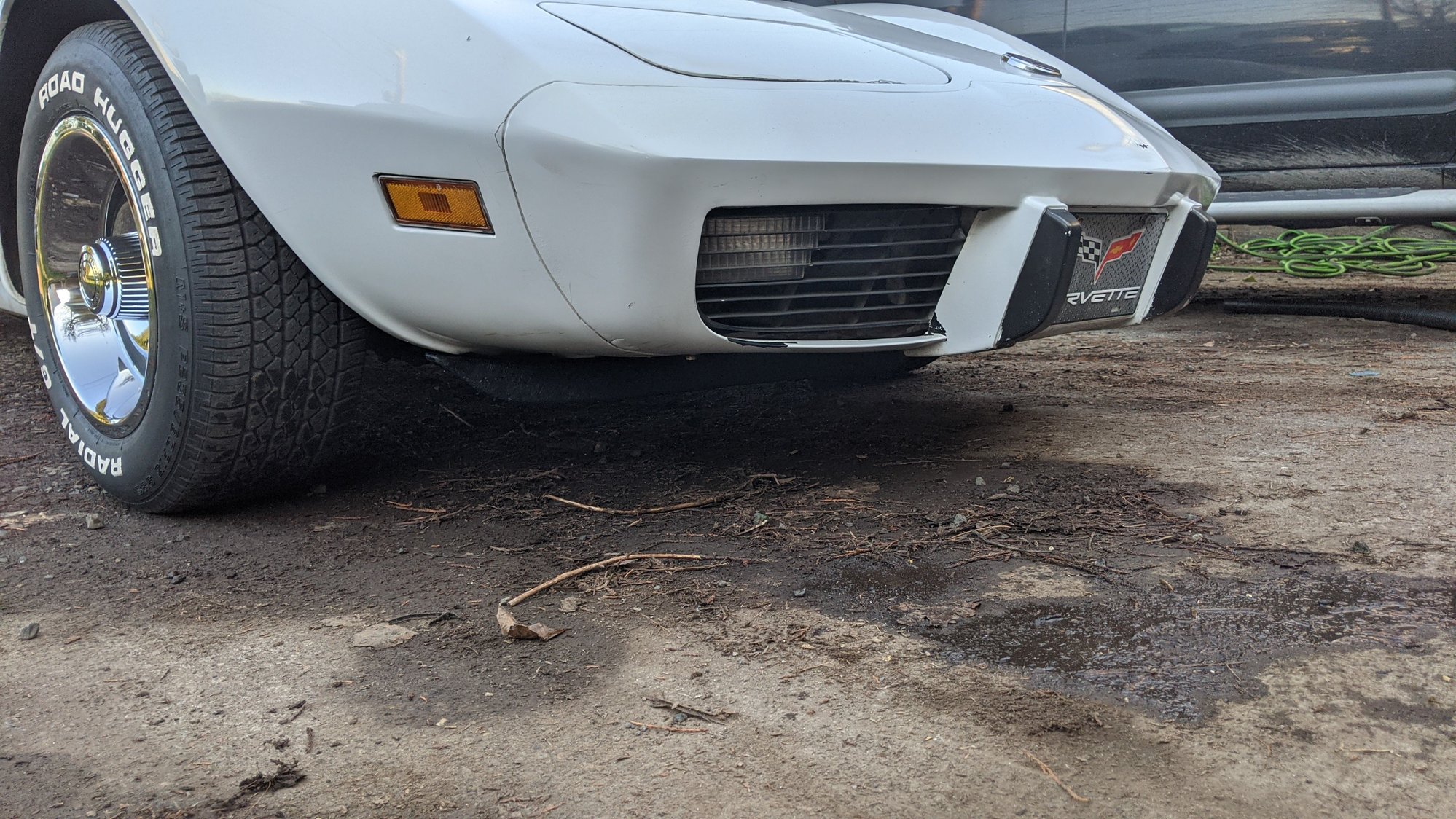

i ordered vision wheels off ebay with -6 offset and 4.25" backspacing. the same specs as the ecklers ones they advert FOR c3 corvettes. they were really discounted, $240 shipped for 4
then i ordered a trim ring and center cap package from ecklers for $260 with the GM licensed derby caps

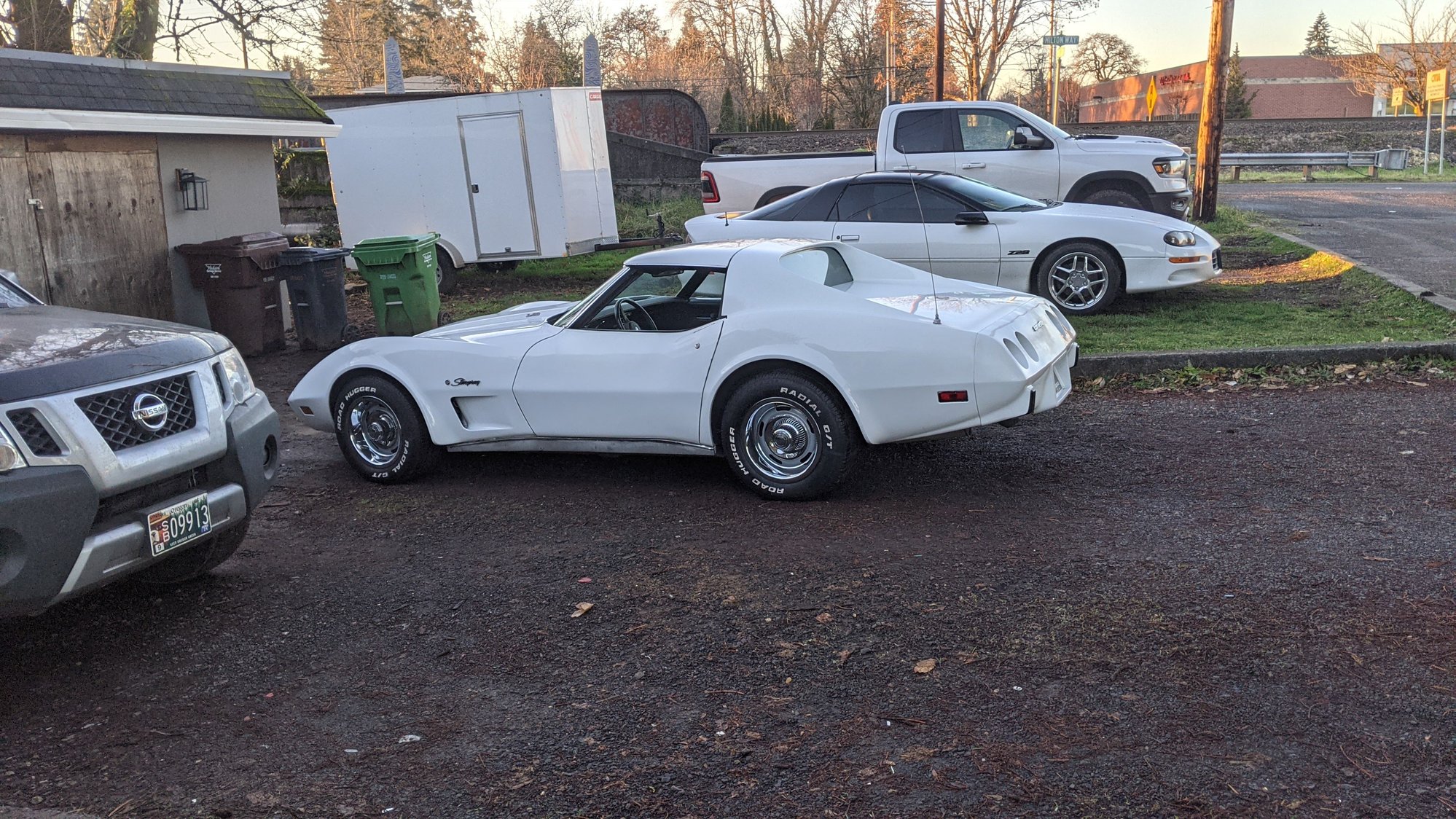

New wheels look fking sweet

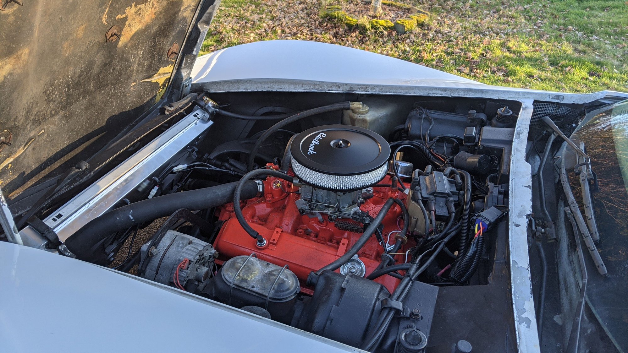

Air cleaner and 210 on 195 fan switch... Works great
