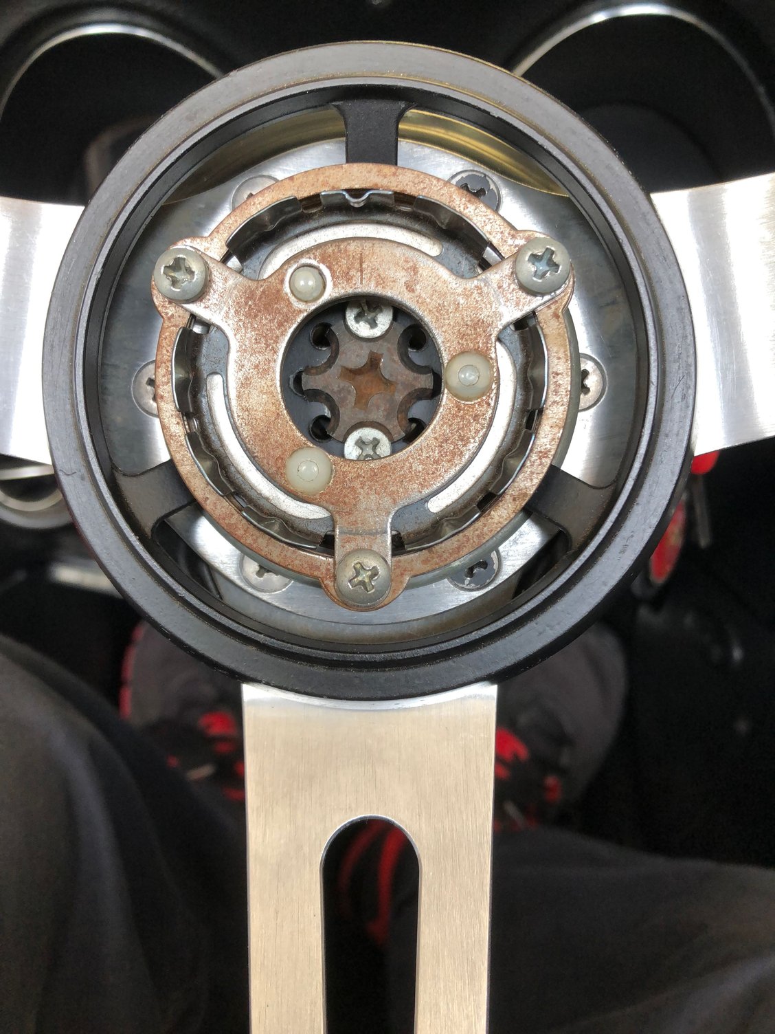

Your horn button will need to be correctly orientated to the receiving HUB. My steering wheel was attached to the metal hub so that is was off by 15 degrees. The Corvette Flags/Steering Wheel were tilted with the tires pointed straight ahead. I asked Ernie Willcox and he explained that my steering wheel was attached to the hub at an angle. I will try to get you some pictures showing the correct orientation of the steering wheel and horn receiver part. I hope this makes sense, if your horn receiver is not like the one in my picture, your horn button will not “LEVEL” when the steering wheel is turned so the tires are straight.
This correct so that the horn button will go on straight
If the three screws are not orientated like above the Horn Button will not go on correctly

Thats exactly what i needed to know and explains why mine wasnt going on very easily. Thanks for the help!
