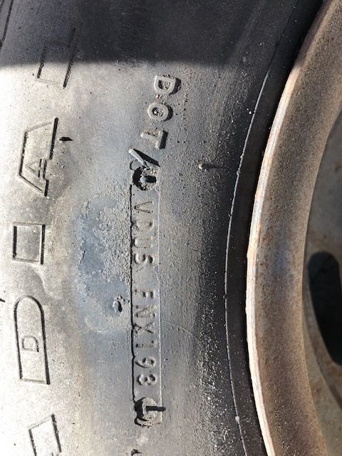

This is the original spare that’s in my May built 73s tire carrier.
To White Line Radials
