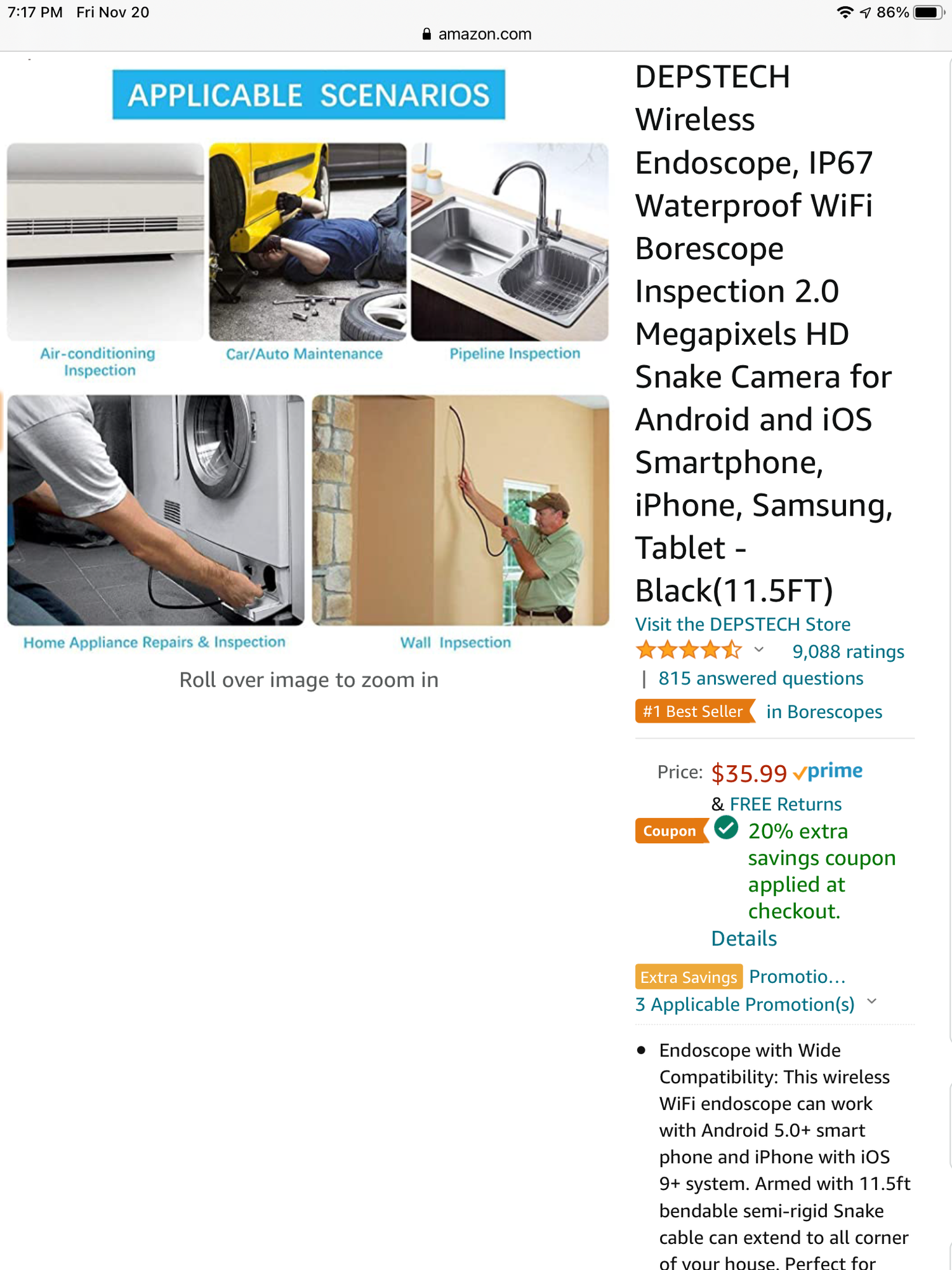

Try a camera or grabber maybe you can grab it if it floats....especially if its the 26 dollar gm additive..
https://www.amazon.com/Endoscope-Wireless-Borescope-Inspection-Flexible/dp/B07Z8SQ6T5
Less than 30 bucks with coupon..hell im going to get one decent reviews
