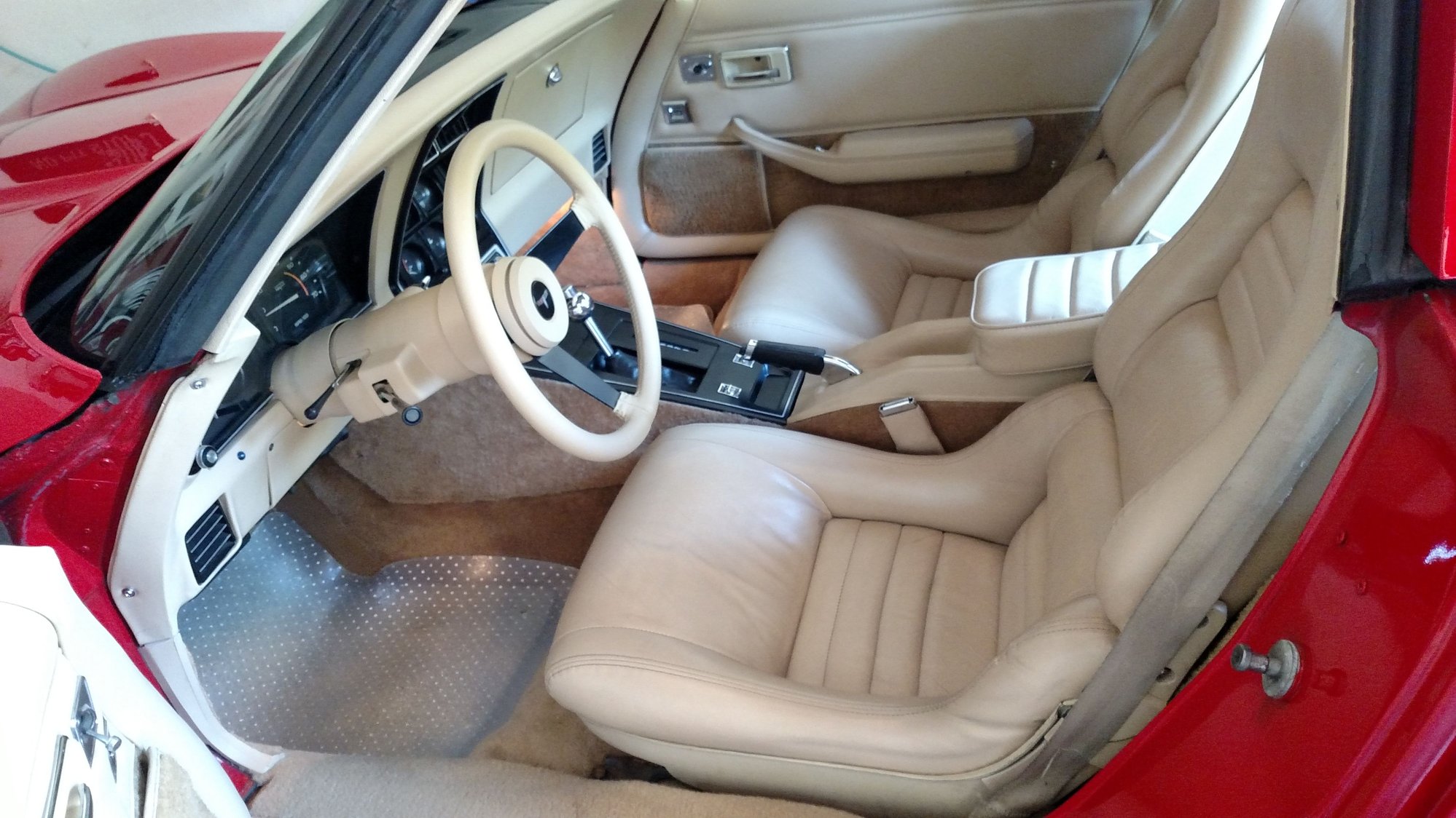

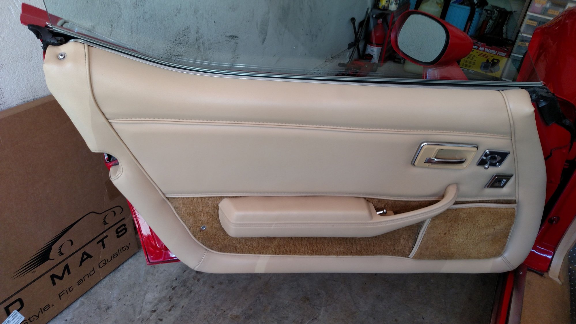

Stick with the stock doeskin color. I did and I'm very happy with the results

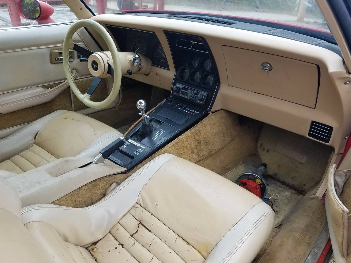

Thanks for all the great feed back!
juat found a pic from when I got the car so you can see what I am working with.... as noted the interior is decent minus the carpet and seats which I plan to replace...
Stock doe skin right??
The mice stole my distributor..

If you are purchasing new seat covers, I recommend that you take one of the new covers (whatever color you choose) to a pro auto body paint store and have them mix up a pint of vinyl dye to match. Then shoot ALL the other interior parts so that they all match...including the leather on the steering wheel, horn button and column. With all of the interior out (for really good cleaning!!!), you can mask off what you need to recolor the dash pad and other items too difficult to remove. Just mask WELL and don't spray on 'wet'. 2 or 3 light coats will be good and the 'wet' dye will not flow under your masking stuff. Wipe down the leather on the wheel with lacquer thinner to get all oil off and out of the outer surface. The dye will stick and last for many years without cracking, etc. (if you don't buy cheap aftermarket spray bomb dye in cans).
