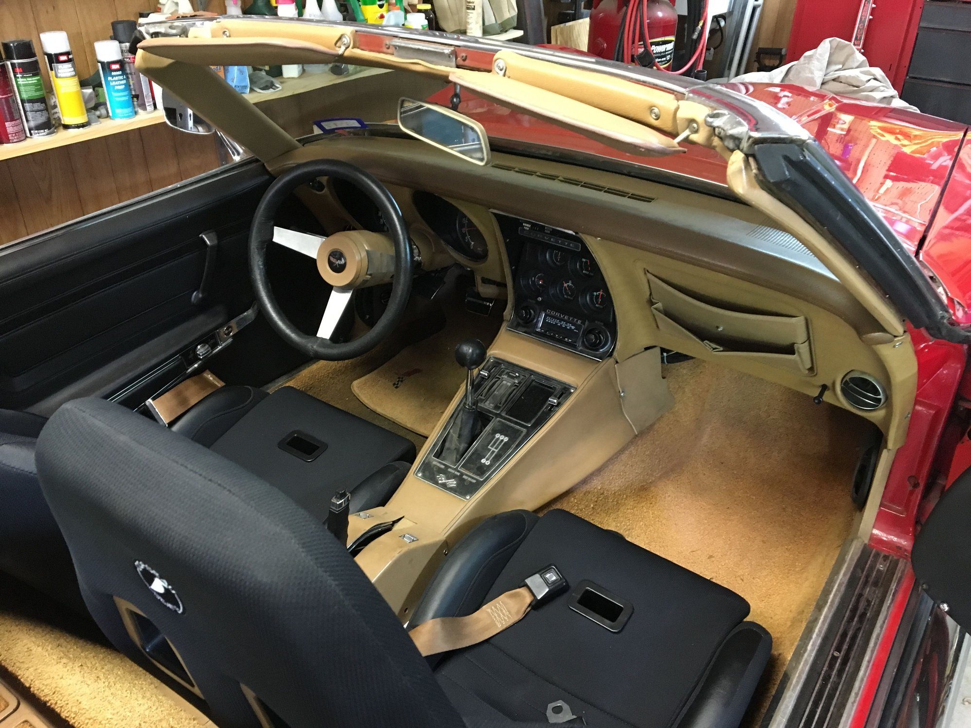

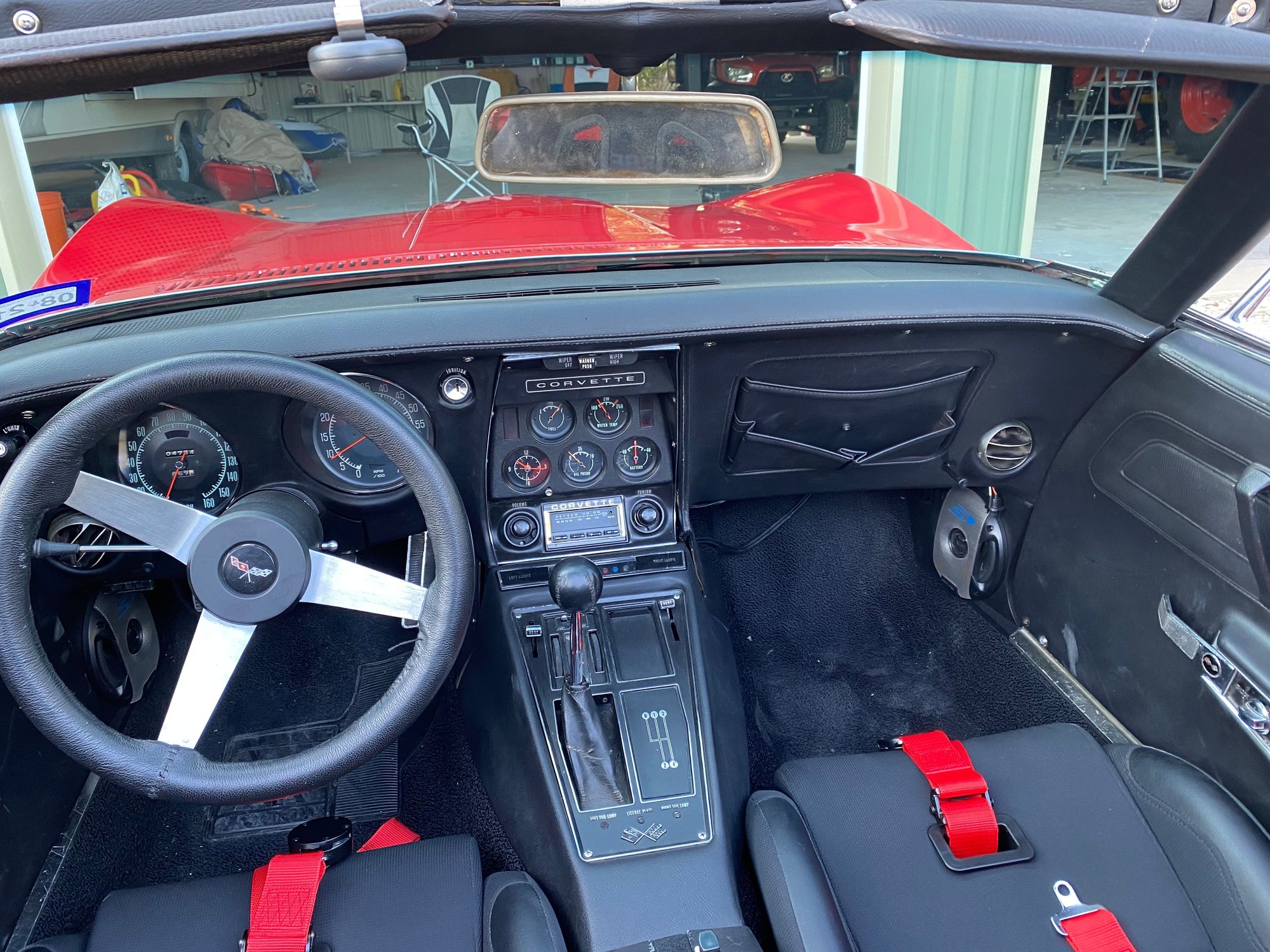

My 70 was supposed to be donnybrook green with a saddle interior but someone repainted it red in the early 80s. I personally like the color combo. I am in the process of using SEM paints to restore it and have had great results. Eventually ill have it put back to green though.
Old Dec 16, 2020 | 12:09 AM
slopoke17's Avatar
slopoke17
Joined: Dec 2009
Posts: 1,351
Likes: 305
From: Feeding Hills, MA
Back in the 70's my first Corvette was a red '77 with buckskin interior. 40 years later I finally found a nice red '77 but with a black interior. I went from black to buckskin and don't regret it for a minute. I've been looking for quite awhile for a nice red and buckskin combo, never realized how rare they were. I dyed most of the hard trim and purchased all new leather seat covers, seat belts, door panels, steering wheel and carpet. You will find spots where its scratched and the original color comes through so you will need to do touch up once in awhile.
original interior
new interior
