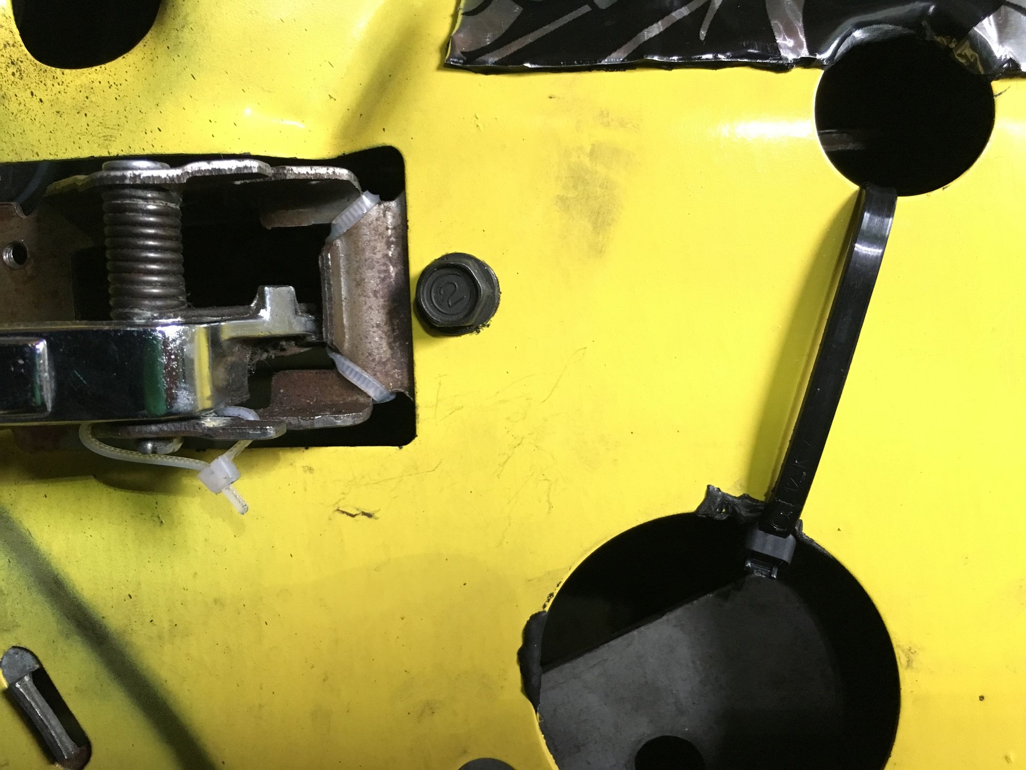

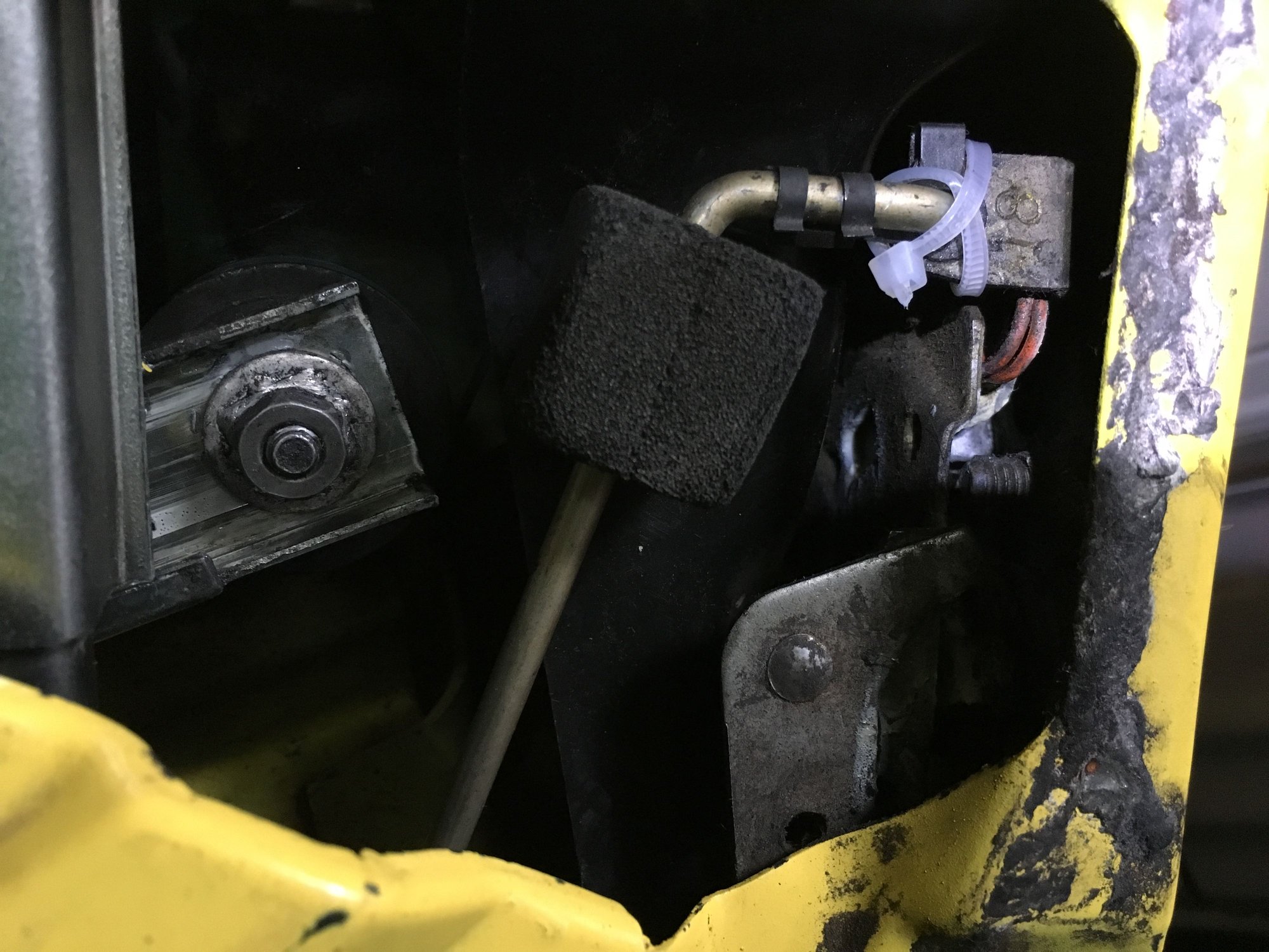

Two nearly identical 78’s; in one the windows go up and down surprisingly ast; the has a slow window on the right, a slower window on the left. Completely rebuilt everything in the doors with a new motors. The slower one already had a replacement motor, as evidenced by no rivets. Replaced all the nylon wheels and cleaned regularly-lubed the channels. Neither window moved any faster than it did before, but I am reassured everything works good enough.
Rattles from in the doors have always annoyed me, so I used a couple extra foam anti-rattle pads along with zip-ties to quiet them.
A piece of Dynamat on the inside of the door skin augments the insulation inside the panel nicely. Nice thunk sound closing the doors.

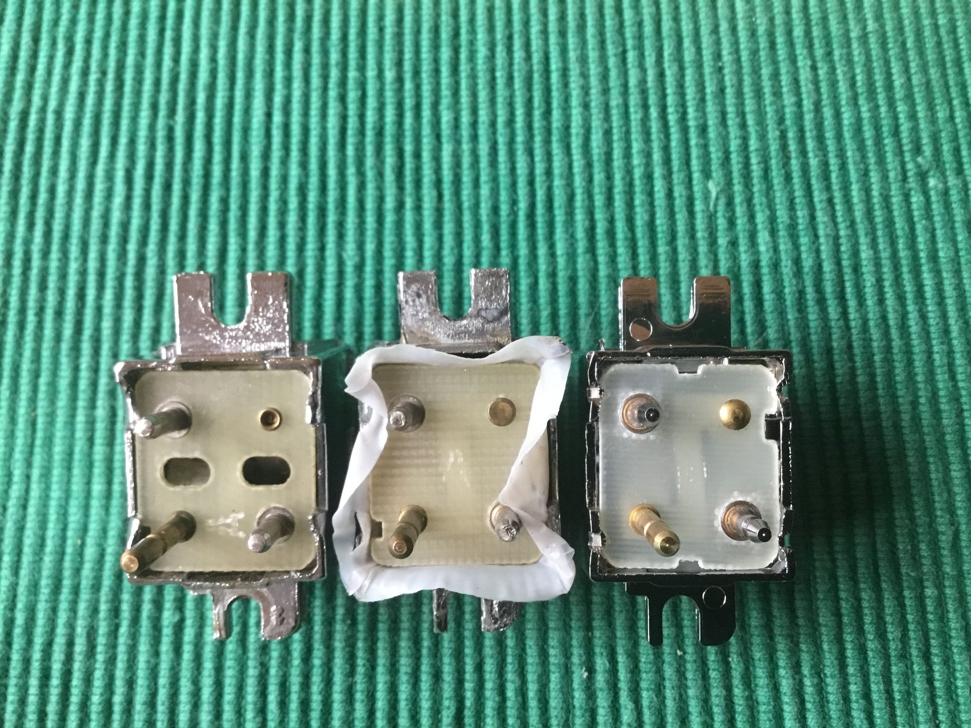

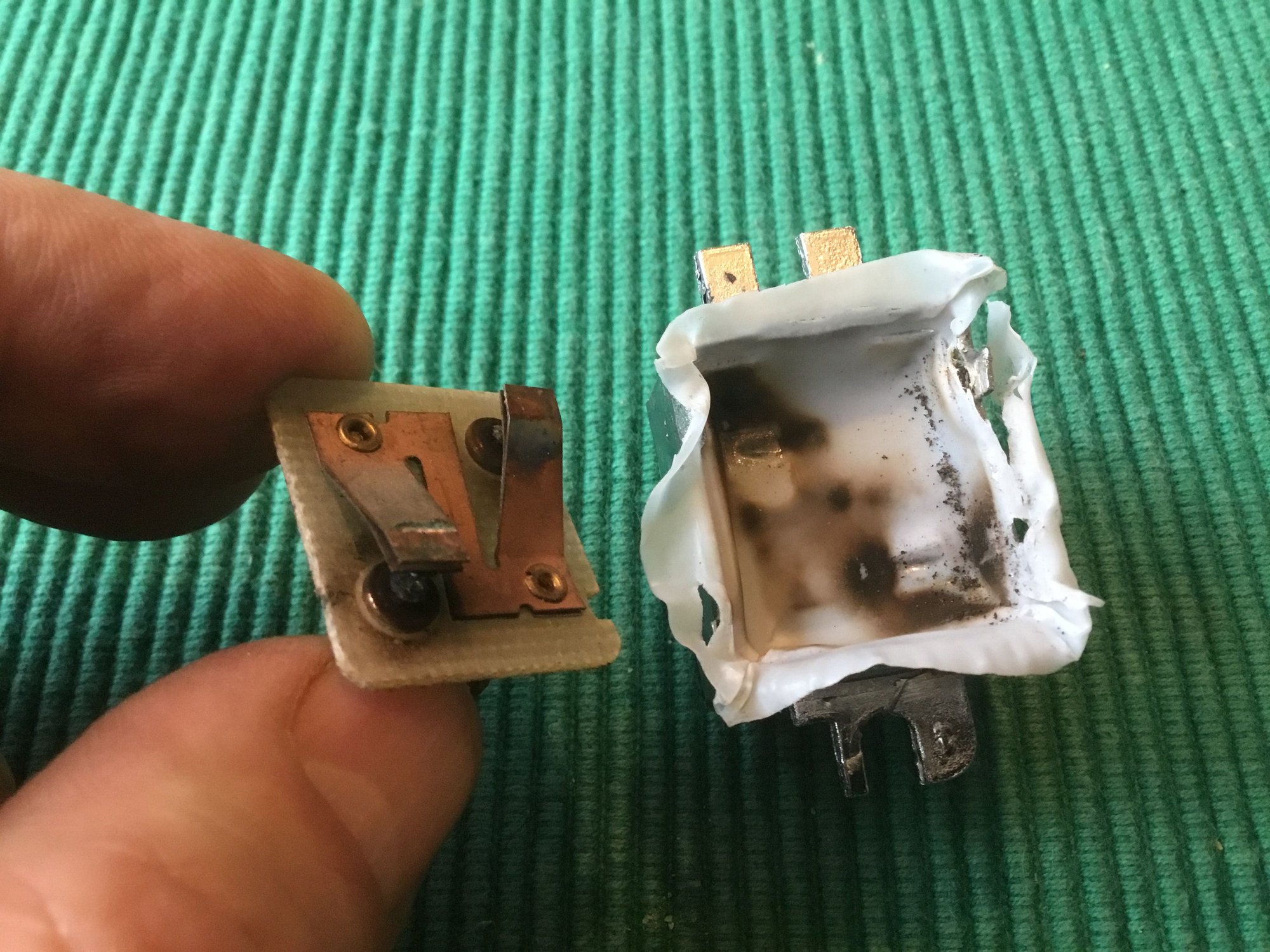

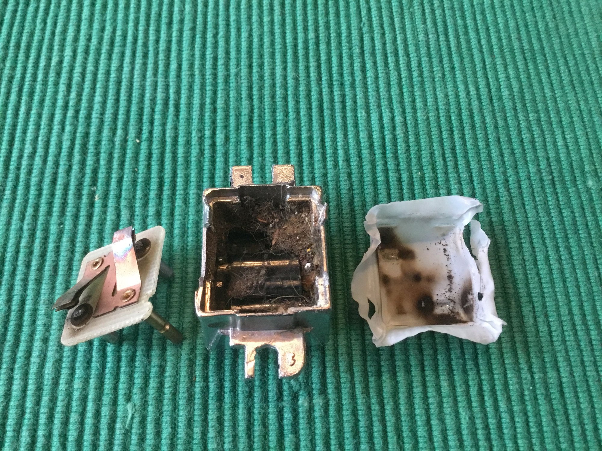

Thanks for the tip on switches. To start I timed the windows up and down. Driver side 6-7 seconds, then died partway up! Pass side 5 sec..
The driver side switch had previously been replaced. Pass side had previously been pried open and a plastic shield installed above the contacts to keep stuff out. The plastic shield had was scorched near the contacts from arcing. Cleaned up the switches and put them back in. Happened to have a new switch on hand to compare function. Pass side went to 4 sec up and down (20% better). Driver side got the old switch to do a solid 6sec. New switch was no faster. Going up feels like it takes off quick at first and hits resistance 3-4inches up; like something in the mechanism that isn’t exactly where it should be is binding something. By comparison the other 78 has a 3 second driver window, 4 seconds for the pass side (time to clean that switch).
Driver side, pass side, new
Driver-I think that fir needle was not enhancing conduction
Pass side with scorched plastic shield
pass side- the shield kept a bit of stuff out of the actual switch contacts

If you clean everything up, get all burning and corrosion off the contacts, put dielectric grease on those contacts and re-assemble them, you will likely find that the window motors operate quite well.
P.S. Checking continuity of switches and power line using an ohmmeter is fine...but it doesn't determine how much current flow would be restricted when significant current is trying to flow thru that system. You need much different equipment to find and quantify those kinds of electrical problems. Complete motor windings are very low resistance components. So burnt switch contacts could eat up significant current and convert it to heat for a few seconds when the switch is 'made'. That's the scorching you see inside the switch housings.
