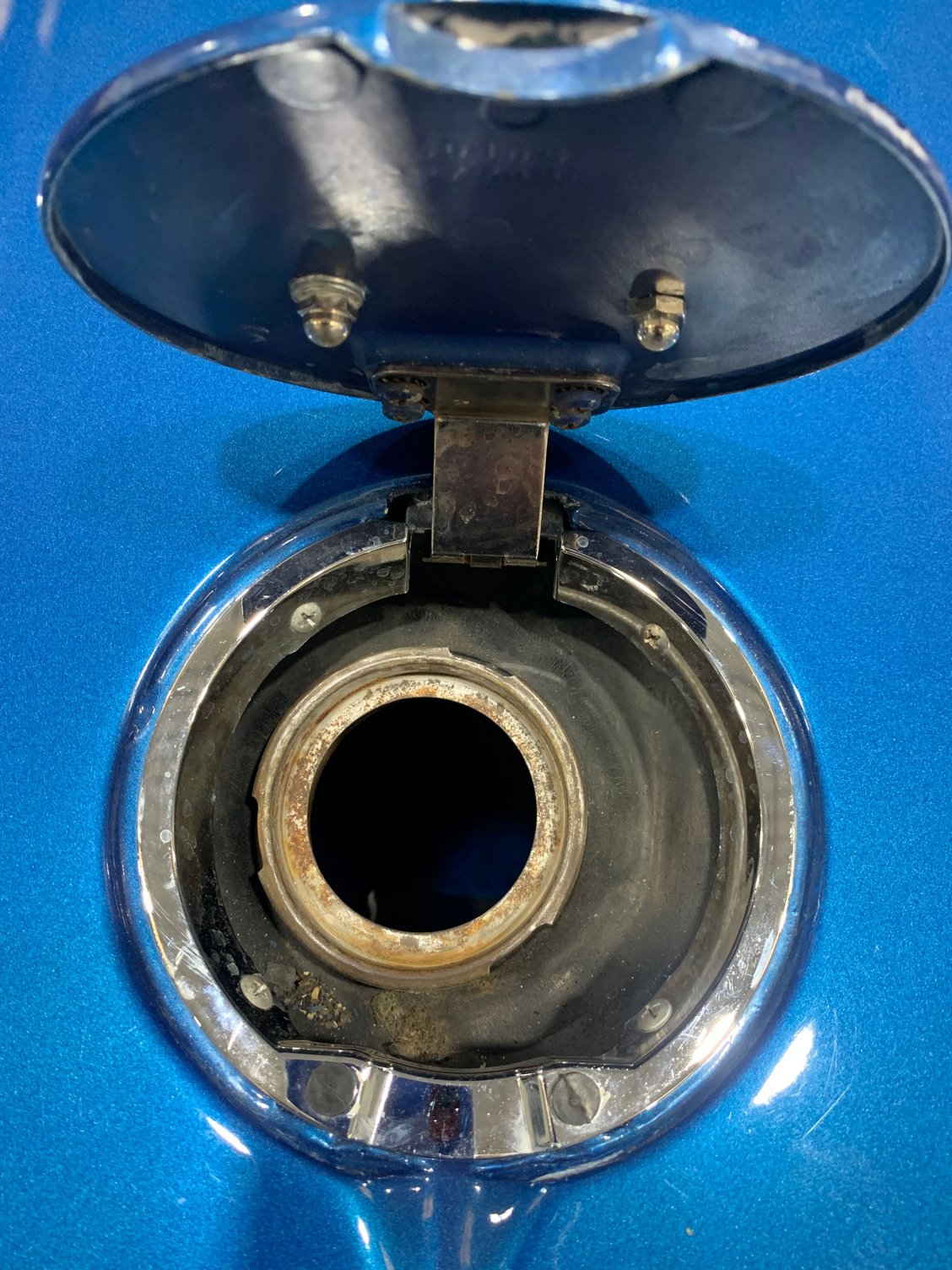

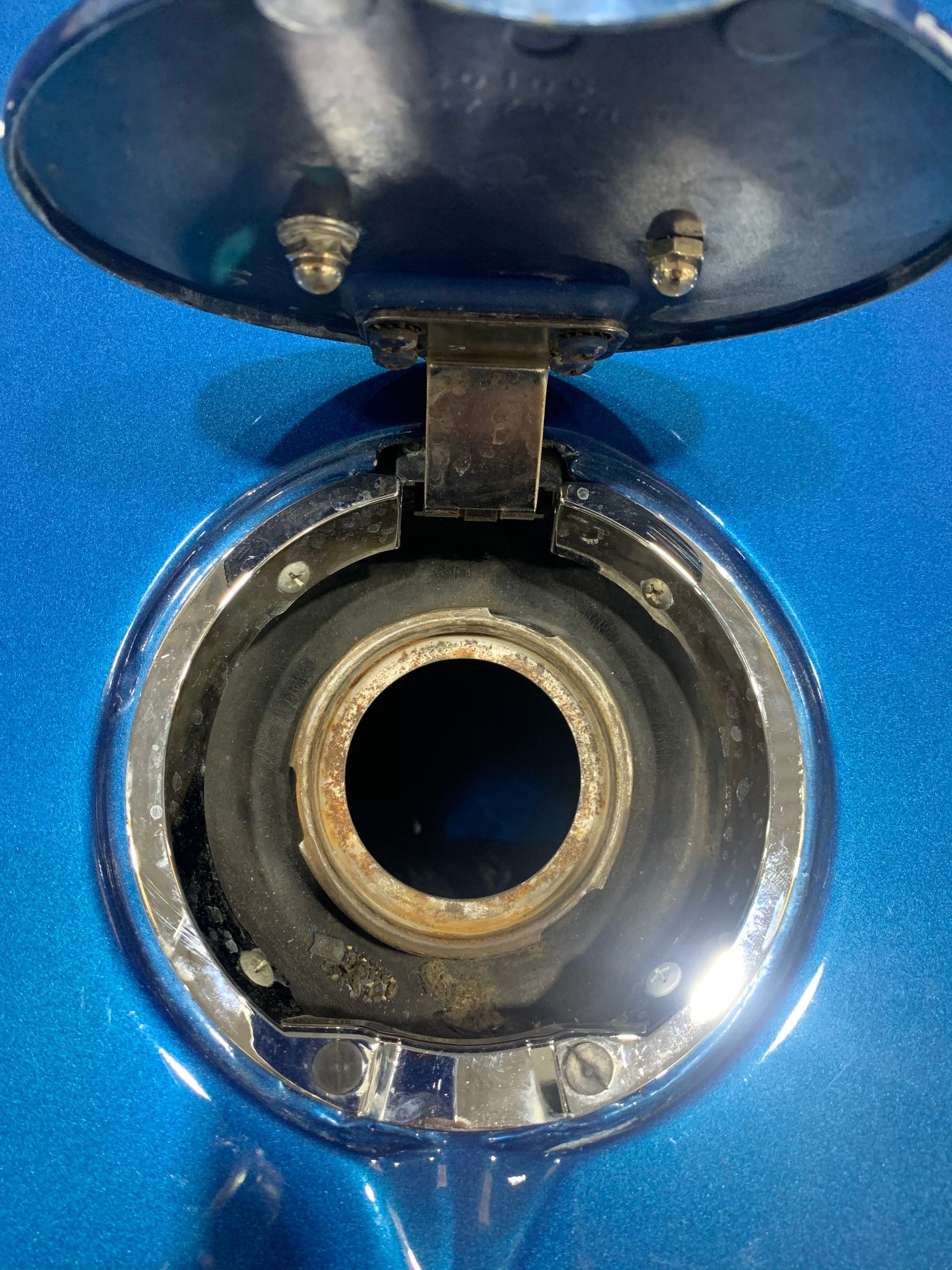

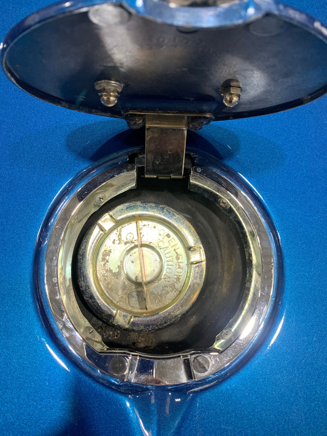

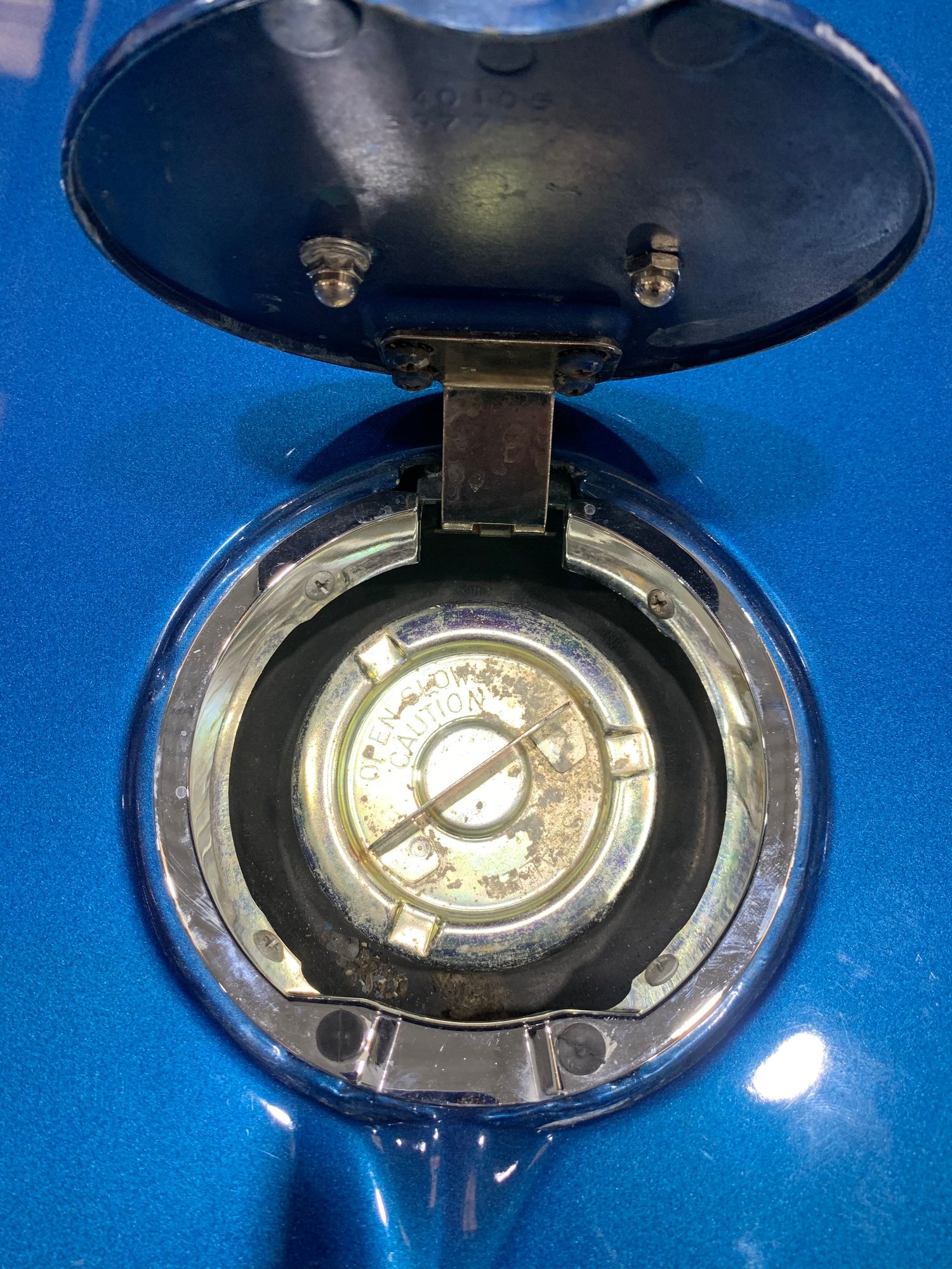

Hi everyone, I have a new problem that really concerns me. Lately when I gas up I notice when I lift up the gas tank cap the gas tank isn’t in the center, it is off center to the left. If I pull it to the right it slides back to the center. I remember one day hearing quite a loud snap but couldn’t find anything wrong. How is the gas tank secured so it doesn’t move around. Is it strapped in? I’m thinking maybe a strap broke and that was the loud snap I heard. I’m worried about gas lines moving around which could lead to them breaking... Check out these pics and tell me what you think

HI Dave,
There are two straps that go across the top of the tank.
They are hooked in the front frame cross member, and then bolted to the back frame rail.
You tighten the bolt to tighten the strap.
You can easily see if both straps are correct by laying on the ground and looking up at the front and back of the tank.
Its possible one strap came unhooked on the front.
Hope that is clear enough

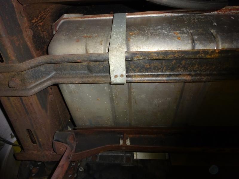

Originally Posted by interpon
Pics from under and strap connectors would be helpful
Here is a pic from a '77. The setup is similar to what the OP has----2 straps running length-wise, hook at the front, bolt at the rear to tighten up the strap.
Orange circle denotes hook-end of strap, yellow circle denotes bolt-end of strap. This view is from underneath, looking towards the rear of the car.
The gas tank has 2 recesses that the straps lay in. Even if the straps were a little loose, they would hold the tank in place.
Spare tire carrier, spare tire, and spare tire carrier cover need to be removed for this access.
It sounds like the one or both of the OP's straps are snapped, based upon the "loud snap"noise he heard.
