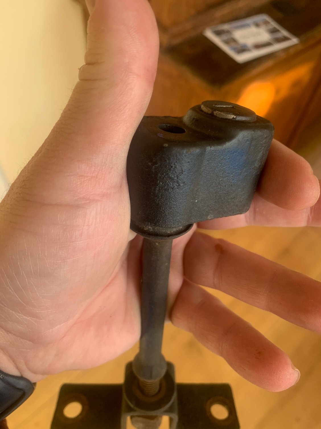

Hey all,
Any suggestions on how to handle this ?
The key is missing.
I suppose just cut it off ?

Ha !!! It took me less than ten seconds
I checked out the link mentioned above...
https://www.corvetteforum.com/forums...post1597968930
I clipped the bulb end off a hair pin and shaped it like in the picture and a few seconds later it popped out.
I love this place.
