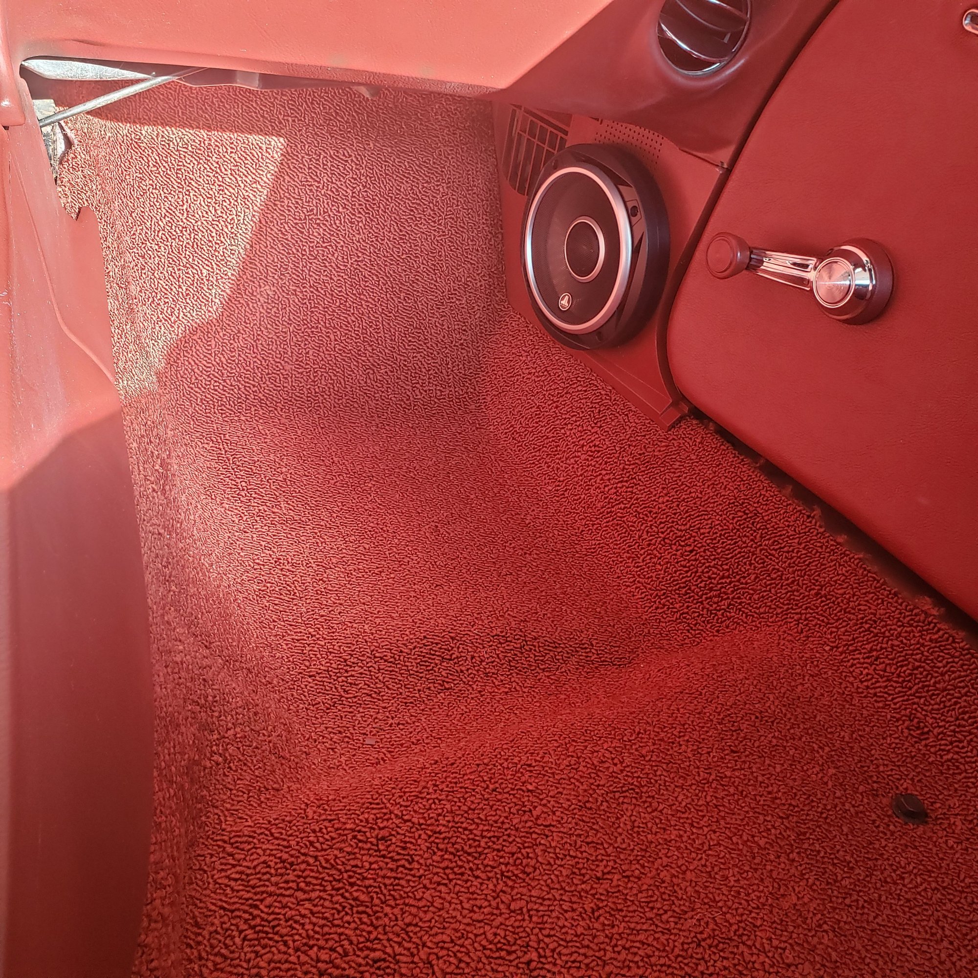

I had my orginal 78 converted with Aurora Digital. I have Bluetooth, phone, USB, am/fm. 200 watts RMS which is different than peak. No need for a sub in my convertible. I use my phone to play XM radio. Great tunes. Sounds beautiful. I install 6.5 round JL Audio speakers in my kick panels and 6x9 in the back, JL Audio.
That is one beautiful interior! love it my friend!!!
Old Jan 23, 2021 | 06:57 AM
twinpack's Avatar
twinpack
Joined: Mar 2009
Posts: 1,461
Likes: 361
From: Monson MA
Originally Posted by 62corvette
Unusual interior for a 78. Looks very 68-ish to me. 😀
typo

This is a nice setup and a beautiful interior.
Thanks for the information, more what I'm looking for.
