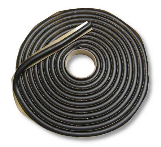

Do the next guy a favor and don't glob a bunch of siht to seal the housing. The pain is cleaning up the mess that someone left behind. I got a roll of sticky sealer, 3/8" black around butyl tape.
Yeahm I've spent literally hours scraping and otherwise trying to clean up the blower motor housing and heater housing. It's like the factory had a sludge fest there - Now of course, 50+ years later it is hard as a rock. I understand making it water proof so rain doesn't leak into the cabin, but wasn't there a better way back in 1969 to seal this thing off? And don't get me started on the wiper trough (another project I started this winter) - what a mess that was!
