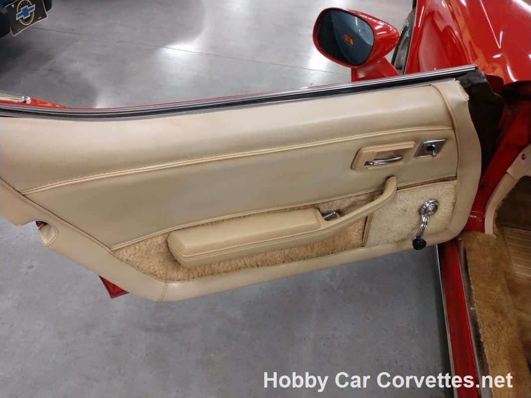

There was a HUGE @#$%-up made by Chevy/Corvette.
The door panels came in power window and crank-up window styles.
some 80% were PW
Those that were crank windows...they PUNCHED the window crank holes RIGHT THOUGH THE MAP POCKETS IN THE DOORS!!!!!!!!!!!!!!!!
Apparently nobody told the door card designer to accommodate crank windows!
The most expensive car GM sold! BIG OOOPS!
Unkahal

Exhibit "A"!
To 1980 interior interchange years ?
