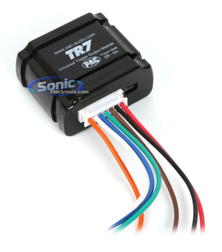

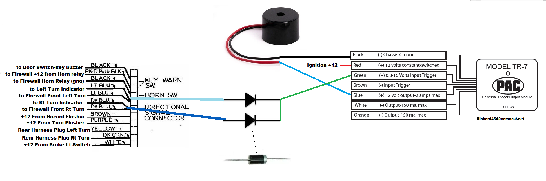

Here's a trick for NOT driving around with the turn signals on- without putting a Cadillac emblem on the back of your car...
After up to (programmable) 4 minute and 15 seconds of the turn signals being on a piezo buzzer will start to beep with the flashing turn signals.
It's wired to ignition- so it won't buzz if you have the car off and using the hazards.
Can be done for about $20-25.

Originally Posted by Richard454
I like the chrome bezels on the gauges!!! Give it a classy look!!!
https://www.amazon.com/PAC-TR-7-Univ...4051340&sr=8-1
Ha You know where I got the idea!

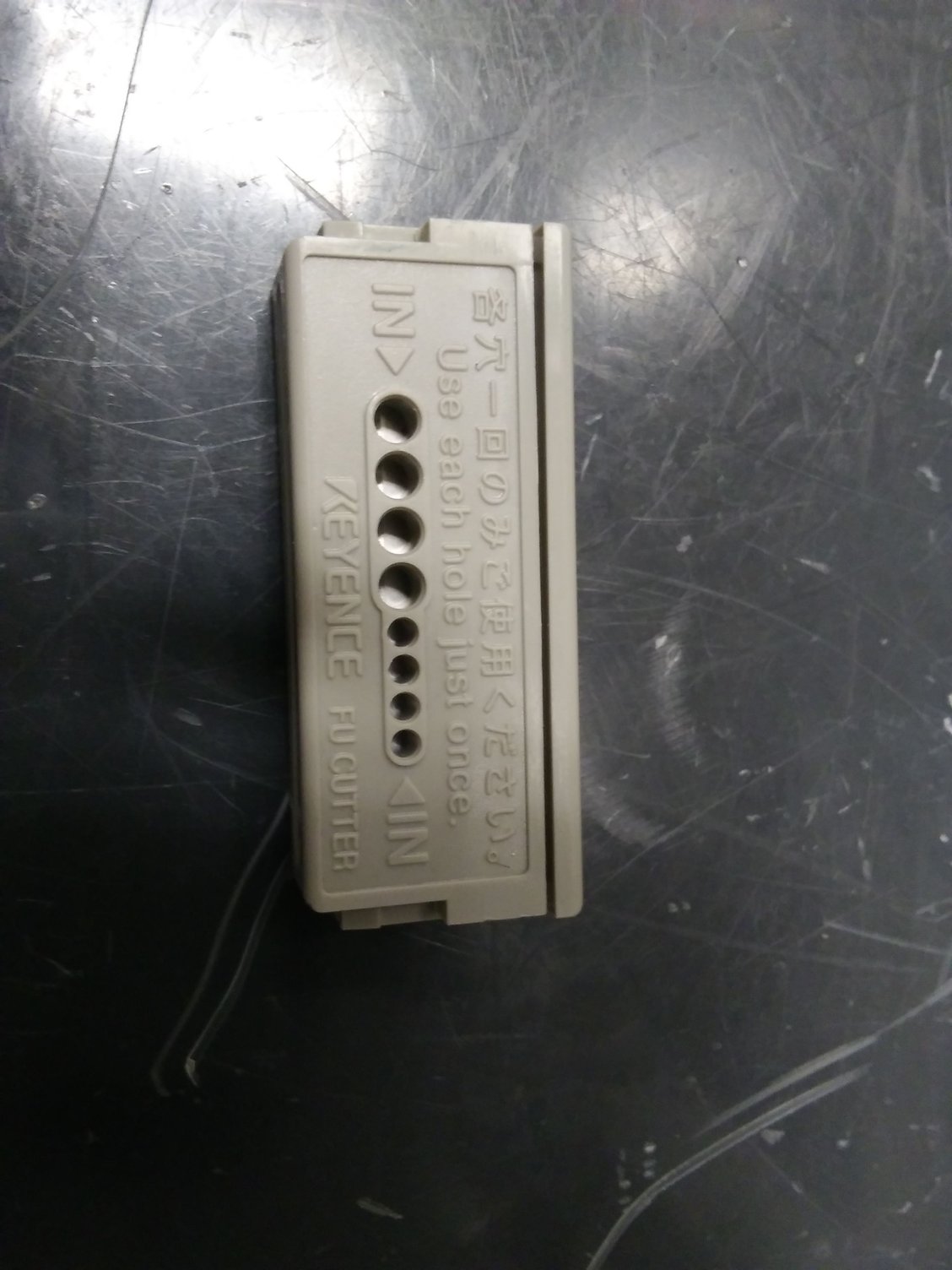

Just a little FO tid-bits. We use FO alot at work. Most are single strand plastic. There are some multi-strand actual glass fiber cables but they all come with a metal ferrel on the ends. We use special cutters for the single strand plastic cables that come with the replacement FO cables. They cut perfectly straight without scratching. You're supposed to only use the cutter once but I've found over the years it can be used multiple times before signal degradation. Pictured is me holding one of the plastic FO cables to my phone to show its single strand like in the Corvette. Second picture is the cutter. I actually used one of these cutters to clean up the ends of my Corvette FO cables years ago. I had to remove the little keeper thingy to do it. I was careful not to break the keeper thingy and managed to put them back on when done. Enjoy.

Originally Posted by theandies
Actually what Chevy used back then was single strand plastic cable but you still need a clean cut.
Just a clarification "to whom it may concern". At least on my 69, the FO is multiple strand with a bronze ferrule. It's hard to get a single clean-cut so I am living with slightly degraded light intensity. Is your cutter good at multi-strand?
Also I buggered up one of the ferrules (which is essentially what holds the fiber in the guide). My local guy doesn't have a source for these.
No, the cutter is used only on the plastic ones. I mean I guess it could do the glass fiber ones but I've never tried as all our glass fiber ones have metal ferrules on the ends and are fixed length depending on application.
Maybe Chevy changed them or maybe I didn't look at them hard enough. Probably the latter. I know after I cut them they transmitted light better.

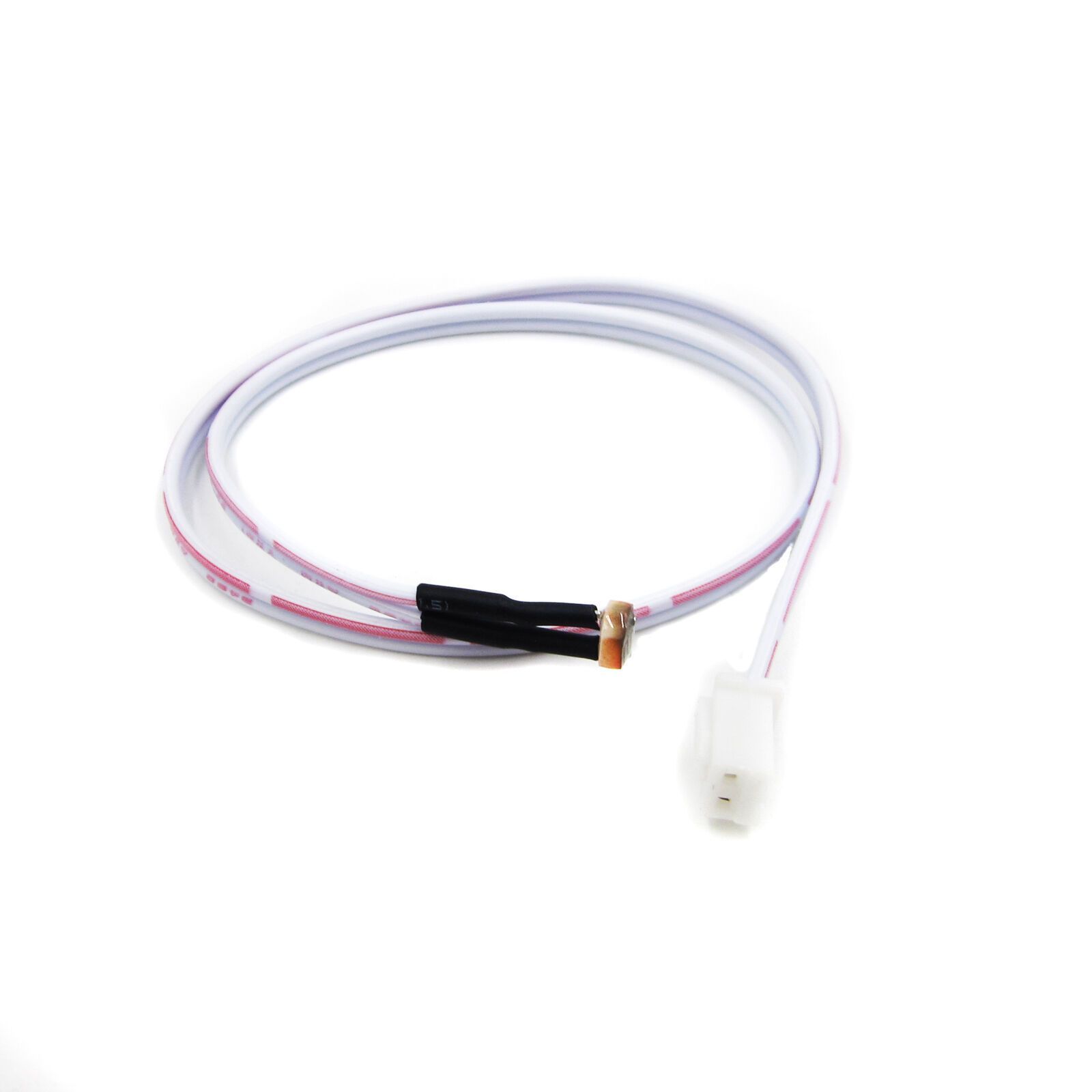

Here we go-
https://www.ebay.com/itm/12V-Photore...IAAOSwE9lZuCds
Only a few bucks apiece-
small- 2" x 3"

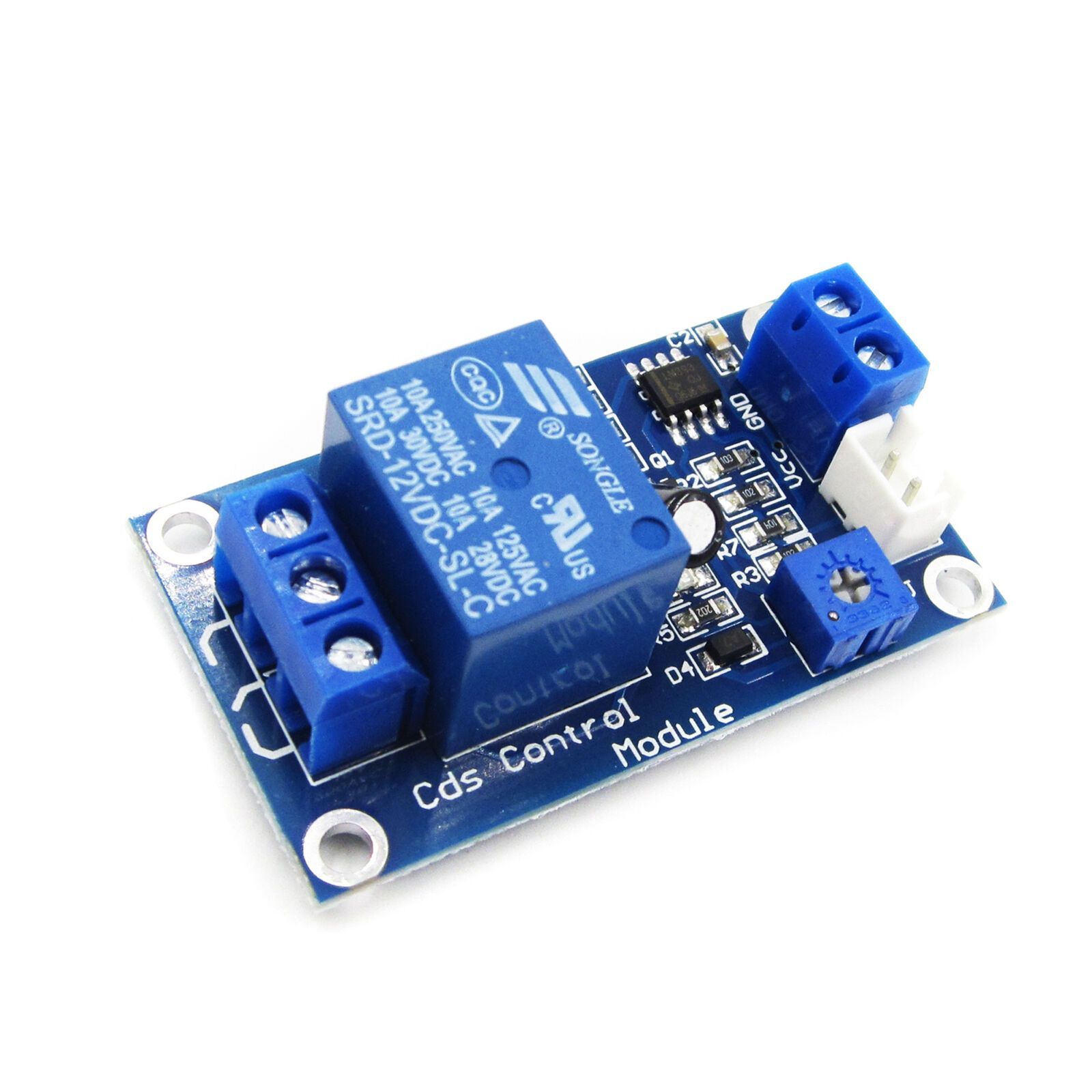

Has a 'remote' sensor- normally open and normally closed relay (10A)
Light detection and brightness detection- can be adjusted via potentiometer
I'm thinking this could also be used to turn on your headlights at dusk/night...
small- 2" x 3"

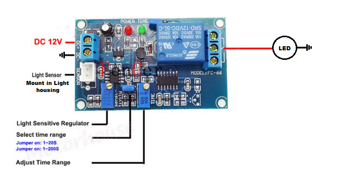

Originally Posted by platinummaker
Richard,
Ic I could impose once again, how would I wire these buys?
Thanks much. Big much!
Here you go-
I'd set the sensor at 1 sec delay- then you'll have to figure out how sensitive it needs to be
Hope that helps- do let us know how it turns out!!!!
