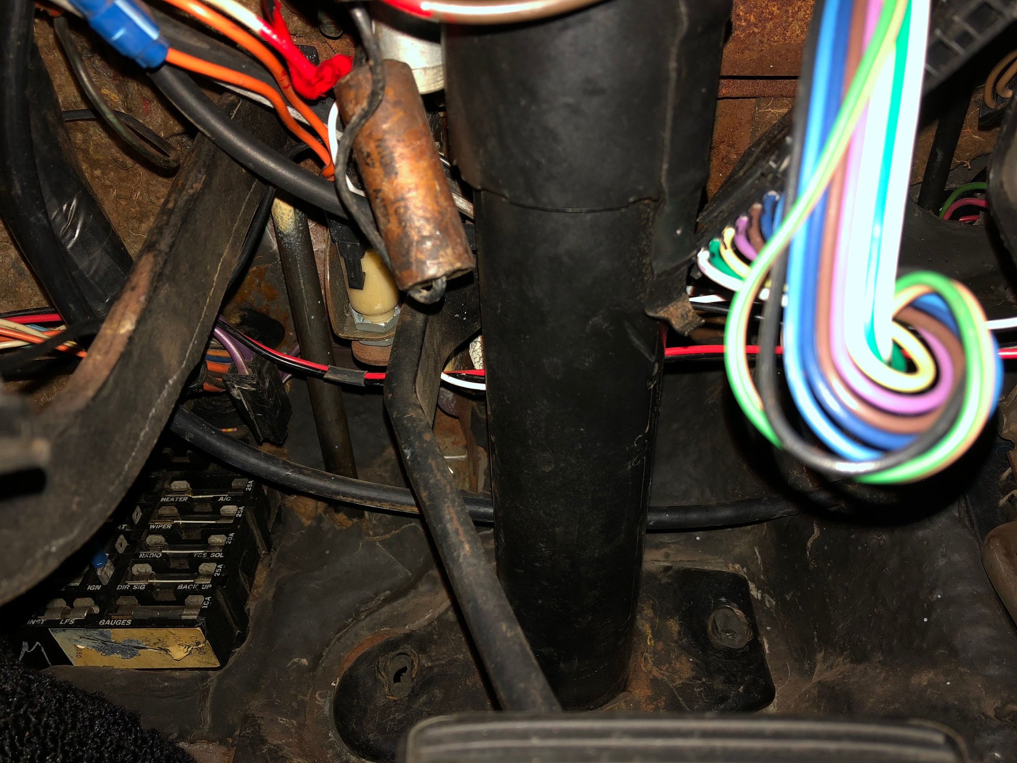

You may not realize that your Lottery Numbers are going to Hit. My dash is out as the speedo/tach are DOA. Here are a few pictures of the switch. Unless you were a contortionist in the Circus, you may have to remove the drivers seat, and even the dash. Start reading and Googling. It may be called clutch switch. Good Luck, you may need it!
Left of the steering column above capacitor
The switch is left of the two white wires

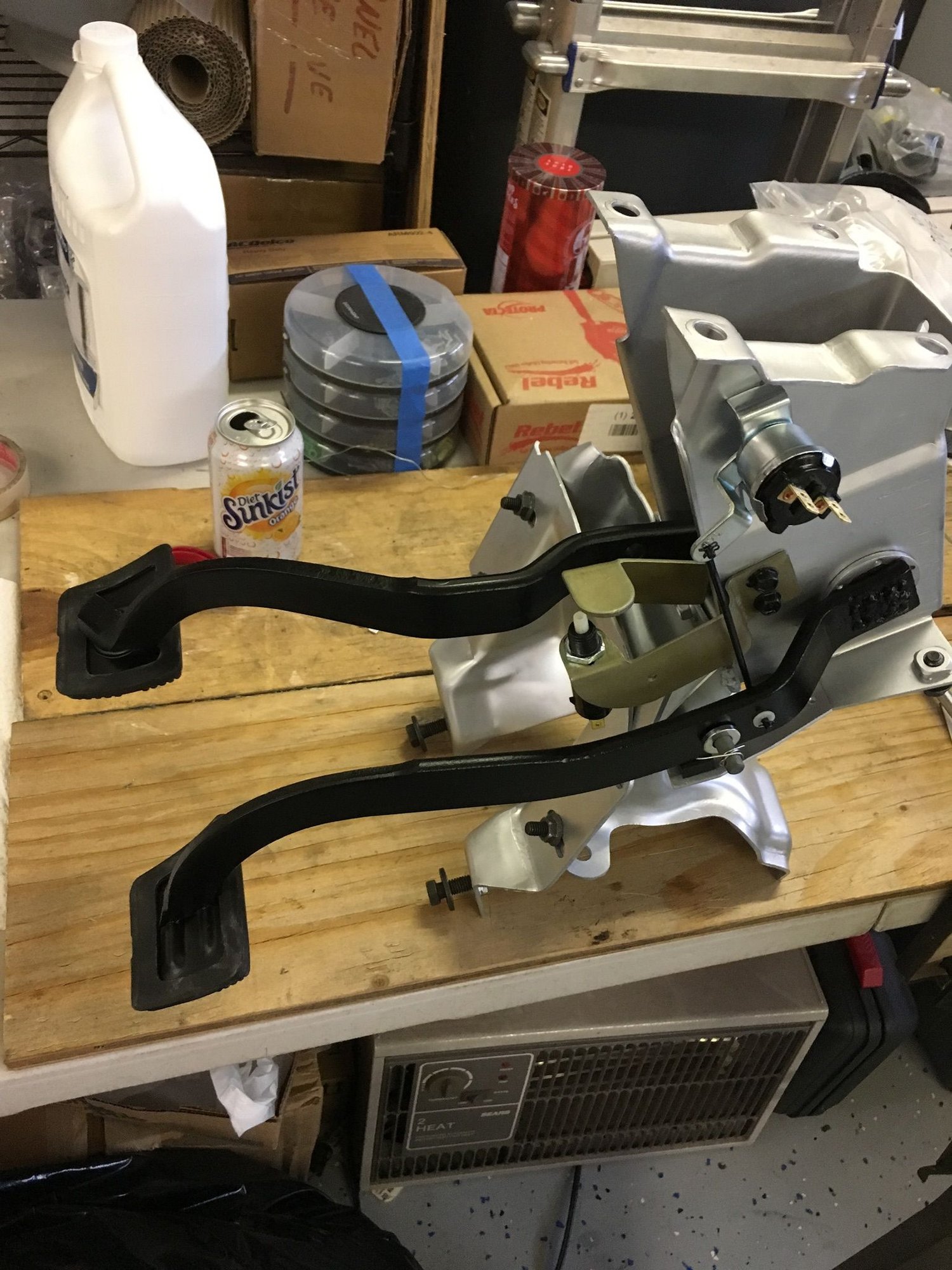

Access is key to everything. Here is a picture of the pedal assembly removed showing clutch switch with the actuating rod and the small clips you will drop while working upside down. Break out the Tylenol. Good luck.
From drivers side looking inboard
From firewall looking aft
To neutral safety switch
