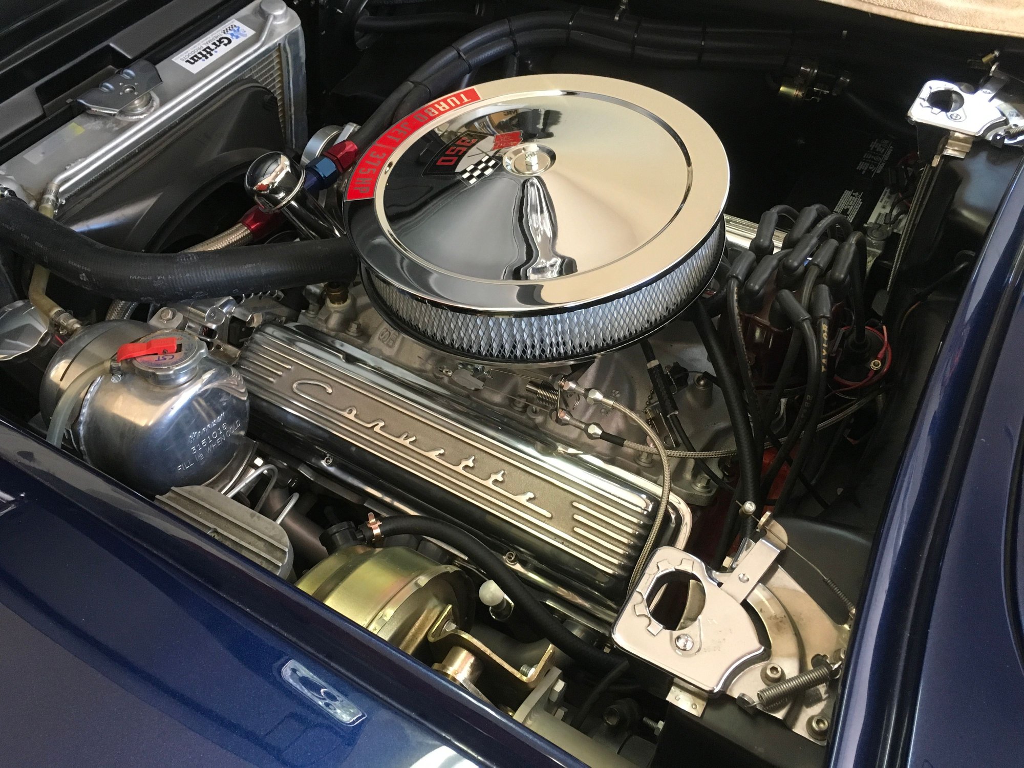

Lokar (and others) makes a bracket specifically for throttle body EFI and the associated throttle and TV cables.I used the carb version on my ‘61 with a carb and 700r4. Here’s a pic you can blow up to see the specific set up. I’ll post some options and part numbers once you let me know what components you already have given you are in the UK, don’t want to buy duplicates and would like to get this done right the first time.
Zoom in to see the bracket, throttle cable and TV cable. Using Lokar, your set up would be similar. I choose a polished bracket and stainless sleeved cables. They also have a black bracket and black cables for less bling and a more stock look. Let me know which you prefer.
