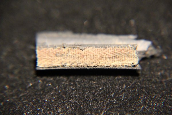

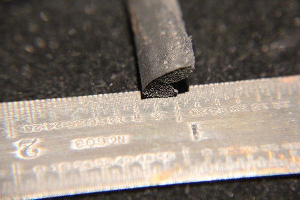

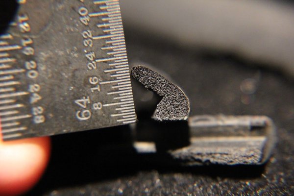

/The original dam is about 3/8" tall when upright and 3/16"" wide, it goes on about 3/8" from the edge of the glass then you cut the urethane tube tip AS SHOWN IN THE FISHER BODY MANUAL and lay the bead in and then install. AND yes you should use the blocks.
Here is a piece of an original - which has a cloth backing, this prevents the installer from "stretching" the dam.
