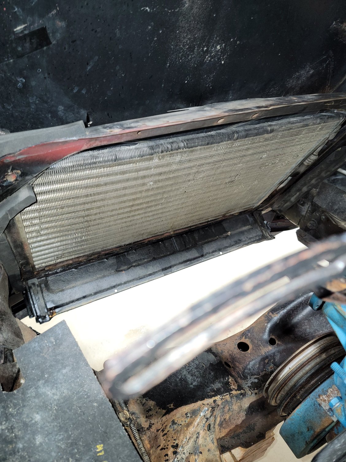

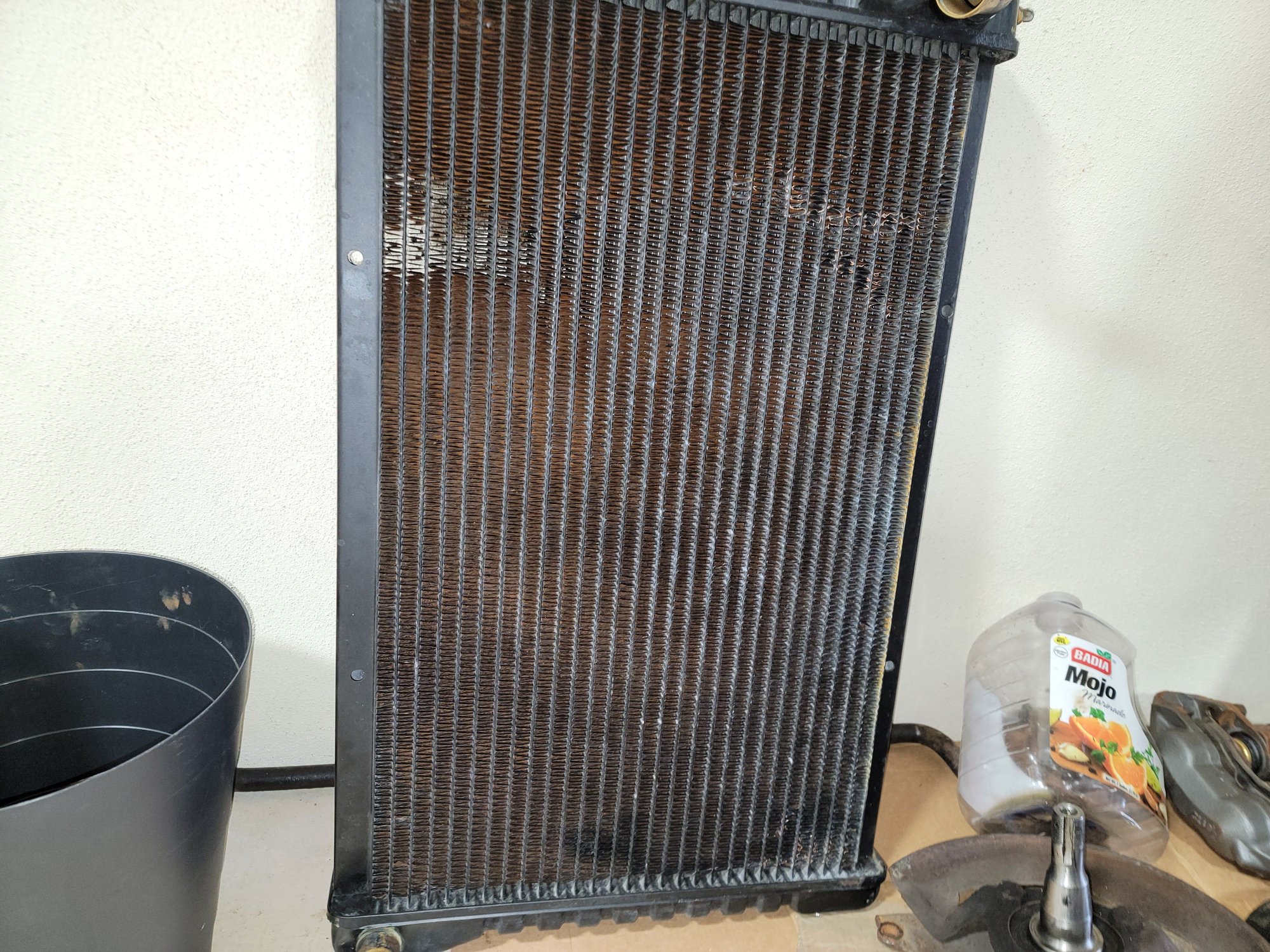

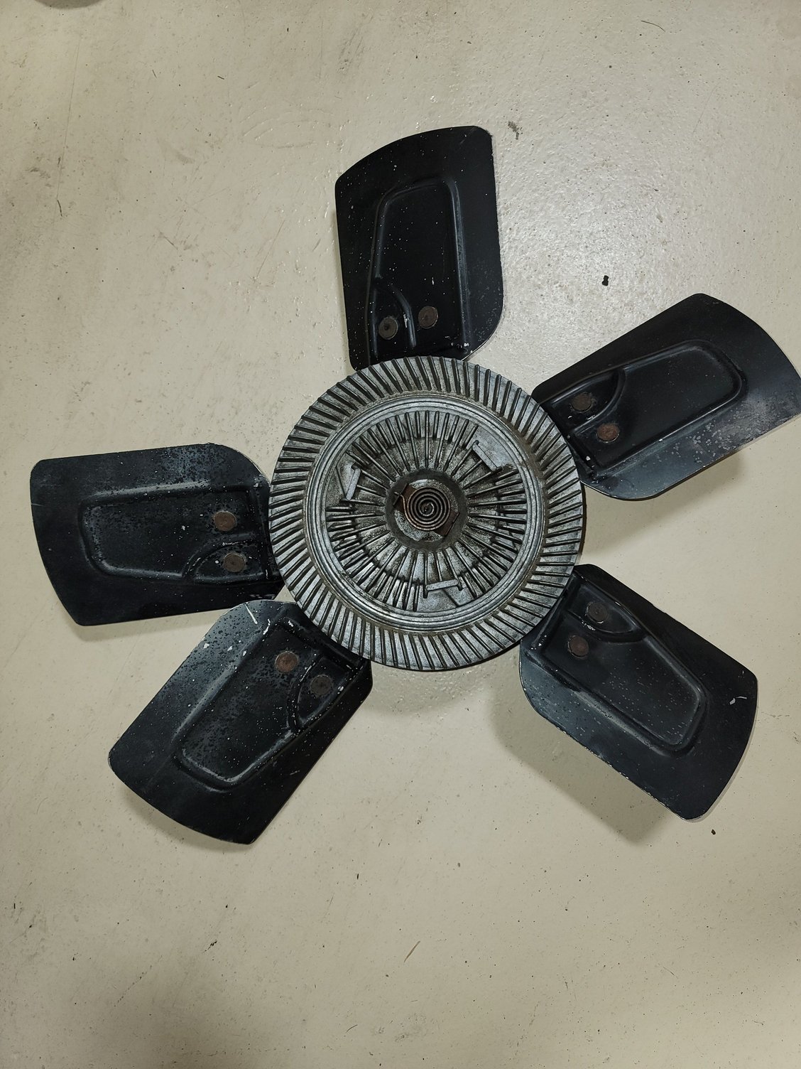

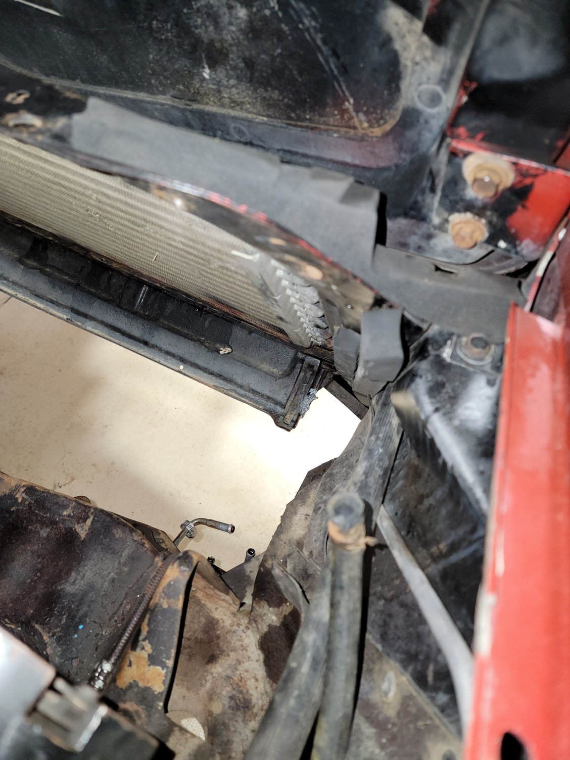

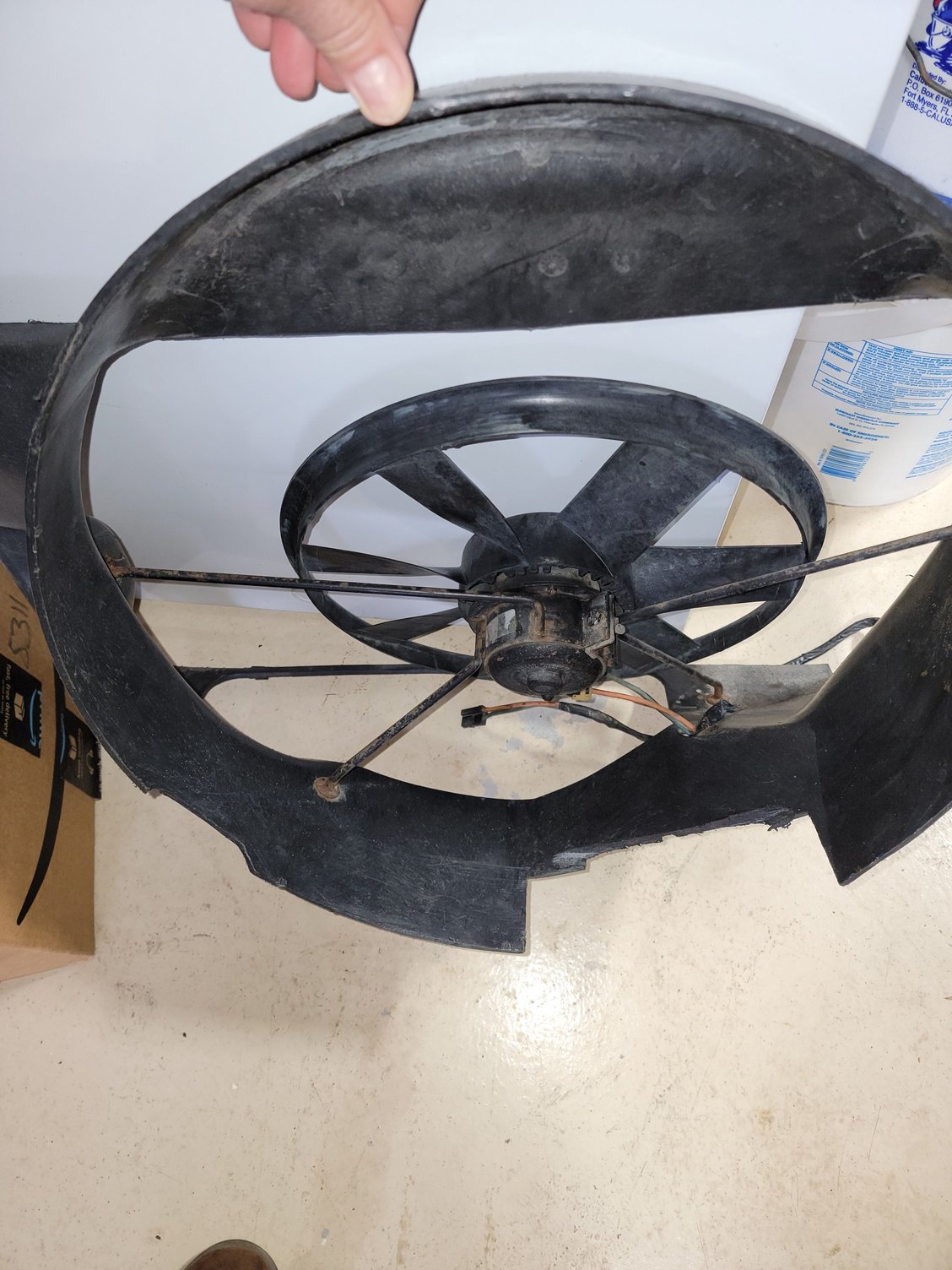

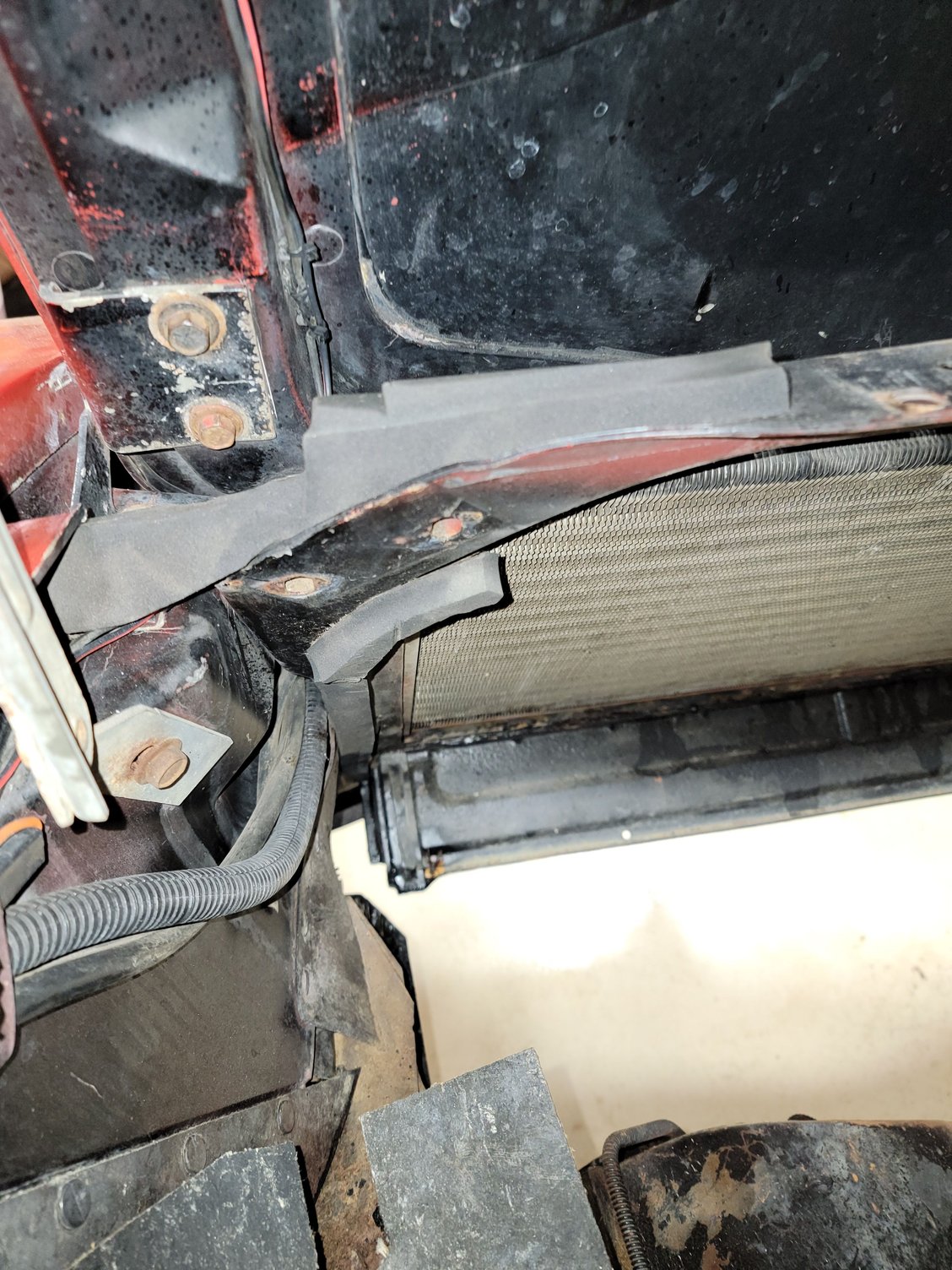

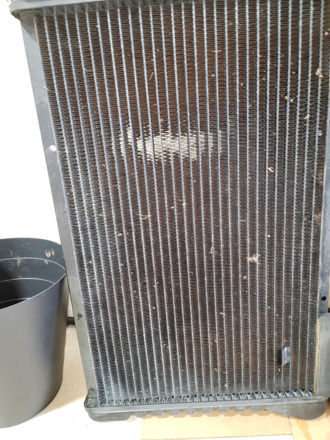

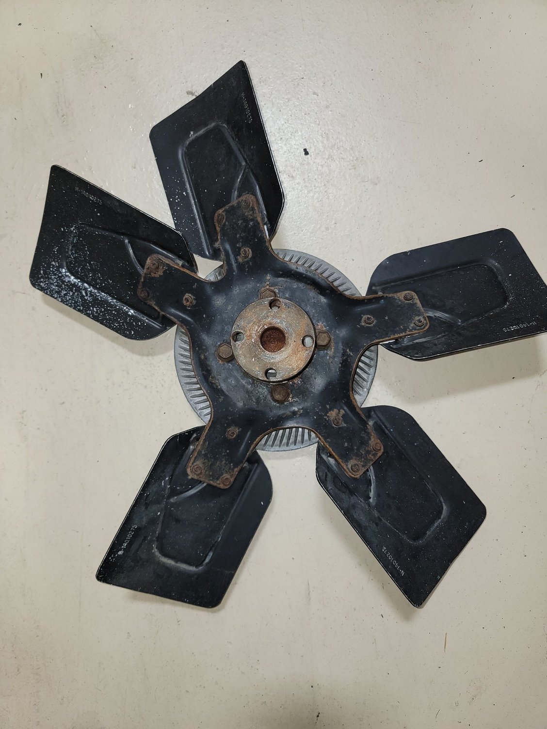

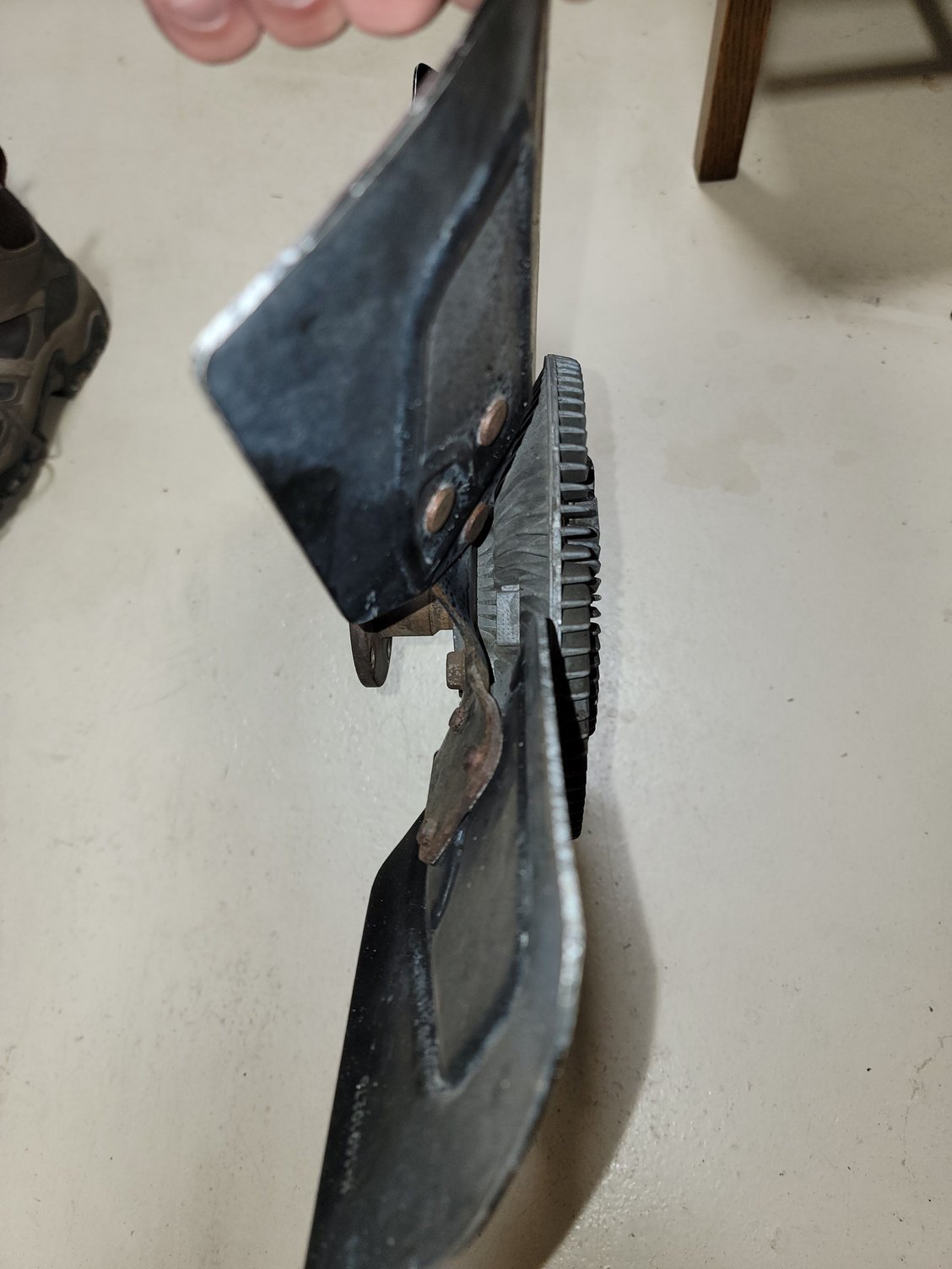

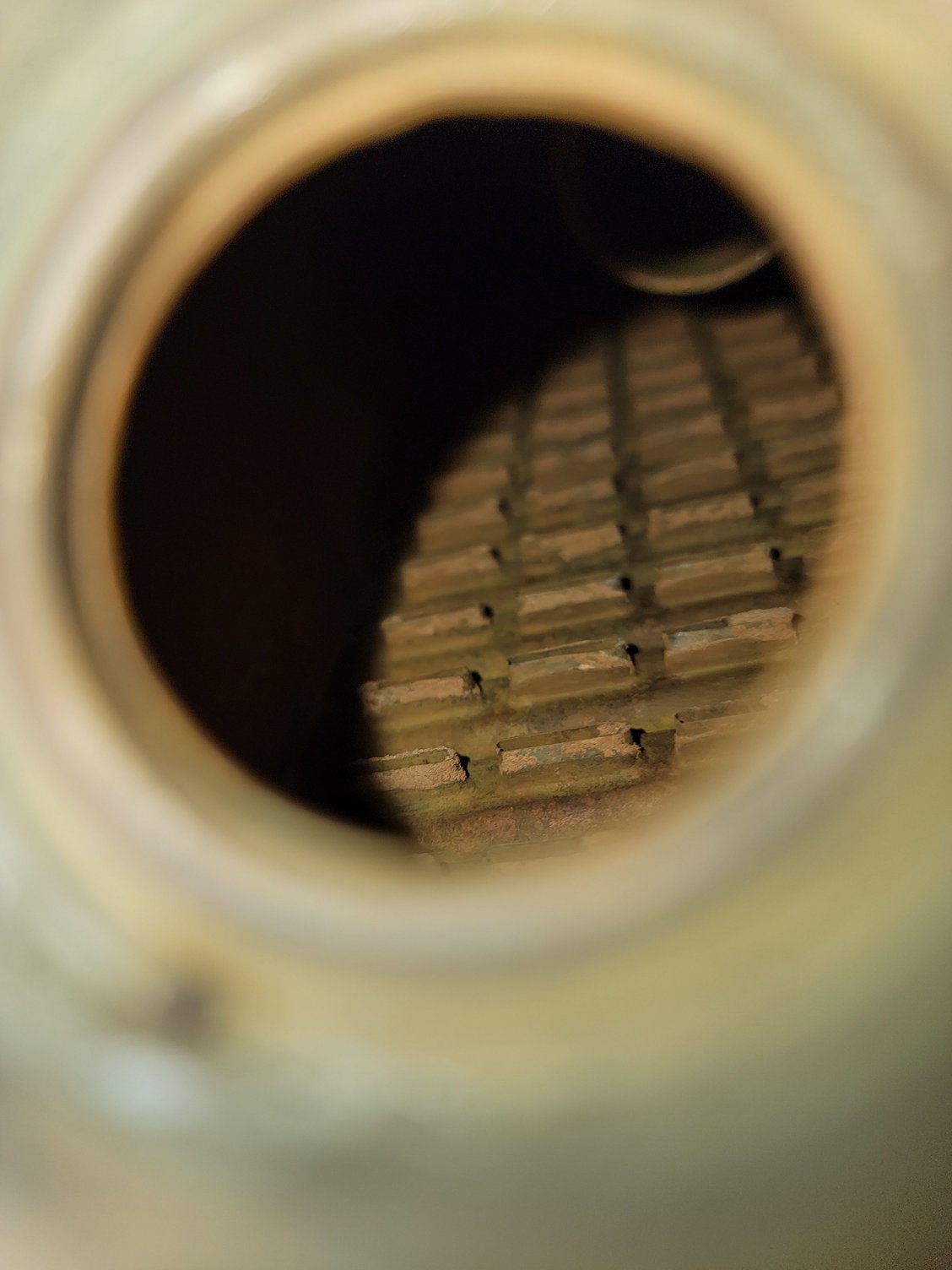

First time posting, however I have been reading the forum a lot and have some questions regarding the cooling system. For my 1979 L-82 with A/C, should I install a 180° or 195° thermostat? I live in Florida, and as expected it is VERY hot in the summer. Along with the thermostat, which temperature/year fan clutch would be recommended? I am looking for the best cooling and optimal engine temperature. Thanks in advance.
Have attached the photos as requested. I have bought a rebuilt ac delco water pump. I flushed the radiator once with Prestone, rinsed until clear, and a second time with Prestone and Evaporust. Ran it for several days before draining. Rinsed it multiple times until water flowed clear. Water was flowing well through radiator when looking in cap hole while engine running. My shroud does not have the springed door. Should I patch it?
Thanks again.

The thermostat doesn't control cooling temp it just opens at a set temp to allow coolant to flow through the cooling system. Install the OEM recommended cooling parts and you should be fine unless there are a lot of modifications to your car. To answer your first question install a 180 deg stat and only than if you think the one already installed is bad or missing.

i have your car..
you should already have a very big fan and (5 or 7 don't remember) blades.. AND an electric fan puller that comes on @ ~230f (kinda ridiculous) but you can bypass it to run and help cool. that's a lot of air movement.. and of course seals are critical
i run 180f
i also went dewitts aluminum radiator as my original was marginal.
pics of what you got may be helpful, and inside of radiator..
My original 40 yo radiator replacement 79 l82 - CorvetteForum - Chevrolet Corvette Forum Discussion
https://www.corvetteforum.com/forums...ss-option.html
edit.. be sure your bottom spoiler is in place too..pic under would be good too..

I have a 78 L-82 and before I went about all of my mods, I did a pretty thorough job going through it due to all of the stories I heard about cooling (and A/C). I live in NC, so we get some pretty good heat in the summer. Here's my list of items to check:
  • Jebby makes a great point on timing, and Lars' paper is just good stuff, so definitely work through this.
  • I used a 180 thermostat just to give myself some headroom in terms of running in hot weather with A/C on
  • Flush or check your radiator
  • Check your lower coolant hose (from radiator to water pump). A really good one of these will have an inner spring, but even if it doesn't, check to see how soft it is when the engine is up to temp. That's the suction side, so if the hose is soft, it will collapse and restrict the flow of cooled water from the radiator into the engine and generally slow down the coolant flow. If it's soft, change it for a quality new one, like a Continental, not some store brand (unless maybe NAPA)
  • Check your fan clutch and make sure it is working
  • Have a good, clean shroud. The shroud is critical to ensuring that the air the fan moves comes through the radiator and does not just circulate around the fan.
  • Foam, Foam, Foam - If you look at the diagrams of the radiator mounting in any suppliers catalogs, you will see an ample amount of foam weatherstrip. It's there for a reason and if yours is gone, put it back. This is especially important for the insulation between the hood and the top of the radiator/radiator support. That piece of foam helps to keep the air from going AROUND your radiator. You want THROUGH!
  • Ensure that the lower air dam is in place and correct on your car. This should be attached below the inlets on the underside of the front (usually black plastic). If you have the pace car spoiler which became an option in 79, all the better. If you have nothing, you are missing a critical piece that scoops up air and rams it towards the A/C condenser/radiator.

If you have the original fan clutch and it's working, keep it. And if you don't keep it, send it to me. I had to change my fan clutch last year (because I'm an idiot and damaged my original, but I digress). After extensive research, I discovered that fan clutches built to original specs are no longer available. In an attempt to consolidate parts, fan clutches nowadays engage at a lower temperature than the original spec fans. The result is they engage the fan more and create a lot more noise. They certainly work well, but the noise from the fan is very annoying.
