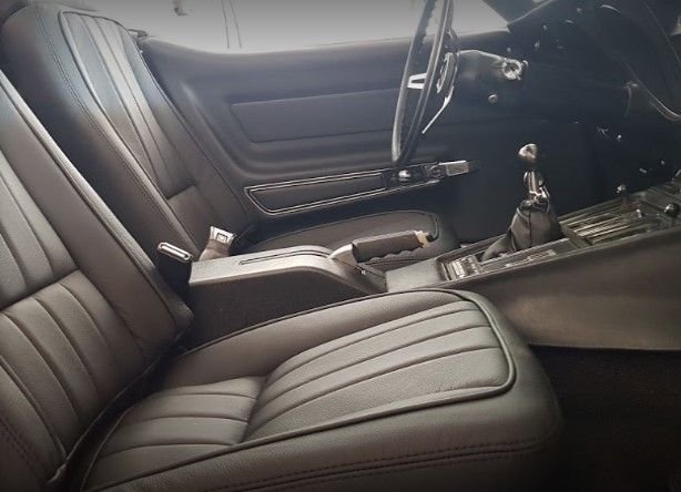

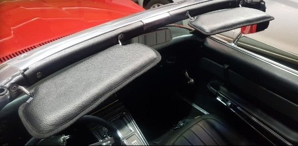

Custom leather covered visors
New leather seats.
I had my vinyl seats recovered in leather, as well as the sun visors. Looks great. Door panels are Corvette America. I listed the door card fitment issues above. I also found that the new panels were thicker than OE in the door latch and winder areas. Requires extra force to get everything to fit. Overall look is pretty good in spite of everything. BTW the re-upholstery in leather cost me around $350!
