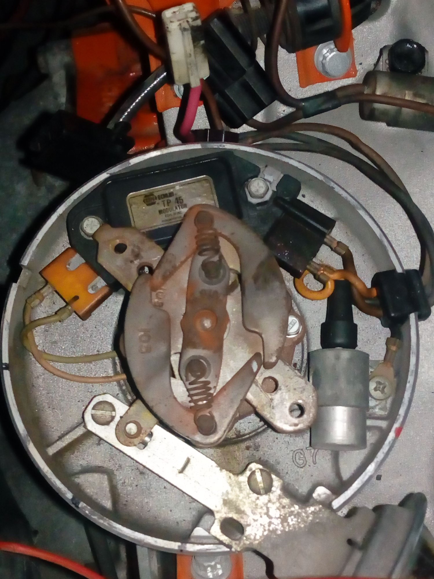

- Maybe it's the ignition control module, like you guys said? (see pic) What are good modulators that will work?

Here is a pic...

You just need a small tube of this:
https://www.amazon.com/Super-Lube-98003-Silicone-White/dp/B0044NI2M2/ref=pd_bxgy_2/139-9707568-9023040?_encoding=UTF8&pd_rd_i=B0044NI2M2&pd_rd_r=7d7eca1d-7477-420b-9f91-6d7ebaca1c07&pd_rd_w=SecdH&pd_rd_wg=PQkrr&pf_rd_p=bd257e40-8799-42ac-88d0-f76e0faf3886&pf_rd_r=J18BS89E3HSTJKZZMYFF&psc=1&refRID=J18BS89E3HSTJKZZMYFF https://www.amazon.com/Super-Lube-98003-Silicone-White/dp/B0044NI2M2/ref=pd_bxgy_2/139-9707568-9023040?_encoding=UTF8&pd_rd_i=B0044NI2M2&pd_rd_r=7d7eca1d-7477-420b-9f91-6d7ebaca1c07&pd_rd_w=SecdH&pd_rd_wg=PQkrr&pf_rd_p=bd257e40-8799-42ac-88d0-f76e0faf3886&pf_rd_r=J18BS89E3HSTJKZZMYFF&psc=1&refRID=J18BS89E3HSTJKZZMYFF
Just a nickle size puddle in the middle of the back side of the module. When you tighten it down it will spread out.
As far as the Module Yes the D1906 is the cross for the original GM #1875990 1975-1980 all used the same...

Before you begin disassembling parts, place a bath towel entirely around the distributor. In the event you drop any hardware it won't fall far.
By removing 3-4 plug wires from the cap on one side the entire unit can then be laid off to the side out of the way.
Smear some Heat Sink Compound under your new module. Pay attention the the old wire harness at the modge and compare to the new unit, matching up perfectly.

I measured the 'pick up coil' or 'distributor pole piece' (don't know what the correct name is). I loosened the connector (red arrow) and measured at the two wires.
I read 772 Ohm... Is this good or bad?
Here are some more pics of the inside:
