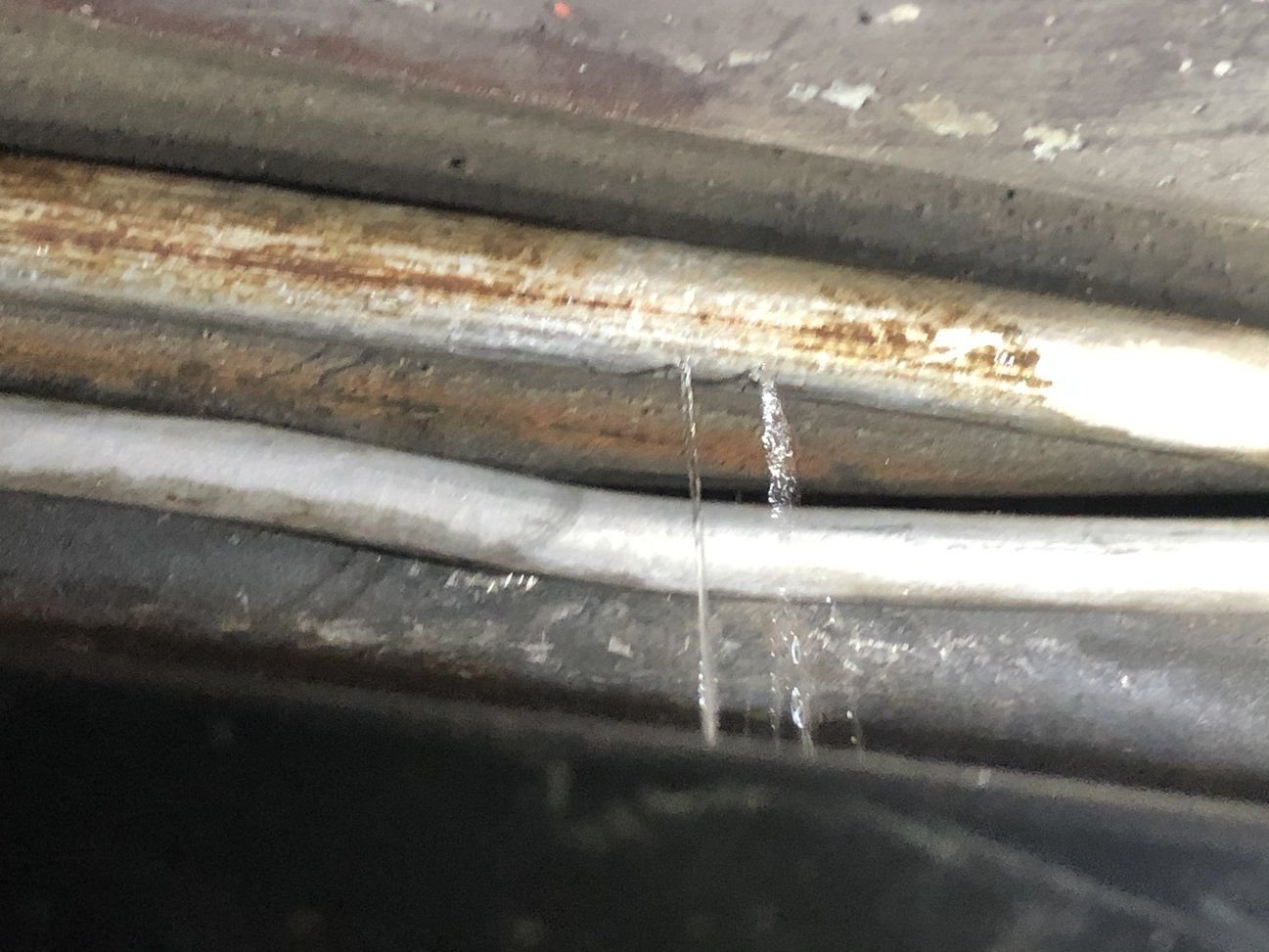

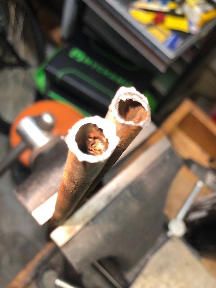

Originally Posted by 7T1vette
If the car is not going to go thru "judging" for originality, why would someone punish themselves trying to separate a 40+ year-old body connection. Odds are that when that separation occurs, there will be "other things" that need to be addressed...possibly because of the mechanical work being done to it. All I can do is advise and shake my head in amazement...
that's what i did..
those steel lines are junk..(old ones)..screwed me all up..
Stuck no run help please on road - Page 7 - CorvetteForum - Chevrolet Corvette Forum Discussion
