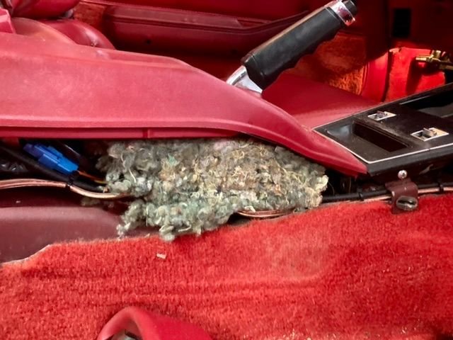

***UPDATE****
I found the nest in the center console on the passenger side. They chewed through a speaker wire and the insulation on the antenna wire.
I’ll be cleaning the area with Mark G’s solution.
I can’t find any but are there any holes under the center console where they could get in?
There’s no detectable small in the car right now but I’m sure I haven’t smelled the last of these rascals. I have a bore scope on order and will be inspecting the duct work as best I can.
On a surprise note. I was tracing the sound system wires to the back and a PO had put a plastic tray in the compartment behind the passenger seat which I always thought was strange. I finally took the time to remove that tray and there it was...the original unused jack, lug wrench and hold down spring. I had bought one on EBay about six months ago.
I’m off to splice wires and scrub the area. I’ll let you know of any major developments.
Thank you to all who helped me out.
The speaker wire is on the bottom and chewed through. The antenna insulation is chewed off to the right.
The nest was on the passenger side only.
