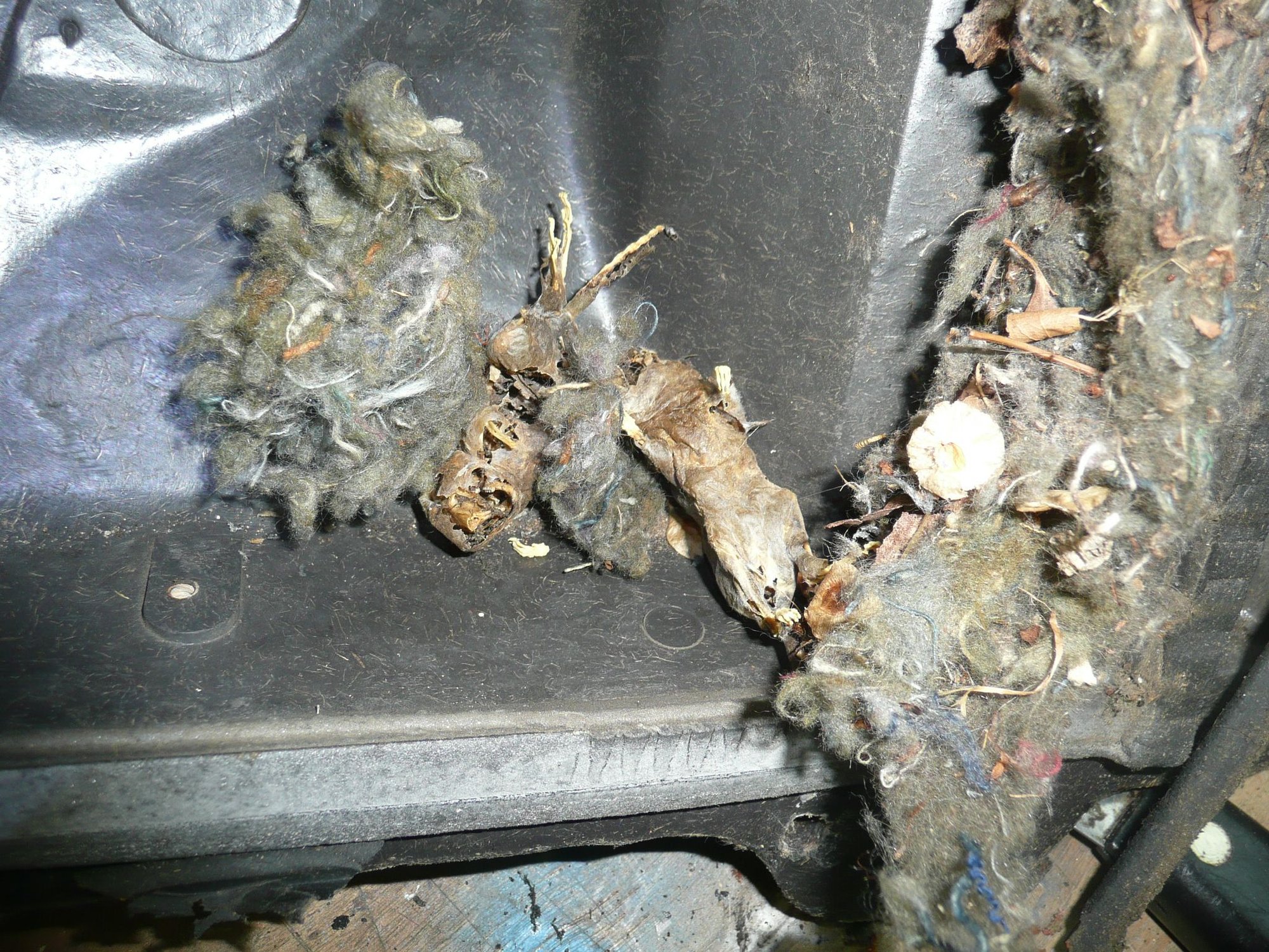

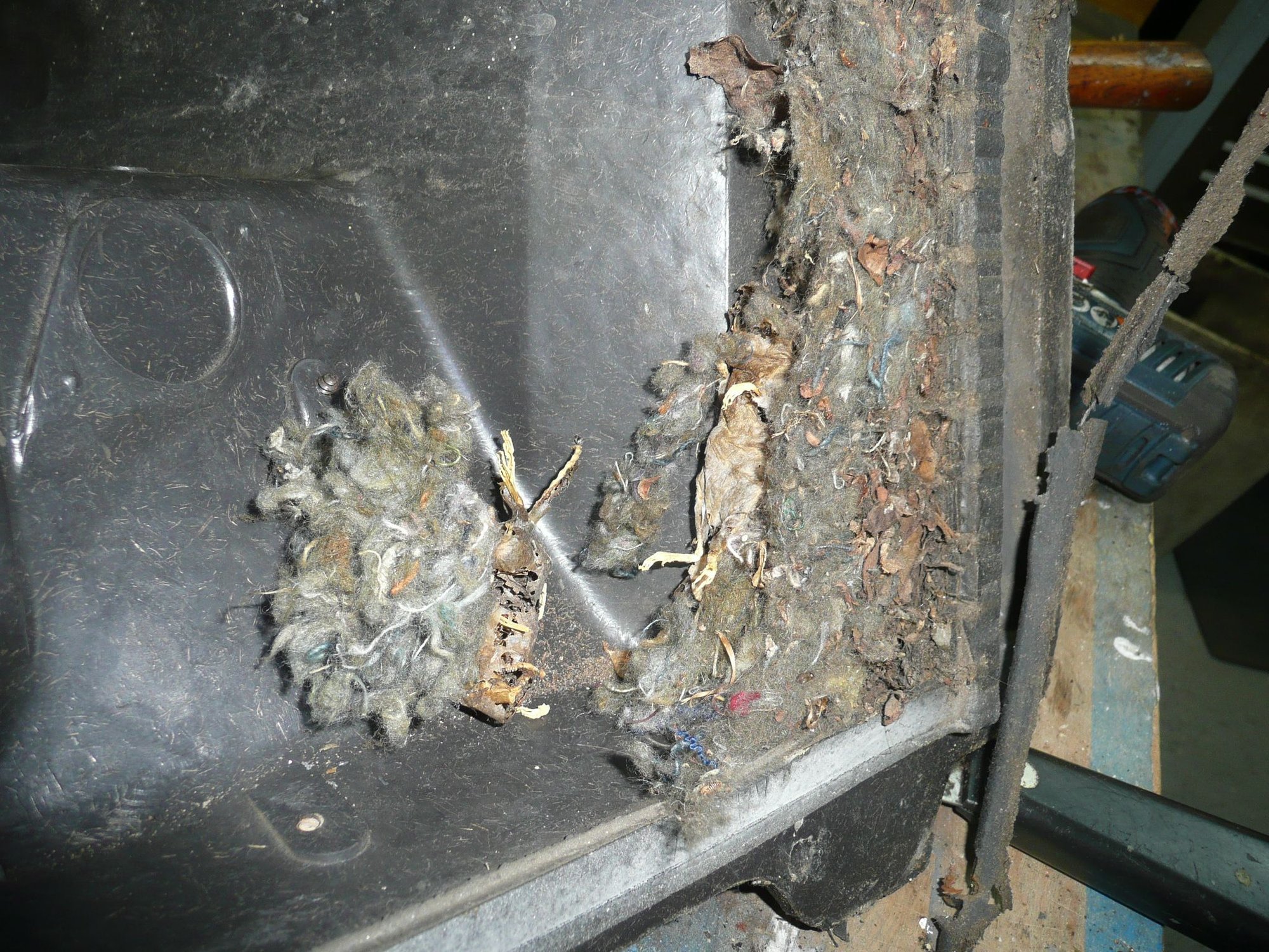

I had one build a nest in the lower seat belt retractor well. didn't know about it. mouse long sence left. but the nest held moisture. I ran a thread about it about 15 years ago. had to weld in a patch panel into the floor.
Just sayin, look everywhere!

I bought an 80 from my neighbor that had sat for 27 years. It has AC....I had to completely remove the entire heating and Ac components enough to vacuum and scrape out all remnants of who knows how many mice....many dead inside the duct work. They even ate at the fan blades and chewed through a couple of the blades. I don't have a lift and I am not a small guy so taking out the blower and all of the other components was the only way I was going to get it done, besides I was not sure all of the vacuum actuated dampers worked...I am now....after laying on my back or reaching over the fender....worst designed car I have ever worked on...looks cool but mice are a bitch

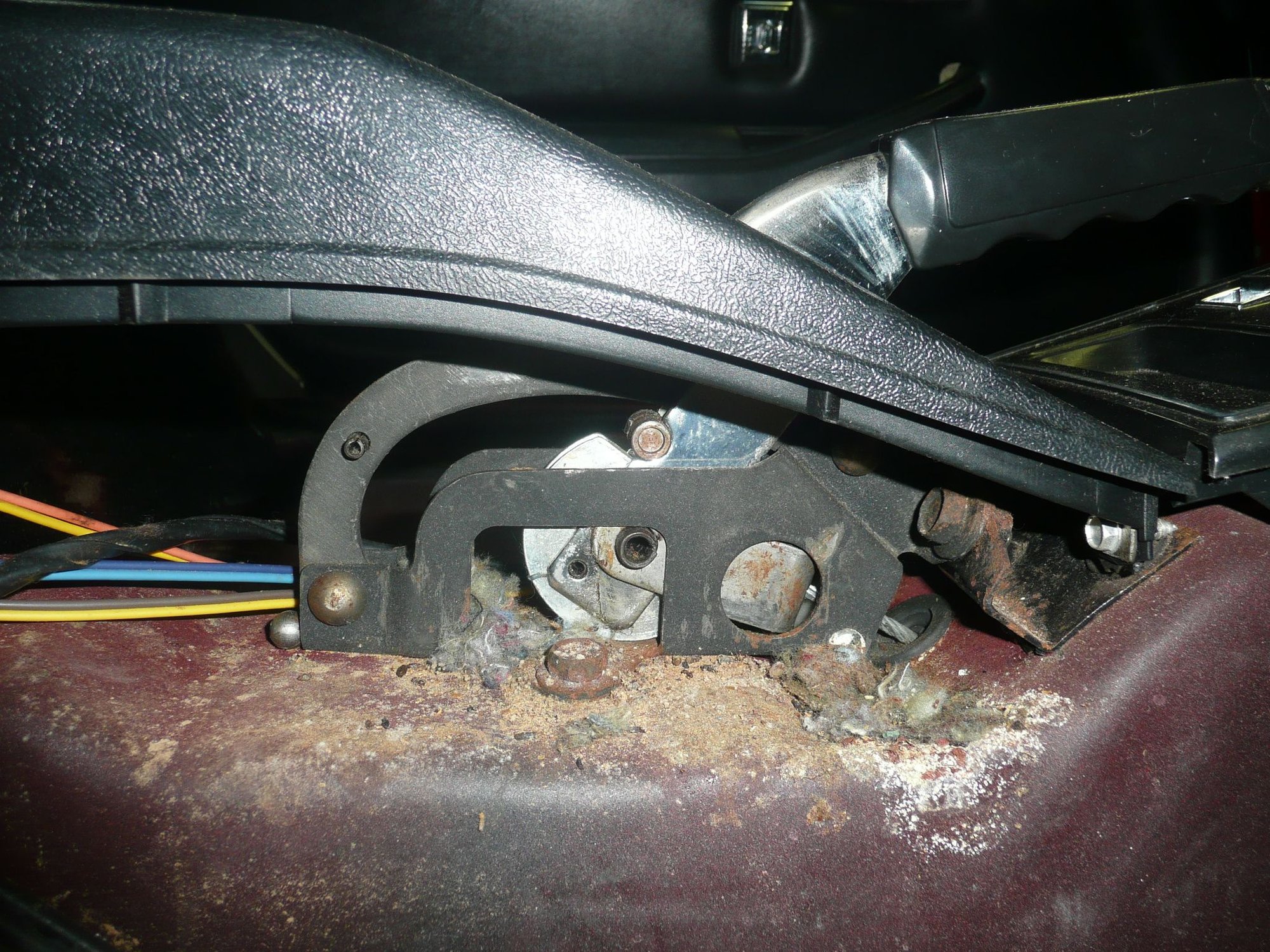

Then the center console was the bathroom where they pee'd. That's where most of the smell came from.
