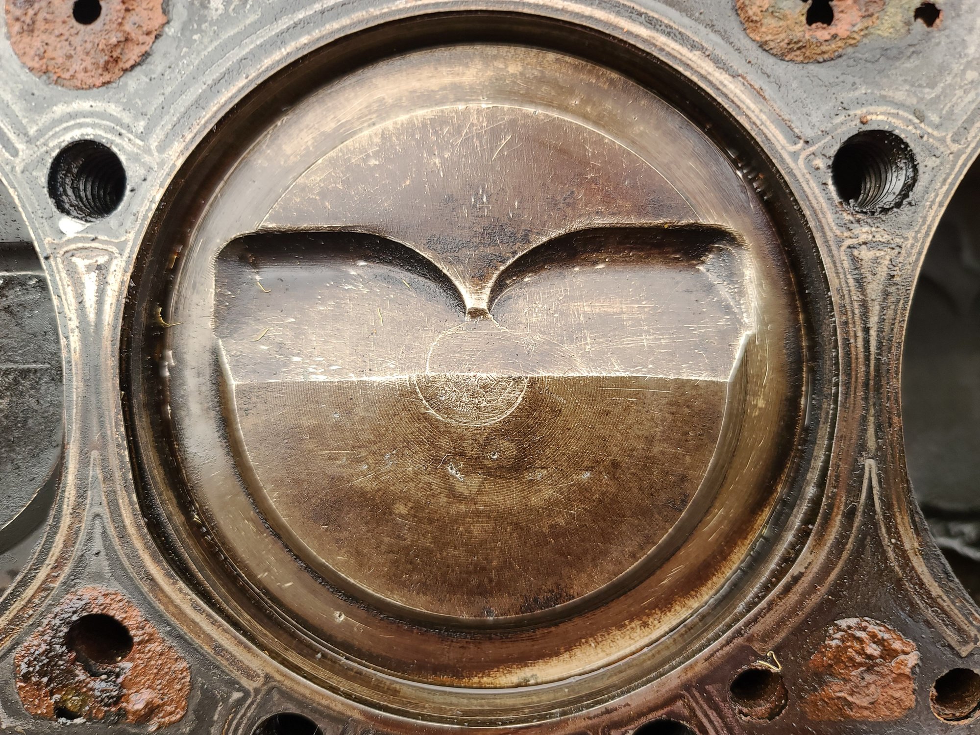

Today I pulled the heads and discovered it is still a standard bore, but 2 holes have had water in them. Looks like it will clean up with a hone. It has the domed pistons ,so I assume it's a real L79.

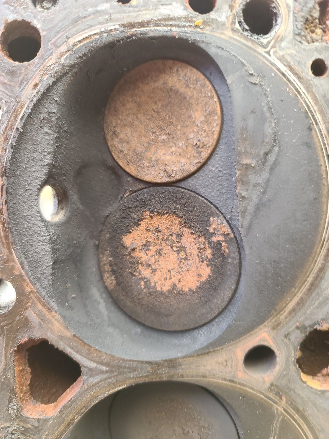

The heads still have me puzzled--they are 3927186 castings, but I can't seem to verify their use on a 68 L79. And, they look like 2.02/1.60 valves in there, yet my research says the big valve heads all had screw in studs and guide plates, which these do not.

I believe that 186 heads had press in studs until 70, then they went to the screw in studs.
I've seen several 186 heads with press in studs.

In my searching, it seems only the 2.02 valved 186s on higher HP cars(like Z28s) had screw-in studs. Not so with the 1.94/1.50 versions like a 327/300.

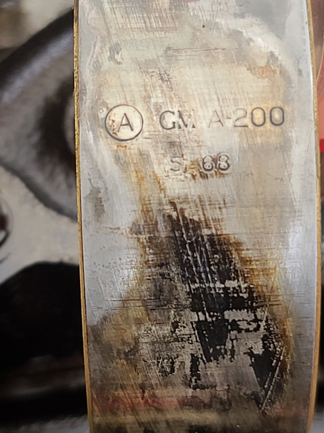

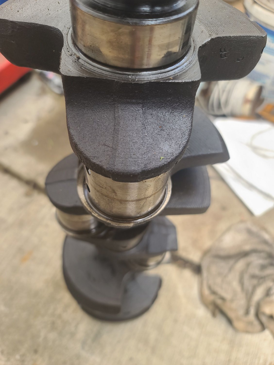

Took the engine apart today--it has the large journal forged 327 crankshaft that some say doesn't exist, f
orged pistons, 151 cam, Standard bore, original, standard size bearings dated May 1968, 186 heads with 2.02 valves...I'm about 99.99999% sure it's a real 327/350 1968 4 speed Corvette L79 engine that has never been apart.
I have a friend going to try a VIN search to see where the car may be. Maybe wrecked? Looking at the outside of the engine, I was thinking it had a million miles of neglect, but inside it's in pretty nice condition. .006" crank end play, .011" between the rod journals--I can't see why it was removed. Timing chain has gobs of slop, but...?
