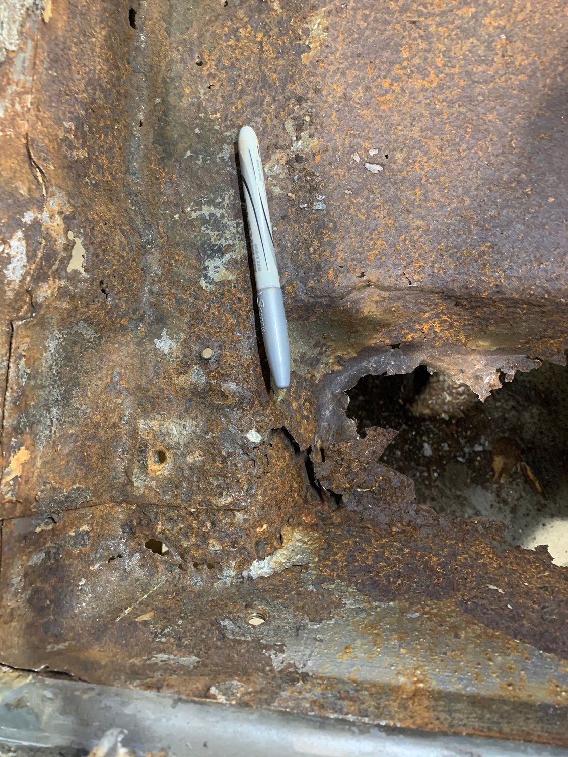

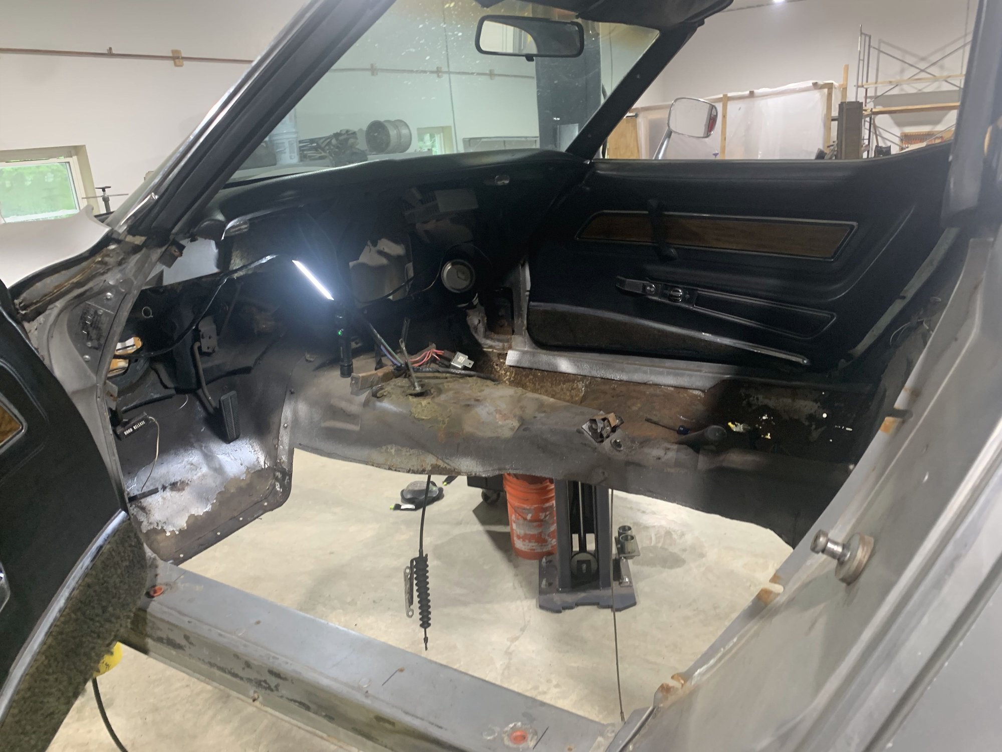

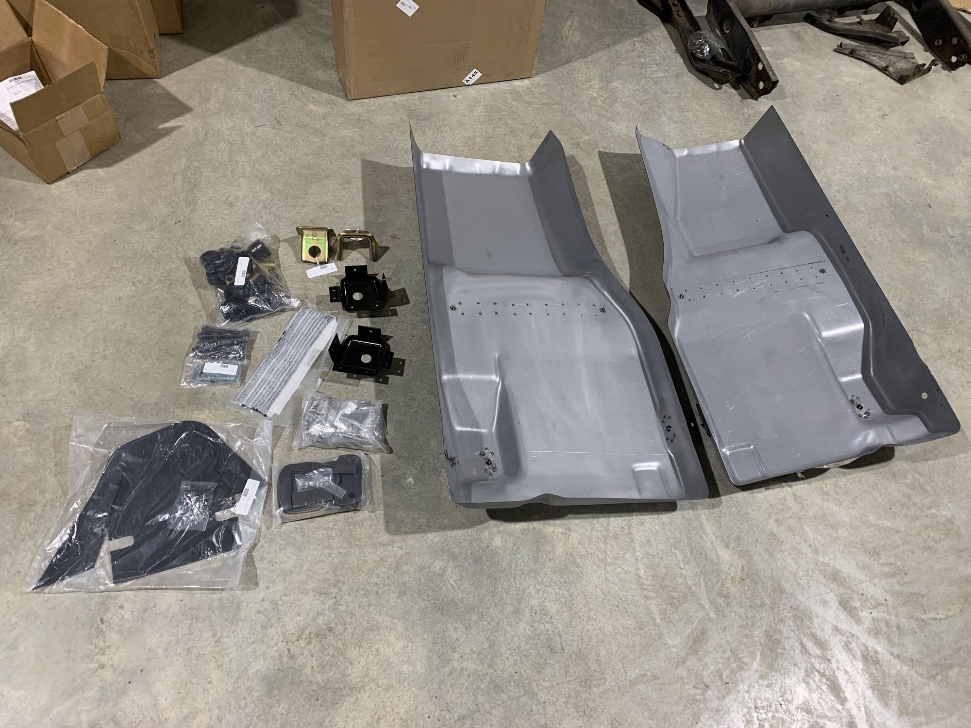

Started on the floor pans and found they were worse than I had originally thought. Guess I will be buying floor pans. Have a question about the fiberglass door sill. I don’t see a way to remove it so thinking I should cut it in the corner, I am pointing to in the picture, the length of the floor pan. I believe this is covered by carpet anyway. Thoughts?

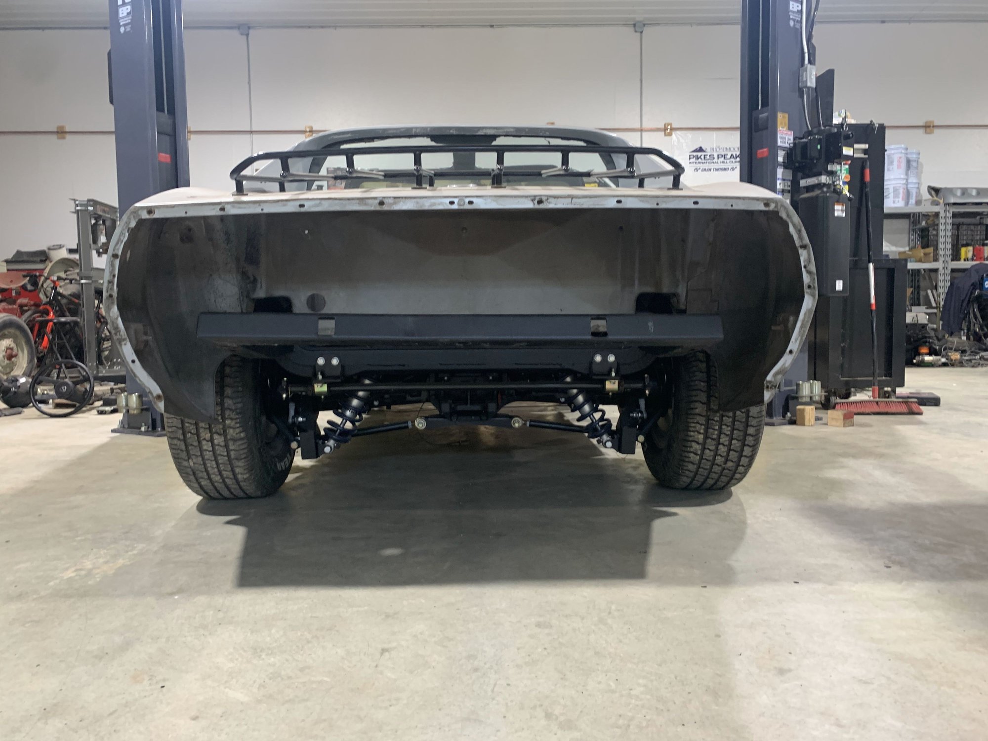

Removed all the metal brackets from the nose. Going to get them cleaned up and painted.

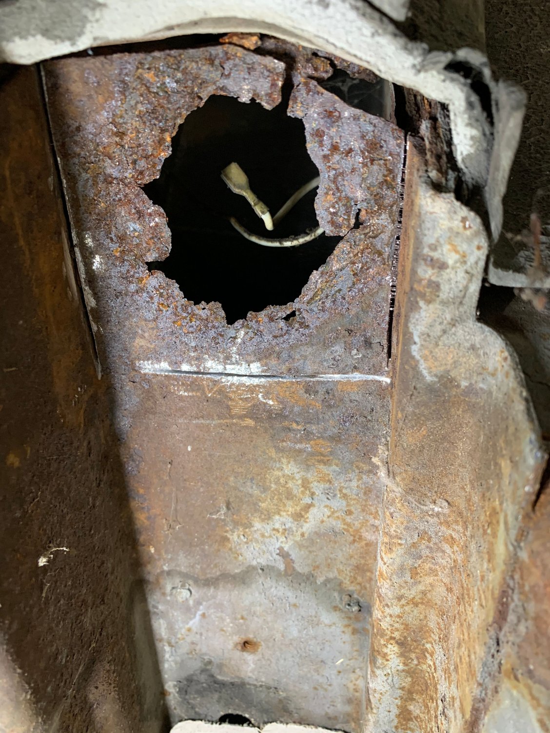

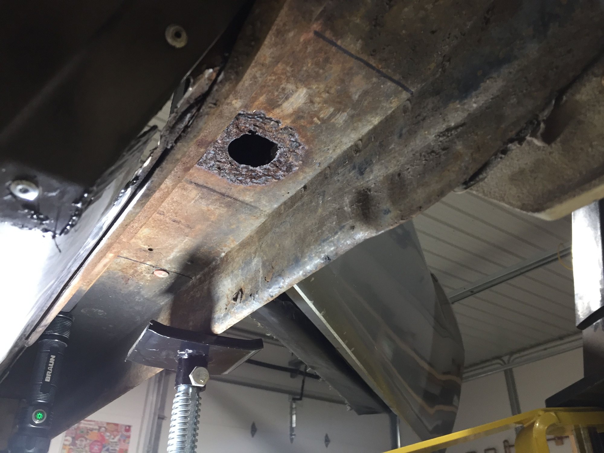

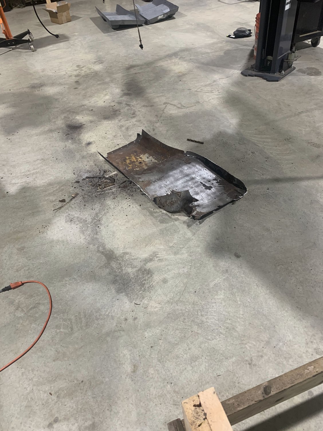

Bad spot cut out and replacement piece made. Will get it welded in tomorrow.

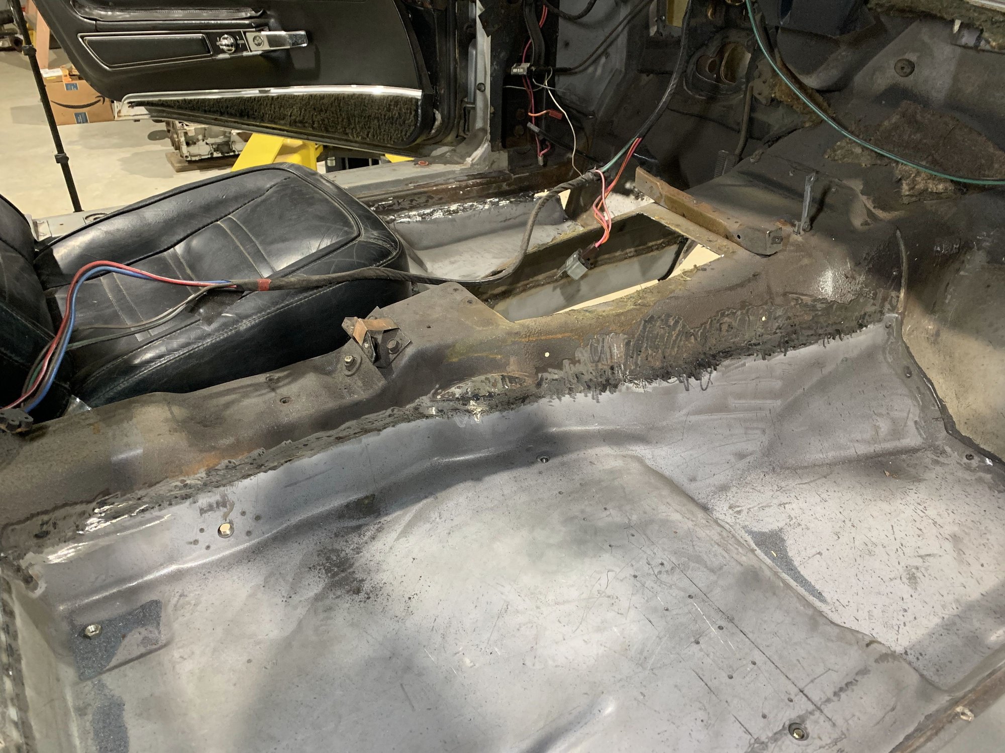

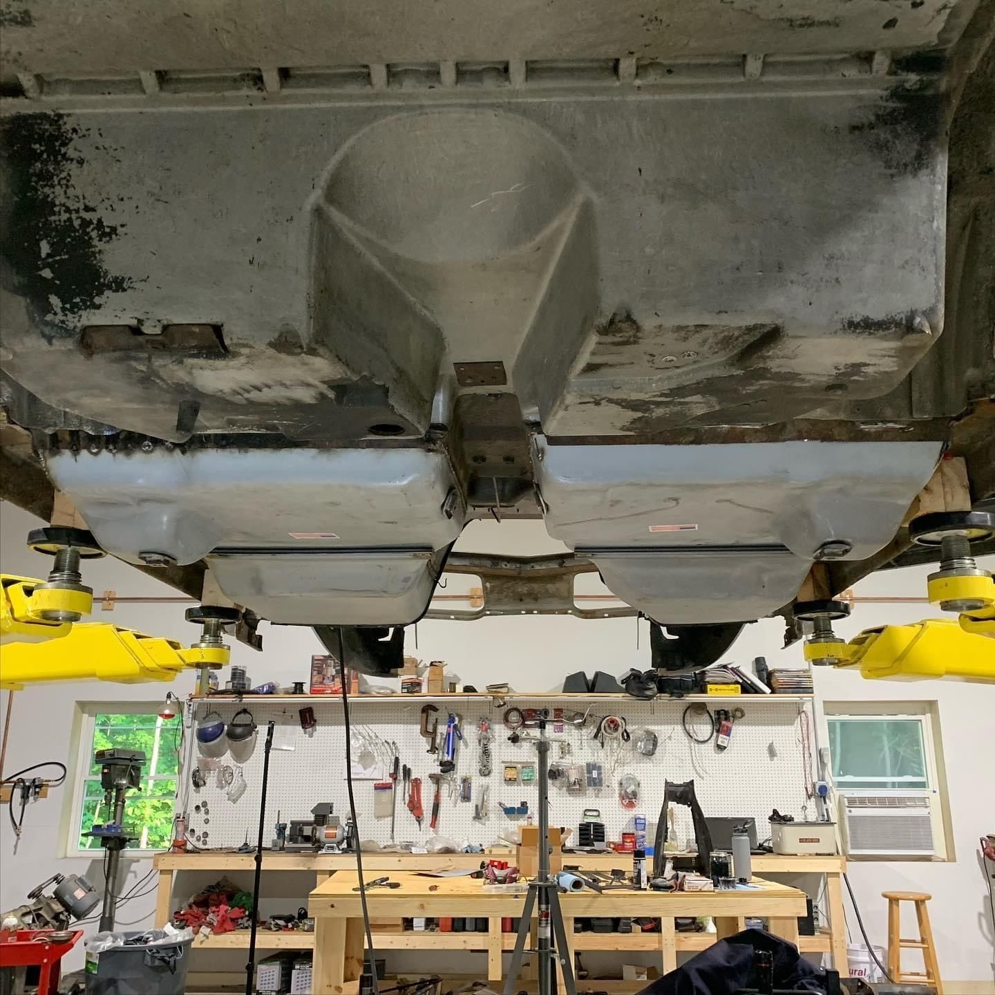

Making progress. Finished welding in and grinding the birdcage body mount. Working on floor pans now. I'll be glad when the metal work is over!

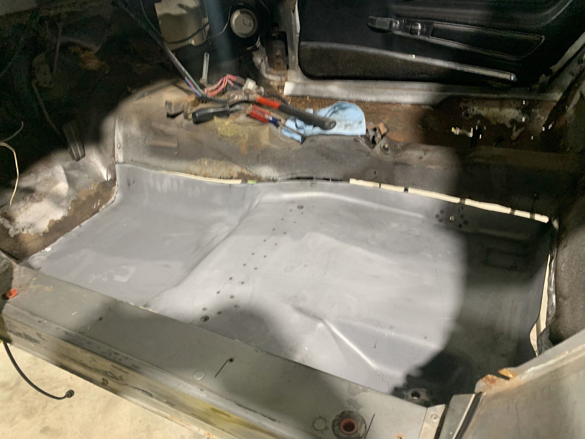

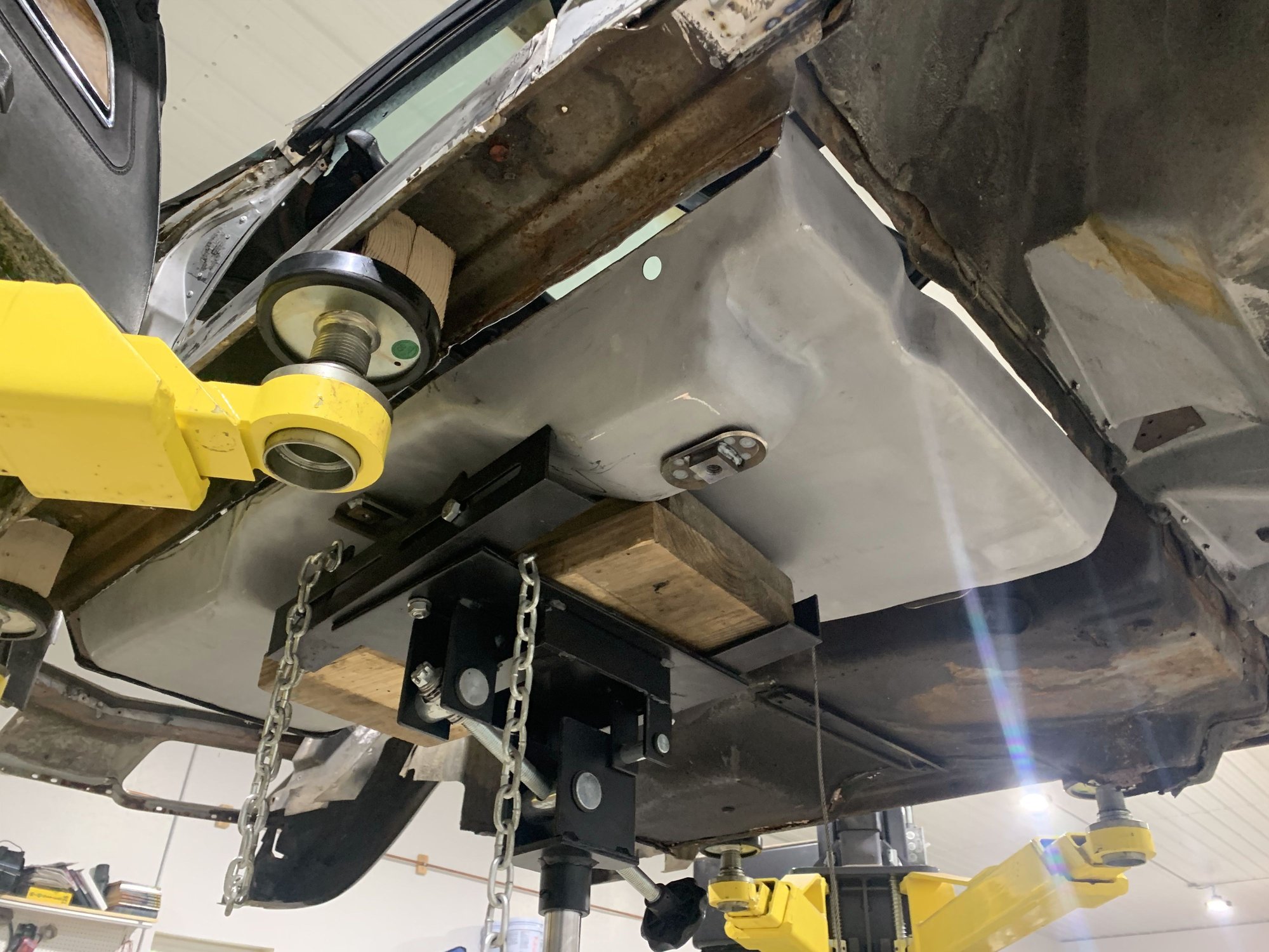

Part 2 video is up. The floor pans are mostly installed.

I'll be replacing my floorboards the same as you.
Your photos and videos help a lot and provide a better understanding what I'll be facing soon. Thanks for taking the time to post these updates.

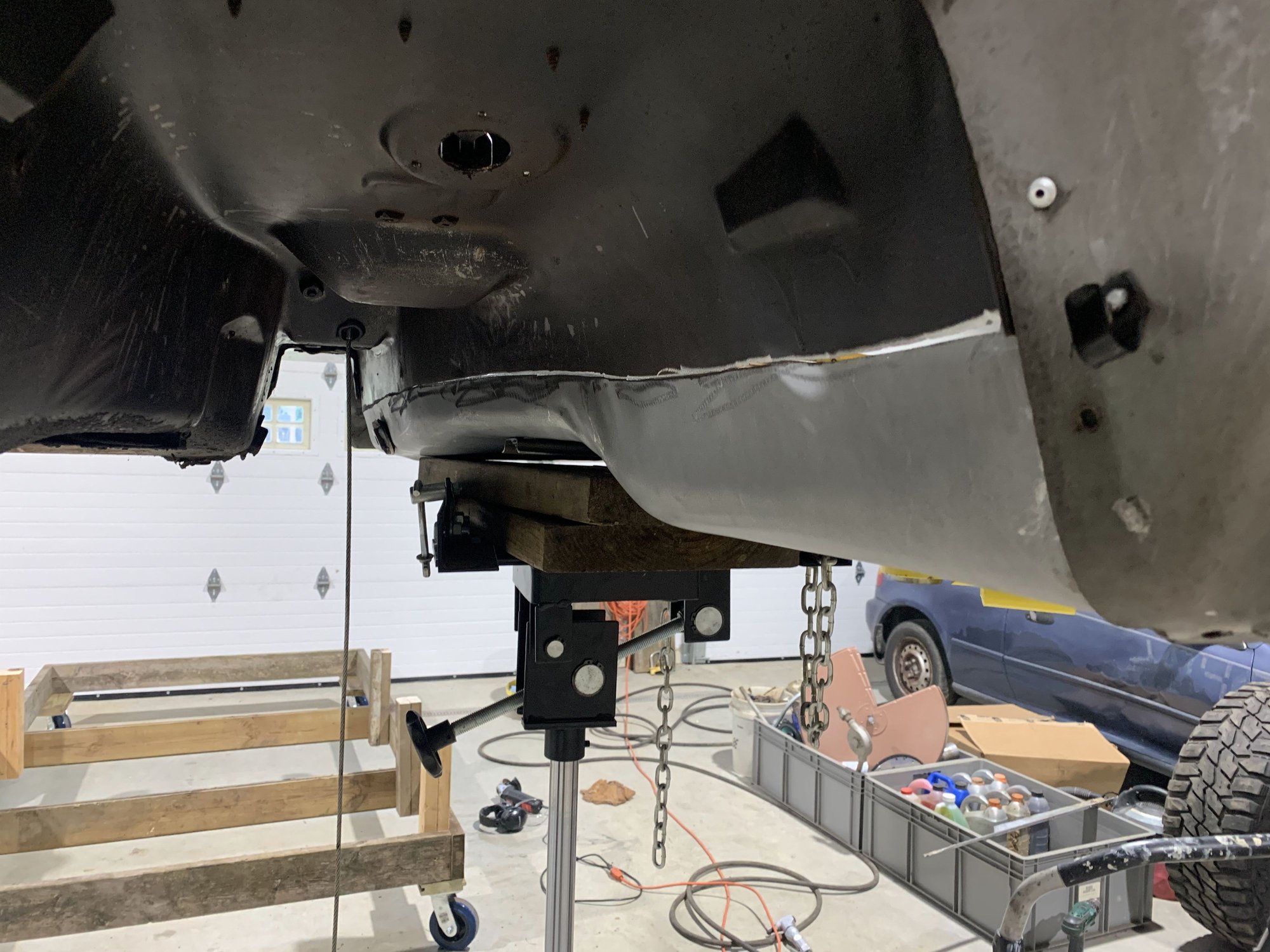

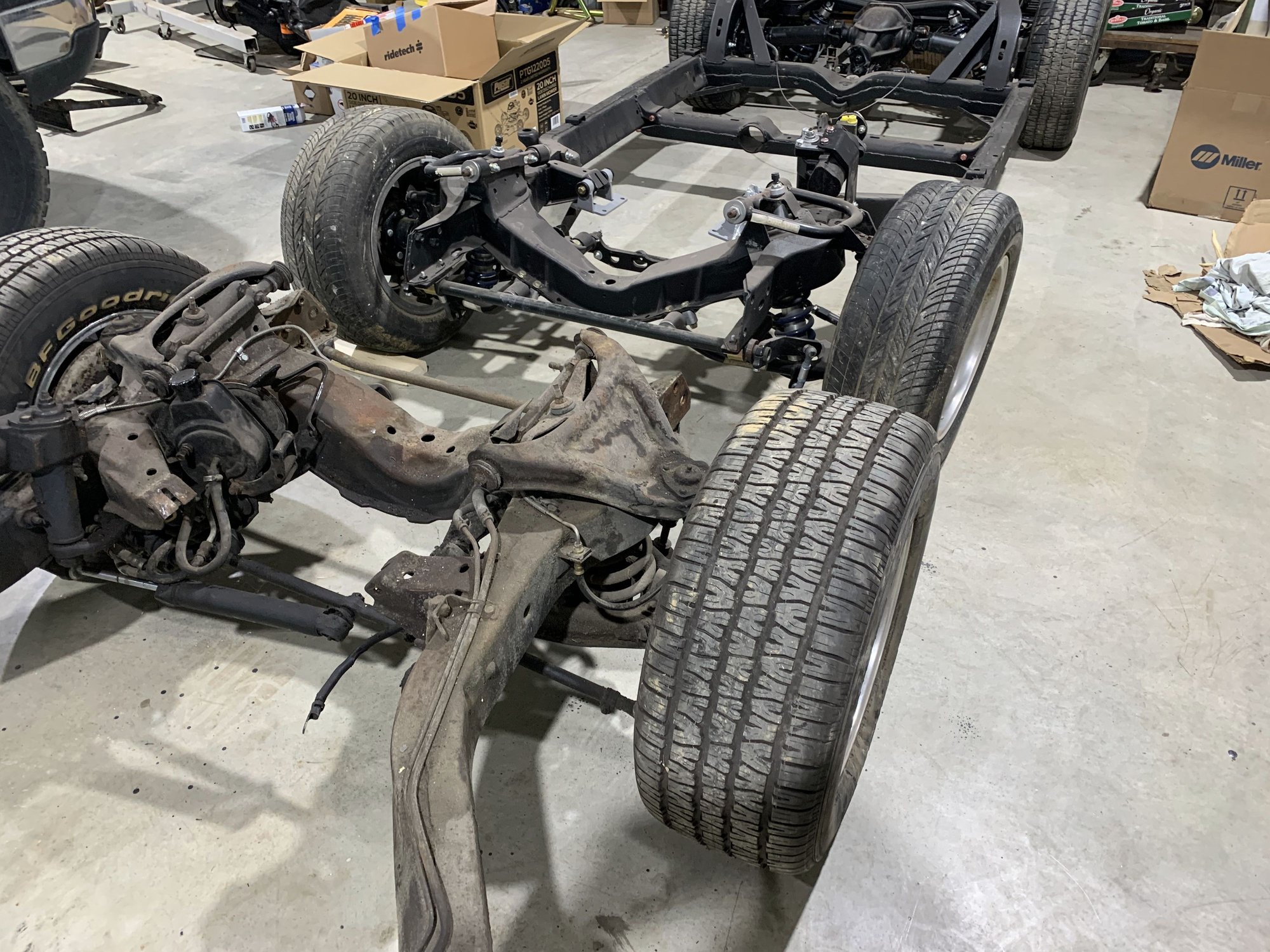

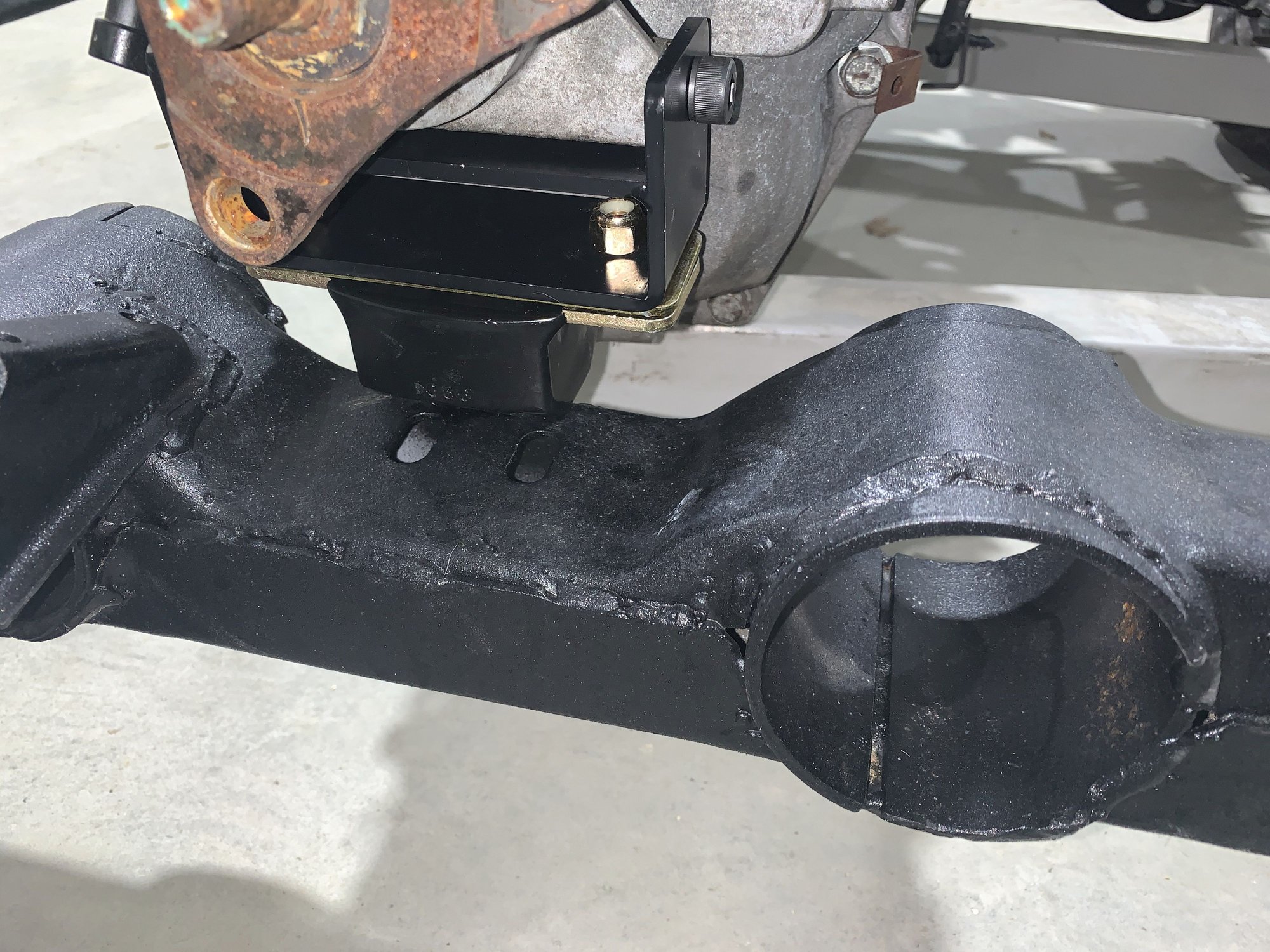

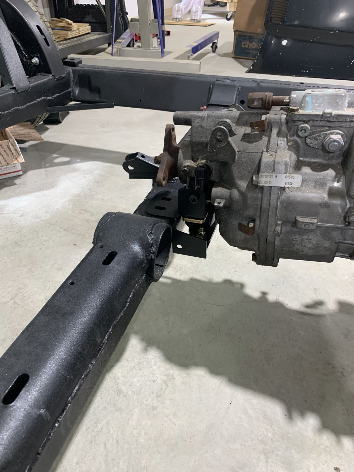

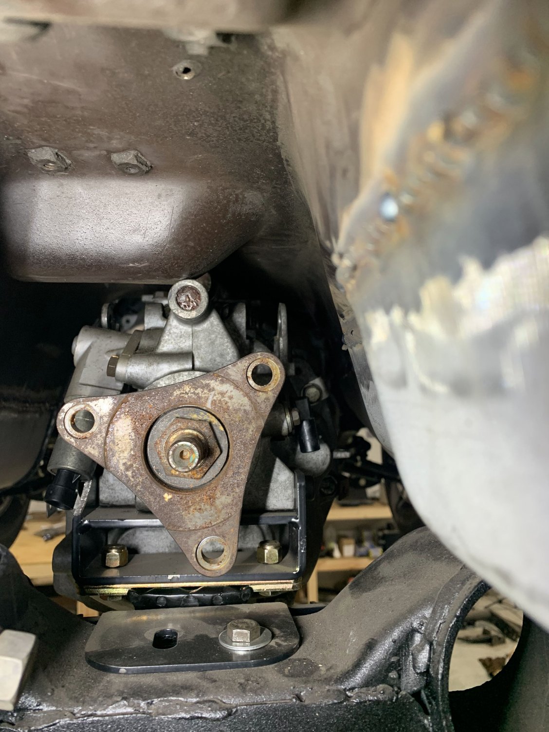

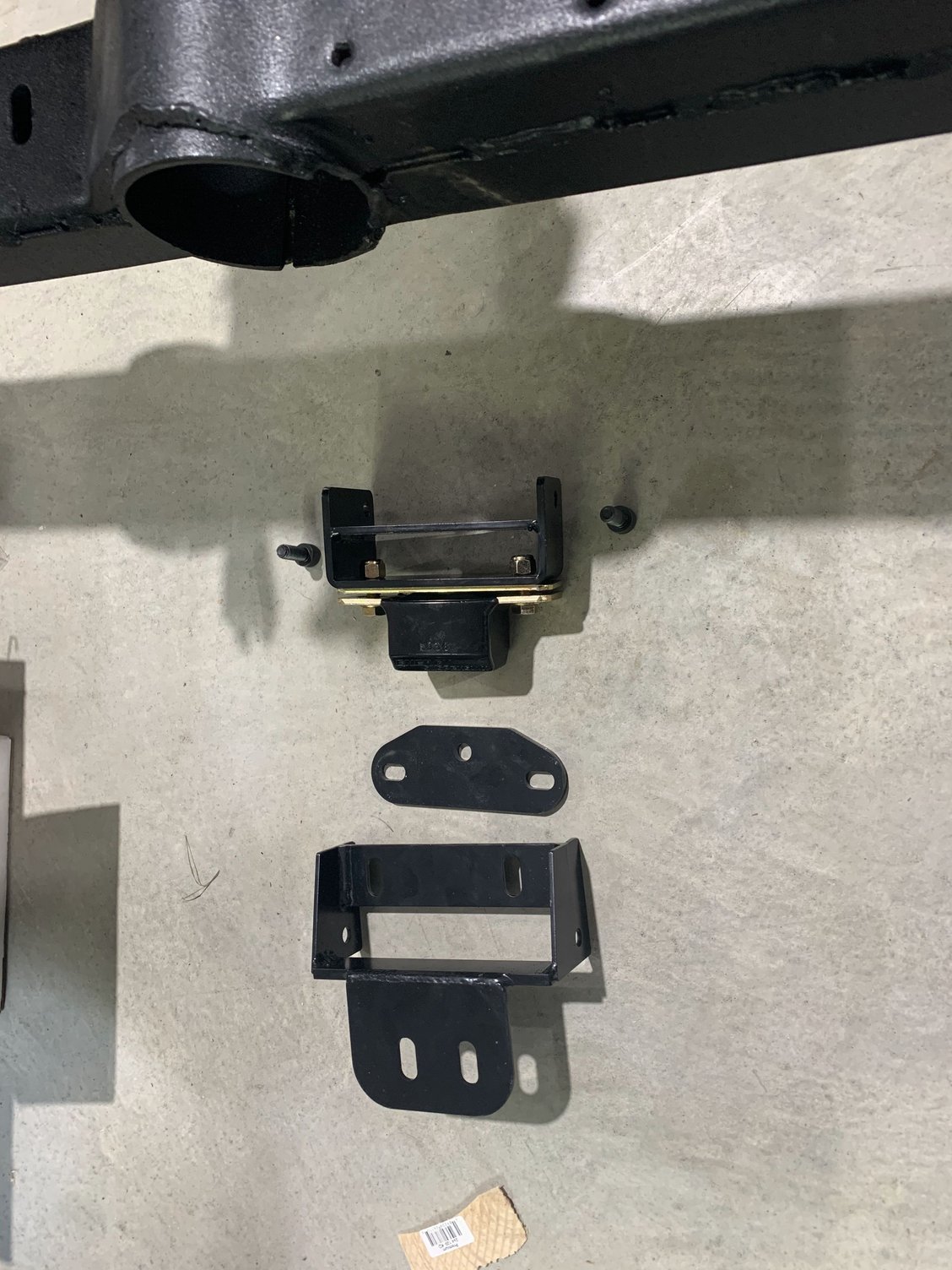

I purchased the TR6060 and LS swap engine mounts from BRP Hotrods (http://www.brphotrods.com/products/6...tte/index.html). To fit a TR6060 into a C3 corvette you have to move the transmission cross member back 2". Also, you need to get the tail of the transmission down to get the driveshaft angle.
This picture shows how the mount lines up before moving the cross member.
This mount lowers the transmission mount down in front of the cross member.
The automatic cars came with a removable cross member. I simply ground out the welds for the upper mounts, moved them back 2", and welded them back in. On the bottom I drilled new holes and swaged in rivnuts. If you do not have a rivnut tool, you need one! This is the one I bought:
Amazon Amazon

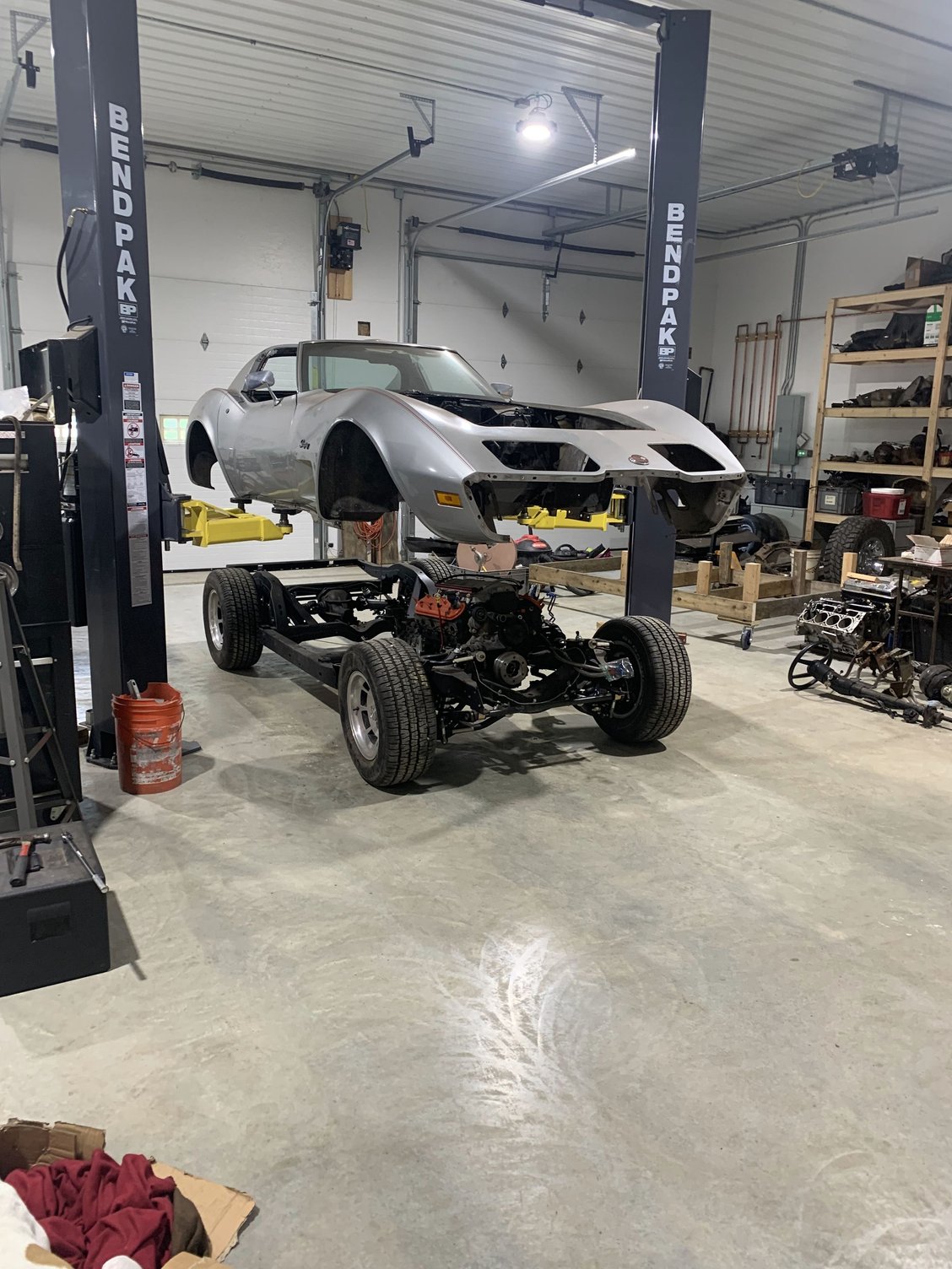

First time this body have seen this chassis.
I think it fits well.
Here you can see where the TR6060 interferes with the automatic shifter pocket. No big deal, just cut it out.
I cut out where the TR6060 interferes with the tunnel. It was very little interference. You can see how it fits in the video. I didn't get any pictures. The plan is to build a custom shifter mount and I will make a plate that matches to fill that hole. That will happen after I have seats in the car.
Found the drivers side front mount was a little too thin for my liking. Cut it out and welded in a new piece.
