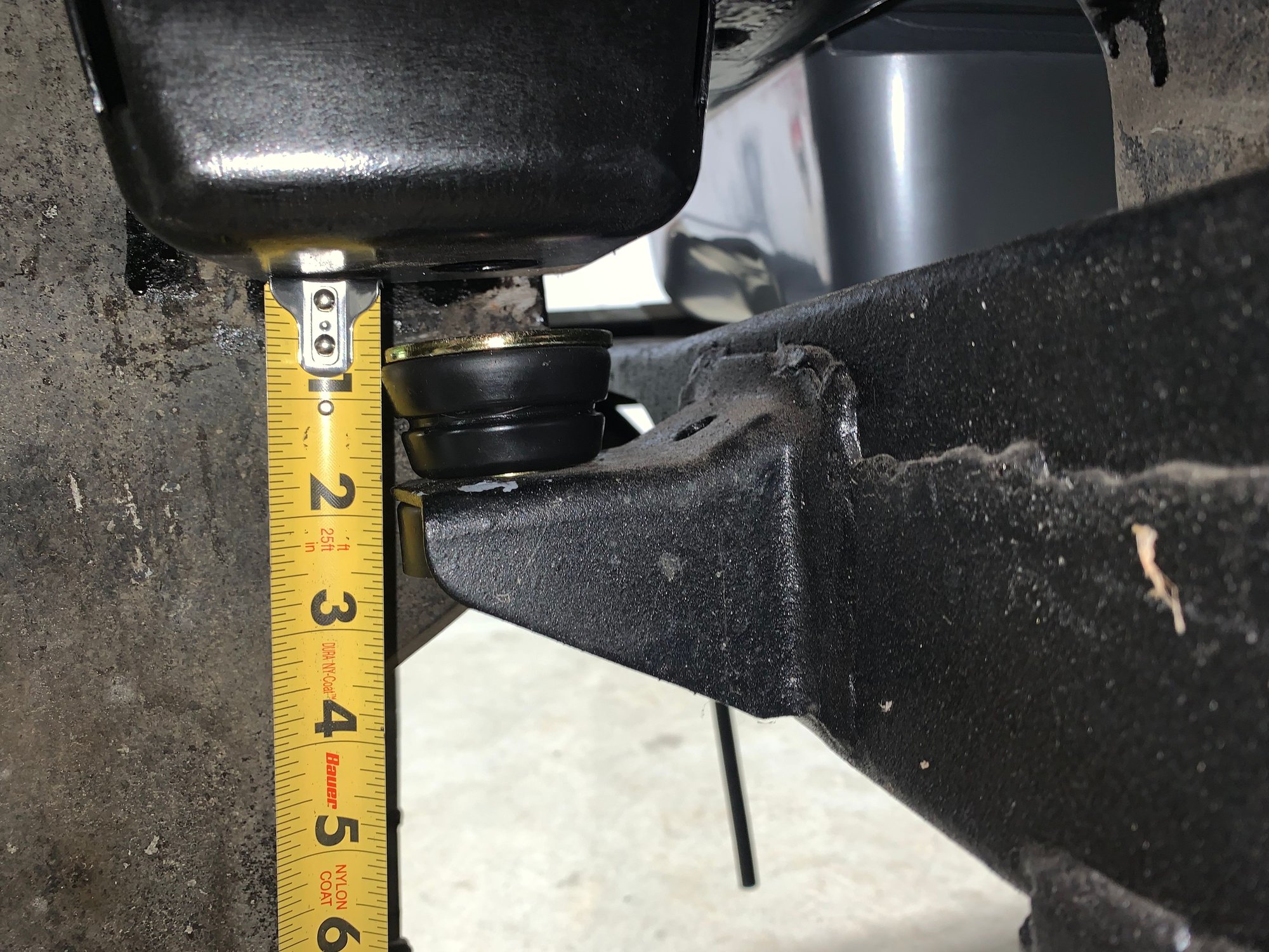

Got the chassis back from the body shop. They said it was pretty twisted up but it wasn’t too hard to get it back within specs. I have put the body back on and everything looks straight now! I do still have a gap at the #4 body mounts. I have shimmed the forward three mounts until the body is sitting solid (it was rocking without shins) and the door gaps look decent when torqued. There is about a 5/8” gap at the #4 mounts. Estimating about 3/4” considering the mount will compress about 1/4”.
At this point the only thing I can think to do is add a spacer to fill the gap. I have an old set of solid mounts from an early C3 and two of those stacked together are right at 3/4”. It appears the bolts are long enough too.
I would appreciate your thoughts.

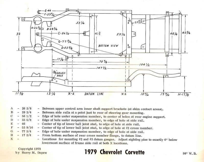

You still have a 1-3/4" gap between the frame and the body.
That seems like too much to me. My 72 solid mounts are not very thick, maybe only 1/2" or 3/4". IMO you are still an inch low in the rear section. The curve at the rear upright is relatively weak/highly stressed.
Did you give the frame shop one of the C3 frame dimension drawings?
If not they may have just leveled the rear section left/right and not front/rear.
My frame shop did not even have dimensions in their expensive frame machine database for that old of a car.
I would measure it yourself to confirm, and then go talk to them.

But you are looking for a huge 1-1/2" drop. That should be easy to measure in a garage.
Base you "datam" line off the #1,2,3,body mounts. I use a 5 or 6' ft long piece of 1" square aluminum from Home Depot to measure the floor and other uses. With a level on top.
