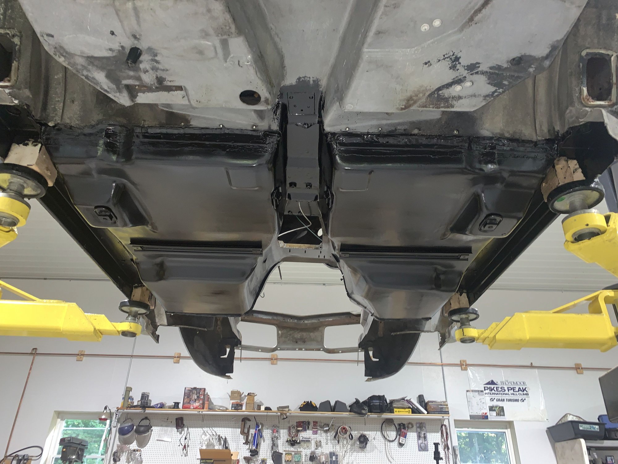

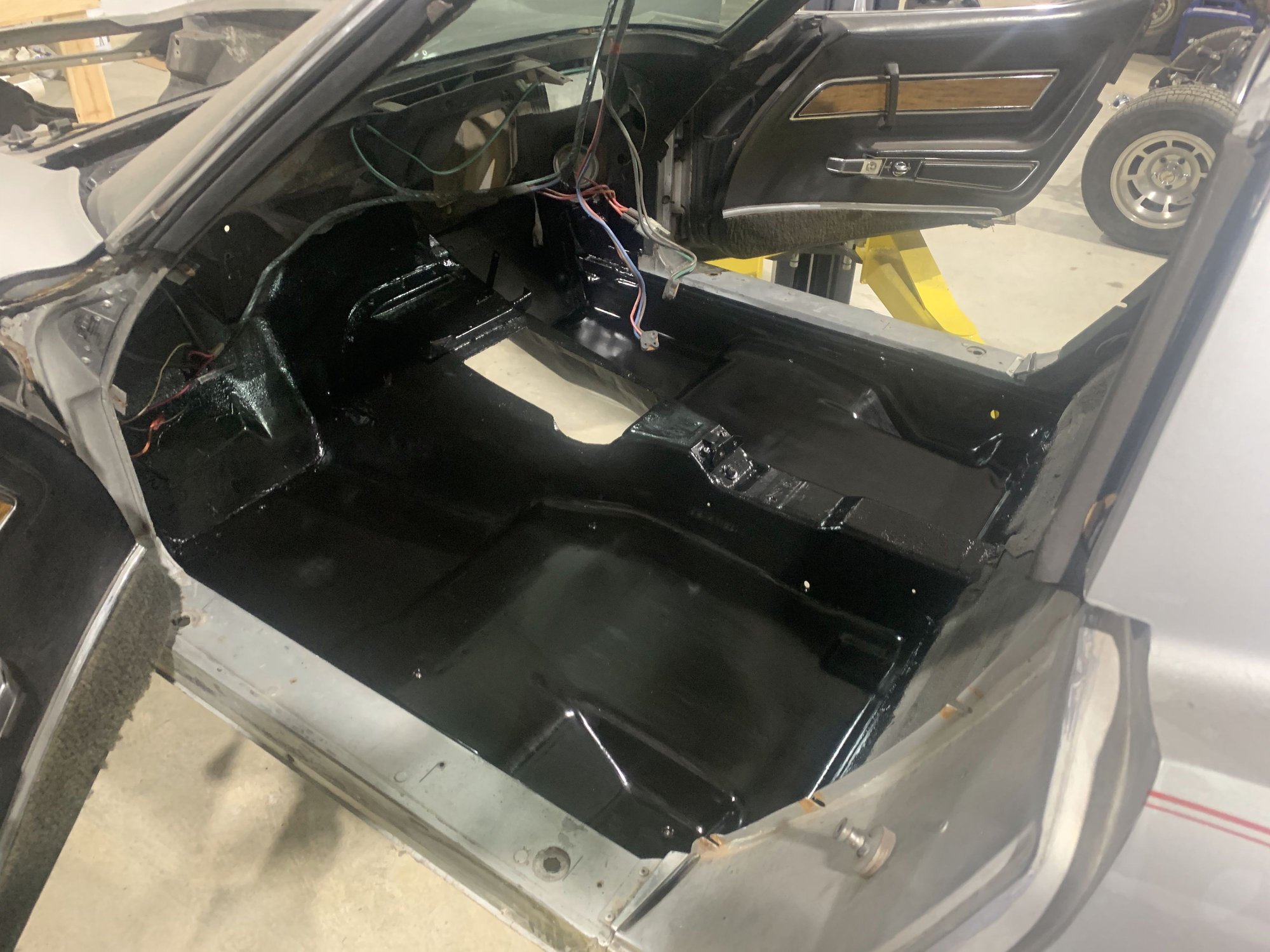

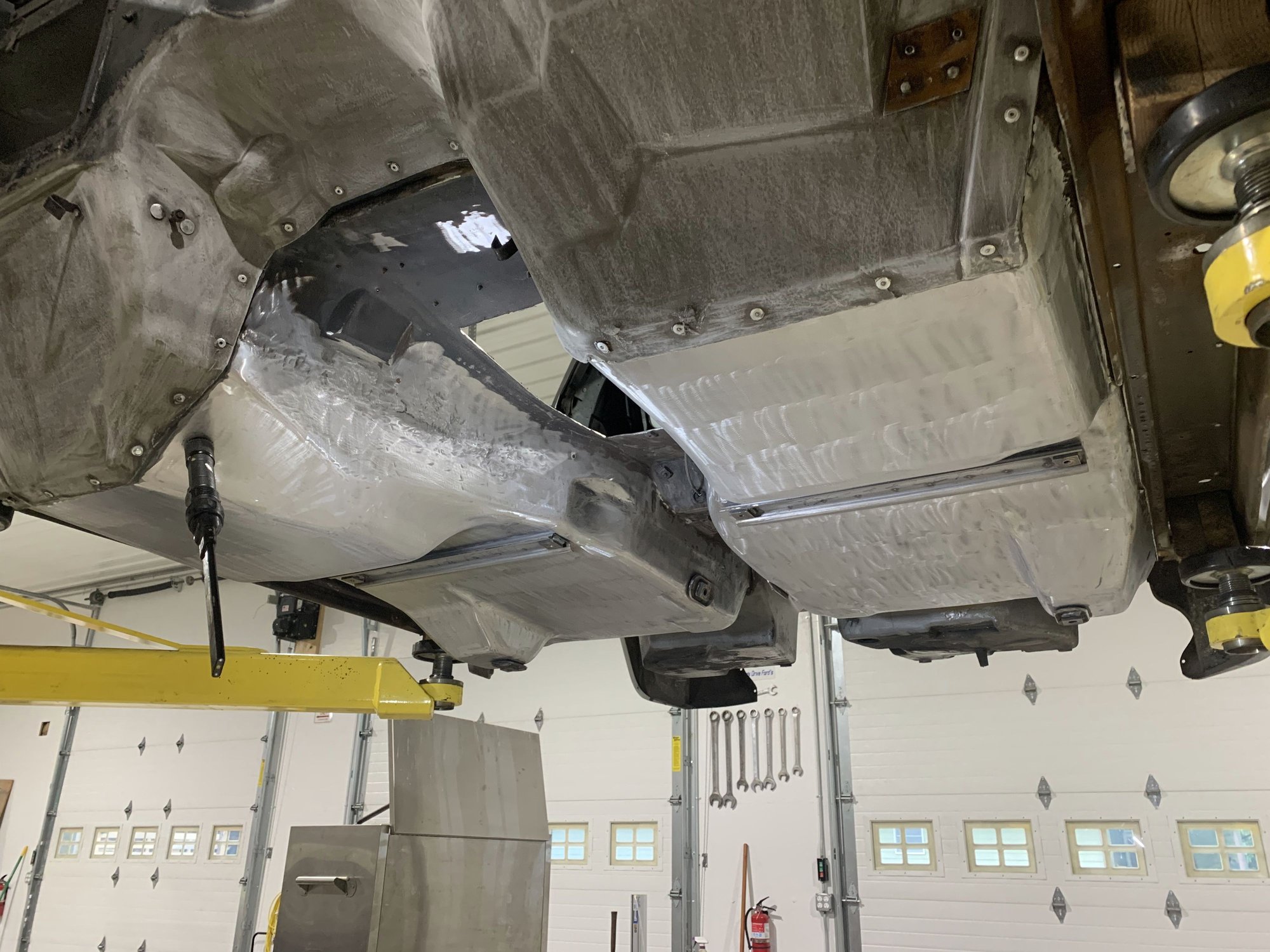

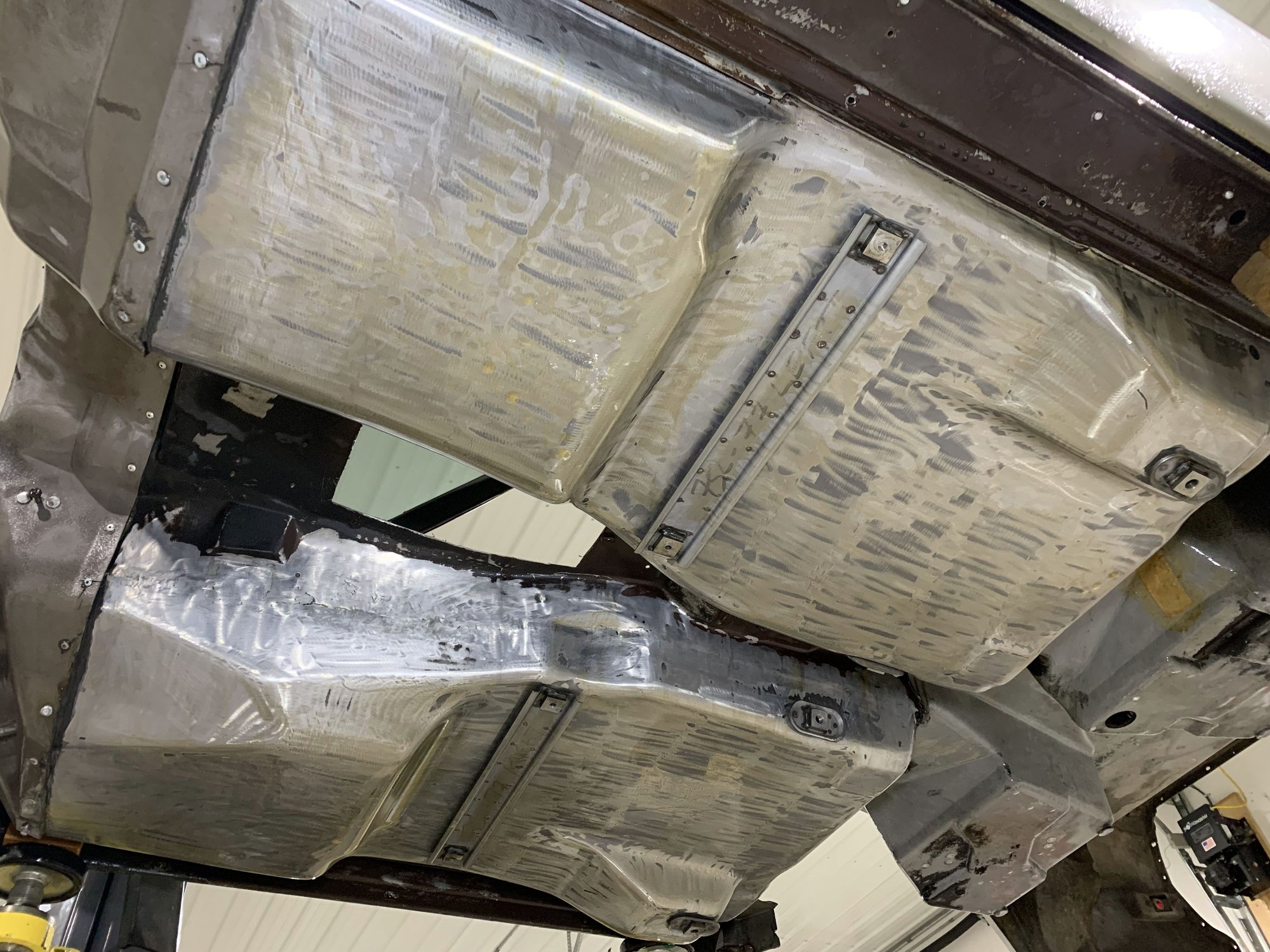

Made good progress on the floor pans.
I removed the gray coating they come with.
What they looked like after POR-15 cleaner degreaser and metal etch.
Final coating complete on underside of floor pans.
Treated and coated the inside of the floor pans as well.

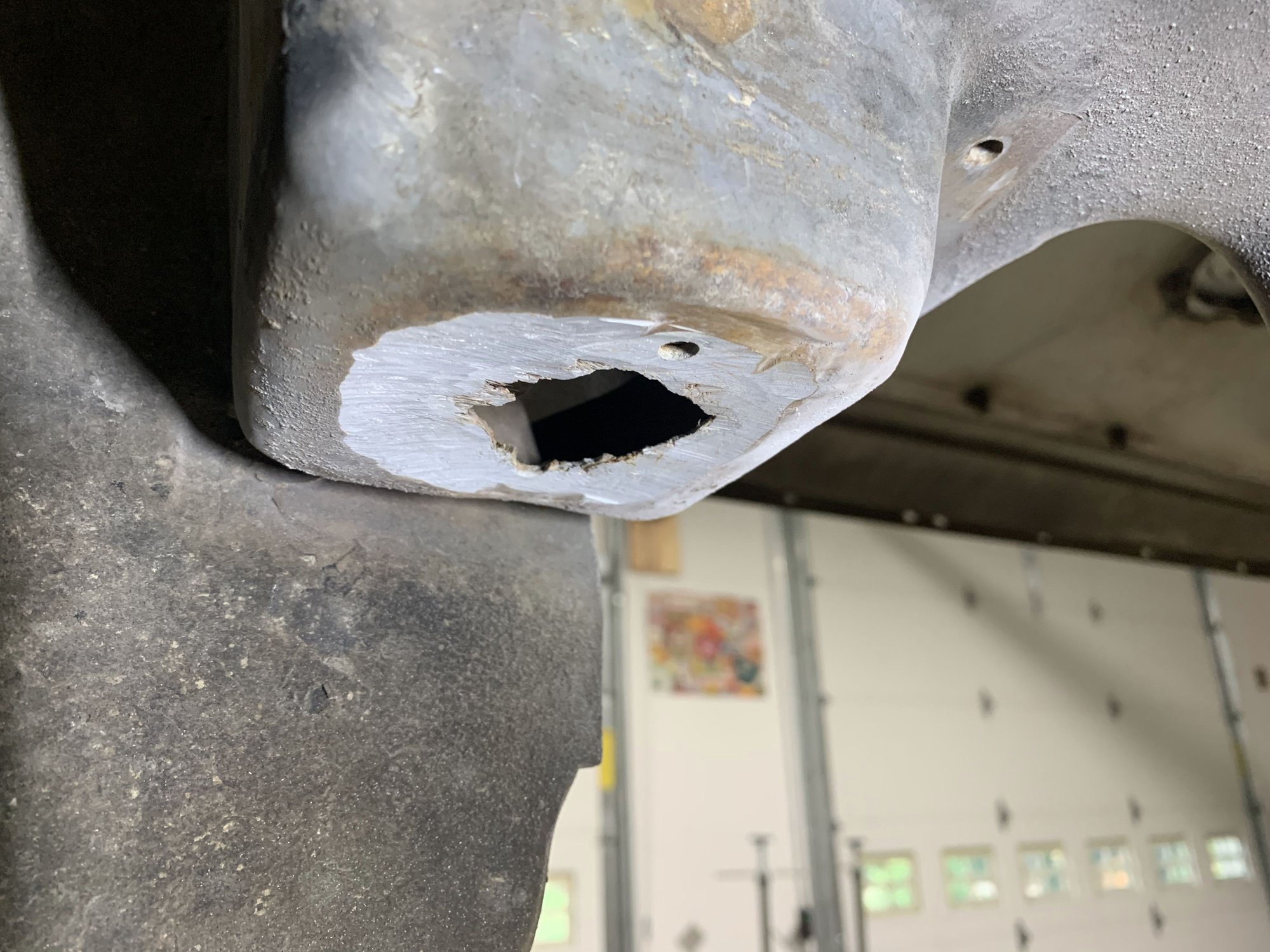

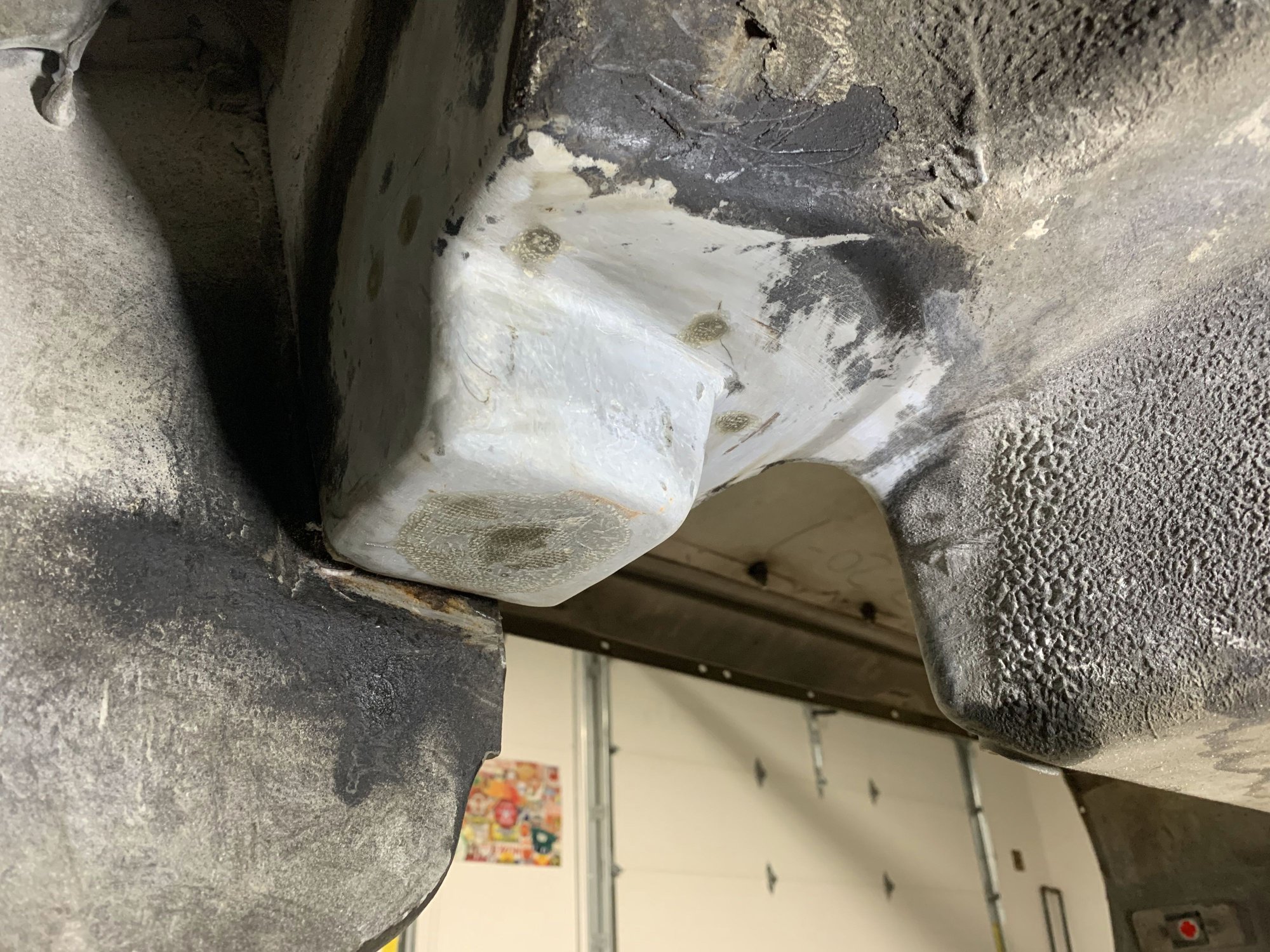

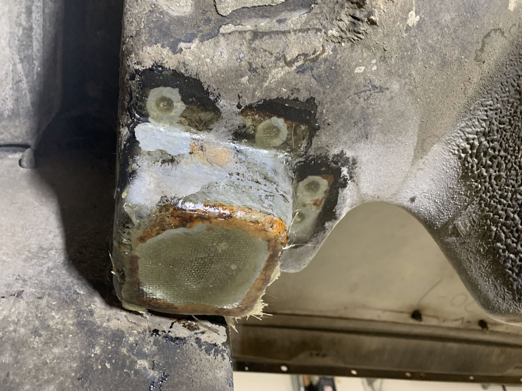

Also did some fiberglass work on the rear body mounts.

Next video is up. I finished the rear body mount repairs as well.

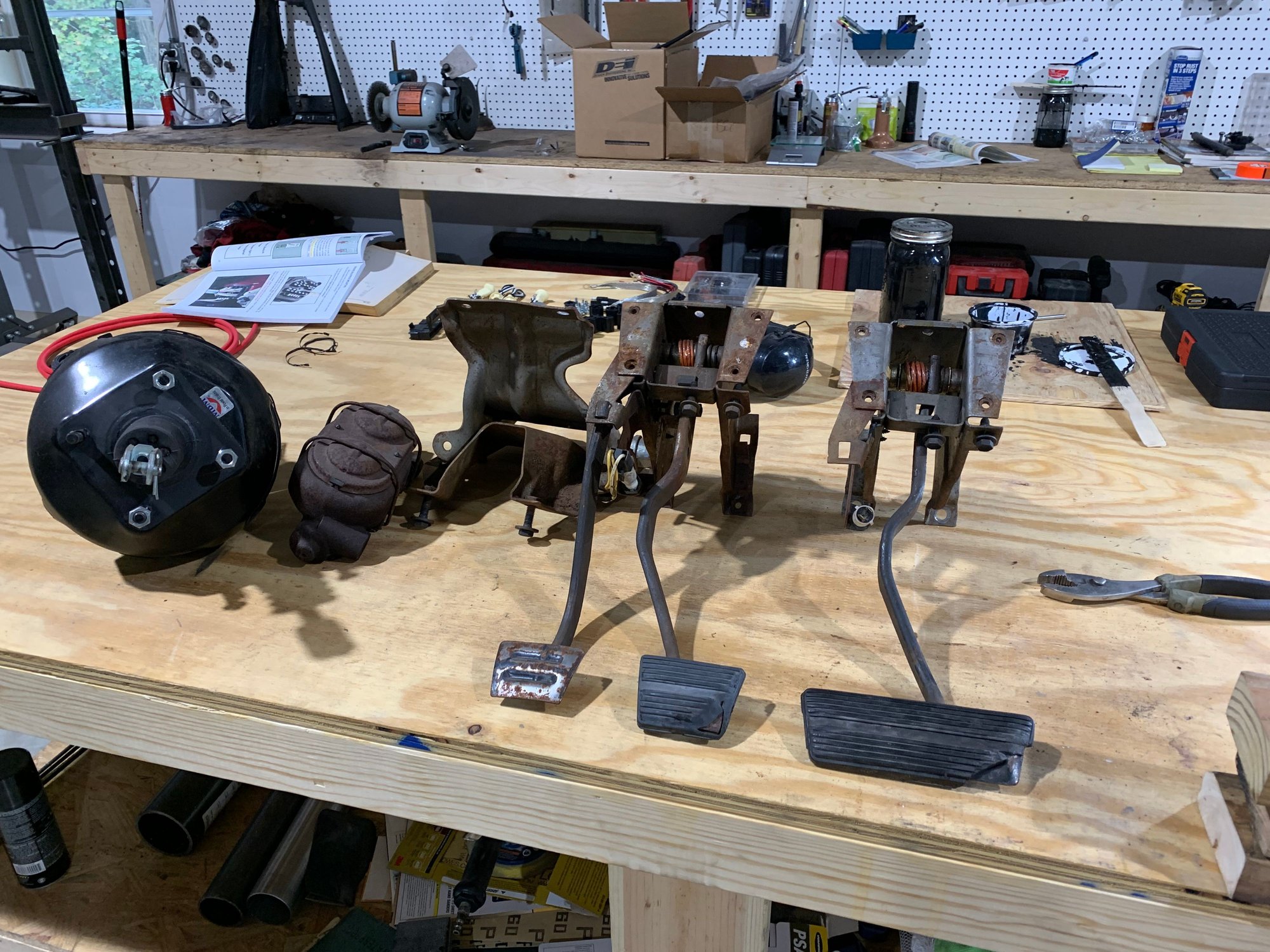

Started installing the wiring. Also, working on converting from auto and manual pedal assembly.

Next video is up. Ls water pump modification, auto to manual pedal conversion, and wiring.

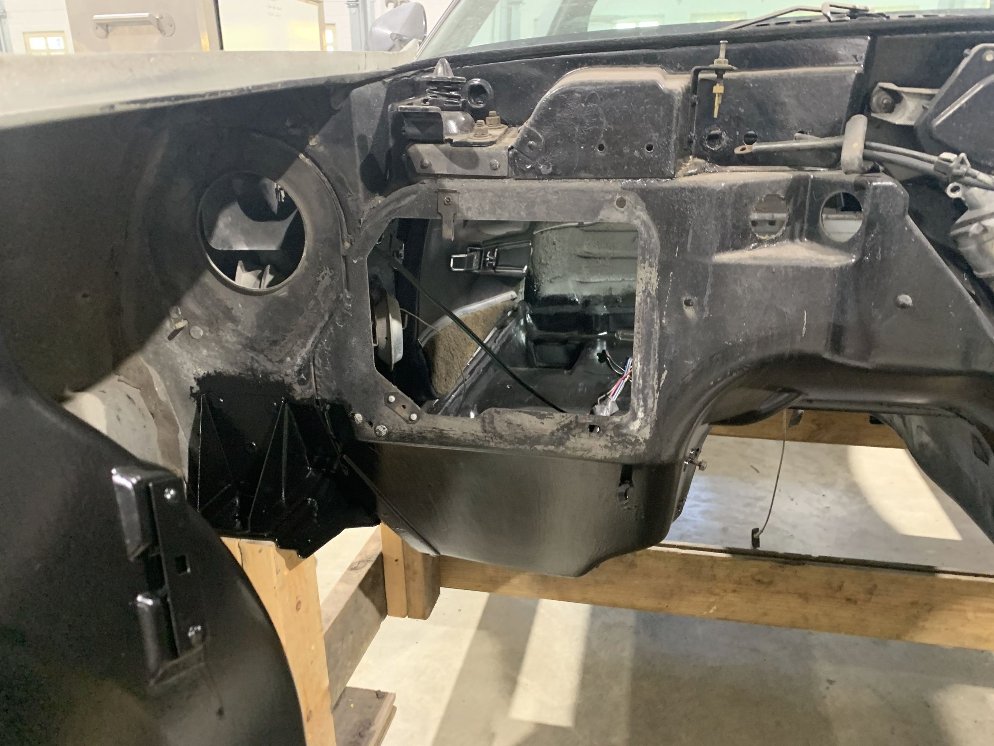

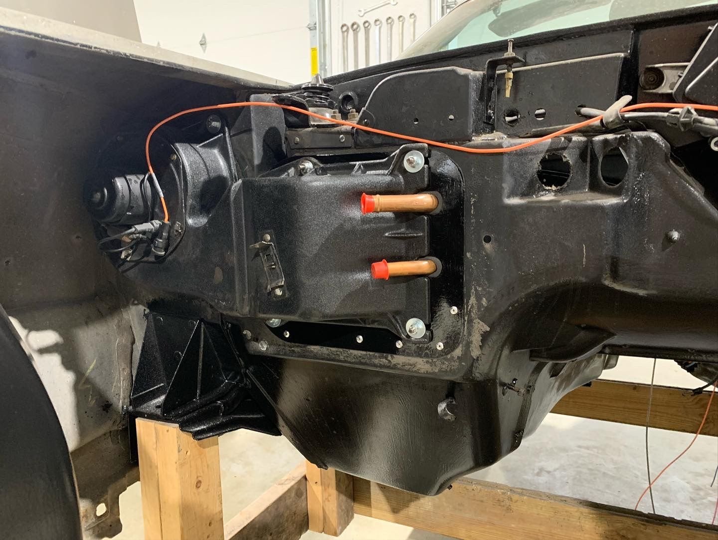

Been making progress. Started fitting interior back in the car. Converted from an AC car to a none AC car by making an adapter plate. Rebuilt the non AC inner heater box with all new seals and new heater core. Installed it in the car and tested the wiring. Finished most of the interior wiring. Converting to non AC saves SO much room behind the dash and in the engine compartment!

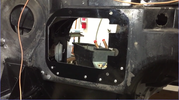

Next video is up. In this part I rebuild the heater box, convert car from AC to Non-AC heater box, and install inner and out heater box.

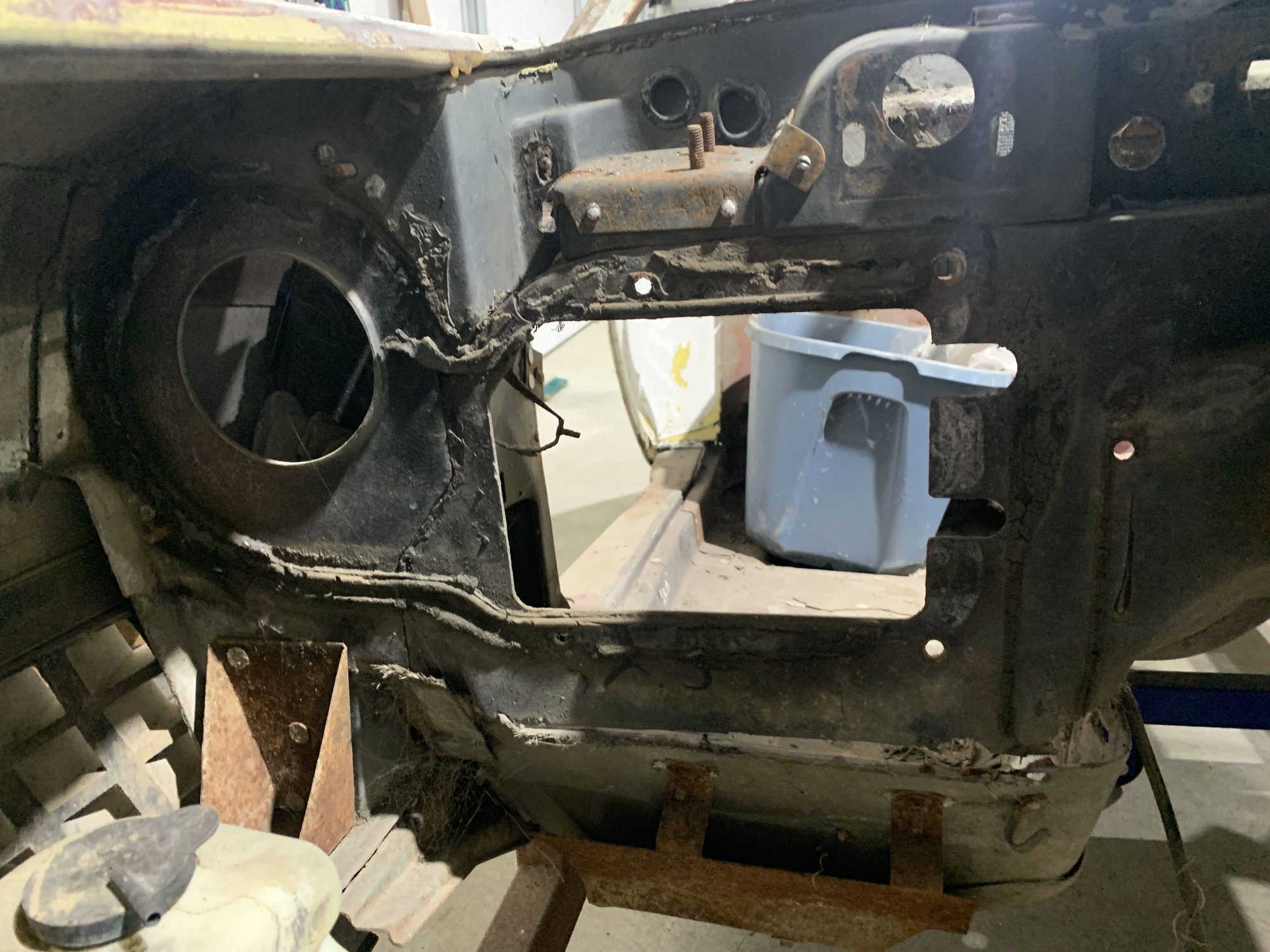

I know the first question is "why would you convert from AC?". I converted from AC to non-AC to save room in both the engine compartment and in the dash. I was going to remove the driver side AC duct anyway because my foot would hit it when moving between pedals. It also saves weight. The AC didn't work in the car and I don't want to spend the money to fix it. I wouldn't use it most of the time anyway. If I decide I must have AC later ill get a vintage air unit.
AC car firewall opening
Non-AC car firewall opening
AC car firewall opening with adapter plate installed

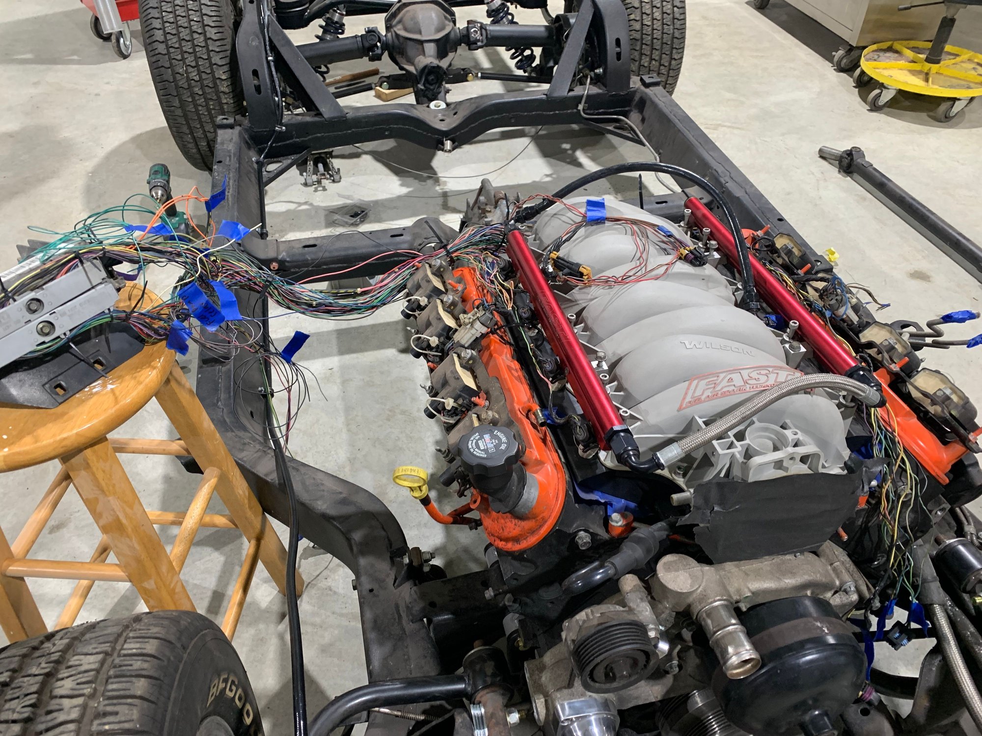

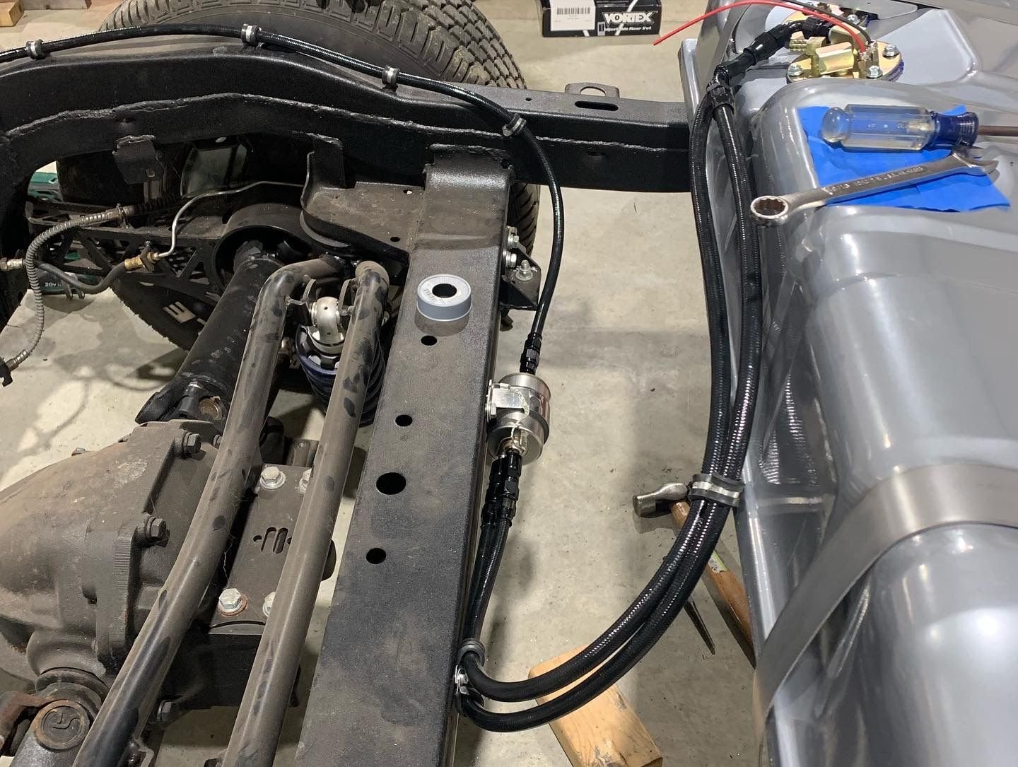

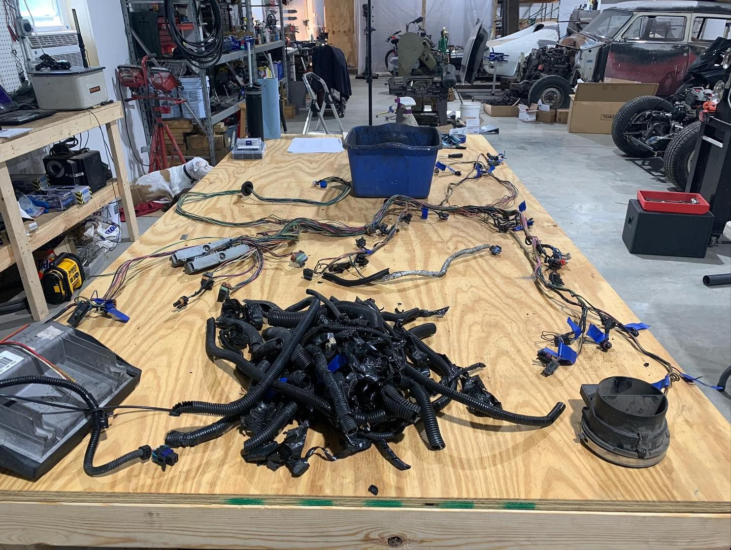

Getting fuel system plumbed and started converting the f-body wiring harness to stand alone. One thing I noticed is the oil pressure is not routed through the PCM like it is in a C5. The C5 also has trans temp wired into the PCM. I think going to wire both into the PCM and see if the readings are transmitted over the serial bus like the coolant temp. I’m going to install Dakota digital gauges and use the serial bus adapter for the signals. Also, the AC pressure switch connector on the f-body is the same as the C5 oil pressure sending unit connector. Don’t even have to buy one.
I’m also converting the harness to the 5 pin MAF. Already ordered the connector to replace the MAF and Intake temp connectors.

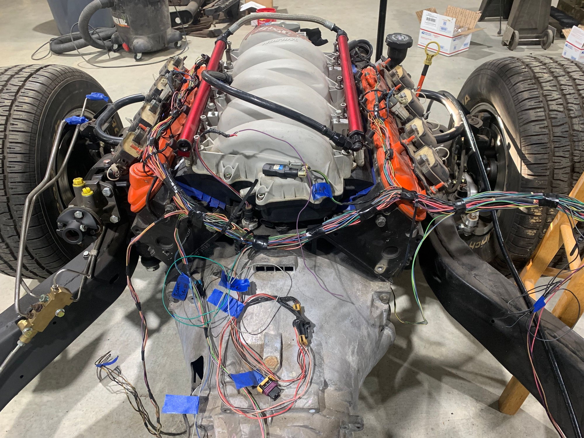

I added the wiring for the oil pressure and trans temp using wires I had removed from the harness. I put the harness on the motor and started taping it into sections. Turns out, the C5 trans temp sensor is the same connector as the VSS (speedo) so I ordered one. Also turns out, the 5th gen Camaro TR6060 uses the same temp sensor as the C5. Very convenient.

I have finished wrapping most of the engine harness. Ready to put the body back on and figure out where to mount the PCM. I was also working on the vacuum lines for the heater and ran into an issue. The vacuum port switch on the controls will not hold vacuum. The issue is it’s a 4 port switch. I could not find anywhere that sells a 4 port switch. Only the 9 port switch. I have three other controls with 9 port switches and at least one hold vacuum. I went through all of settings to figure out what ports did what and think I found a configuration that will work ok.

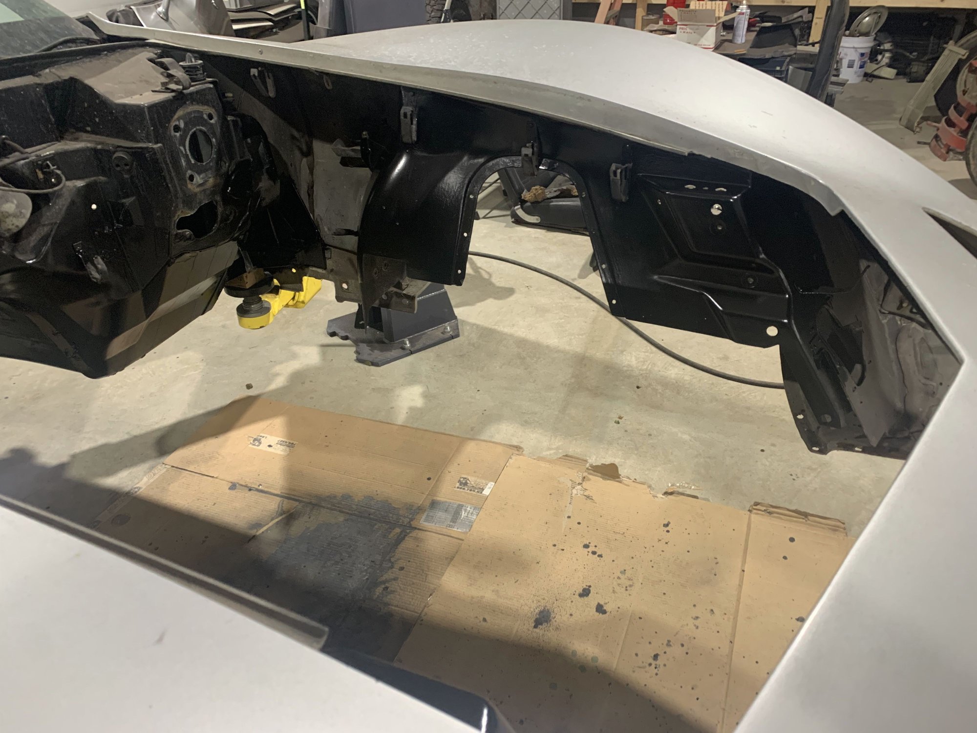

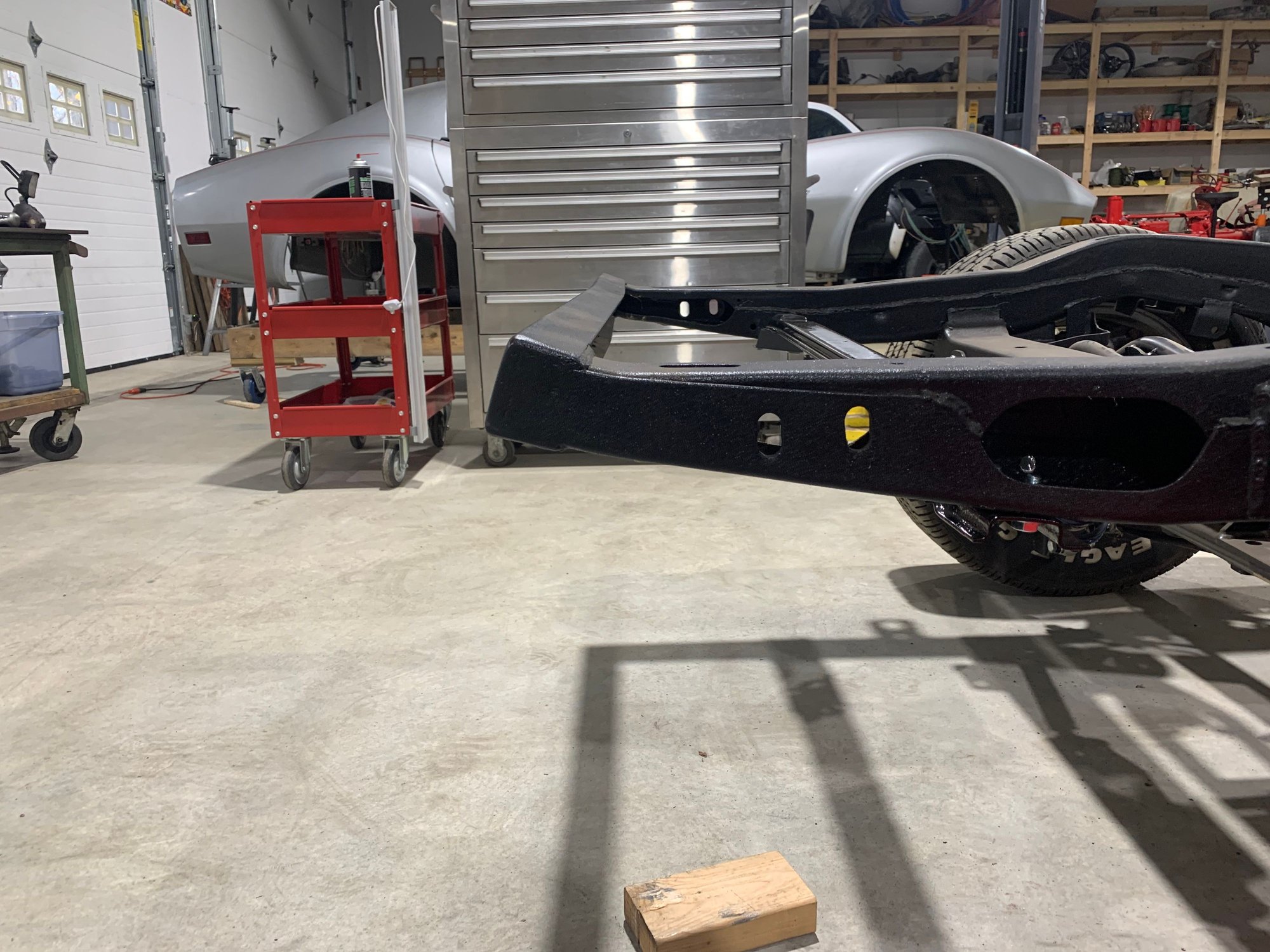

I have ran into an issue with the chassis. I think the rear part of the chassis is bent down. See how it’s not straight with the body? The three front body mounts on each side are torqued down. The driver rear (#4) has a 3/4” gap between the mount and the body. The pass side has 1 1/8” gap. Made an appointment with a frame rack for next week.
On a good note, I got the computer mounted and wired into the car.
