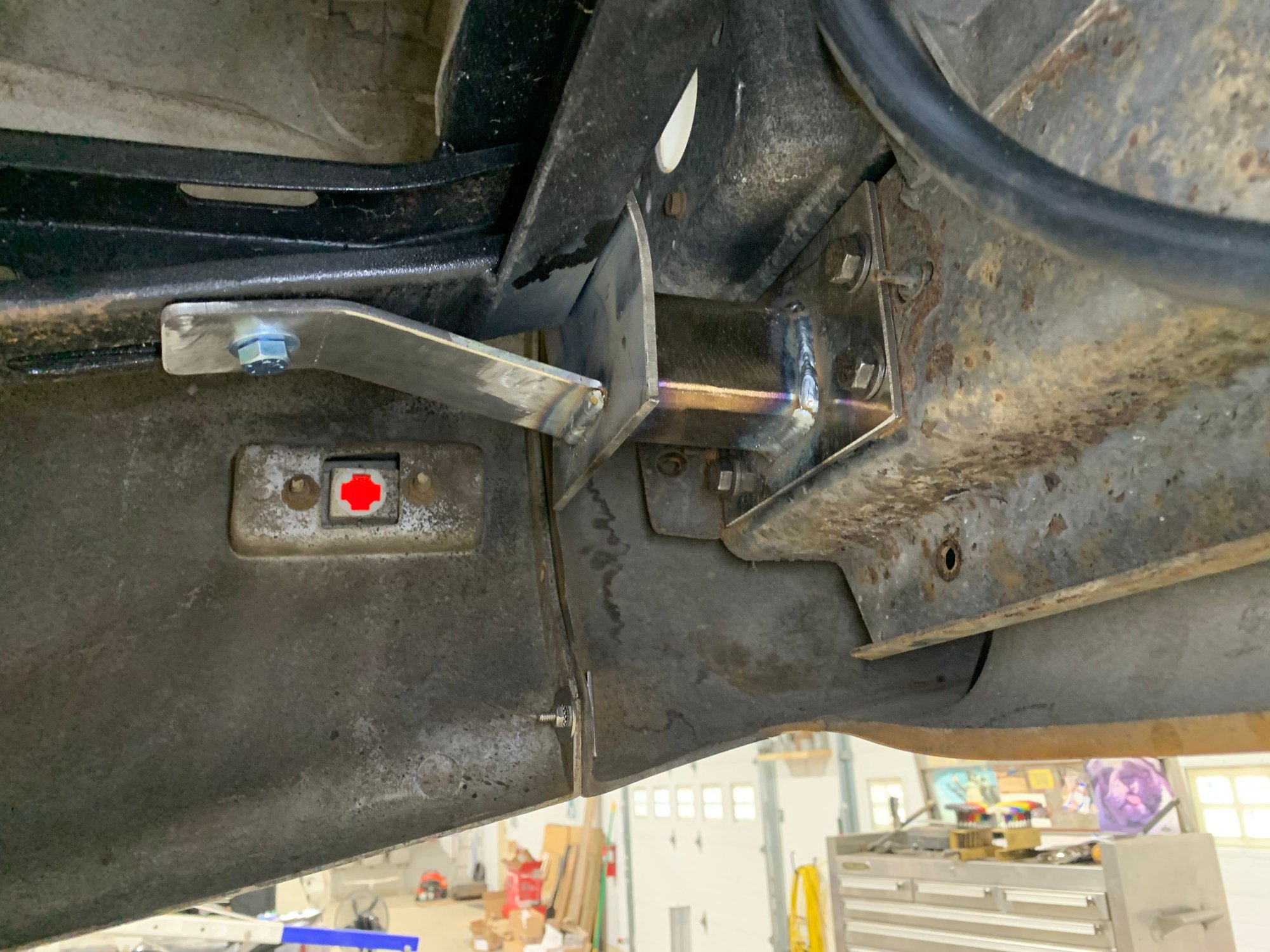

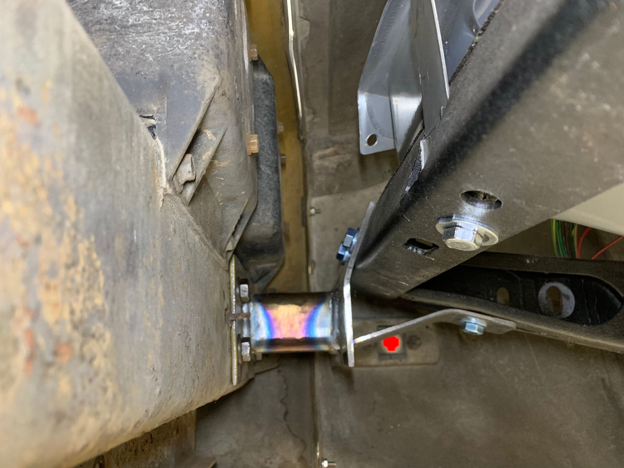

Got around to making the adapter brackets to fit the ‘76 rear bumper support to the ‘73 chassis. I think they turned out pretty good. That rear bumper support is heavy! Definitely something to replace with lighter parts in the future.

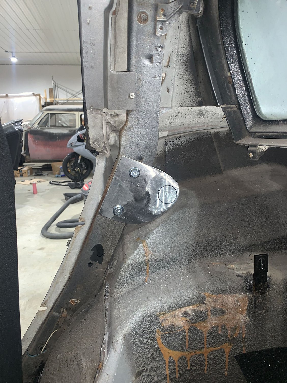

Fixing the headlight assembly brackets. First time welding aluminum. Had already fixed the one on the right. It was worse than the one on the left. Cut new pieces of aluminum and welded them in. Pretty happy with the welds and the finished repair.

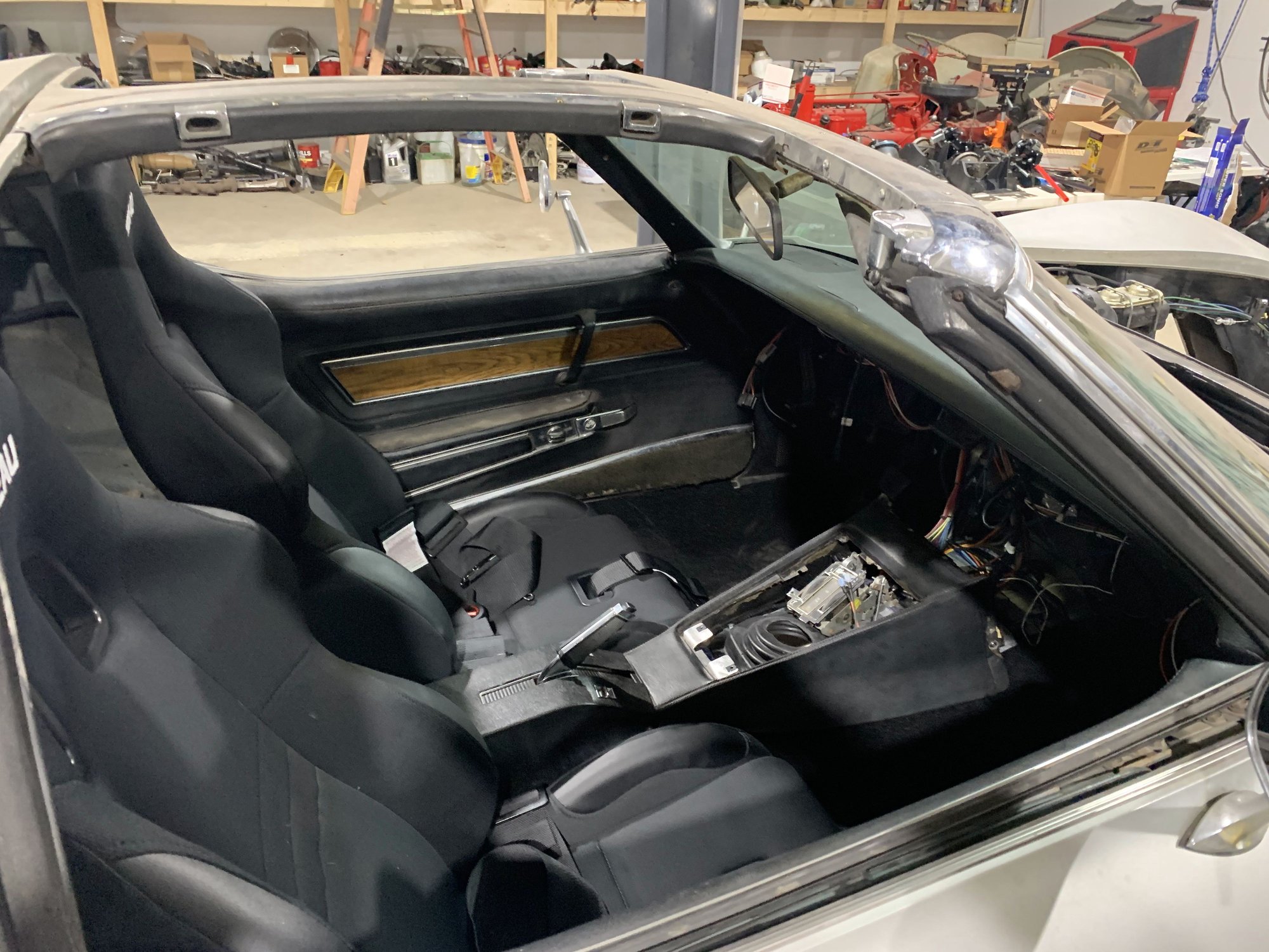

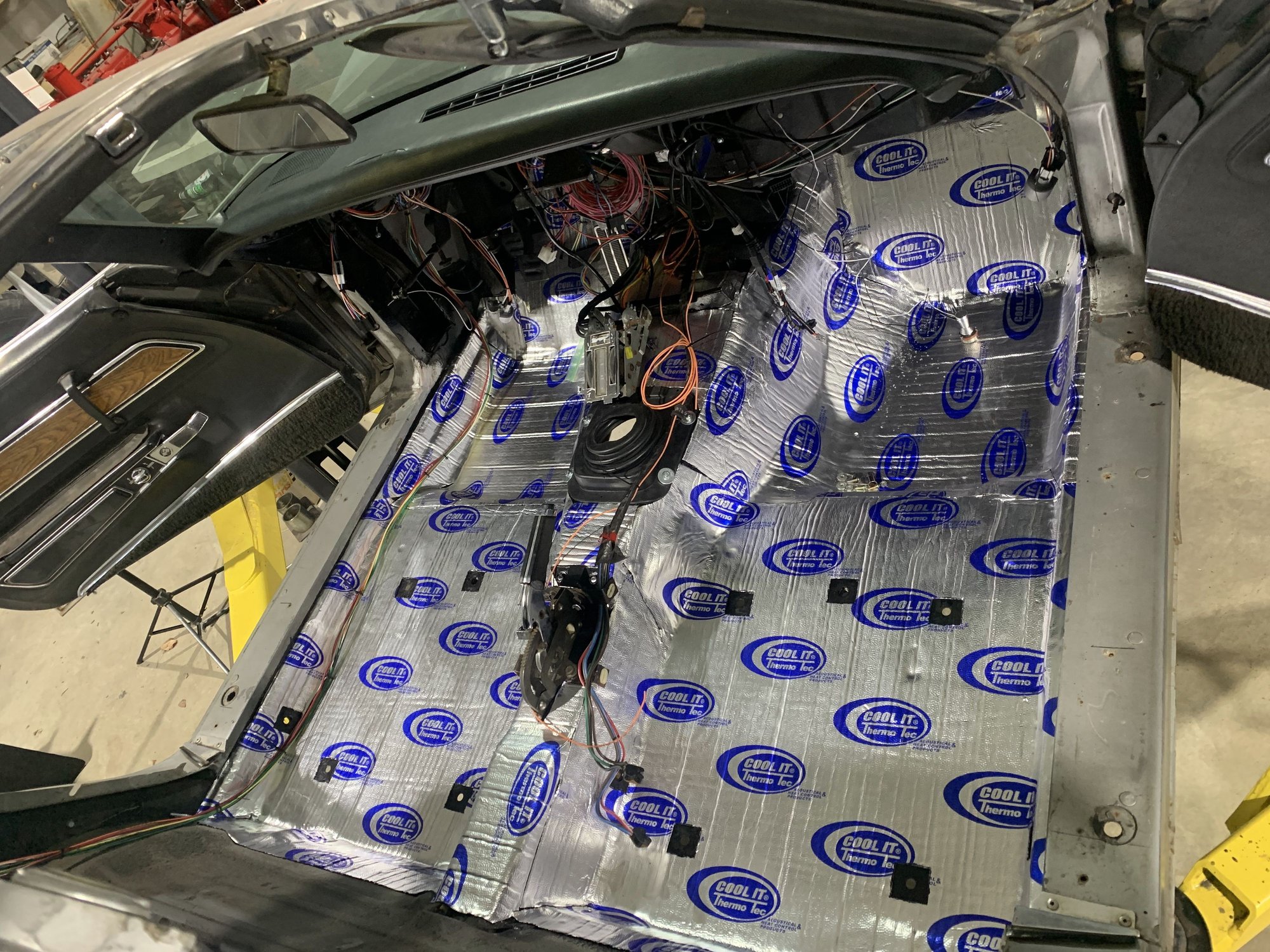

Been pretty busy and getting some things done. Bought outdoor carpet from Menards, cut/fit it to the floor pans, and glued it in place. Started getting the harnesses installed. Also fabricated and installed the harness bar.
I then started trying to verify driveline angles and couldn't the numbers to work out. The flange on the trans is down about 5 degrees. A couple degrees too much. I started measuring around and it appears the front of the frame is too high by about an inch and a half. I asked the body shop to measure all parts of the frame but obviously they didn't. So frustrating! Also, the differential pinion is around 0 degrees or a little nose down. That doesn't make sense. I would expect it to be nose up by about three degrees. I looked at the stock chassis from the 76 and its also about 0 degrees or a little nose down. Does that make sense to anyone? It is possible I just don't know what I'm doing. A little help would be appreciated.

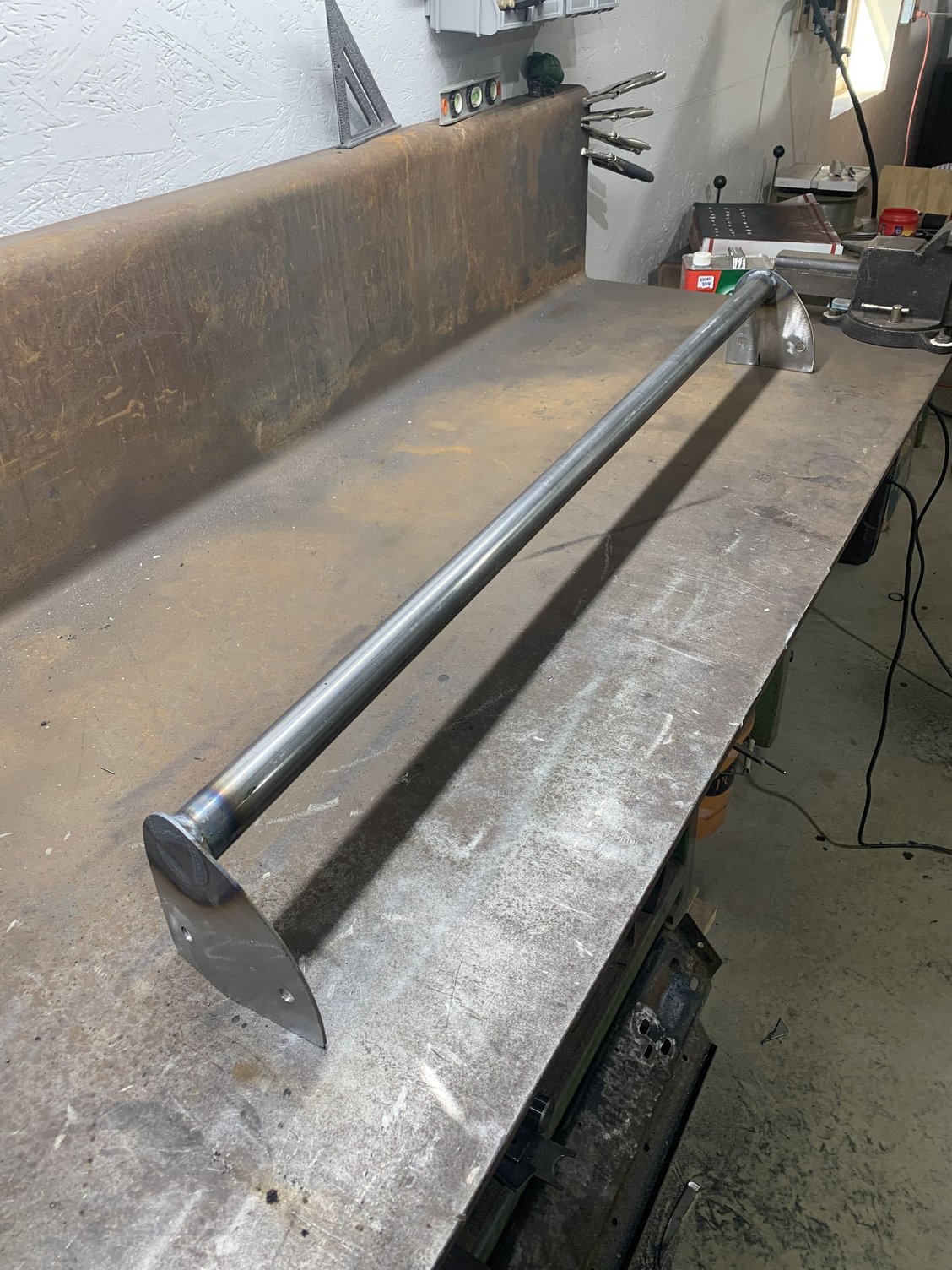

Made the spreader bar.

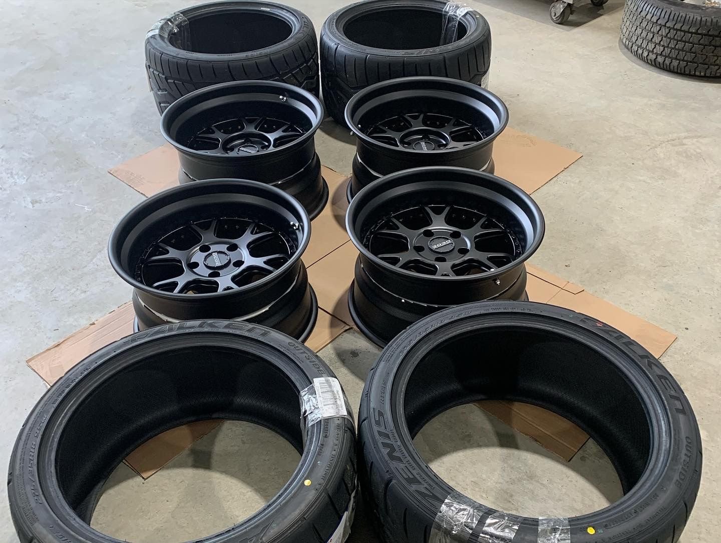

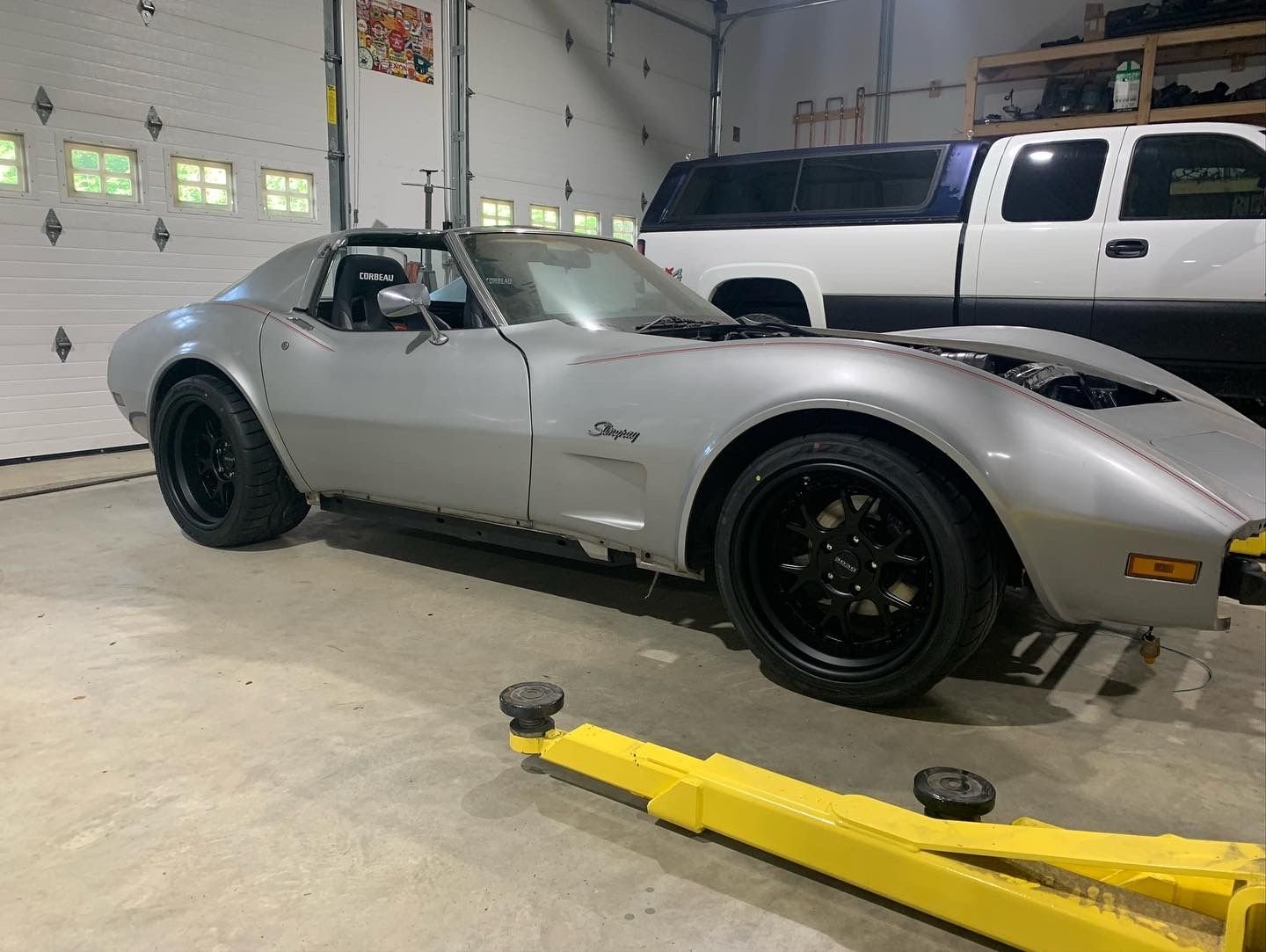

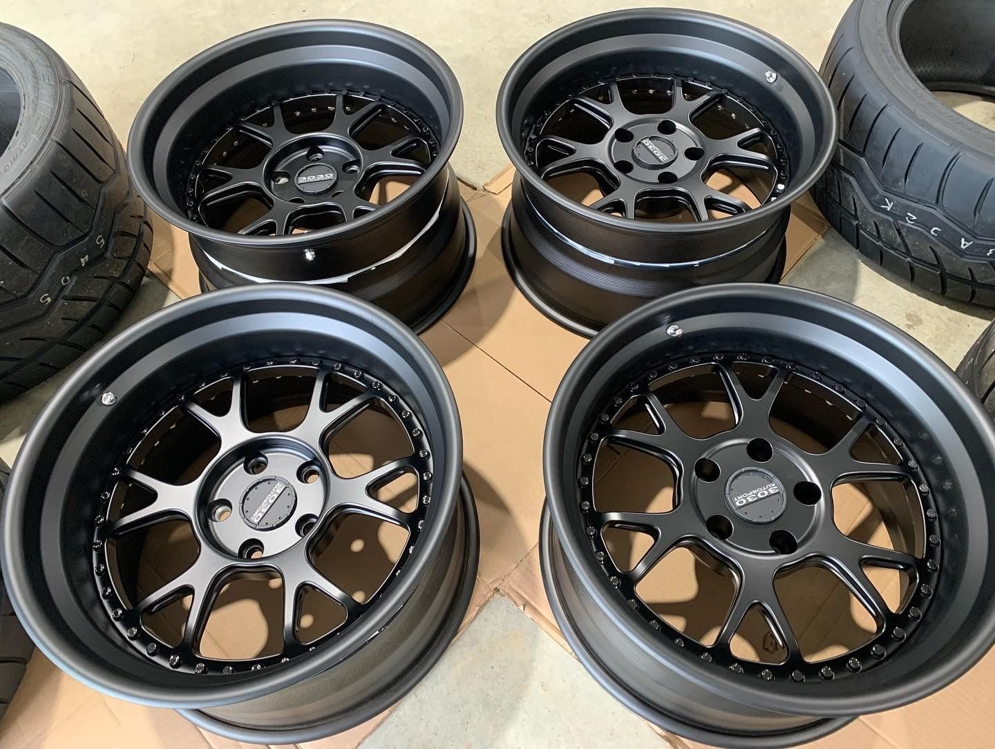

Wheels turned out amazing!
