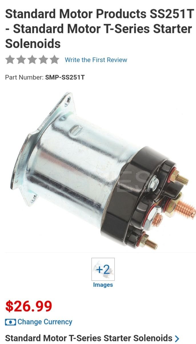

And yes, you can buy just a Solenoid. most " Mechanics " these days just replace parts. not rebuild them, so most auto parts store's just stock the complete starter. But it is possible to buy just the parts.
Old May 17, 2021 | 06:48 AM
4-vettes's Avatar
4-vettes
Posts: 13,258
Likes: 7,847
Cruise-In VIII Veteran
Just an example, but this is from Summit.
