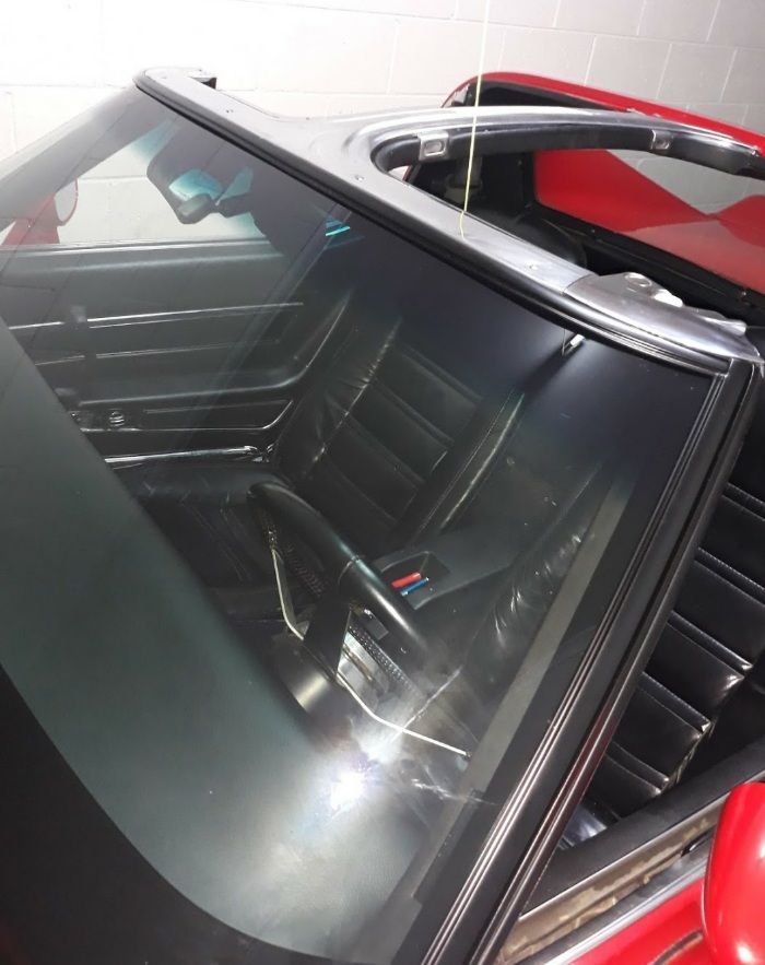

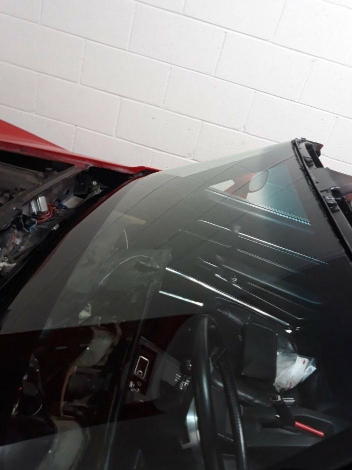

New windshield, Jan 2020. Glue drying.
all mouldings installed, after the glue set, perfect fit. tons of measurements and I did set the side trims on lightly to check fit right after windshield was set down just as a double check. But don't press down. once down. there's no coming back up!

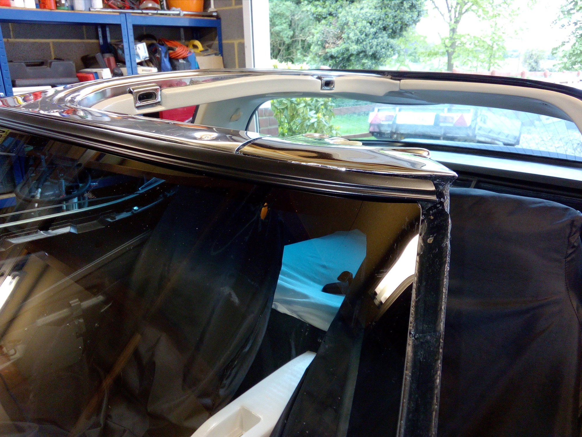

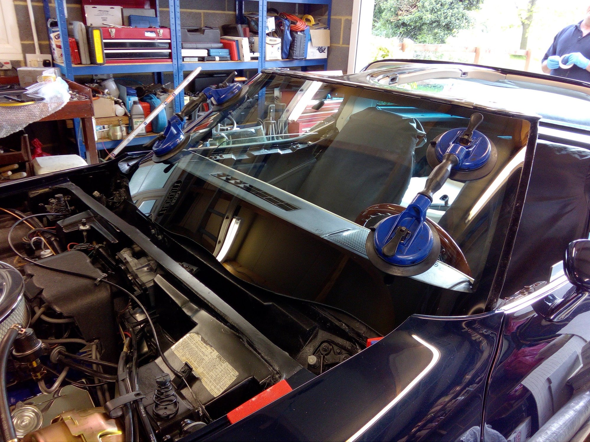

Well my screen is now on. I used 3/8 damming strip and the glue both on the windshield. I did use a windshield replacement firm but the fitter was perfectly happy to do things how I wanted and for me to help him with the job. At first he thought we should put the tape and glass on the frame, but then realised he couldn't fit his glue gun into the bottom corner of the frame, hence we put them on the screen. Decided to put in the top trim whilst the glue was still wet and that worked fine.
