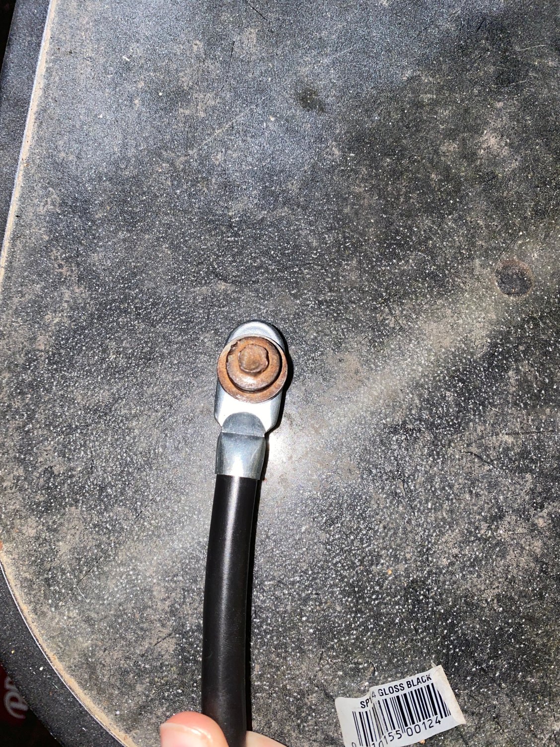

I was told, that any cable would work. So I got a correct size cable, with the side battery connectors.

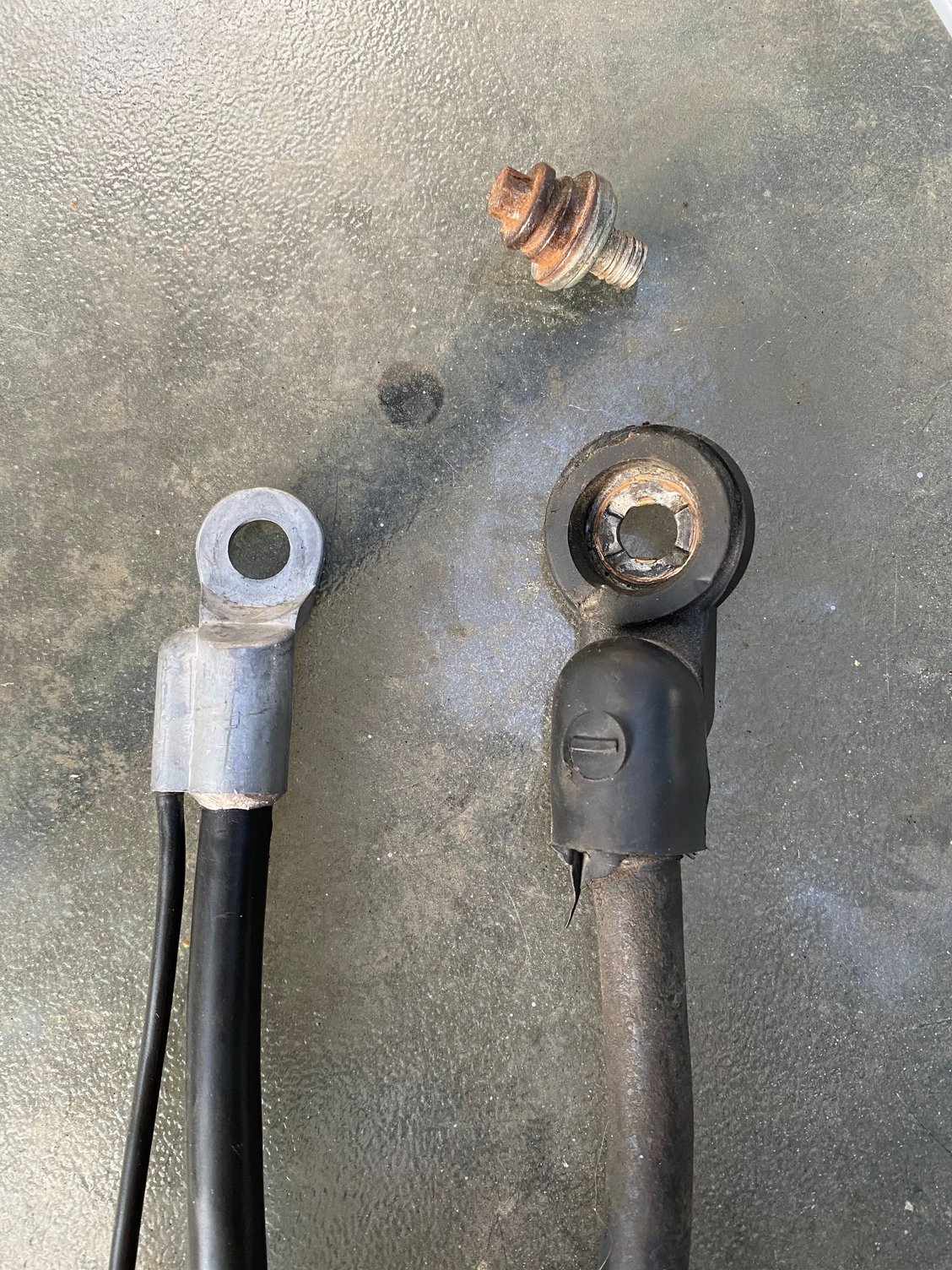

And they different, I had planned to rebuy connectors. Do I need to buy a new cable to match the old(will be replaced new) connectors?

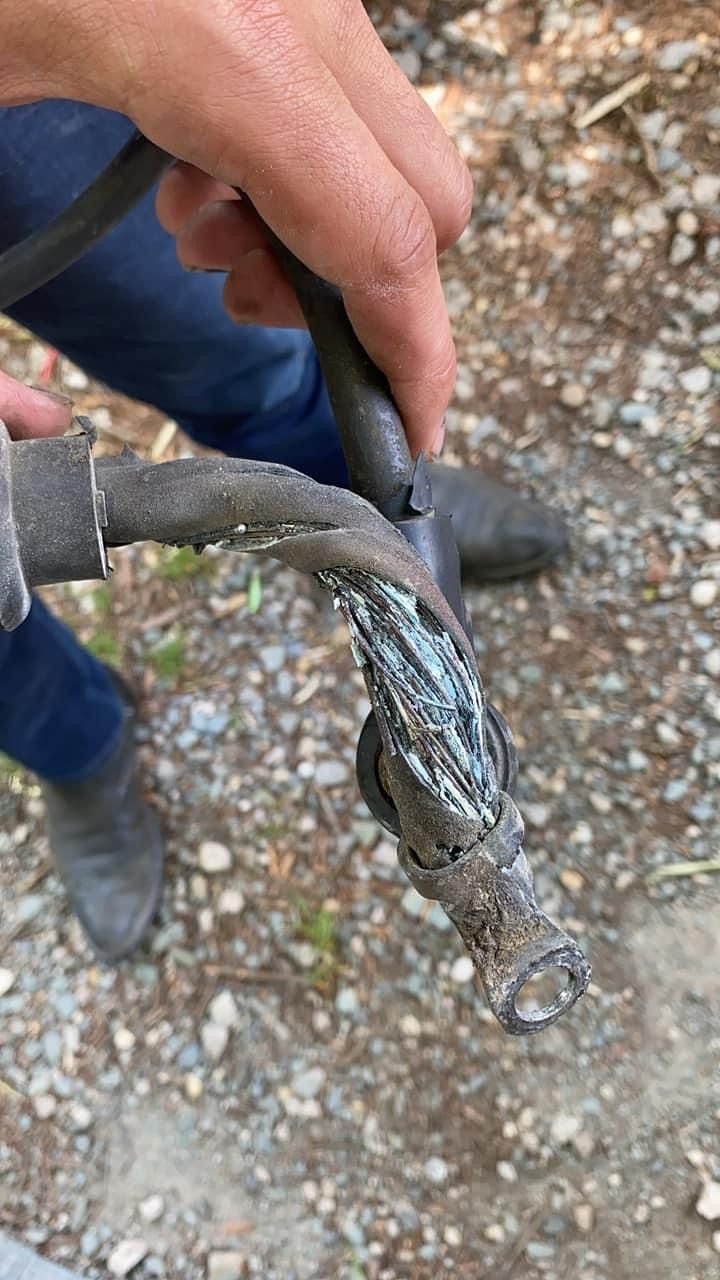

I will post pictures of the dead old cable, the old cable connector compared to the new. And the grommet for the old connector won’t fit the new..
my typing and my thoughts are messy, I’m sorry. I know nothing about battery’s and if I do it wrong my car could catch fire. I know I look dumb, but I just don’t want to make a mistake and set it on fire.
Very obviously the old cable... I had no idea it was this bad until I was under it....
The old cable has a built in rubber cover and the new cable came with adjustable rubber covers

electrolysis. differential metal corrosion. steel to the pot metal lug to copper cable. all that electricity through three different types of metal. doesn't matter if the car never saw rain. it saw electricity. the lug. you won't get it off or back on new cable. the correct cable with lug is pricey. wrap tape around the wire and jam it into the hole. we don't drive through big puddles much anyway.

can I use a bolt or does it have to be a grommet like this? Couldn’t I just get a bolt and washer to make sure I get a good seal?.
I’m not worried about the connection in the frame, I’ll just lock that in with a bolt. I’m worried about a poor connection in the cab cause cab.

would I be able to rethread this grommet? The threads on it seem too flat and spacious.
I’d like to stretch the new connector to fit the old grommet, however, the grommet is as wide as the whole connector.

the rubber on the battery terminal end? inconsequential. rubber around the pos is a protector from arcs and sparks. the negative lug is just fine without it. https://www.ebay.com/itm/18483673950...xoCoSoQAvD_BwE i thought you meant the big rubber grommet that seals the battery compartment from water splashing in.

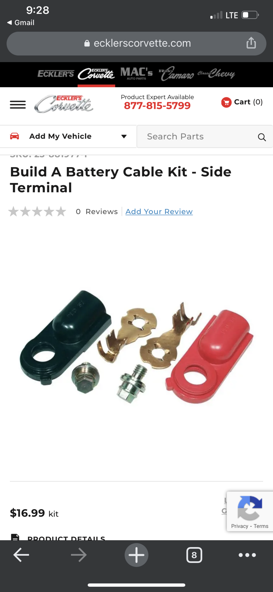

Eckler's kit has pretty cheesy lugs (actually, those are so puny, I can't even call them "lugs" ). Go to Tractor Supply or similar vendor and purchase 2 feet (you verify how much you need) or so of #2 wleding cable. 100% copper, please...no aluminum wire for this puppy. Use a propane torch to solder the lugs on...saturate the strands with solder so you get a GREAT electrical connection. Cover open metal surfaces with some Permatex Ultra Black RTV (not run-of-the-mill silicone caulk/sealant). You'll be good to go.

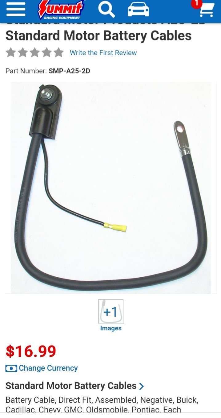

Summit Racing, hardly worth making one for this price.

I think the battery bolts are 5/16", rather than 3/8". Also, that $16.95 battery cable is most likely aluminum. I doubt you could by a full-copper cable for less than $50, these days.

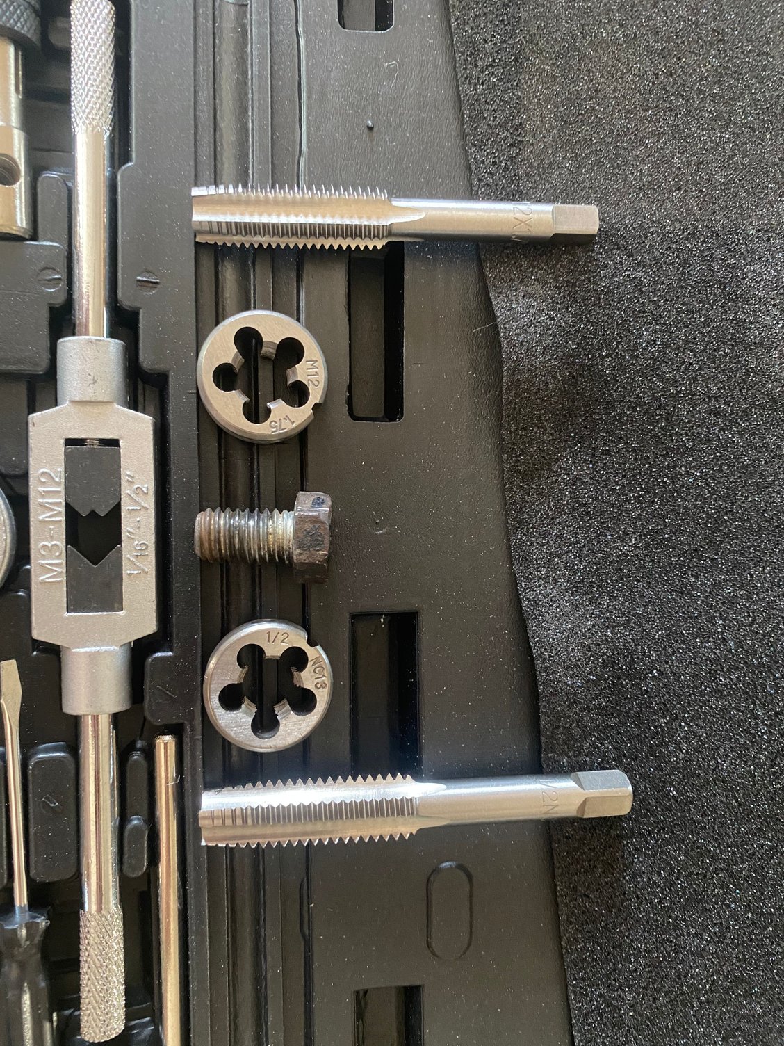

the bolt to hold the cable connection to the frame is too big, how do I make it bigger. I’ve recently bought a thread tapper/chaser kit, is this how I’d do it?
the bolt is either M12-1.75 or NC13-1/2.
I’m so close to having this done, I don’t want to **** it up and I don’t want to use force the bolt through and give myself a headache for later.
and stupid question, the ground connection is the side that has the little yellow wire right?.?
"the bolt to hold the cable connection to the frame is too big, how do I make it bigger"
What is "it"?
The end of the new cable with the small pigtail wire normally bolts to the battery post...but in your case it can be bolted to the frame if necessary
Usually the threaded hole in the battery post is about three threads deep (designed to be stripped out!).
If you convert to a 3/8"-16 TPI bolt you need some flat washers and a lock washer to "shorten" the length of the bolt you have now in order to prevent stripping the battery post threads.
(We have alot of info going back and forth...maybe you can pick one problem and fix it...then move to the next problem)
