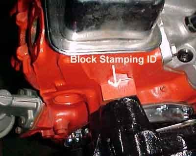

Read the label at the lower right arrow -- specifically the top left corner of the label where the arrow head is pointing (at least I think that's where the L-48 or L-82 is specified). You can also look at the pad on the front of the engine, below the upper left arrow. This should carry a serial number that matches the last 6 digits on your VIN tag and an engine assembly date and option code. The pad faces up but is angled downward toward the wheel and is about 5" below where the valve cover meets the head. Lastly, your VIN coding, I believe, has what engine was originally installed in the car. Hopefully all three of these data points indicate the same engine.

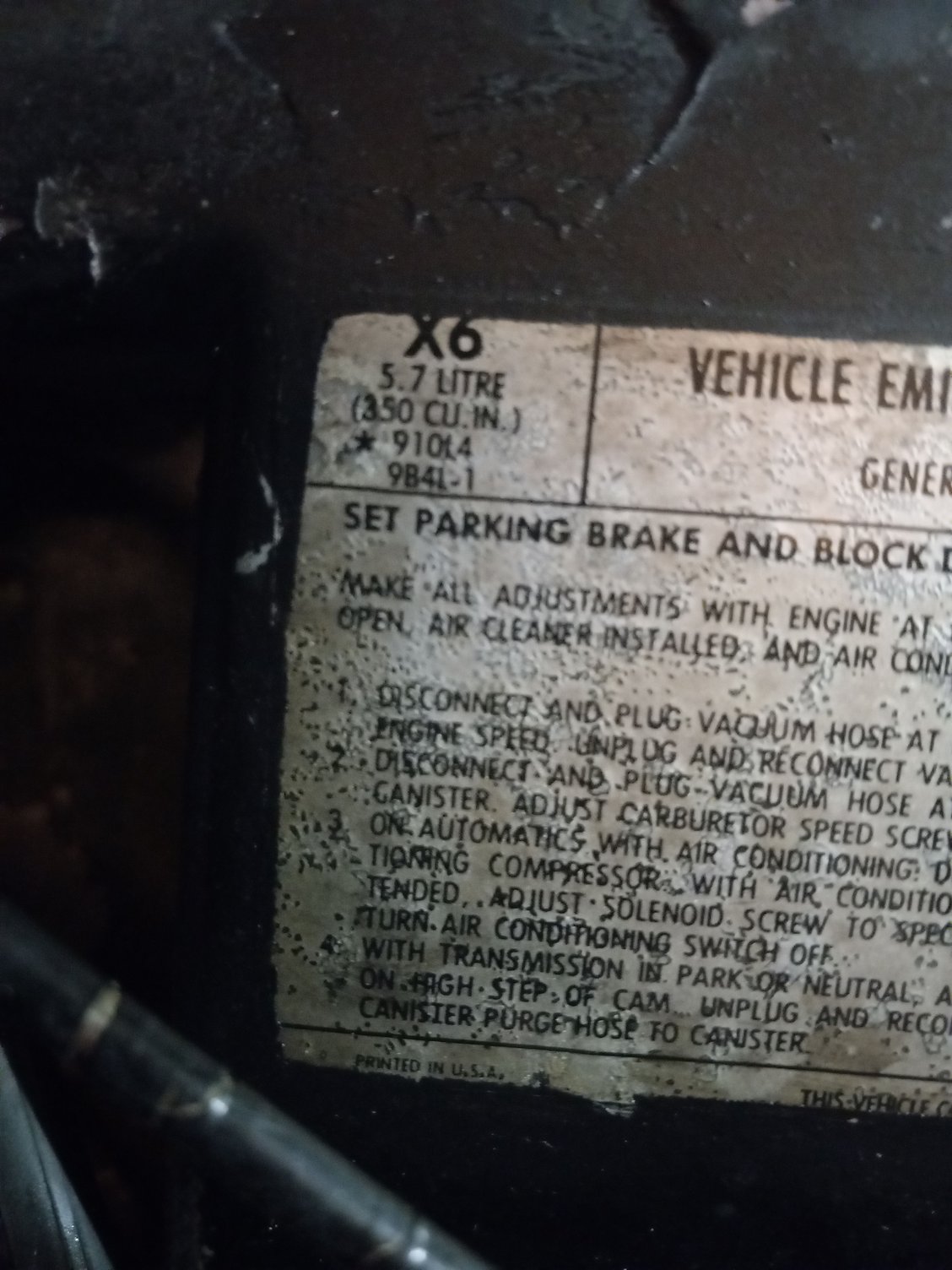

I could not find the s/N that the upper left arrow points to.
The placard for the lower right is attached. I can't make heads or tails of it.

X6 on the emissions label indicates a L48.
Valve covers can be changed, or blocks for that matter but emission stickers are forgotten. Is there a L82 printed on the tachometer face?

Most of all you need to locate the engine stamp pad. Located below the passenger side valve cover in front. Will be difficult to see with the ac there but the suffix will tell you what block it is.

and last 6 small numbers will match the vin tag and title if still orig engine.

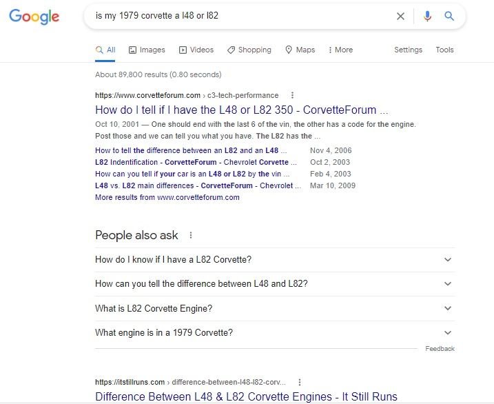

My recommendation is to allocate a couple of hours to start Googling to get a baseline of information. The interweb has anything you could possibly want to know about your C3.

The fifth digit of your VIN will tell you which engine your car started life with, "8" indicates the base L-48 350, and "4" indicates the optional L-82 350. Of course, after 40+ years, anything could be under the hood, that's why you need to locate the stamp pad, on the right front of the block.
The stamp pad should have two sets of numbers and letters. One set identifies the engine, and where and when it was built, the second set should match a portion of your VIN. The engine identifier should start with a "V" for the Flint engine plant, followed by two numbers for the month and two for the day the engine was assembled, and finally three letters to identify the engine. For 79 the engine codes are ZAA, ZAB, ZAC, ZAD, ZAF, ZAH, ZAJ, ZBA & ZBB. The ZA codes identify the various base L-48's, and whether they are automatic or manual trans, and which emission regulations they comply with. The two ZB codes identify either a manual and automatic L-82. The second set of numbers and letters stamped on the pad will be the VIN derivative. It will be made up of nine digits and will be in the following form, 19S4xxxxx. It decodes as "1" Chevrolet, "9" 1979, "S" St Louis assembly plant, the "4" is a GM control number and the "xxxxx" should be the last five numbers of your VIN.
