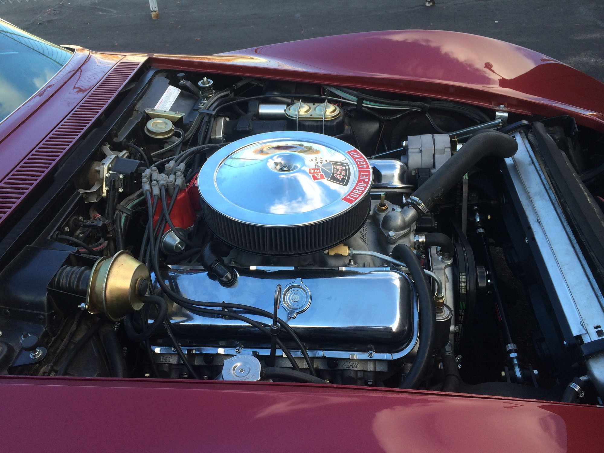

See attached excel spreadsheet and picture. Would not let me attach the excel spreadsheet, total $$ amount was $12,349.43
To Big or small block

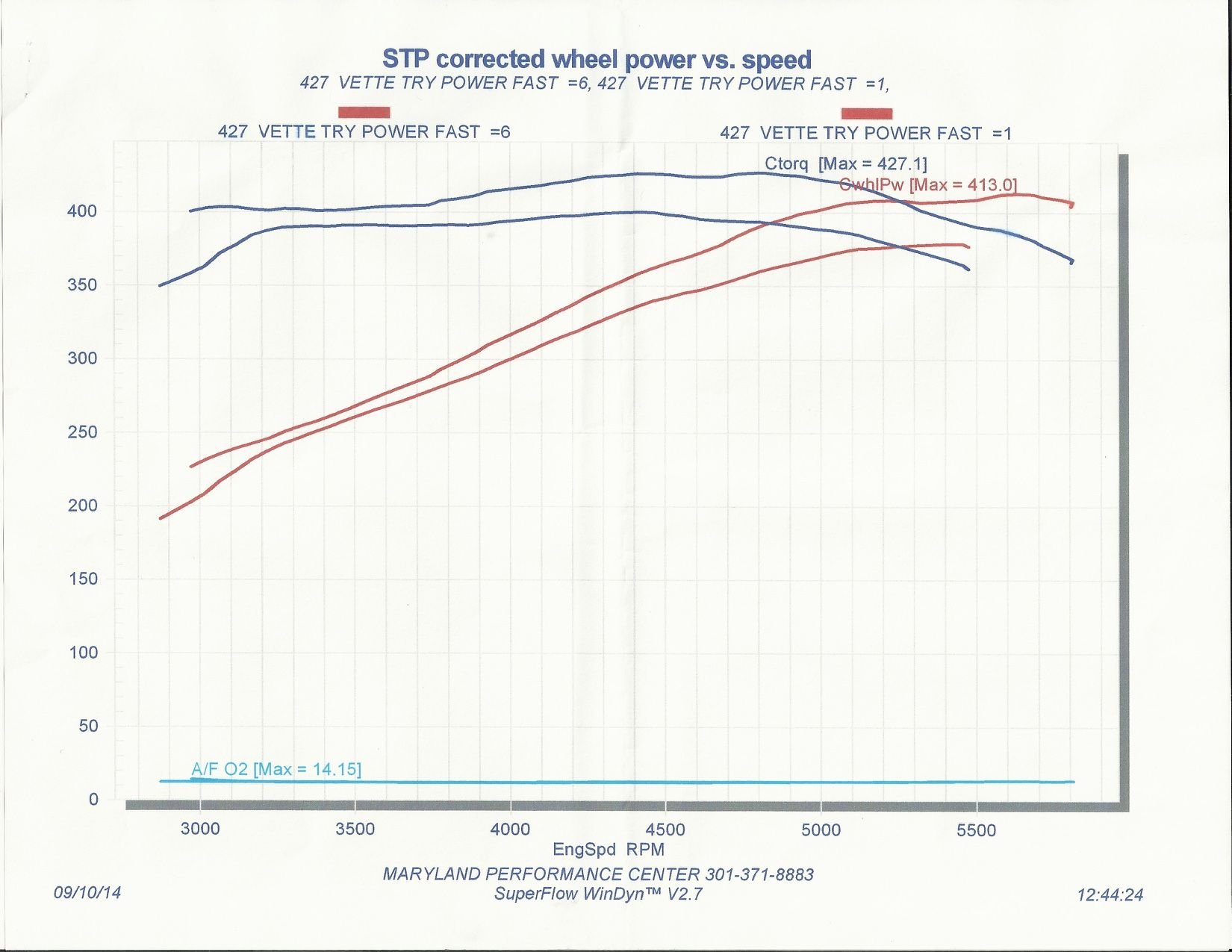

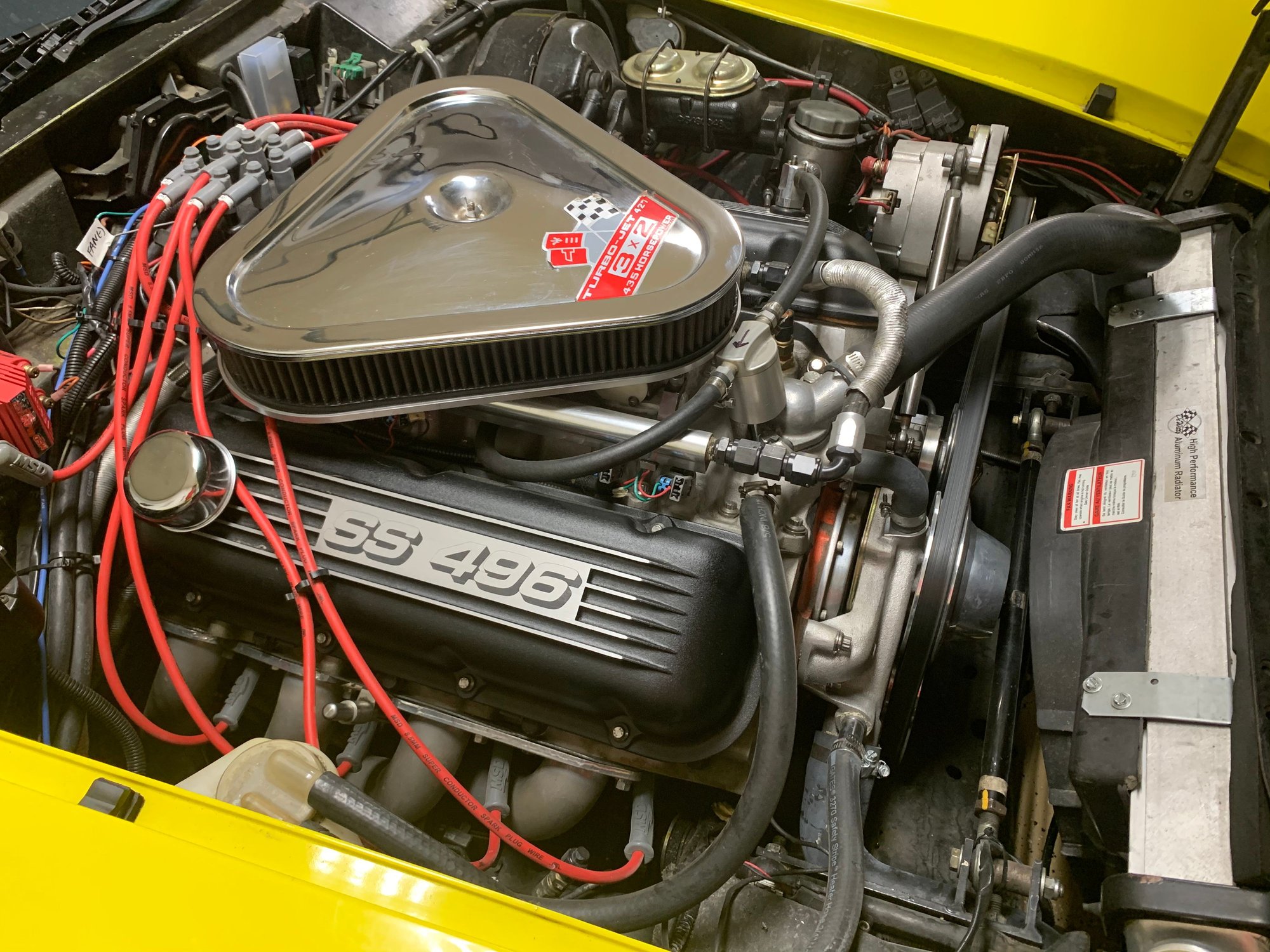

Did the small block to big block swap about 10 years ago. So much fun to drive. Idles at 850 rpm, pulls to 6000. Torque is absolutely flat. Also did EFI which makes a huge difference.
My motor:
My dyno chart from the EFI tuning. Ignore the 427, it is actually a 496. This is at the rear wheels through a T-56 Magnum and 3.73 Tom’s 12 bolt rear. Tuner said the STS baffles (capped) were costing me 50+ hp above 5500 rpm. I don’t need more and it is a good balance of noise vs power.
