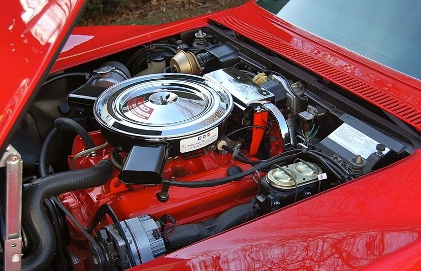

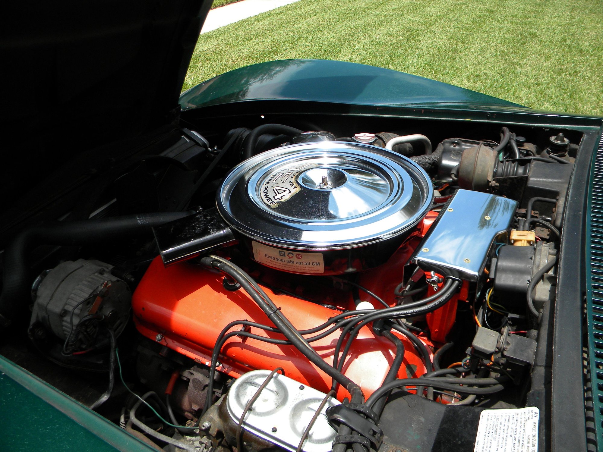

Gee, I wish I had a sbc instead of this Big Block.
I should have bought this:
Instead of this:
