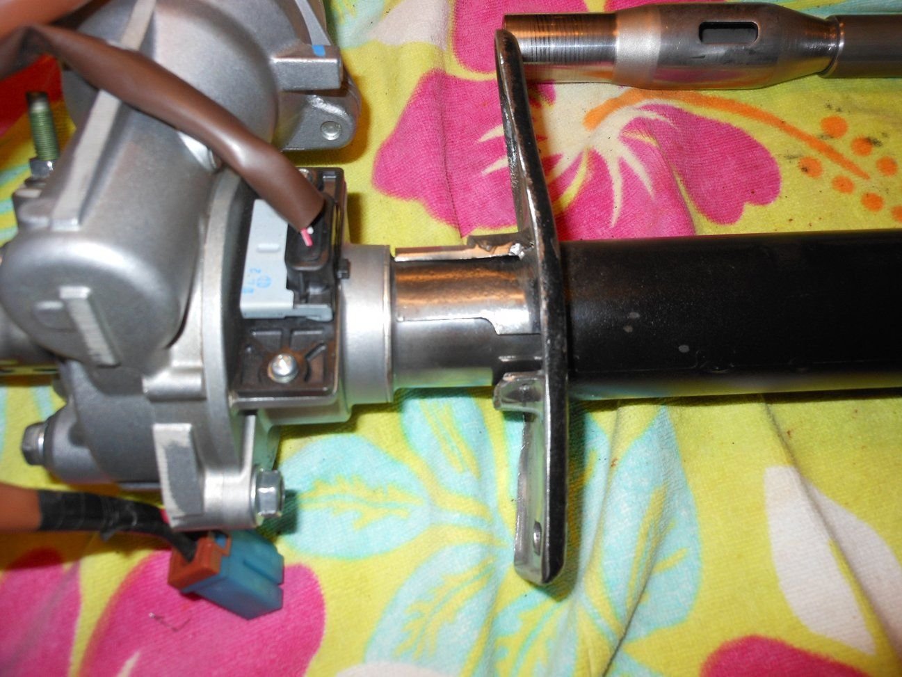

I went with the best of both worlds-
Replaced the OEM with a Flaming River Manual Rack and Pinion
- Great feel- no play
- No fluid to leak- hoses-pumps- pulley- belt
- The cradle definitely stiffens up the front
Then added electric power steering-
- Parking is super easy- even going with a smaller steering wheel
- at speed there is no power assist
- Three wire hook up with a small control box
Old Jun 11, 2021 | 07:51 PM
Richard,
Does your electric steering mount on the column up under the dash or is it one that mounts in the engine compartment?
I looked at several rack and pinion steering systems and found they were a no go with a big block car because of interference issues with the rack and the oil pan.
A couple companies would not guarantee fit, so do a bunch of research before you purchase.
I would still like to go rack and pinion steering with the electric assist because I feel it is superior to the oem and Borgeson box.
I guess I will do some new research as it has been over five years since I checked into it.
I ended up going with the Borgeson Steering upgrade which is still in the box, on the shelf, waiting for my complete restomod.
If Someone has designed a new electric steer rack and pinion, I’ll be selling my Borgeson and switching my plans.
