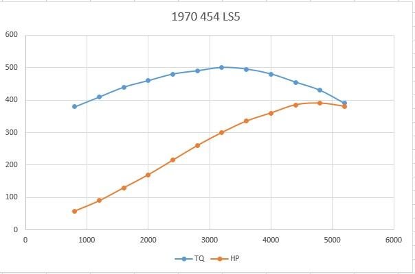

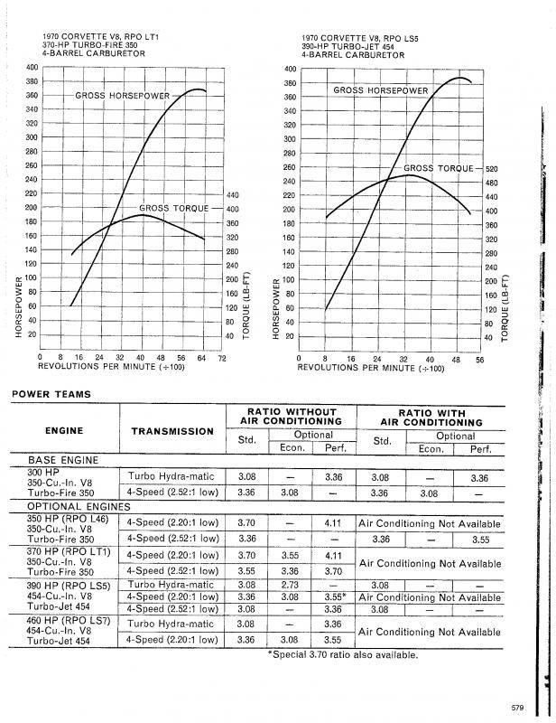

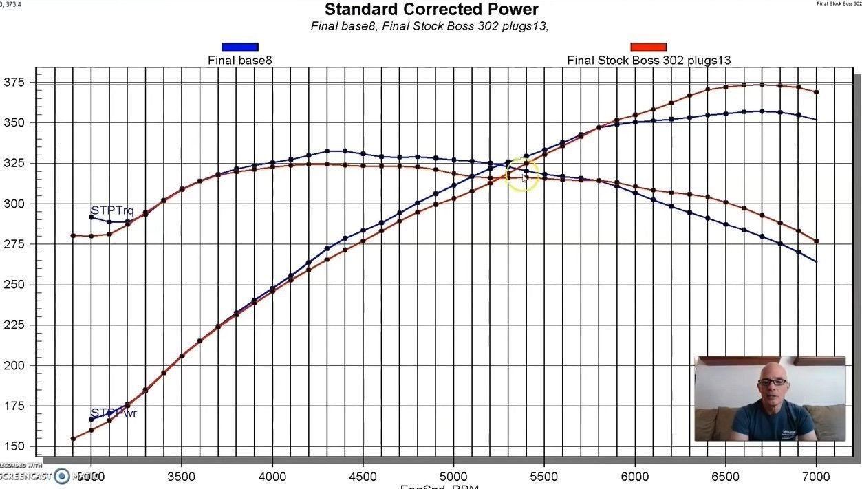

I like pictures.
302 DZ vs 454 LS5
Only 33 HP apart
but 333 TQ vs 500 (167 apart)
6700 peak HP rpm vs 5200
That describe it?
Stock 302 DZ 357HP @ 6700 333TQ at 4400 The DZ is in Blue, Ford engine is in Red.
LS5 data from GM chart 390 HP @ 4800 500 TQ @ 3200
GM data says LS5 made only 58HP but made 380 TQ at idle! That's more TQ than the DZ ever made!
A 350 LT-1 needs 4000 rpm to make 380 TQ.
Duntov and Pat Bedard tested both the 1970 LT-1 and LS5 at drag strip at almost exactly same times/mph. But noted completely different engine "character".

Isn't that a Ford Boss 302???
