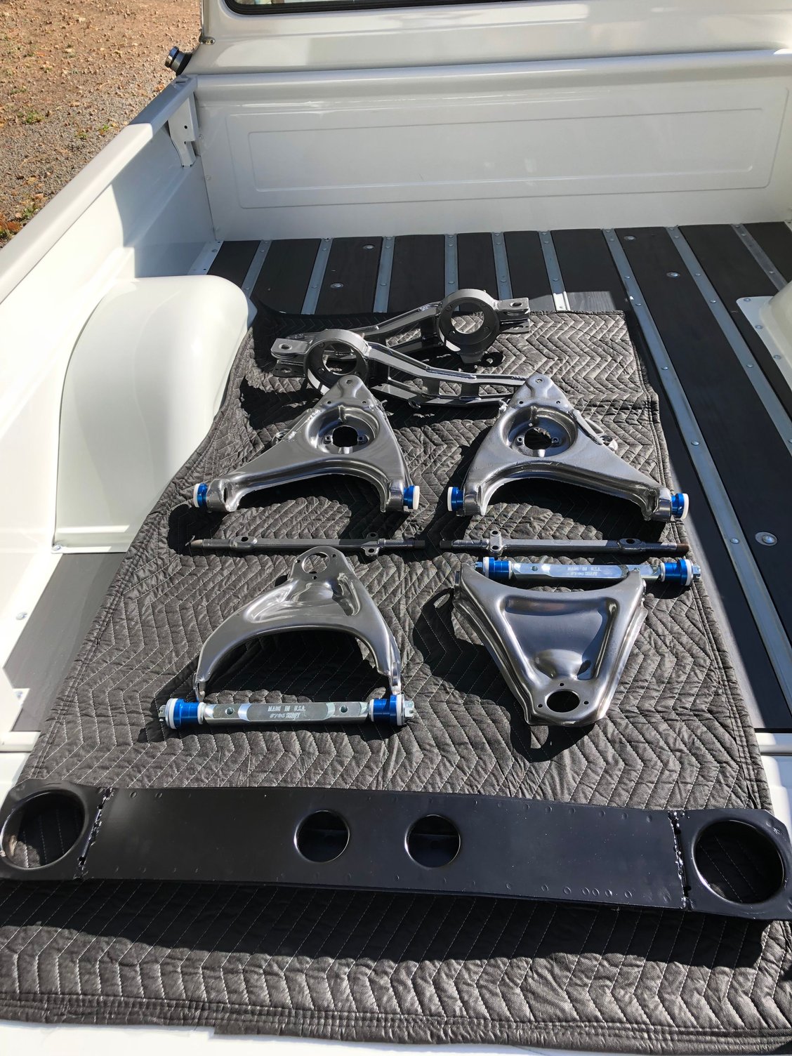

Powder coated frame, A arms, crossmembers, springs. But not all the same color but no one will ever see it unless it's on a lift. But I really dig it

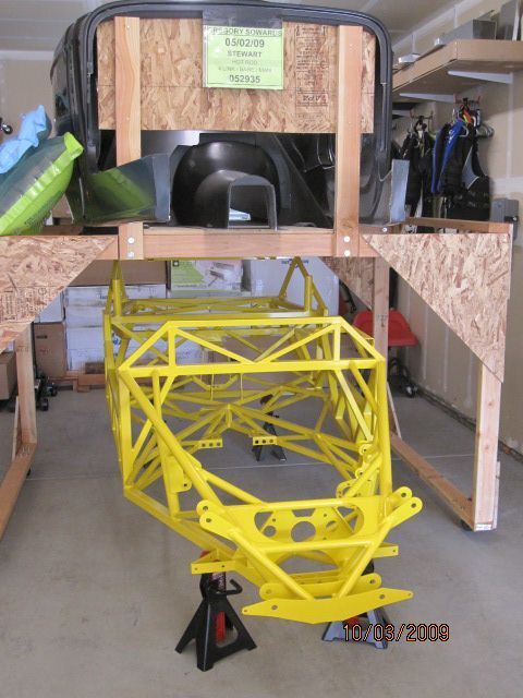

Here's a couple of pictures of the frame and suspension from my Factory Five Racing 33 Hotrod.
The cost for the frame was $650.00.
Super nice finish and I plan to do my 73 frame as well.
