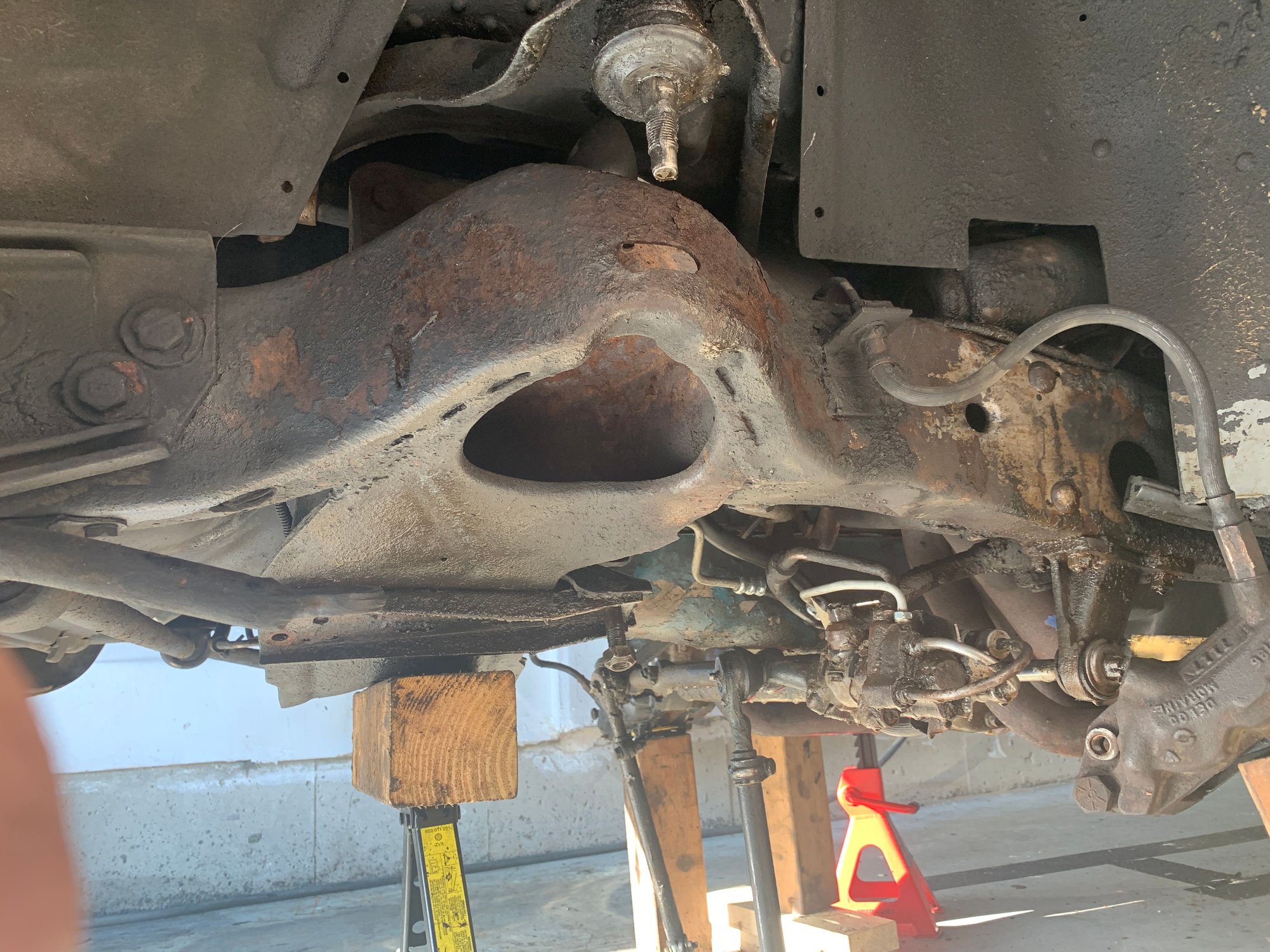

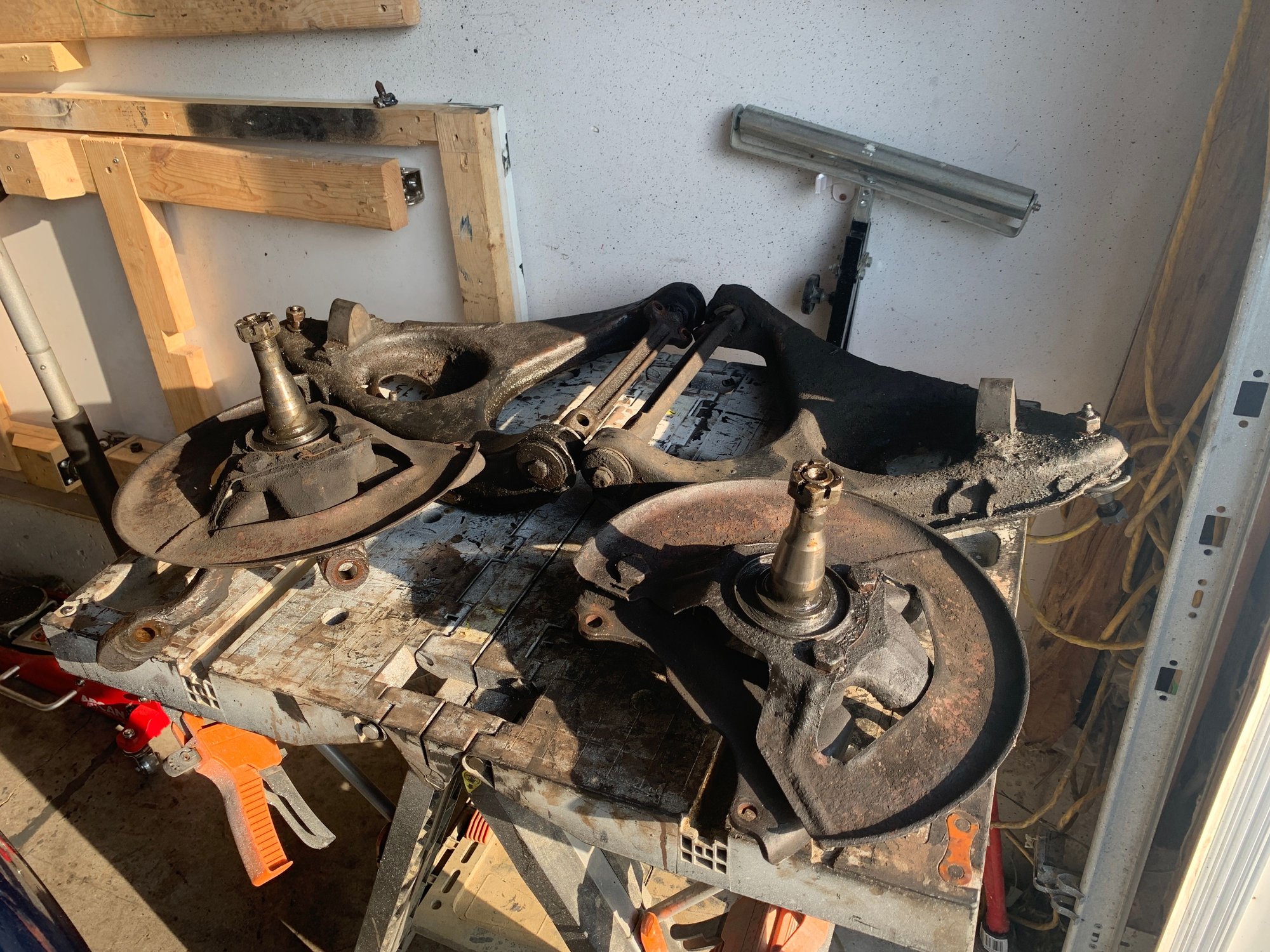

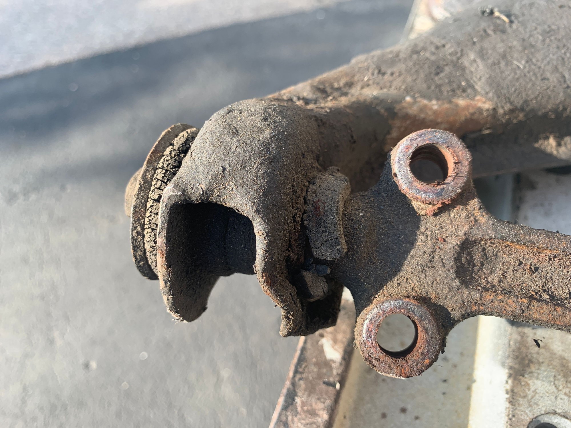

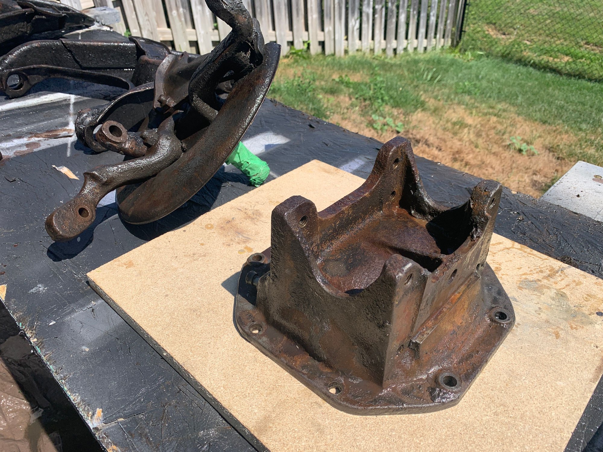

The teardown continues:

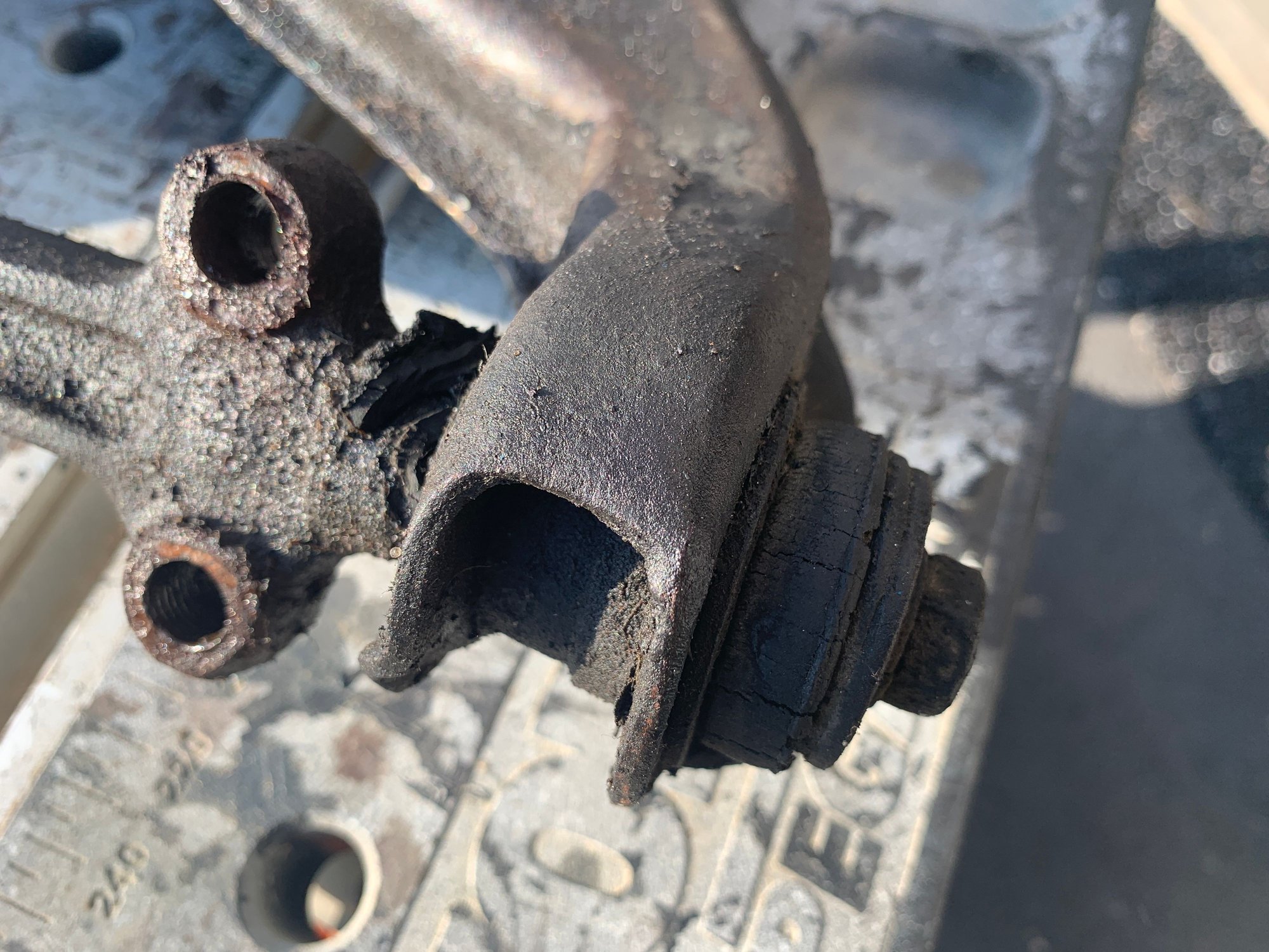

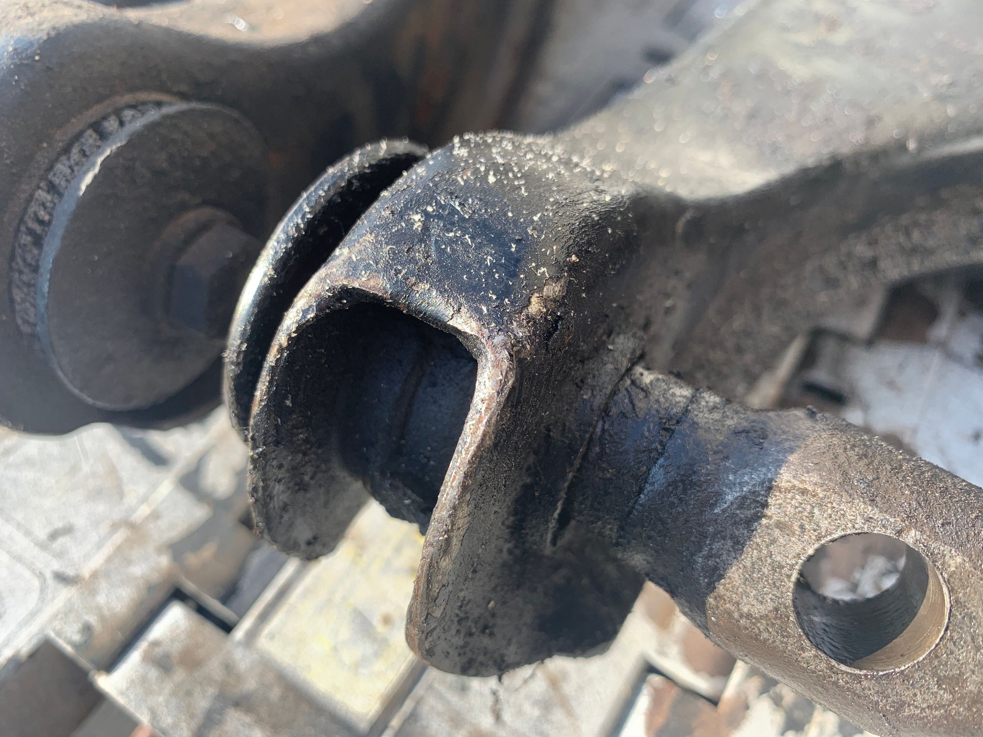

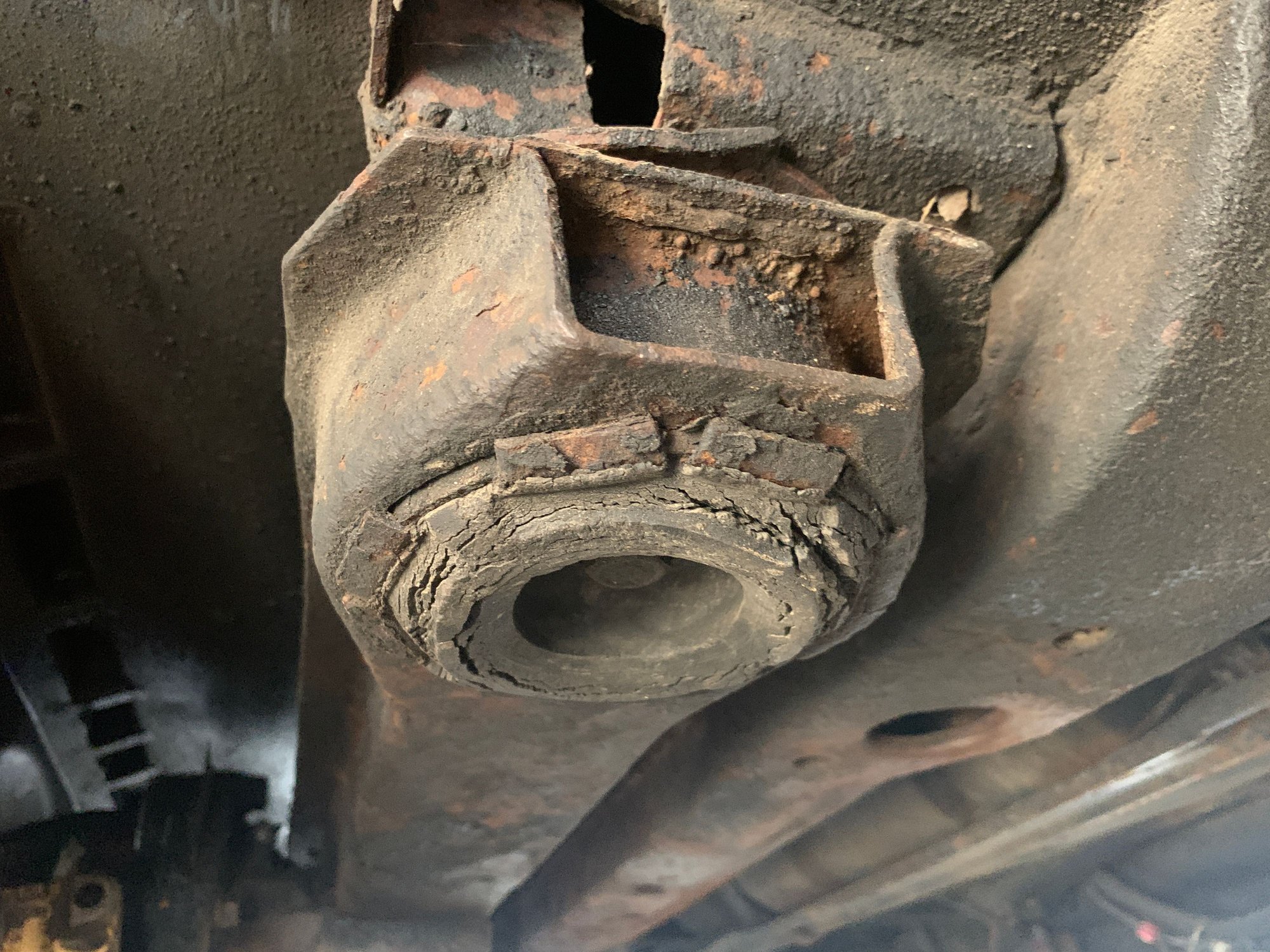

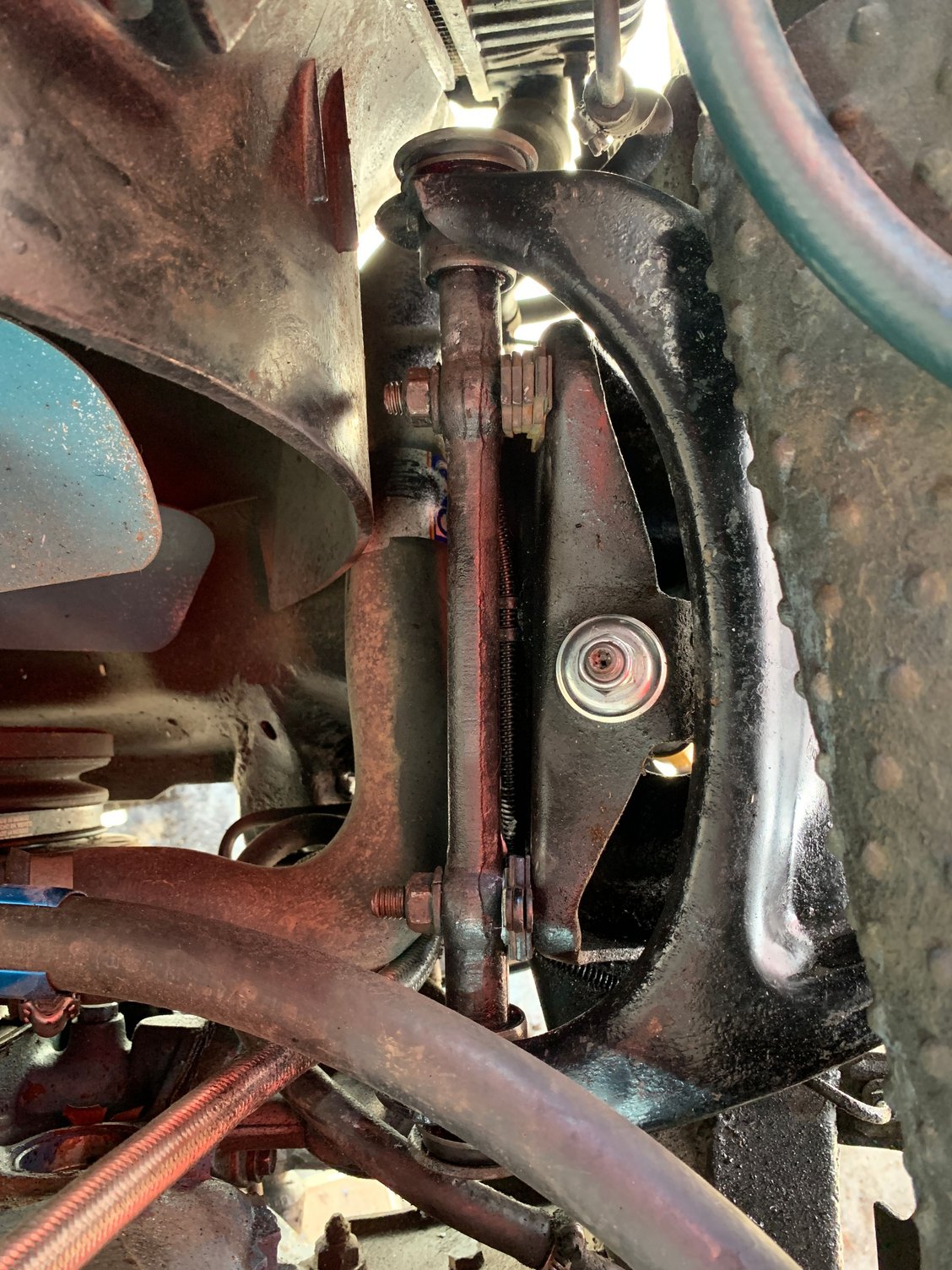

It appears there's a bushing missing from one of the lower control arms (and all others have degraded to manure)

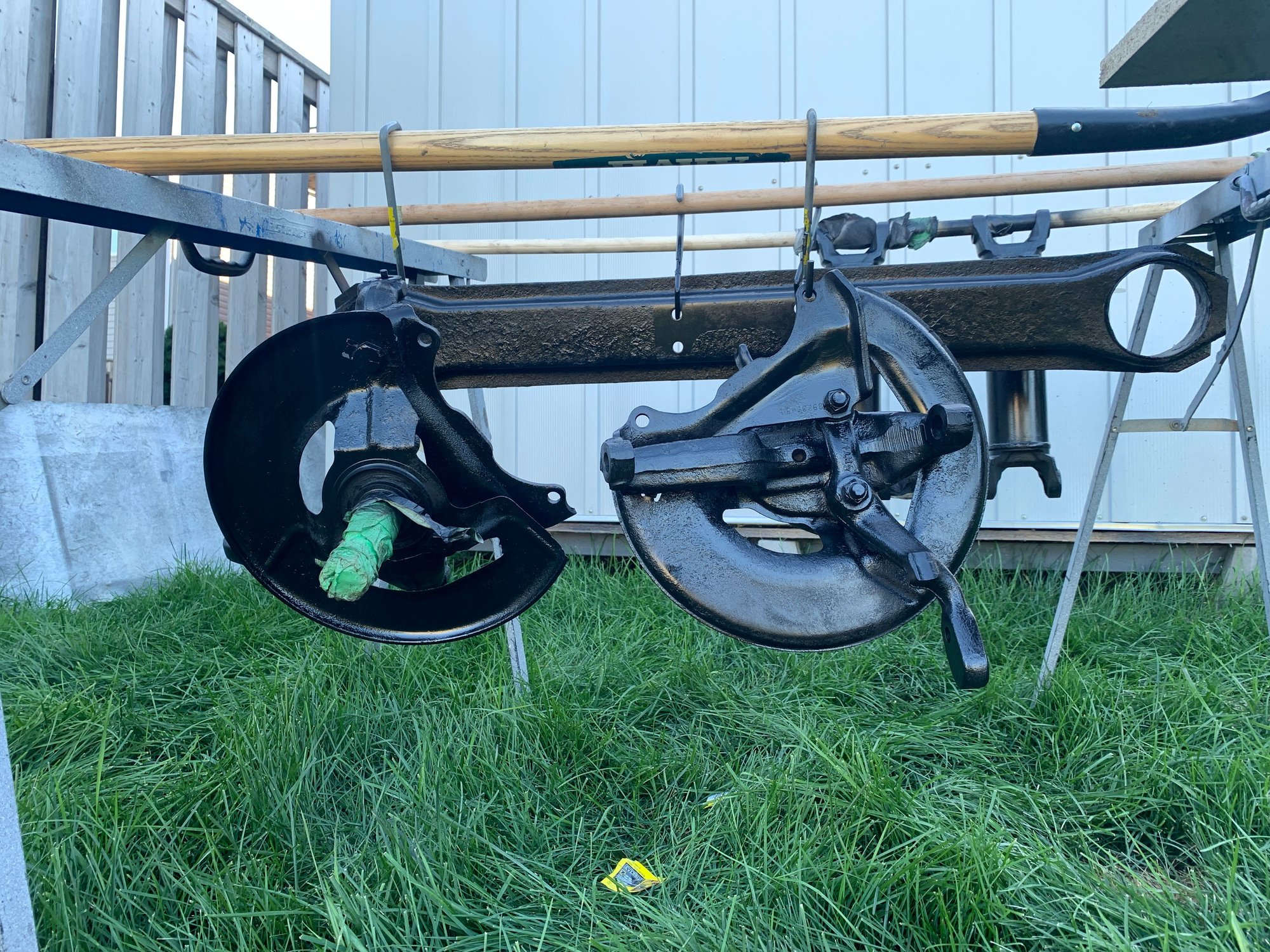

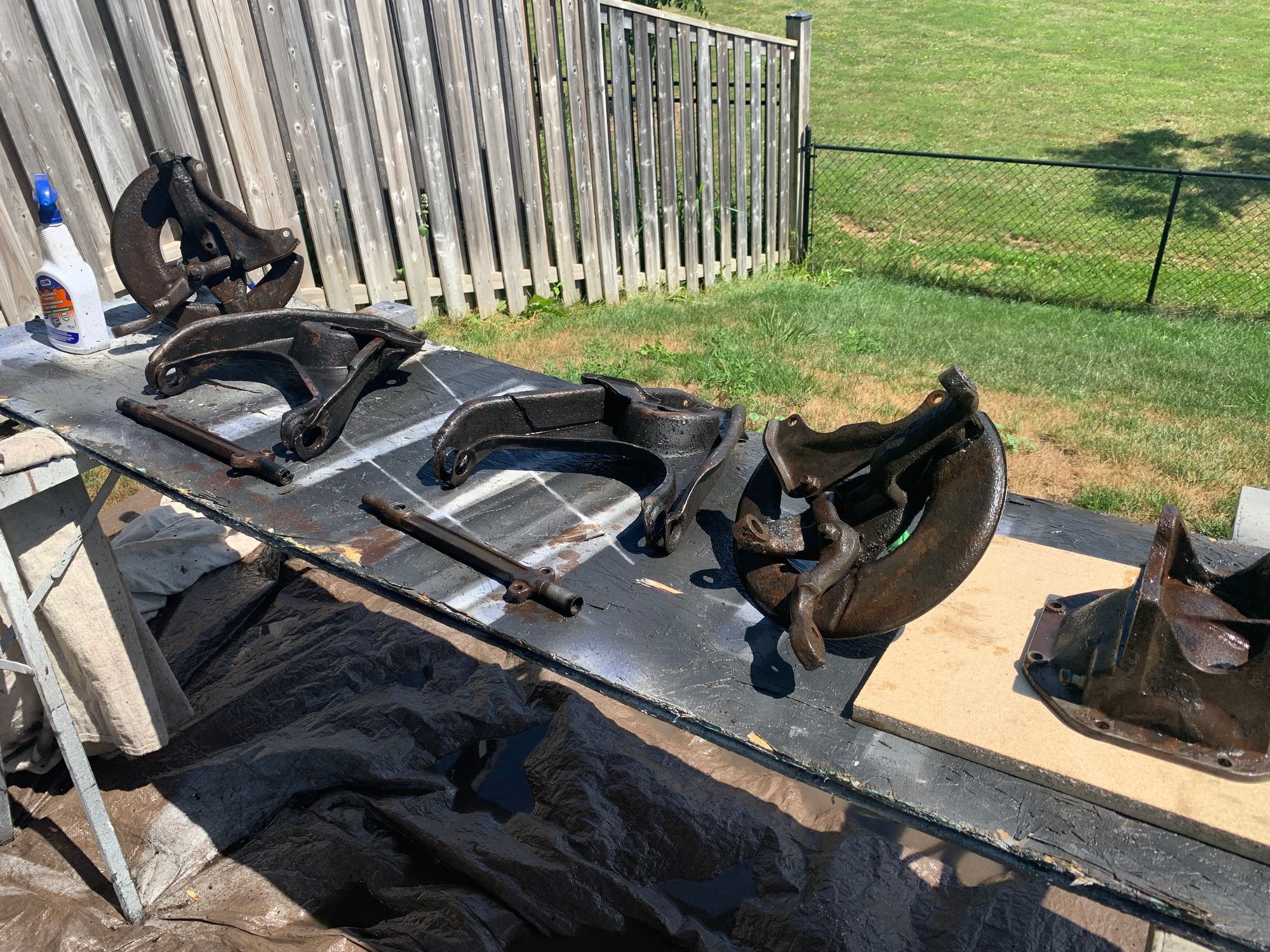

Happy Sunday all!

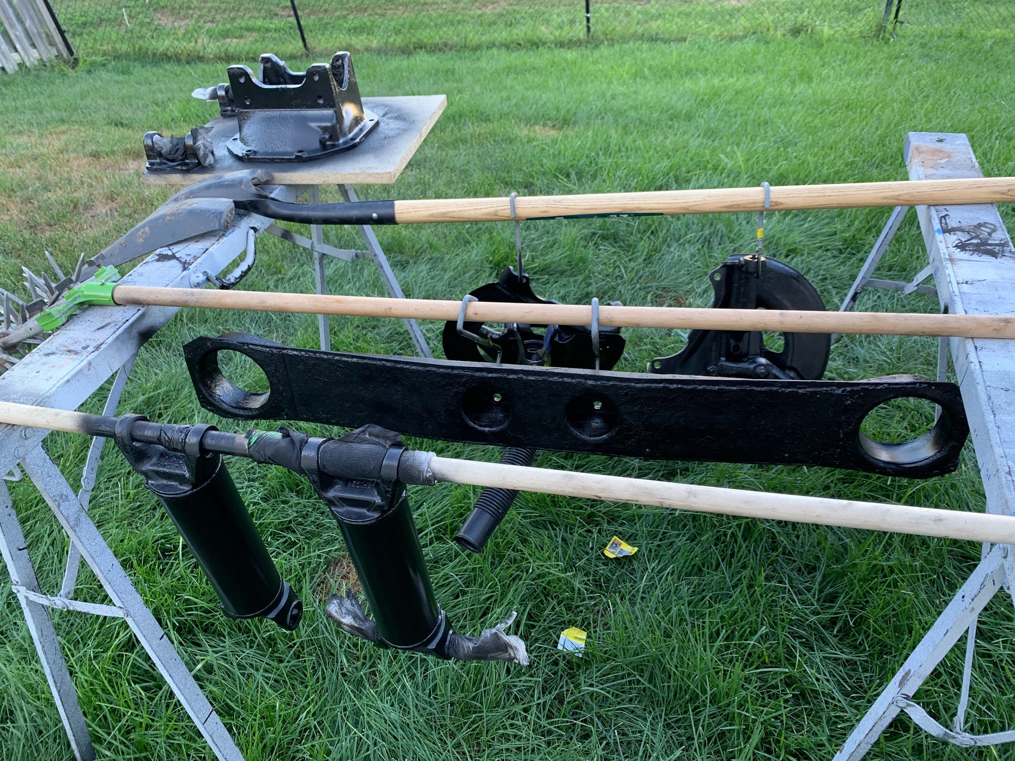

Not a lot of exciting updates but figured I'd share the progress on the Vette. Today was clean up day!
Still have to pull the upper control arms and tackle the trailing arms but pretty happy with how it's going so far! Couldn't do any of this without all your help

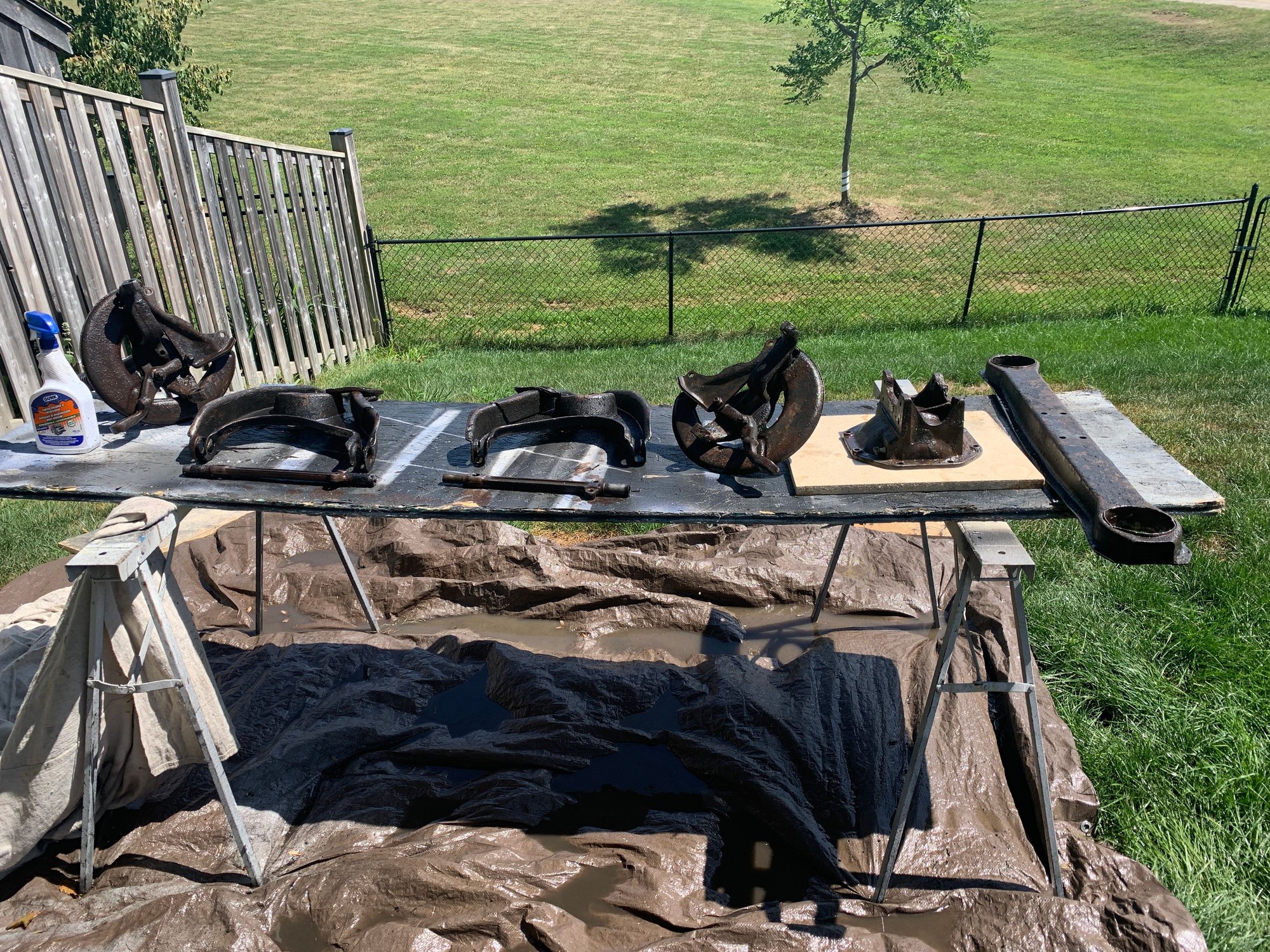

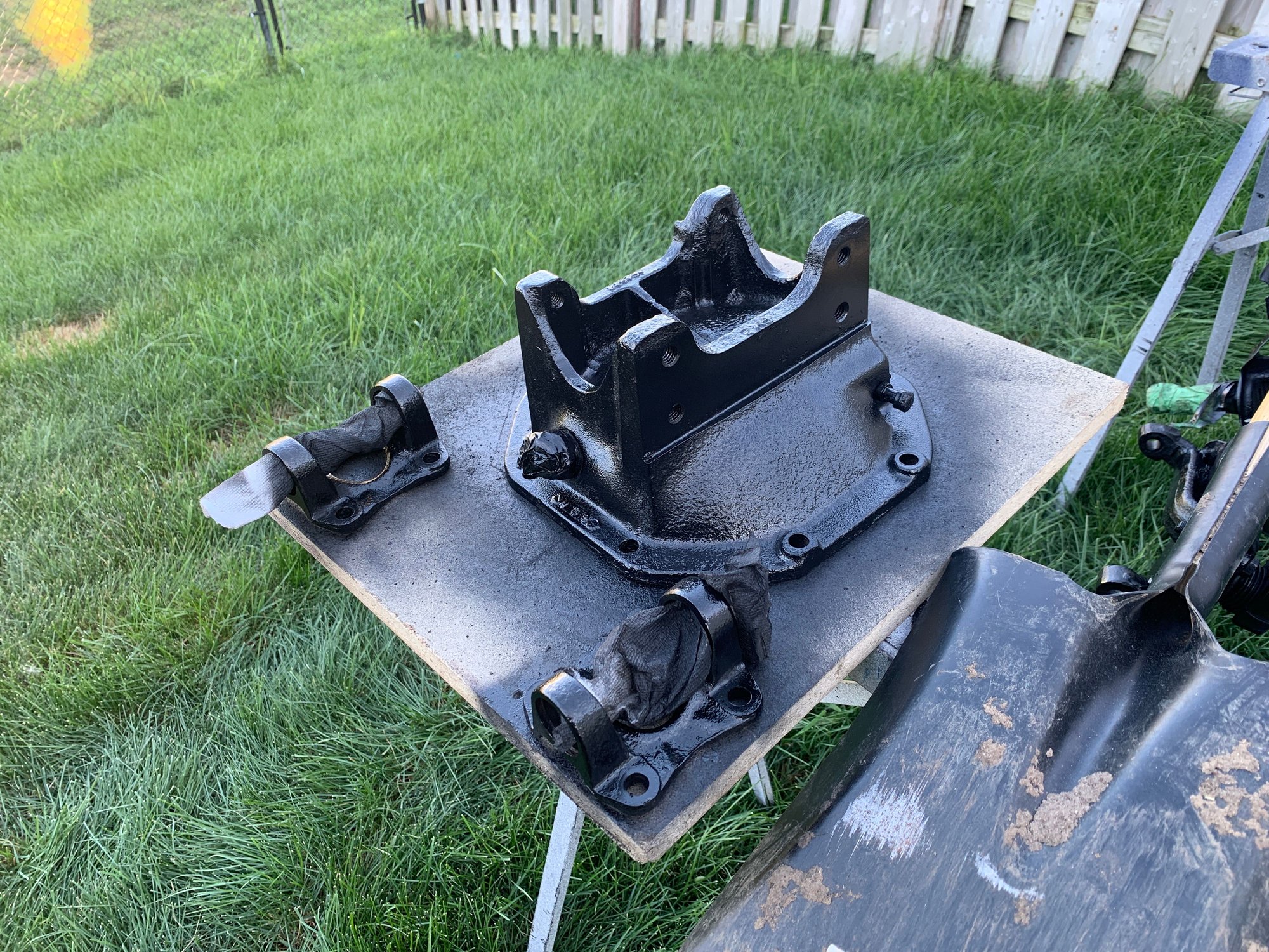

Cleanup continues!

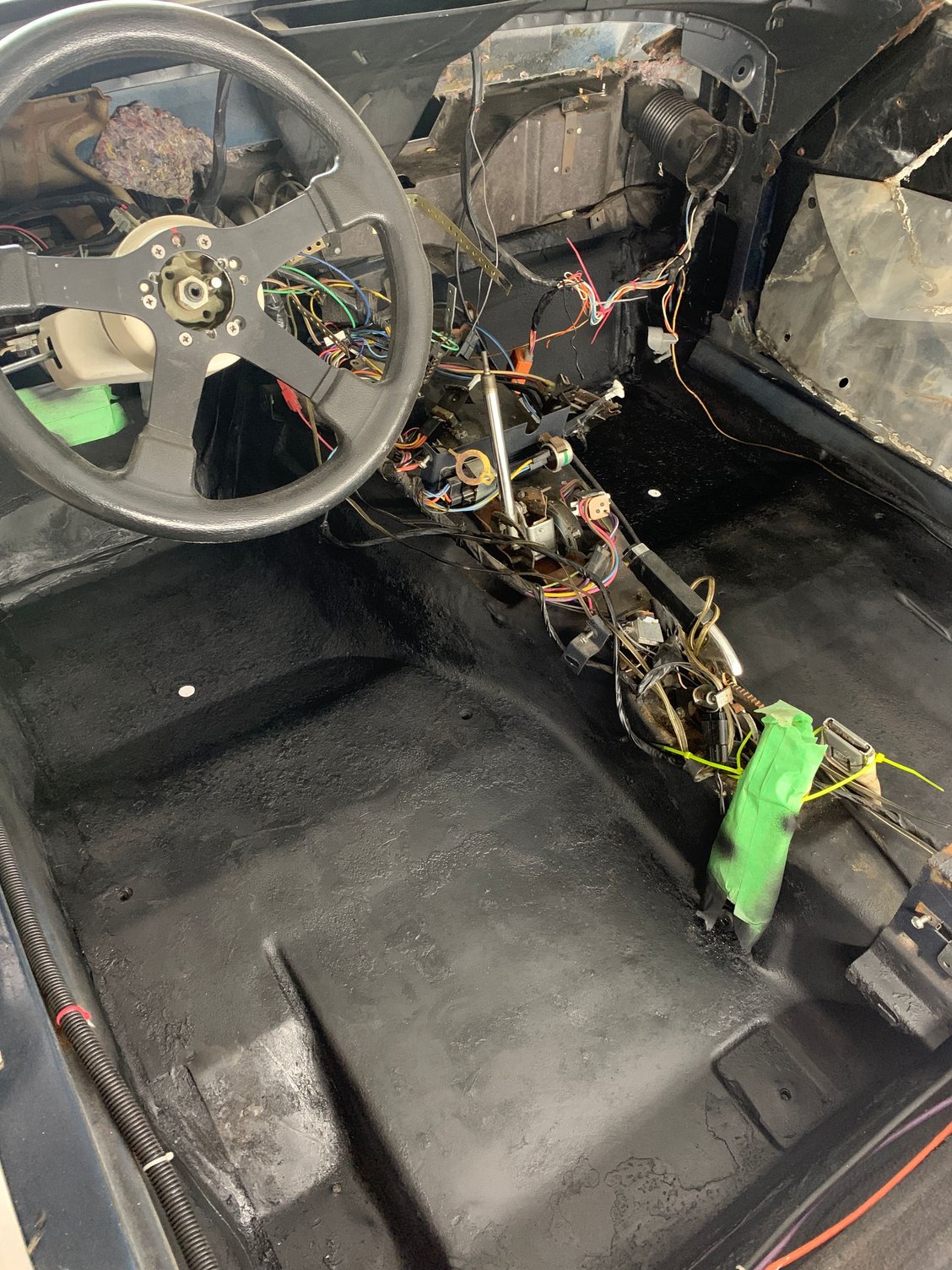

Been mostly dealing with both front and rear suspensions these days but today i took a break to do some interior finessing
Before:
After:
Floors seem pretty solid but i might still reinforce them with fiberglass. Seems like a good spot to learn how to use it since it'll be covered anyway
Pretty satisfying to look at the before and after

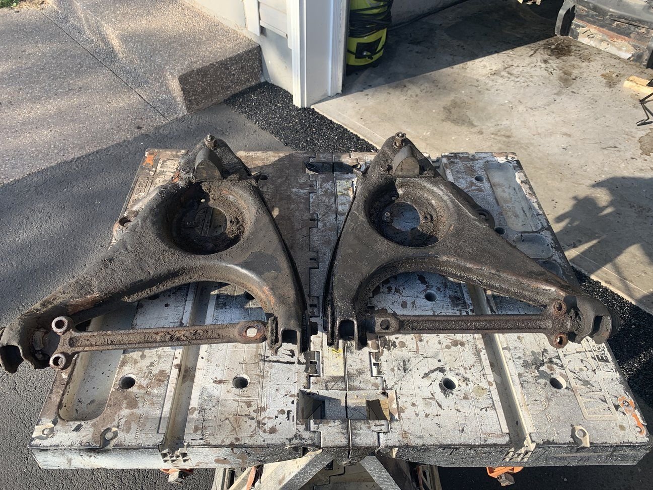

The Vette has been getting some love lately
Before:
After

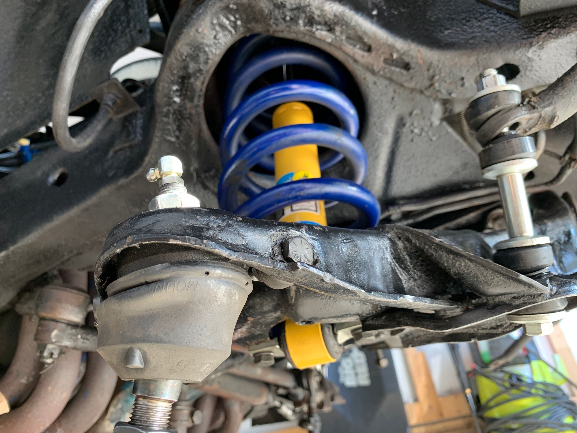

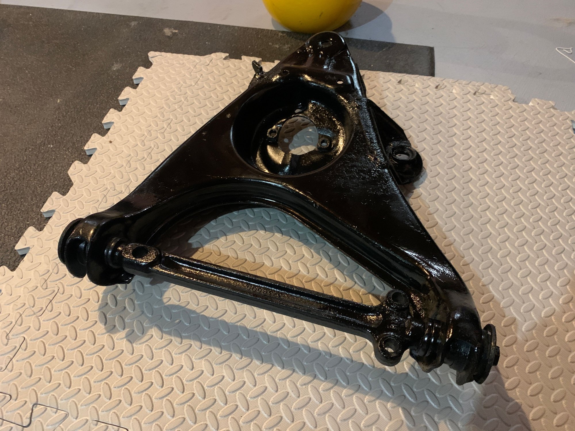

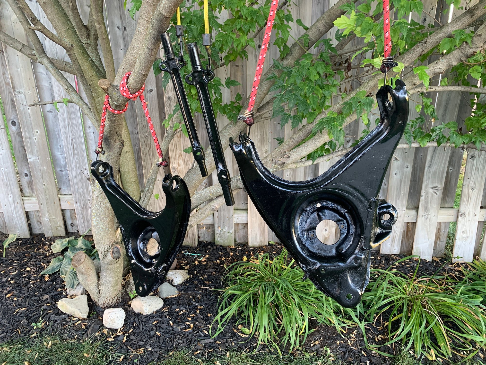

Upper and lower control arms getting new Moog bushings and ball joints all around

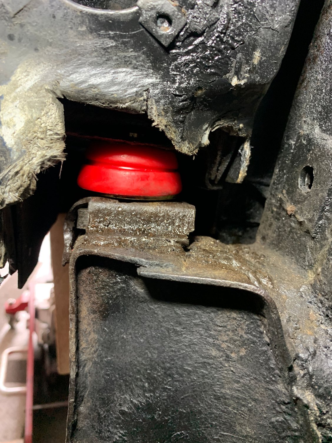

Happy Saturday all!

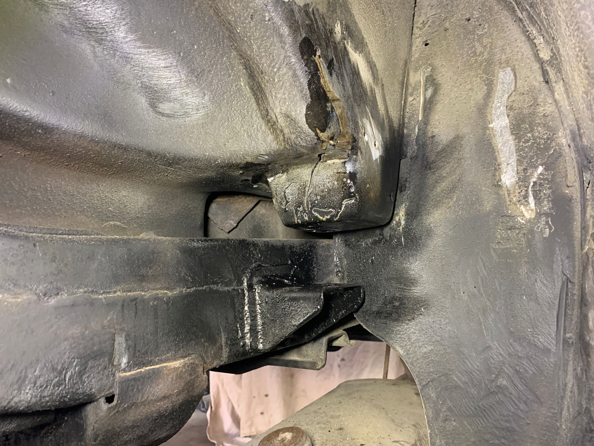

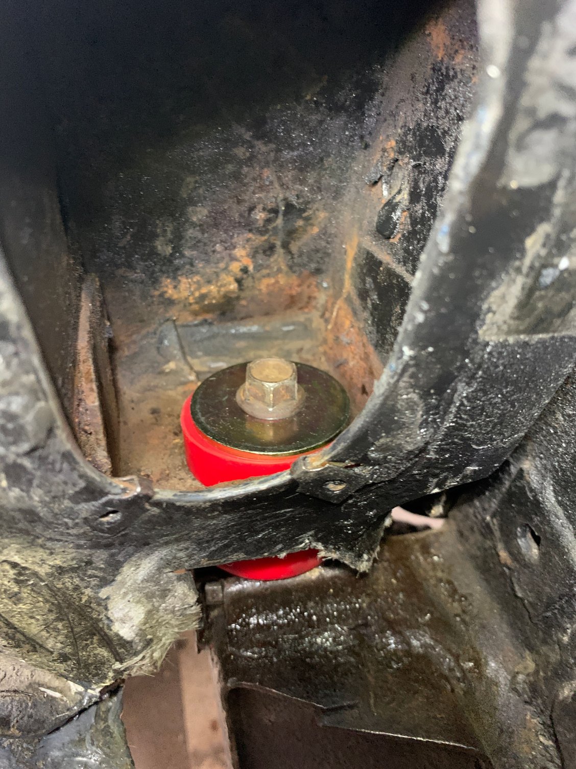

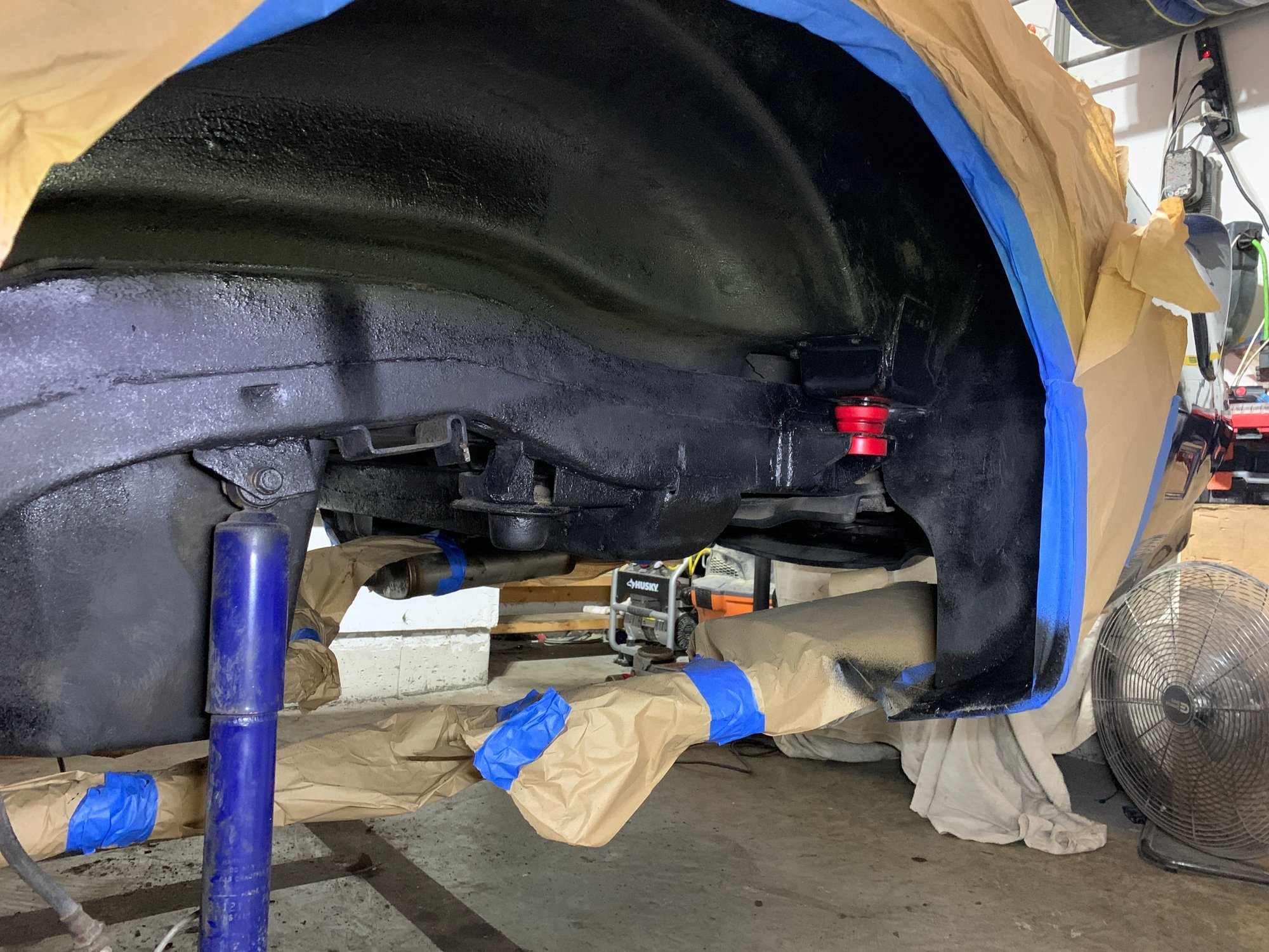

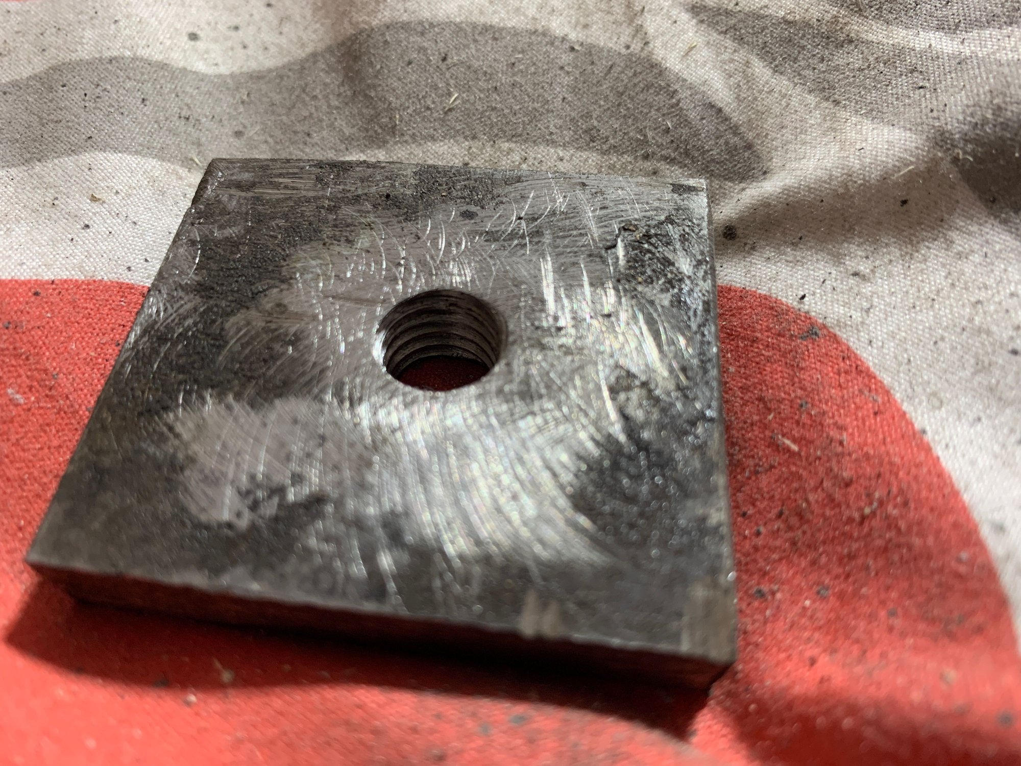

Today was body mount day. Had to make a cage nut for #3 and replace both body reinforcements and cage nut on #4 but otherwise seems to be going smoothly

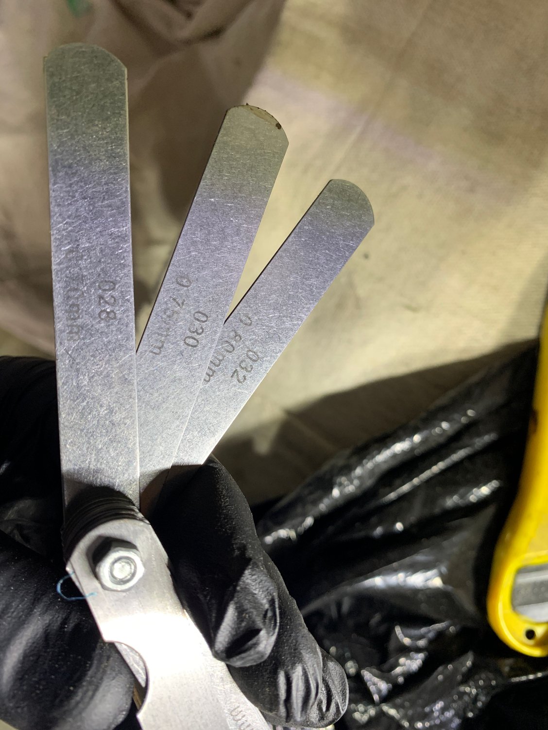

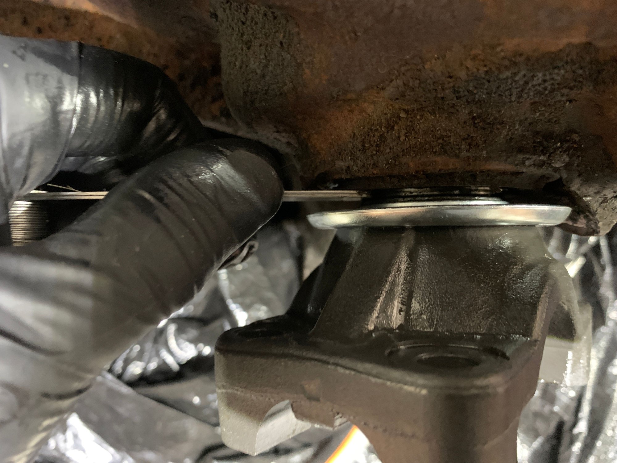

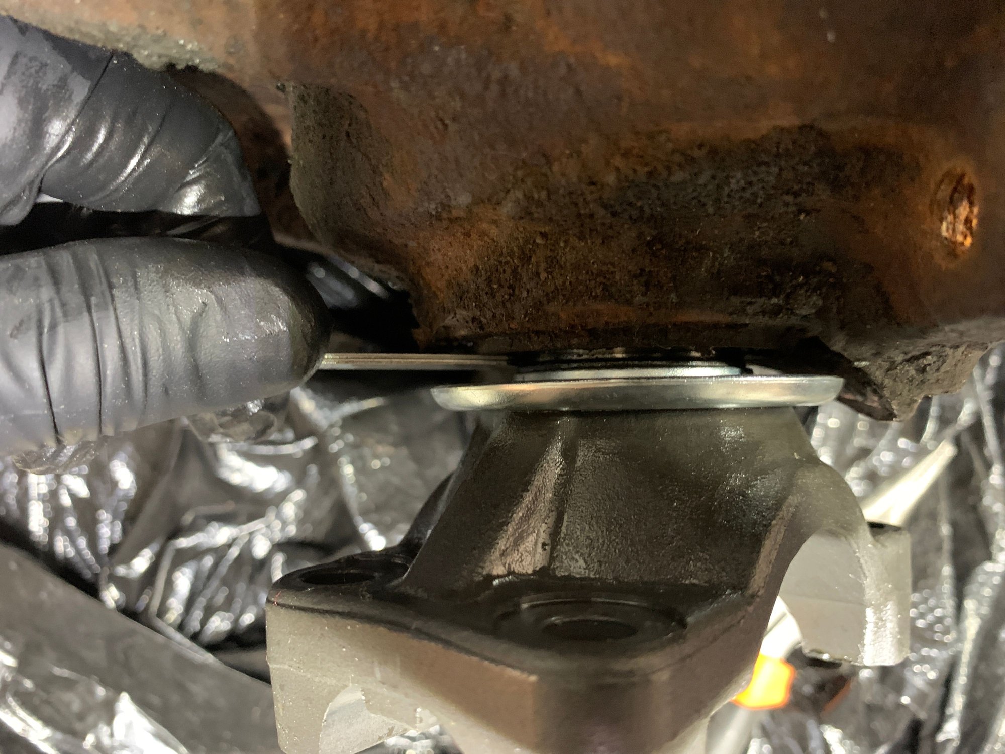

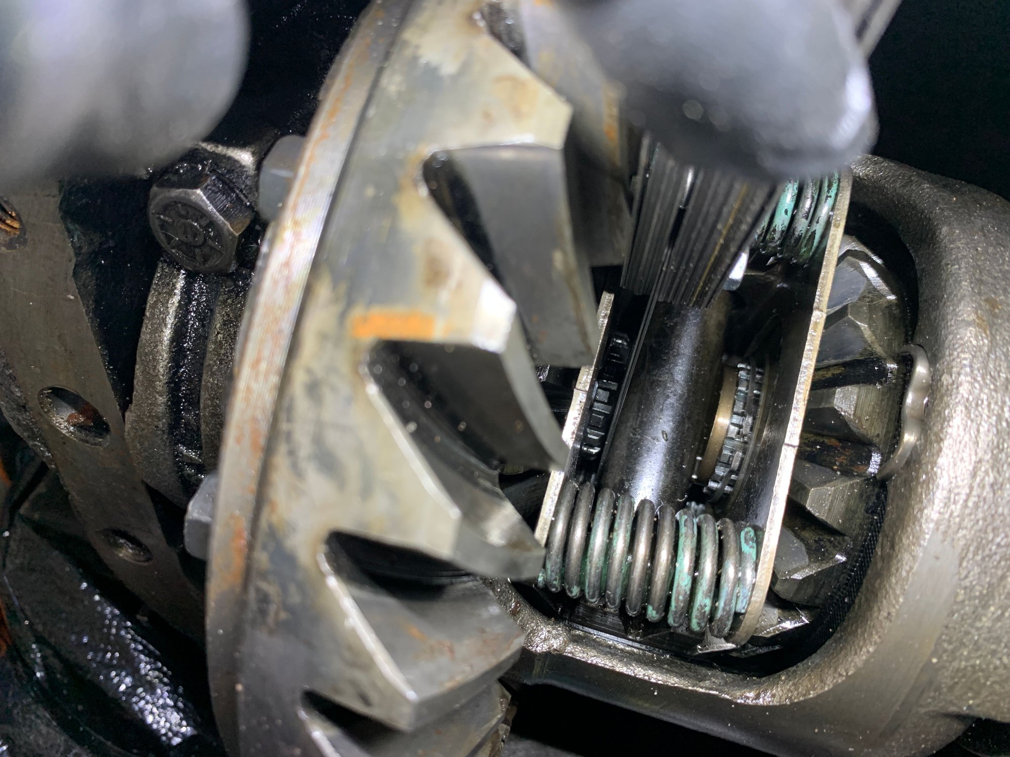

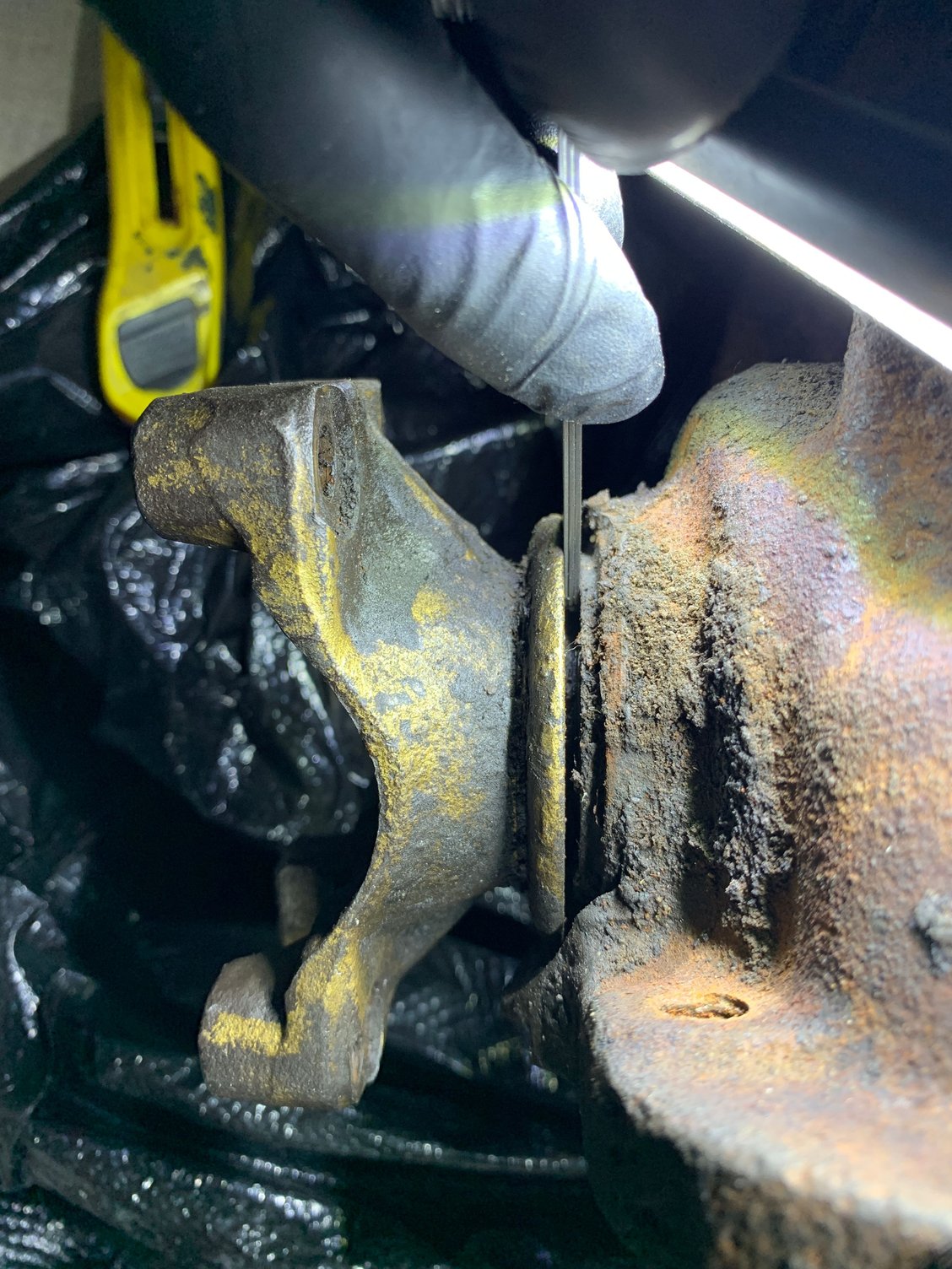

I've also been tinkering with the diff but unfortunately the new yokes don't seem to have addressed the yoke play (at least I don't think so, I have another thread going on describing this issue in more detail). Seems like a rebuild might be in order
Old Aug 29, 2021 | 12:00 AM
doorgunner's Avatar
doorgunner
2026 Loser of the Year
Posts: 36,601
Likes: 7,048
From: New Or-leens Loo-z-anna
You have some good pics of the differential that show exactly where you were measuring end-play
(The car show pics look good considering they were "Drive-by Shots")
Have you looked for specs. about what the end-play should be between the yoke shaft face and the hardened pin?
GTR1999 has been helping me with yoke play. Above .05 appears to be around the threshold to consider a vendor build. Nowadays they can set them up to .005” or so. I’m going to make some phones calls and find someone in the area that could help with this - not a job I’m ready to take on my own.
Since I want to make upgrades to the power plant within the next year or so, I’ll probably need the diff rebuild anyway, we’ll see

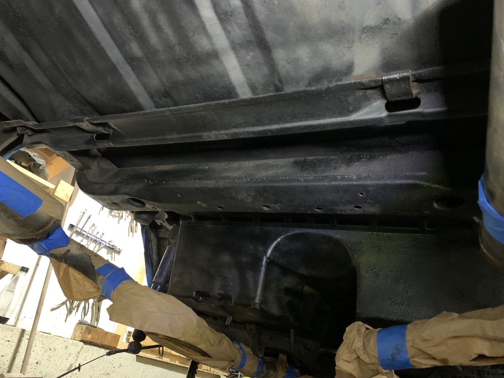

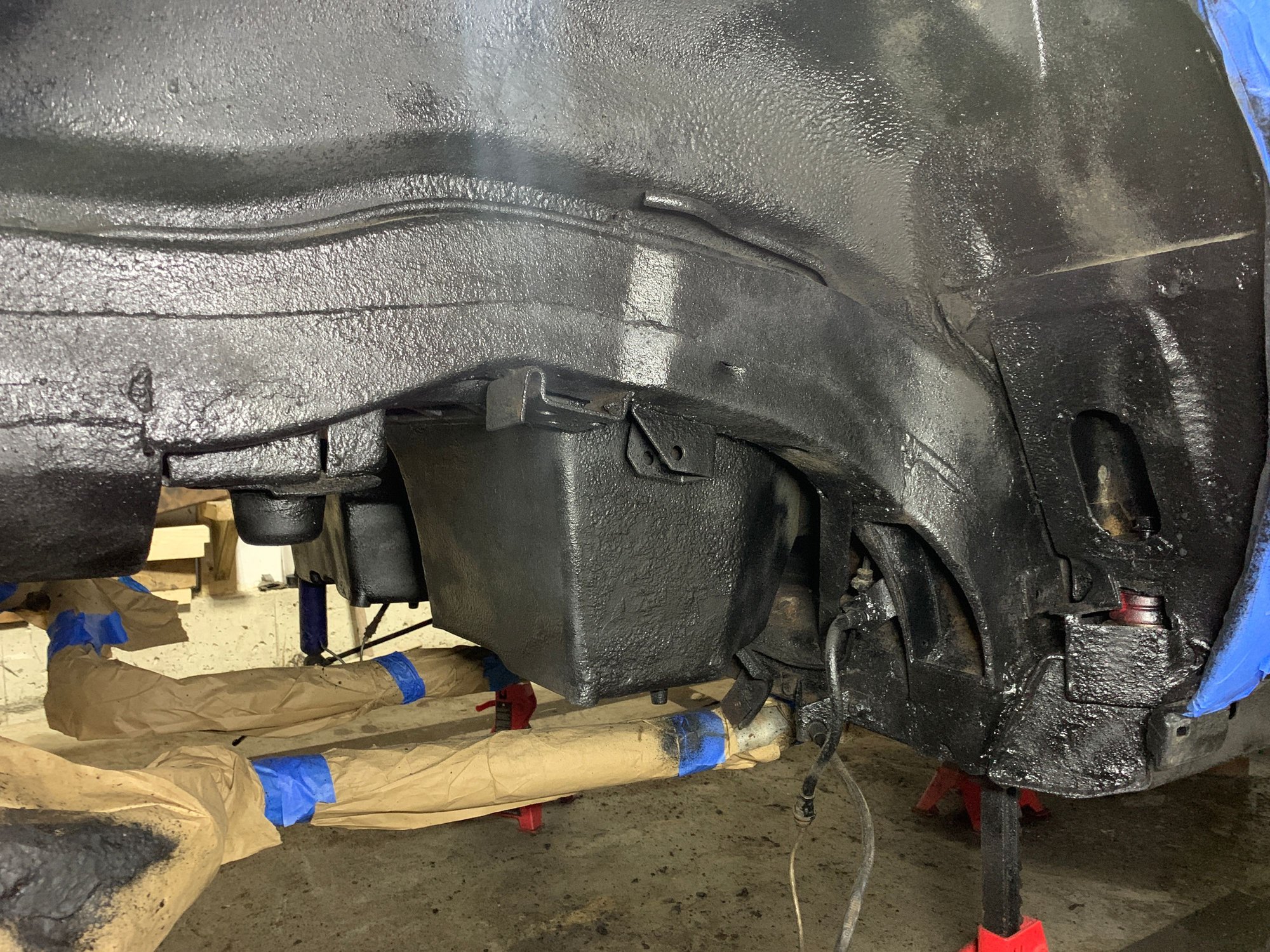

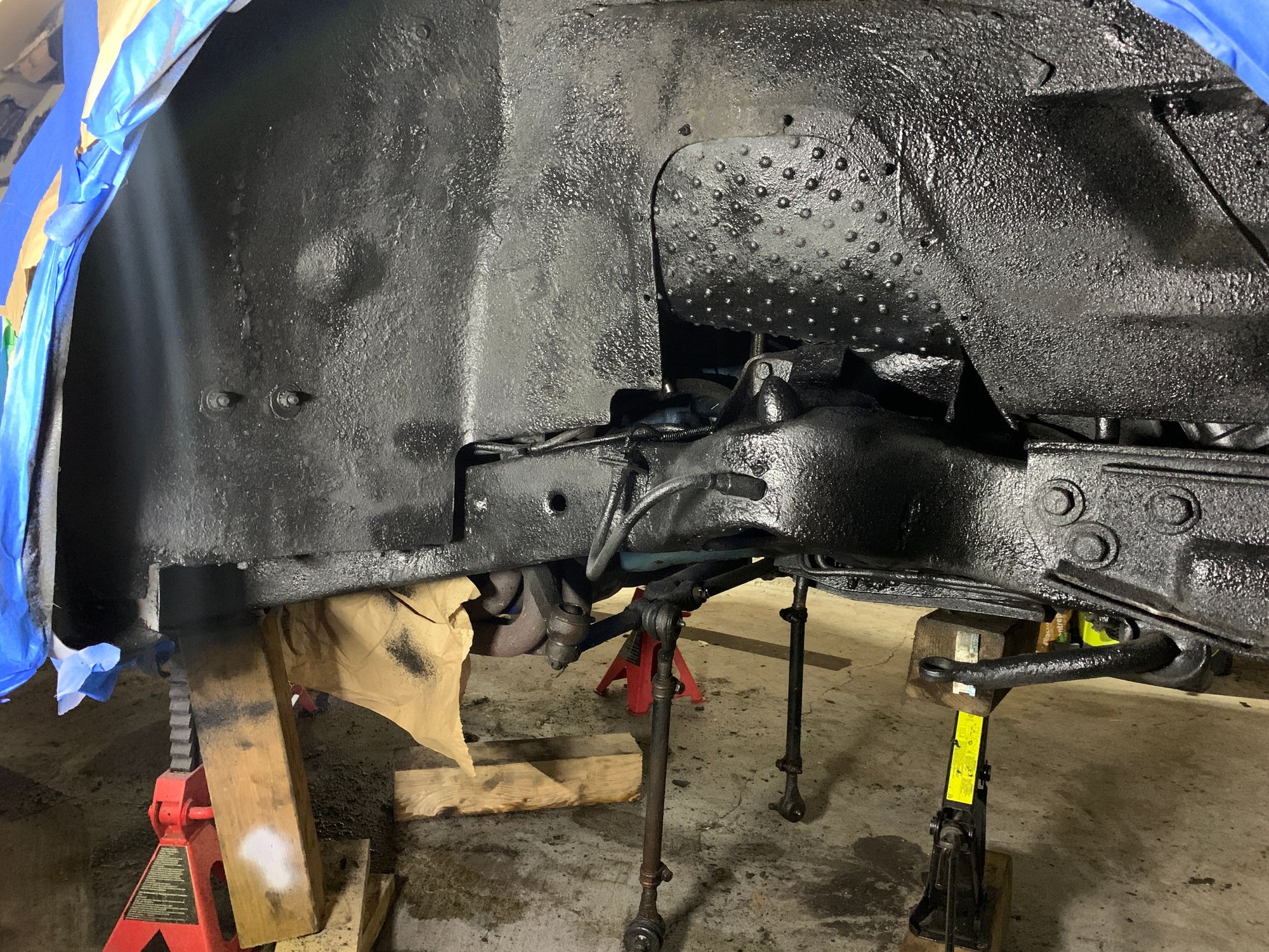

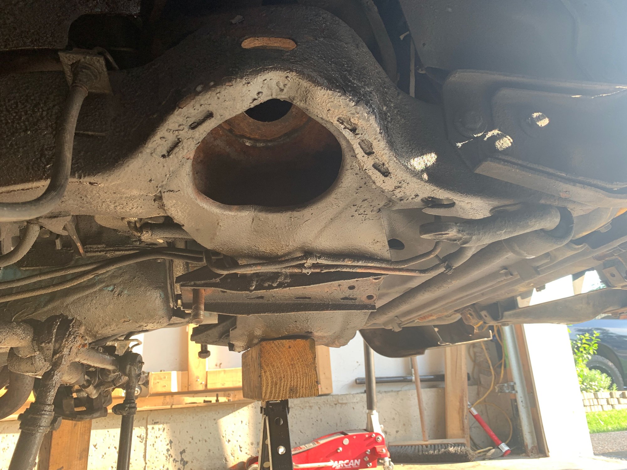

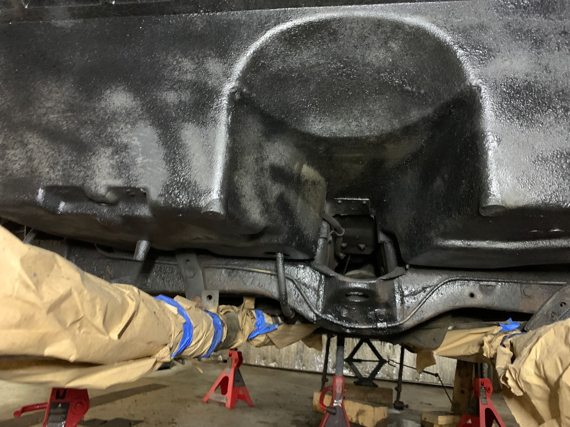

Cleaning up the underbody without a lift has been a pain but she's finally starting to look pretty underneath.

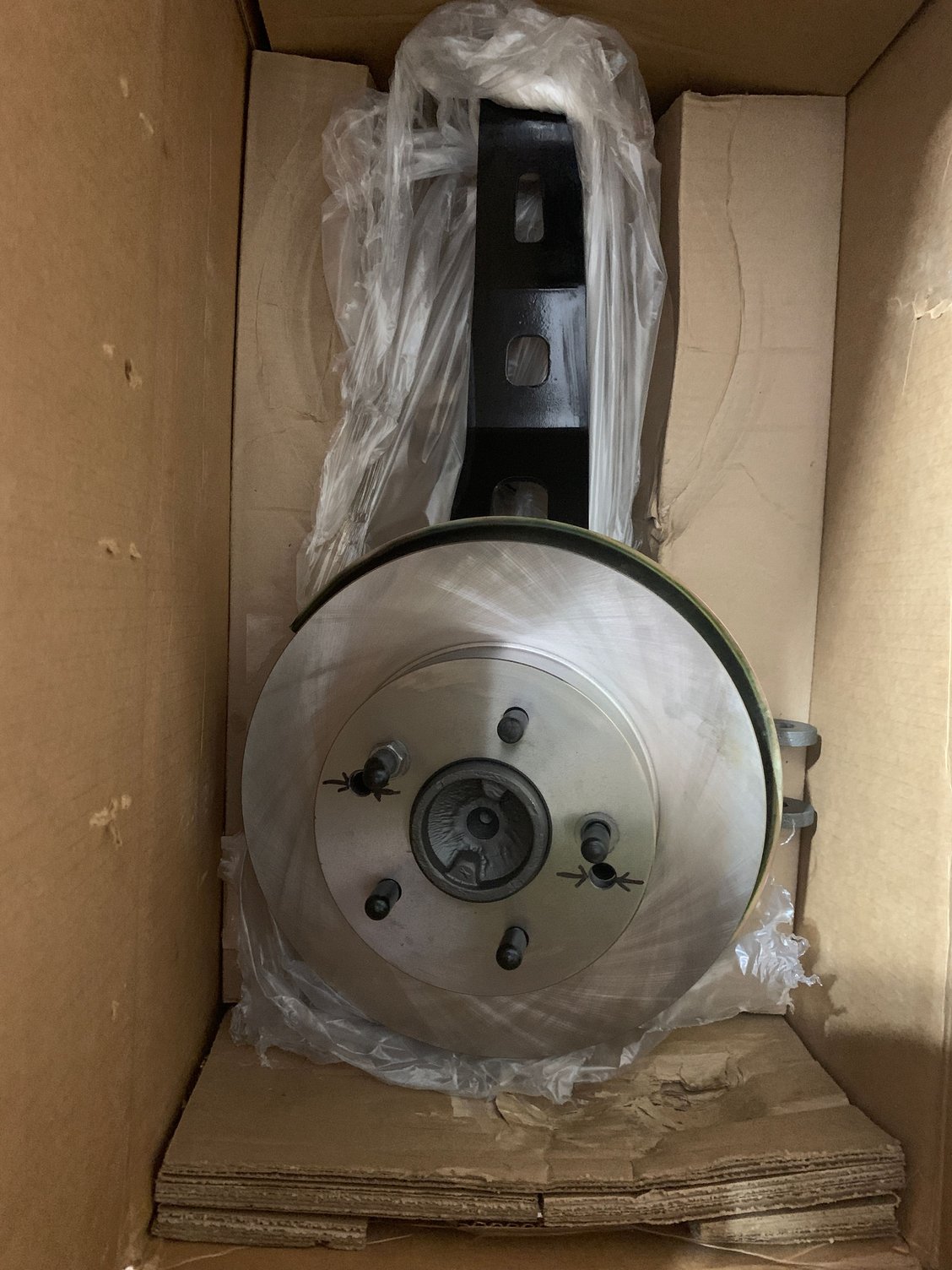

Crossmember bushings, brake lines and rear suspensions should be here this week and after that I should be able to start putting it back together

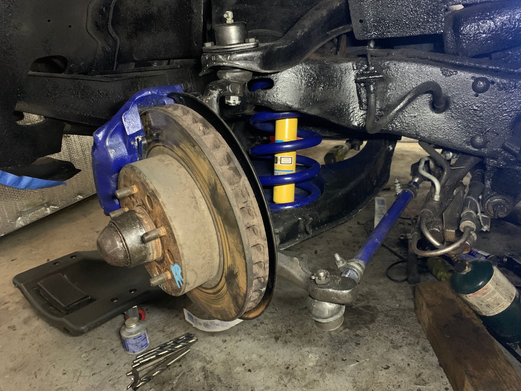

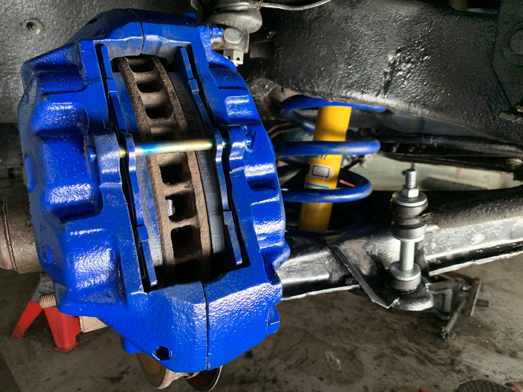

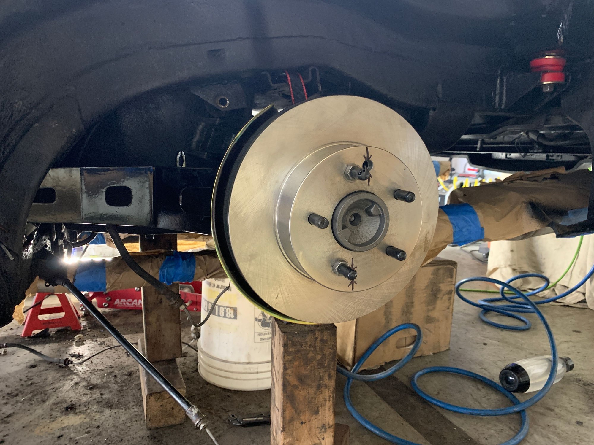

Slowly making progress!

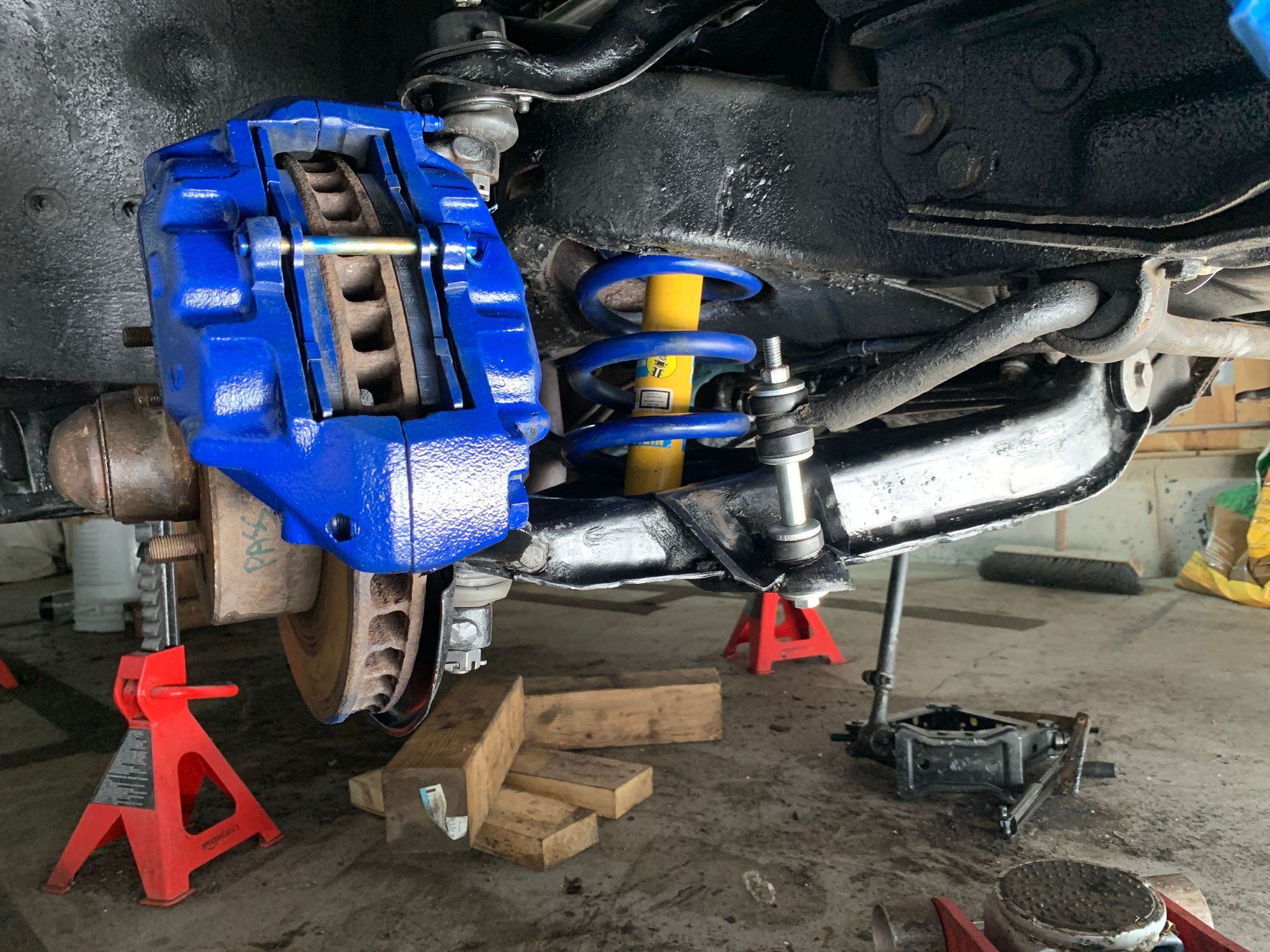

Today was front suspension installation day. The spring compression tool I bought didn't work on the inside of the spring so I had to MacGyver a steel plate to keep the spring aligned at the top but otherwise wasn't too bad a job. Doing bushings on the control arms was definitely a lot harder

From: Kitchener, ON, Canada

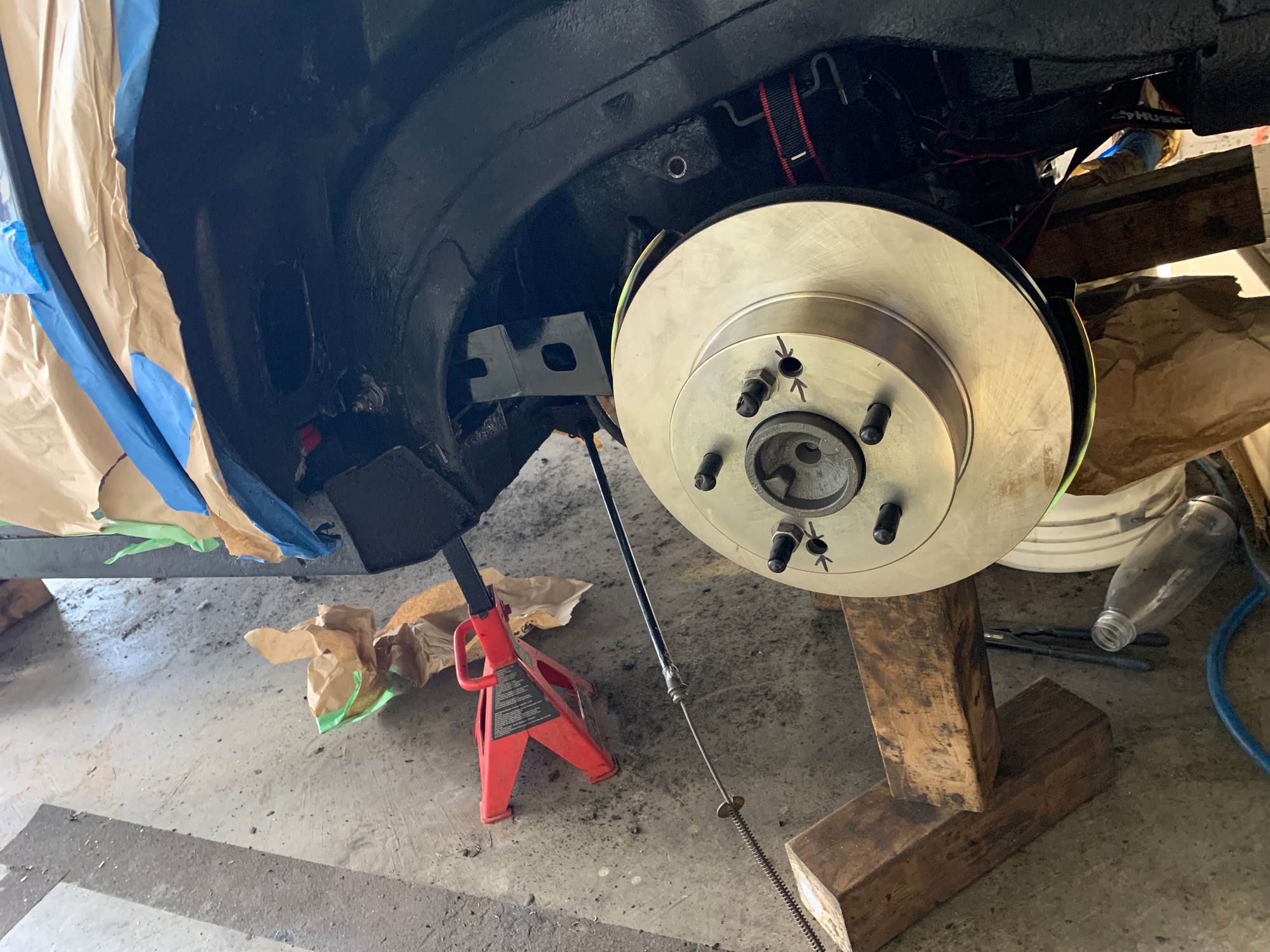

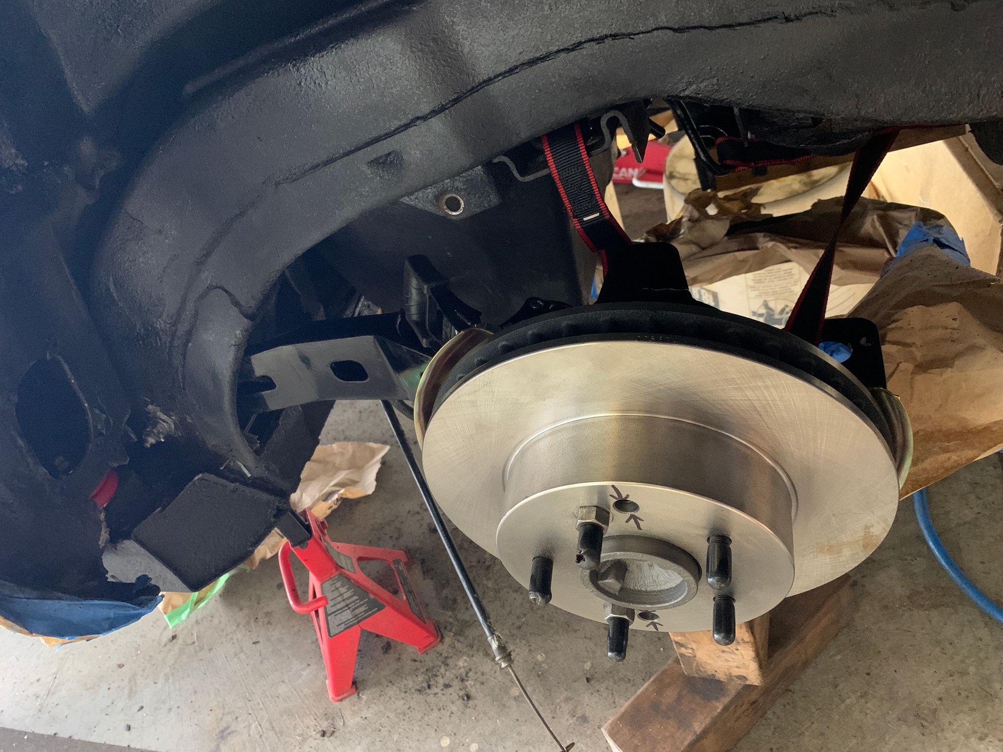

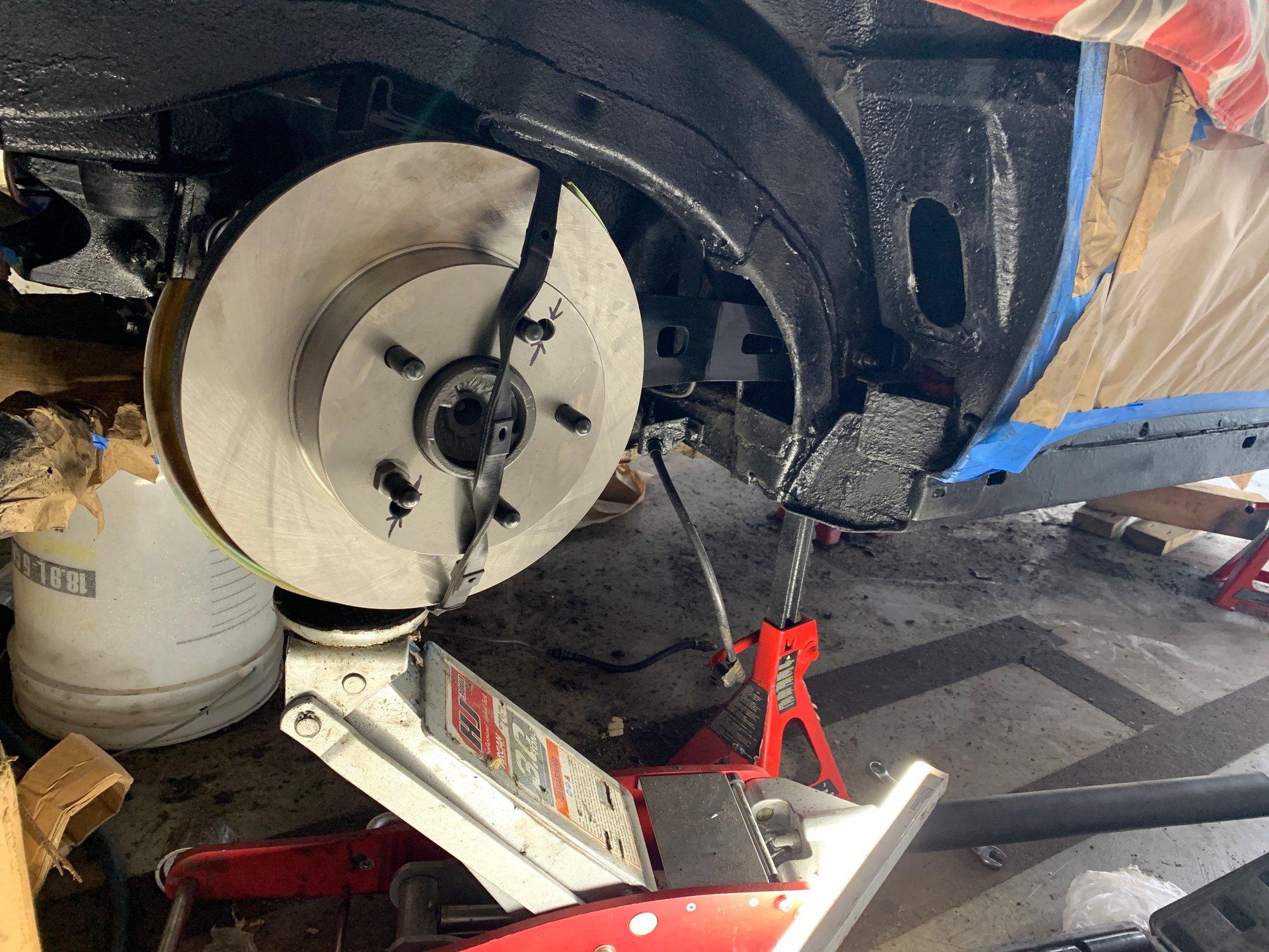

Front passenger side back together
will probably get around to replace pads and rotors but pretty stoked to have something back in the car!
driver side next!
happy long weekend all

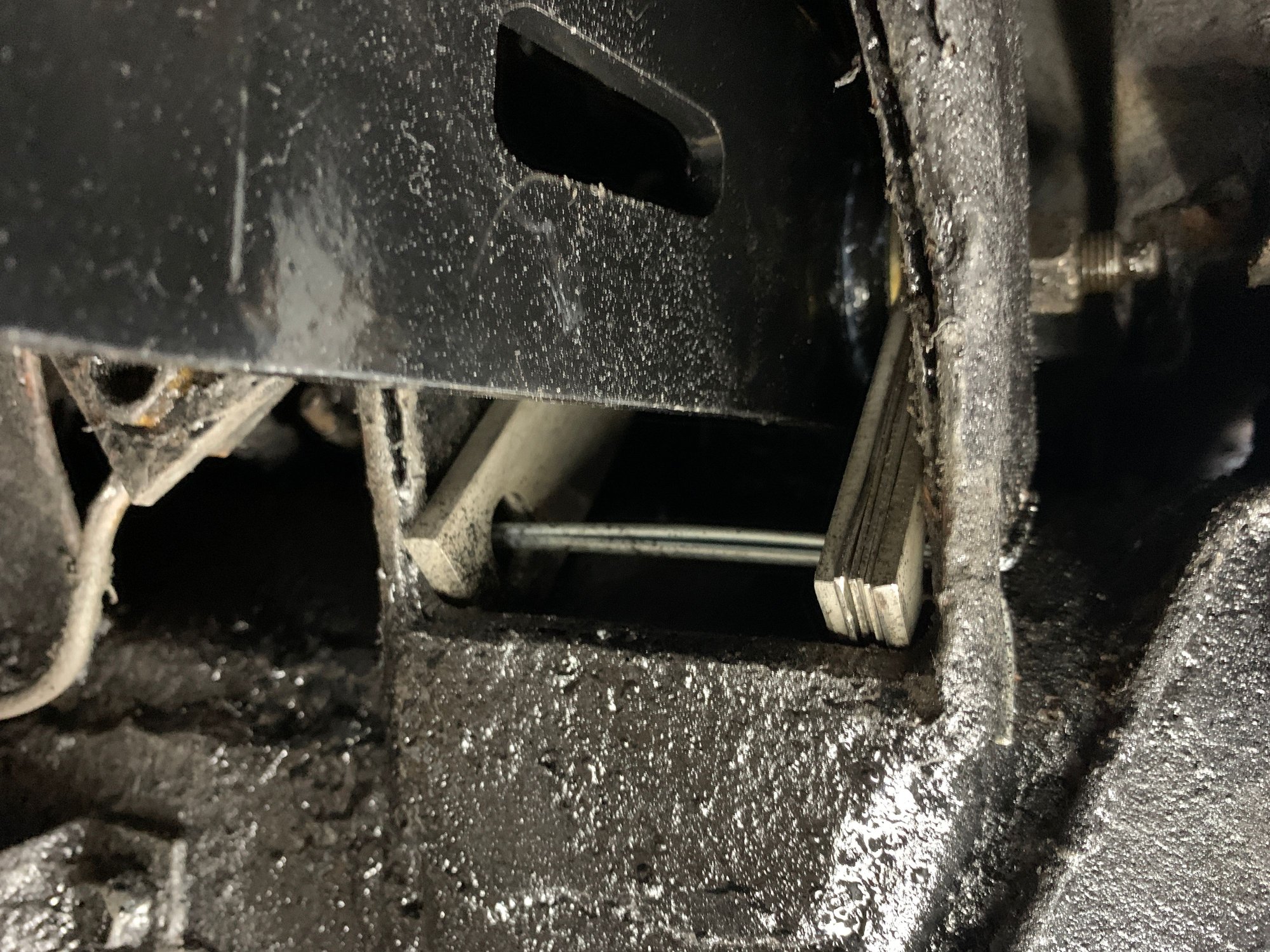

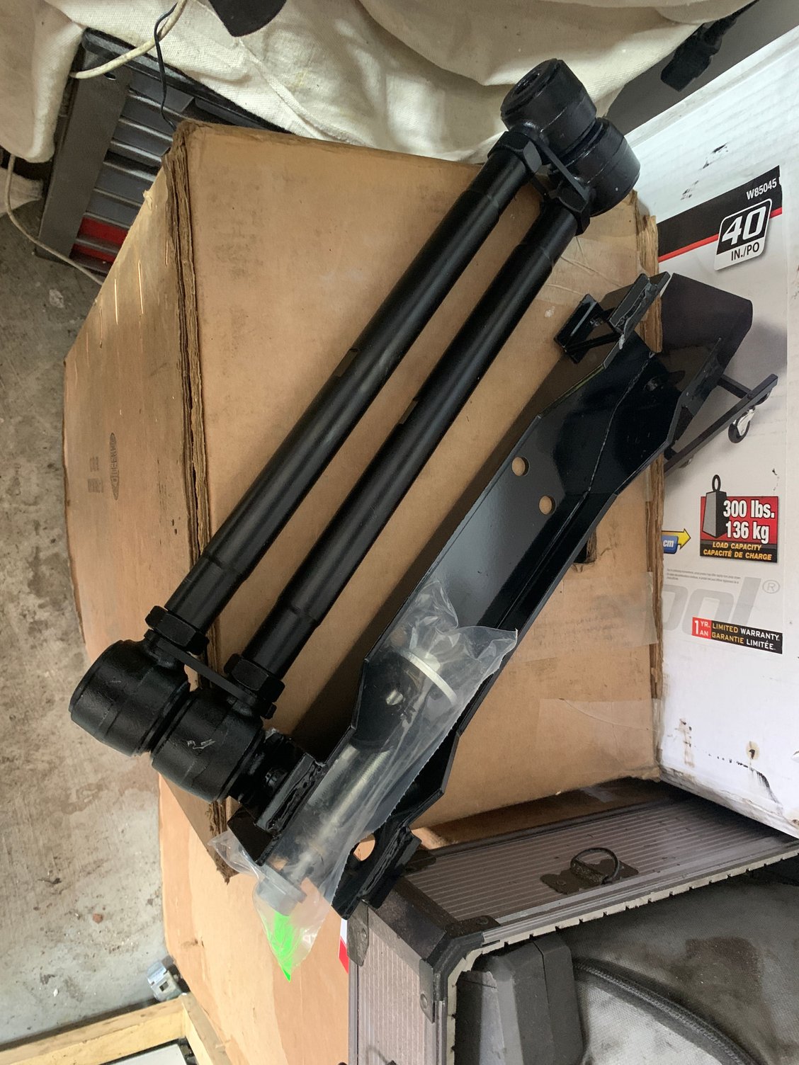

Trailing arms are in!

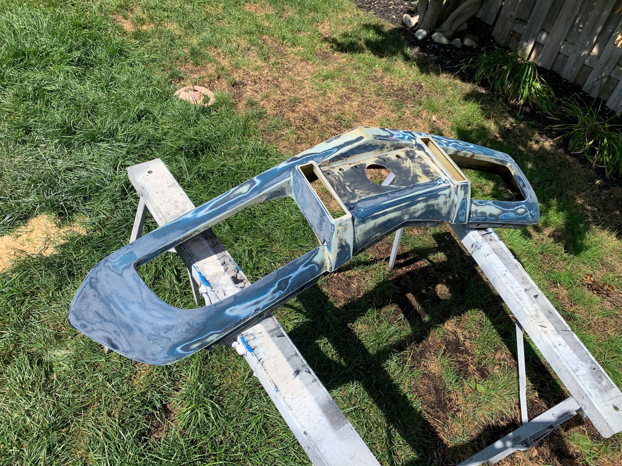

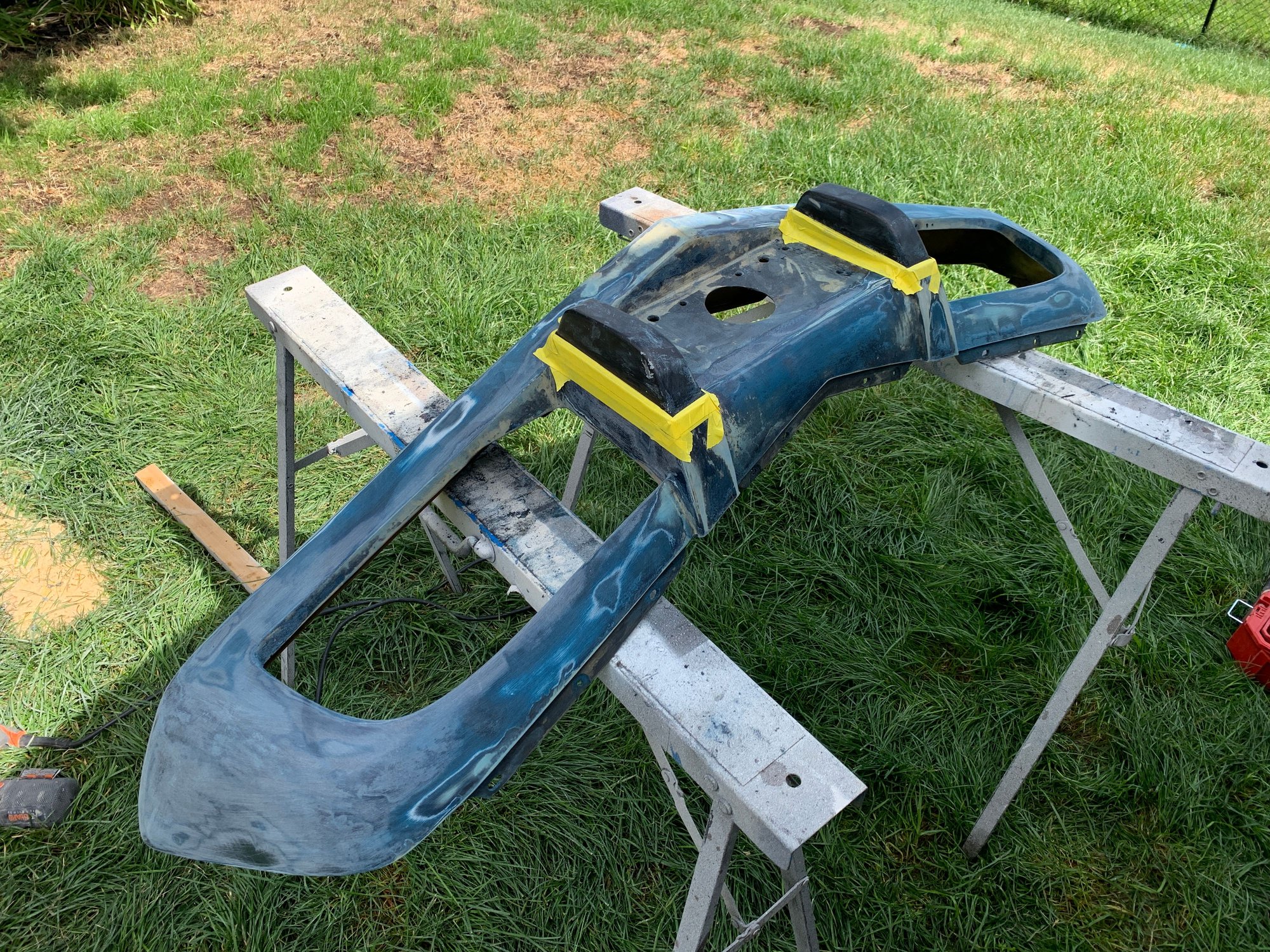

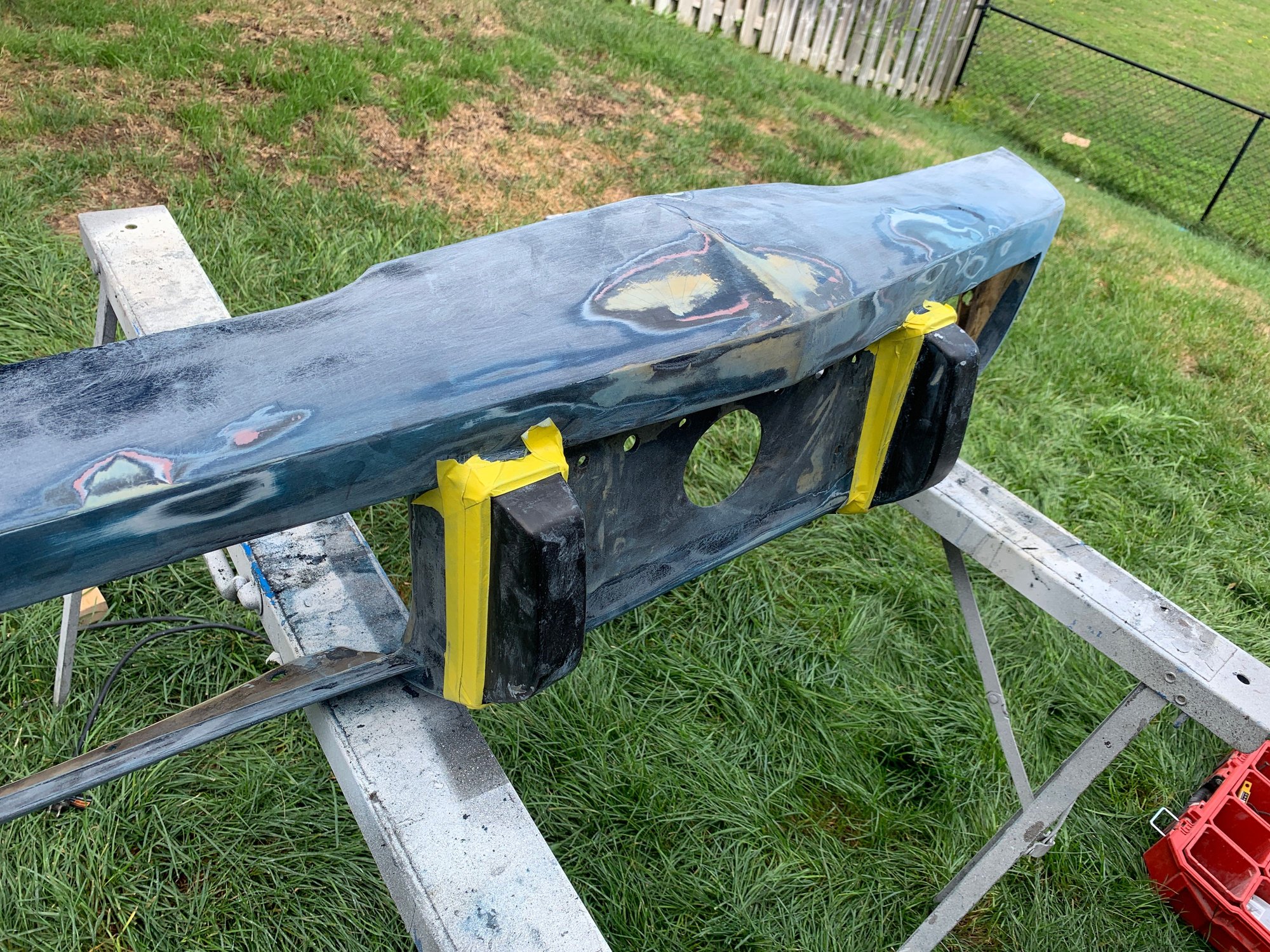

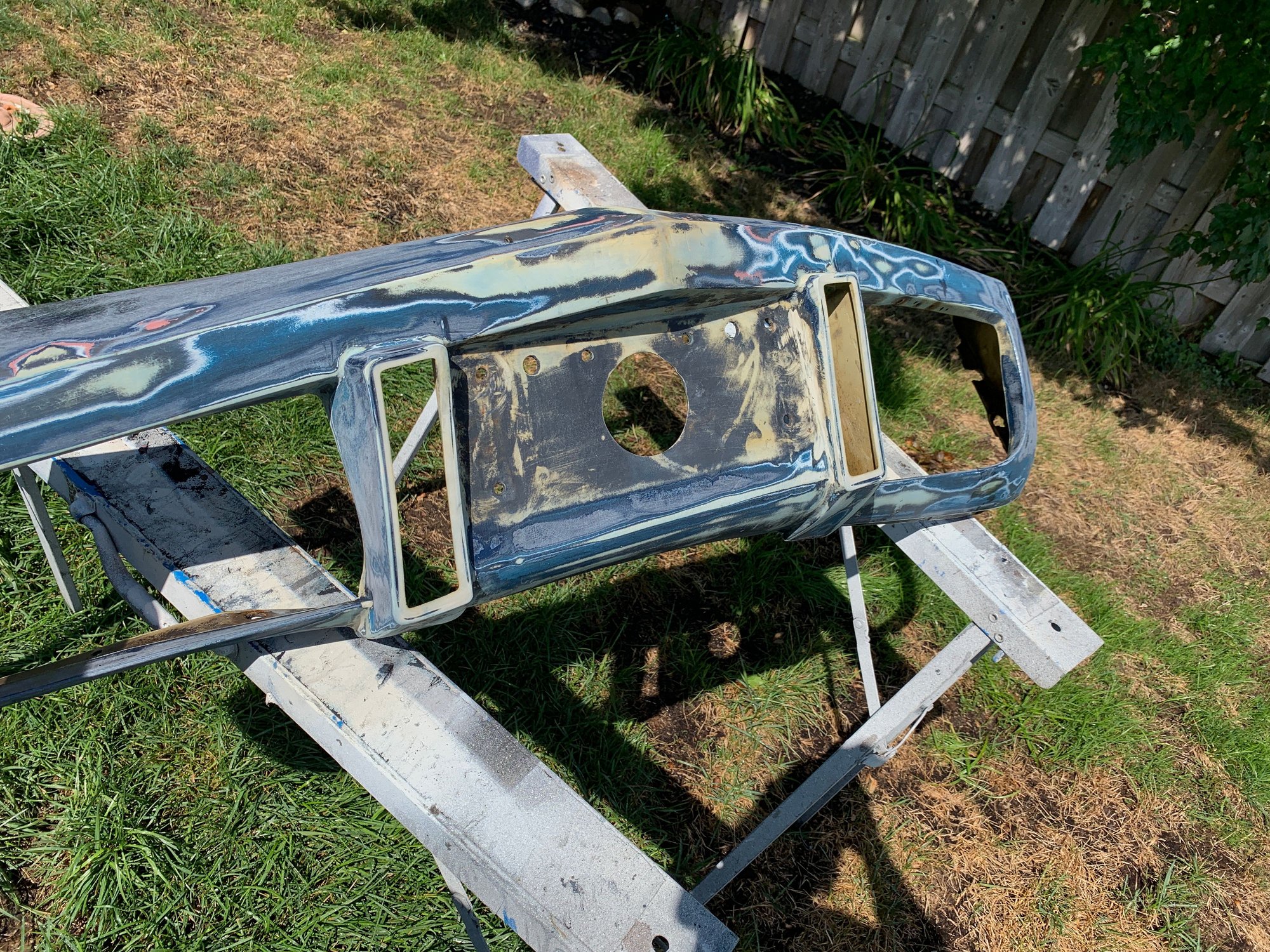

Today I ventured a bit into body work...my front bumper paint was in pretty bad shape and there was a random black stripe in the middle of it, figured I'd tinker with it although I'm still planning on getting the 80-82 style bumper down the line. While at it, I chopped off the rubber bumpers and going to 3D print some low profile replacements
A couple spots on the one side needs to be reinforced with fiberglass around one bolt hole - the first attempt at using fiberglass was quite messy, have to do some reading and watch some videos to learn how to properly use it.

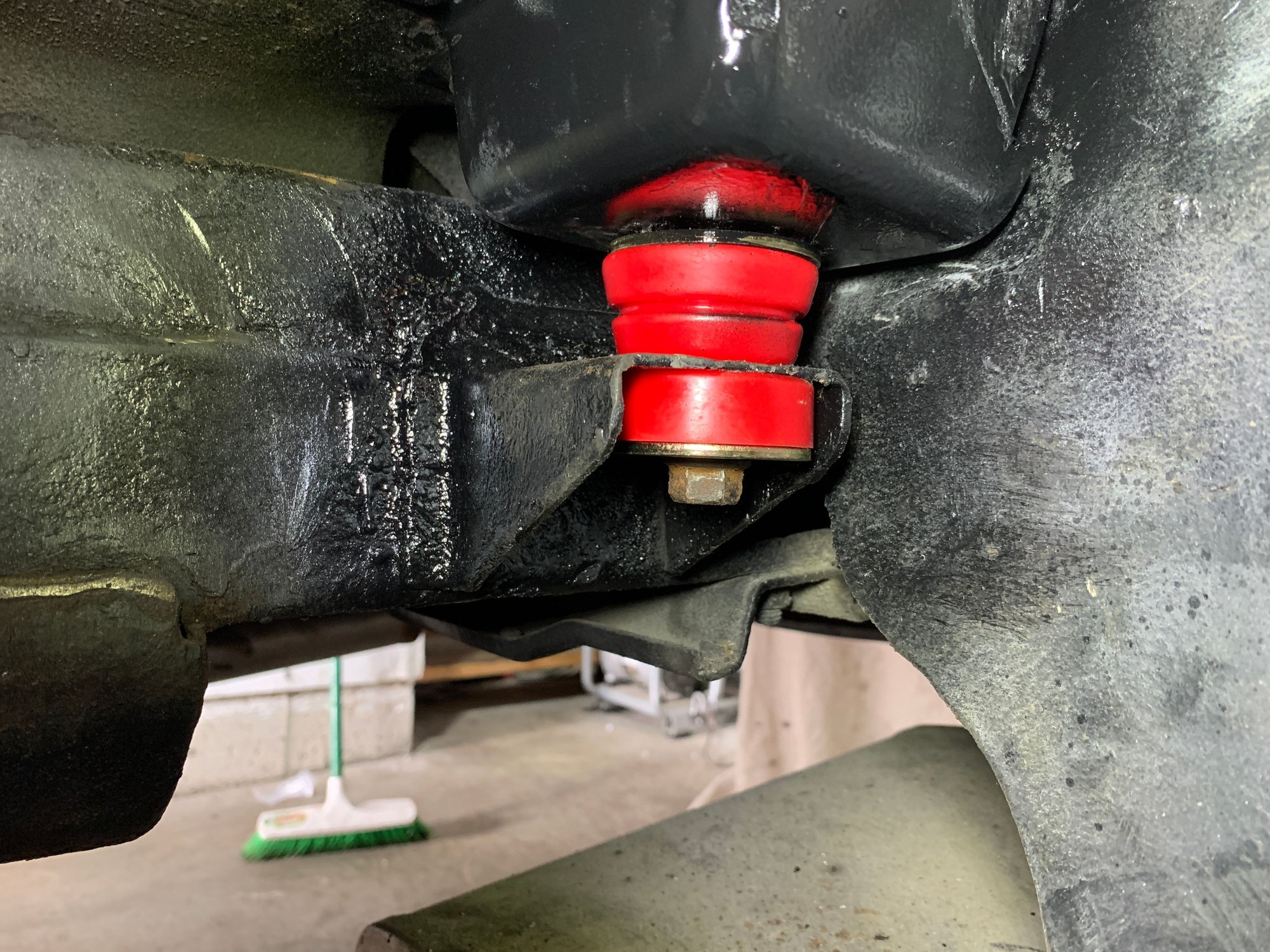

That's it for today. Waiting on my diff mounting bushing kit to arrive before I can put the rear end back together
