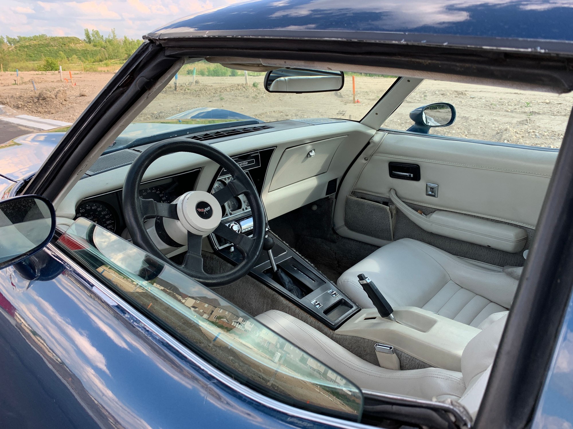

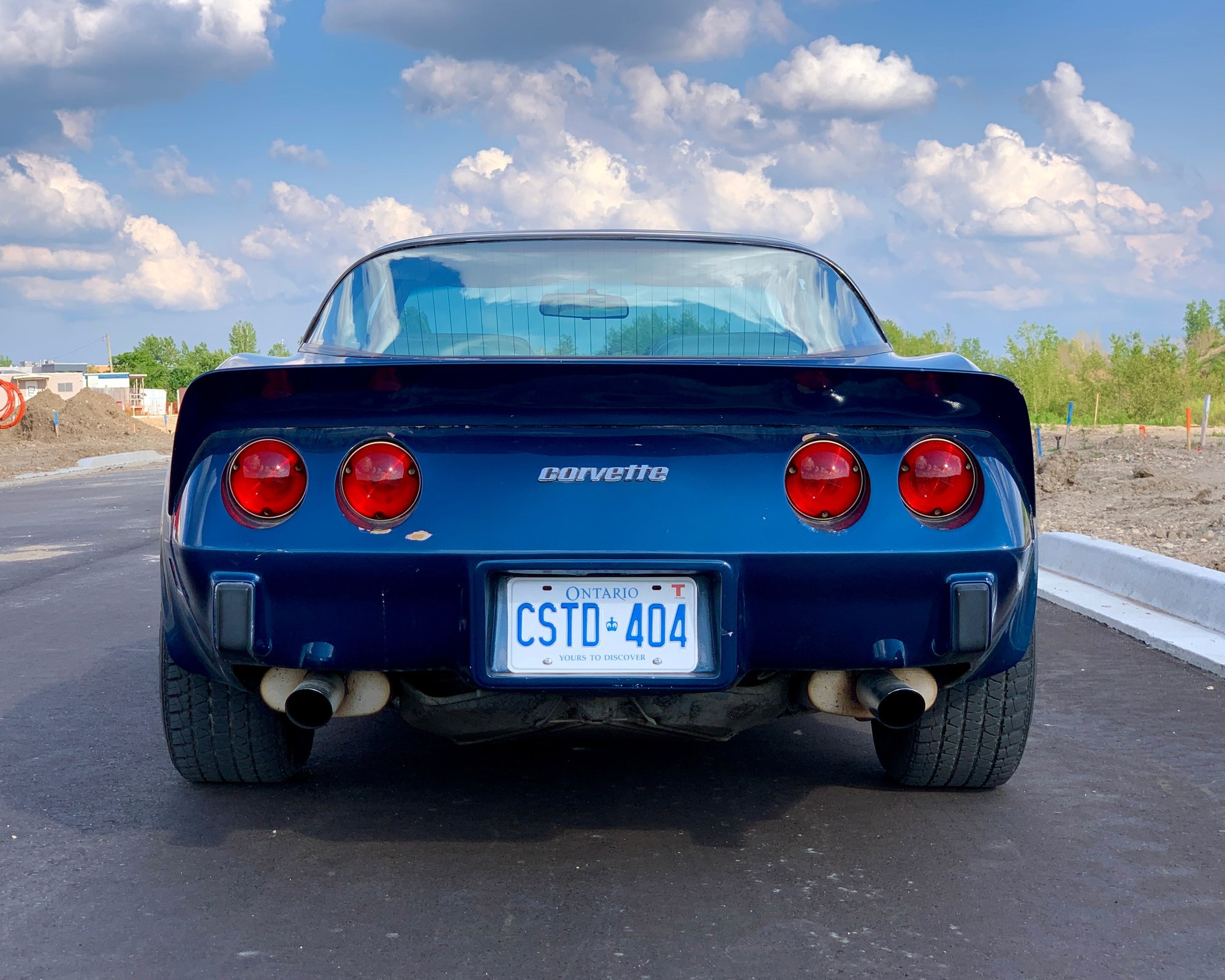

Hey guys, been wanting what felt like an eternity to put up this post and today is finally the day, Betty is home and went for her first ride today!
(Full disclosure, purchase agreement with my wife gave her rights to naming choice , we compromised on the title of this thread because you know, Vetty)
Needs some work but birdcage and frame have been thoroughly inspected by a mechanic who works exclusively with classics and has a chrome bumper of his own - to me that was the most important aspect when buying a car given my location (Waterloo, ON, - LOTS of snow during the winter months)
Taking this as a learning opportunity to working on cars (been years since i touched one with my dad and it was a BMW E30i from 89, not much in common with a Vette. I already have a looooong shopping lit and will definitely be relying on this community to help make those a reality haha. Looking forward to sharing progress and learning from and with you all! Here she is:

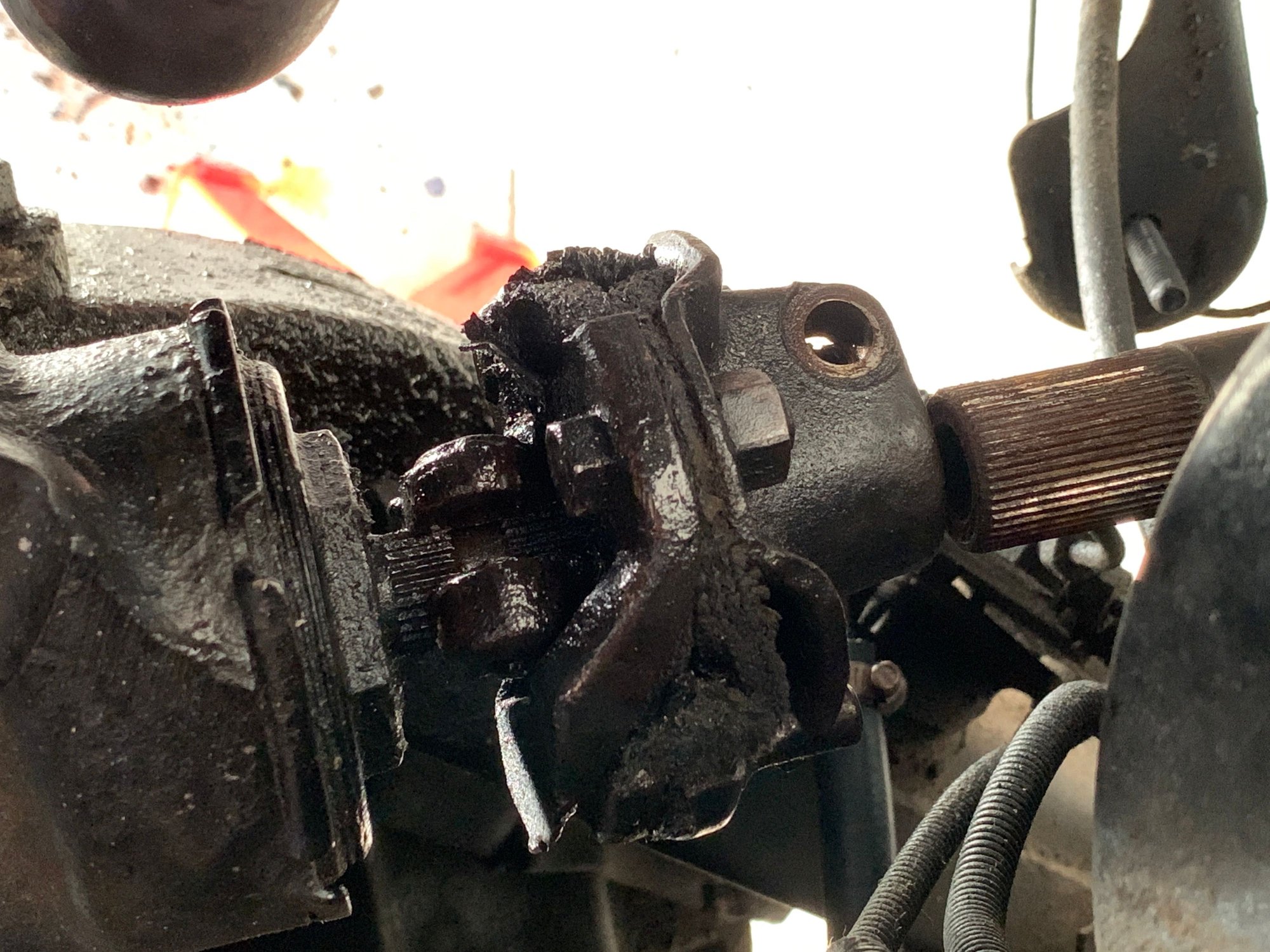

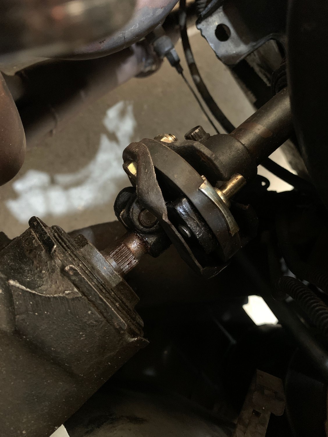

This was the state of the rag joint:
Unsurprisingly, the car was incredibly sketchy to drive even just around the block on a paved construction area.
Got around to disassemble the old rag joint, did a light soda blast and painted with steering column coupler with high temp enamel paint and voila:
Steering is tenfold better! Calling this a temp replacement as down the line i'll likely install a u-join or borgesson steering but for now i'm pretty happy with it - this was my very first corvette project too!

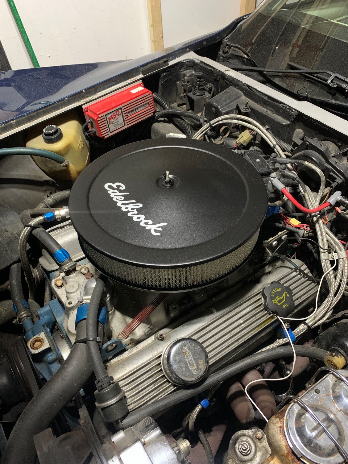

Also got around to install the new air cleaner

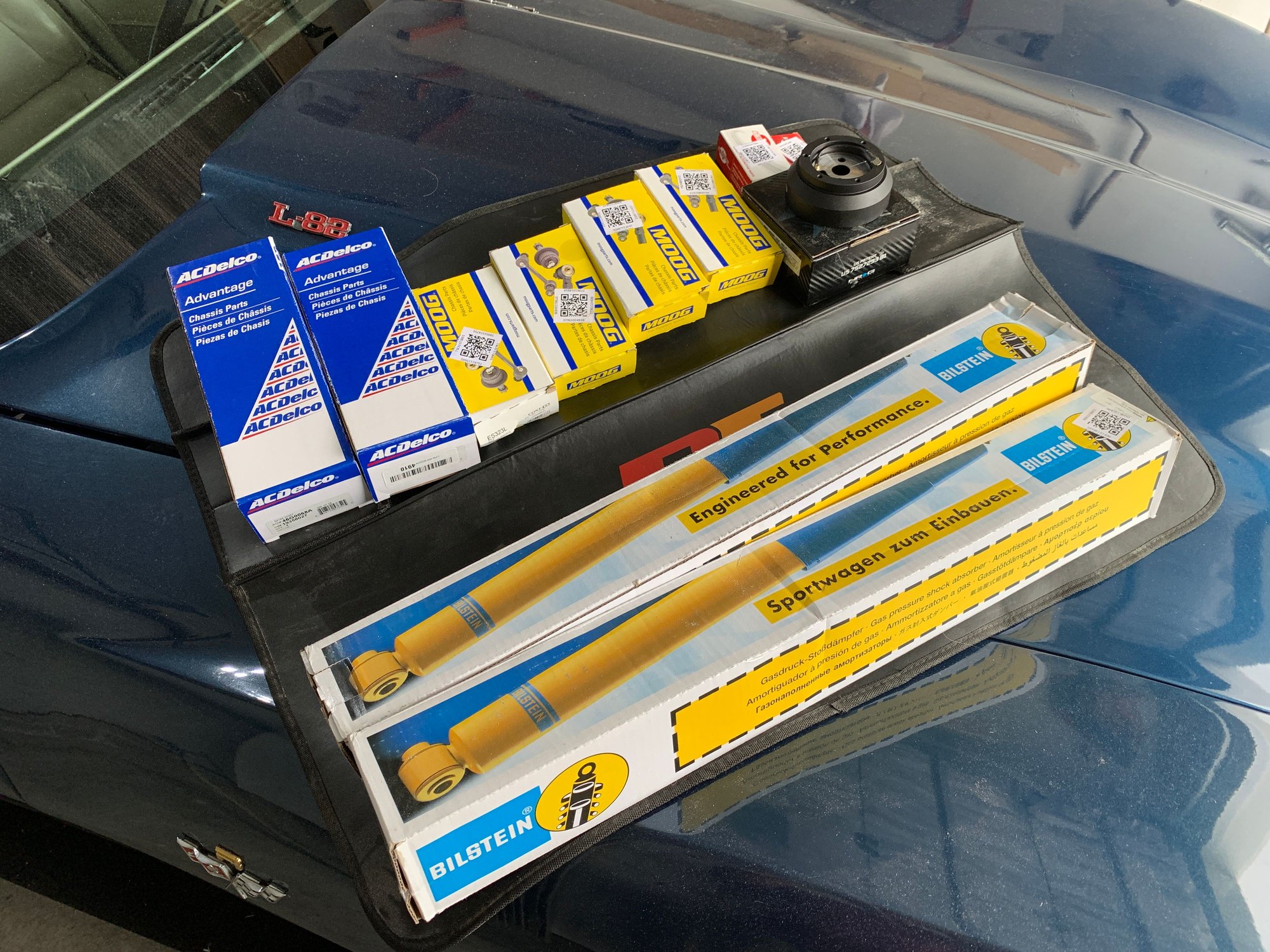

Next on the list:
Tackling suspensions, both front and back!
Got Bilstein HD's for front, Sports for back, going to be replacing all the bushing, sway bar end links, ball joint assemblies, and just about any other 40+ year old rubber pieces.
Will be posting updates as I tackle these much bigger projects and likely report back with very many questions

ONE QUESTION: Did you make sure you tapped the new rag-joint down far enough so the lower bolt fit into the notch in the steering box shaft?
Old Jun 28, 2021 | 10:16 PM
antpgomes's Avatar
antpgomes
Joined: May 2021
Posts: 313
Likes: 61
From: Kitchener, ON, Canada
Originally Posted by doorgunner
New parts installed!
Yes the second notch is fully snug under the bolt but I'll try and tap it a bit further down once I get a small peening hammer.
That was mostly a test fit to diagnose whether this was the primary cause of the loose steering column

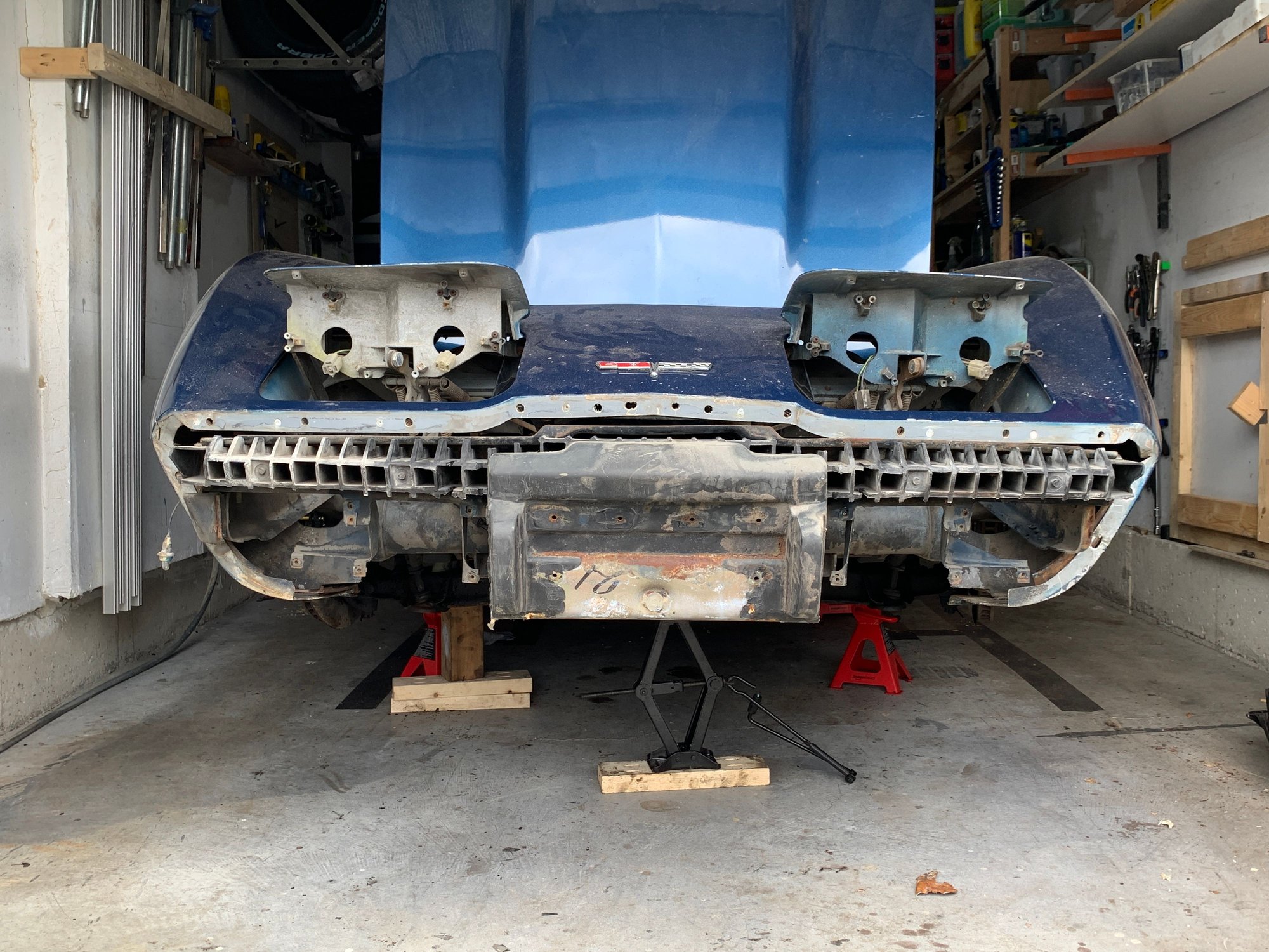

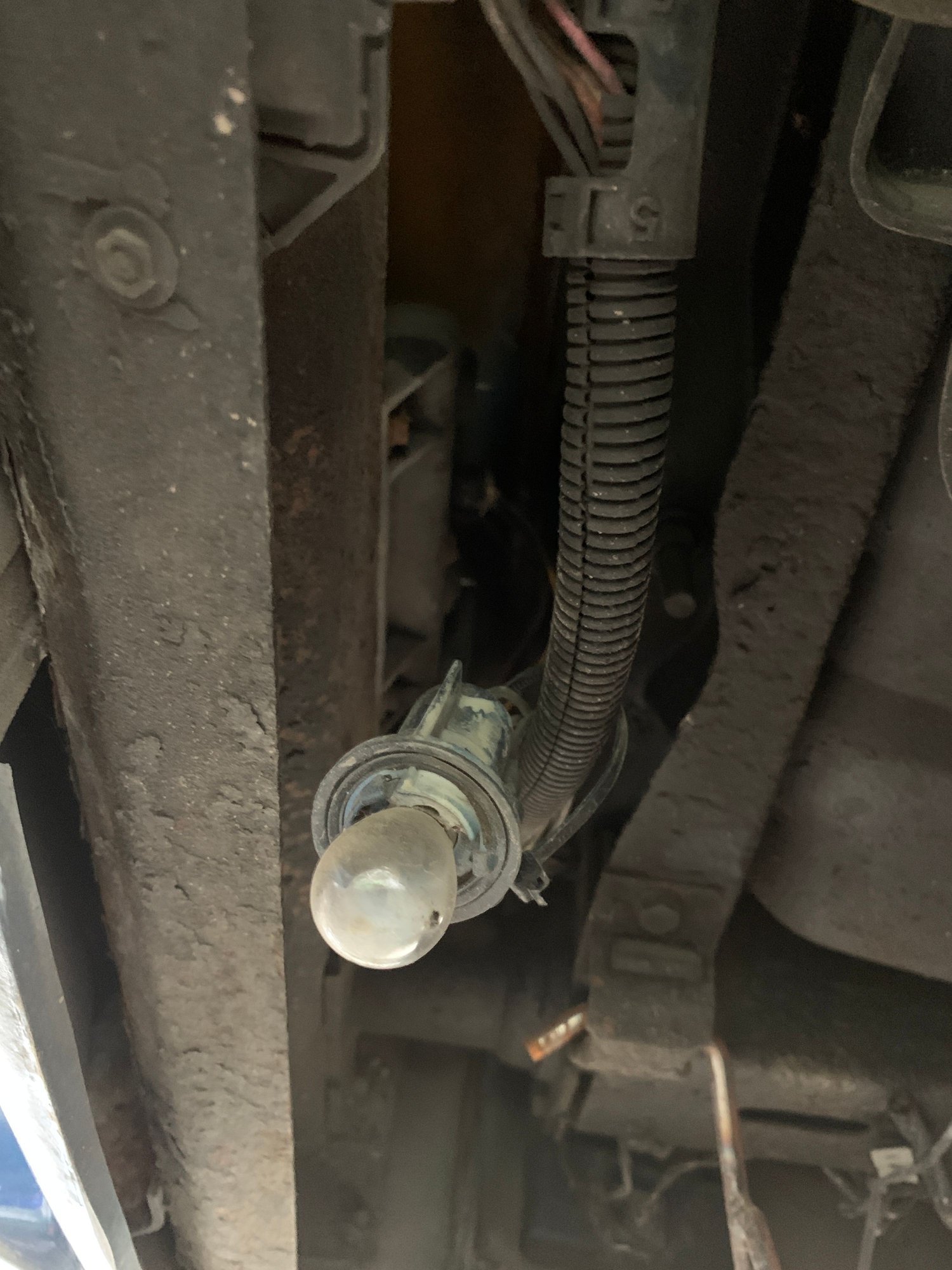

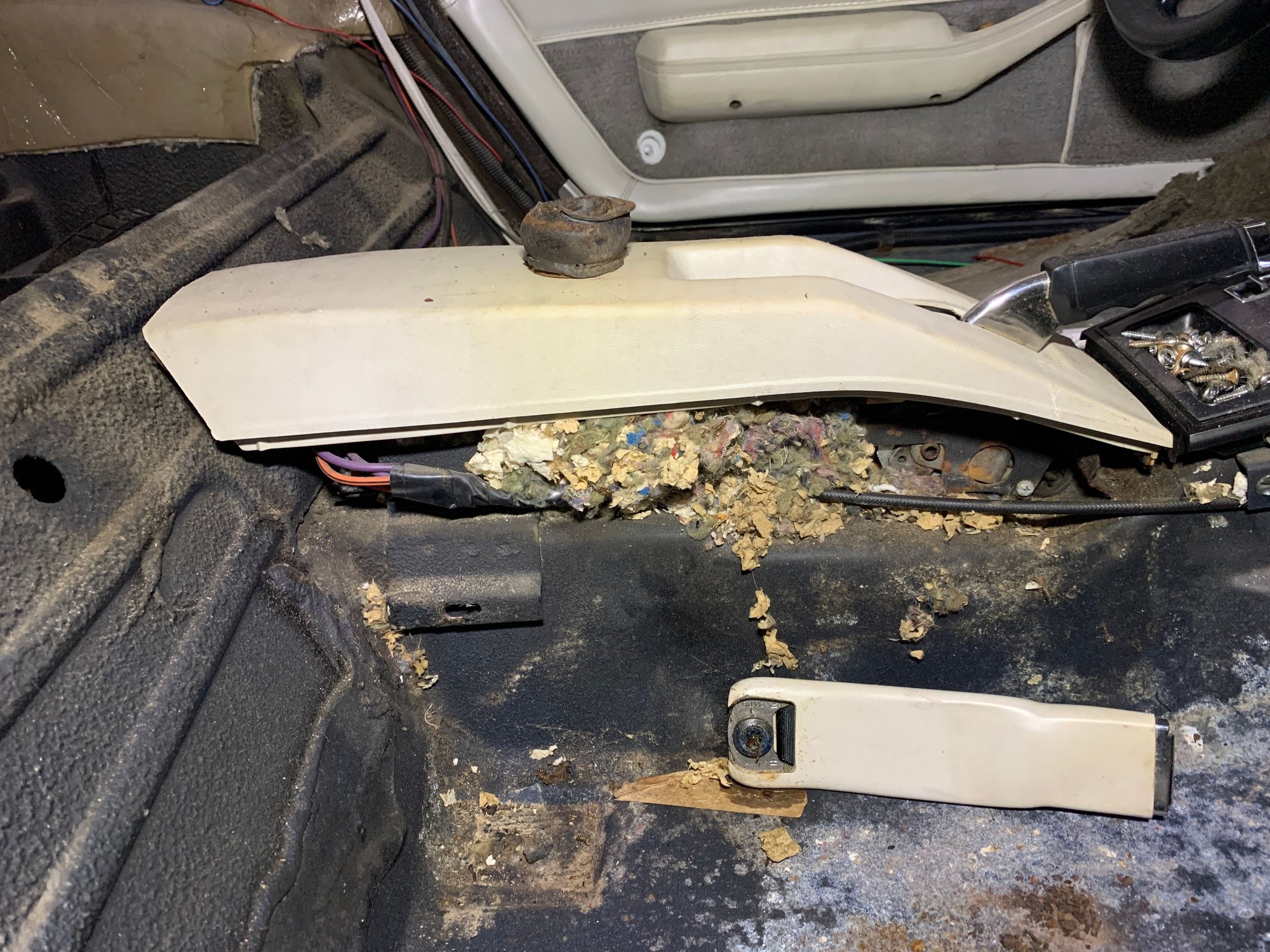

While I wait on parts, I got the car on stands and had my first good look under the rear section and it appears there's a few sketchy things going on
There's lightbulbs just hanging there (and my taillights and license plate light are all working fine)

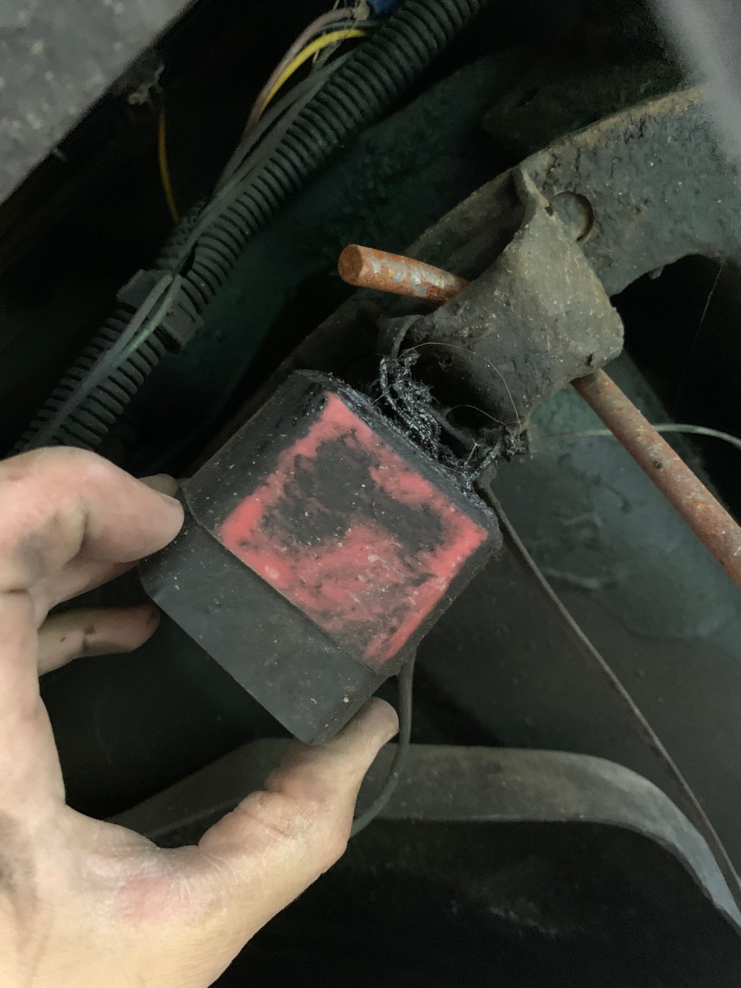

this thingamajig is also hanging there....looks like a buzzer covered in gunk? Some sort of alarm perhaps? I have many questions

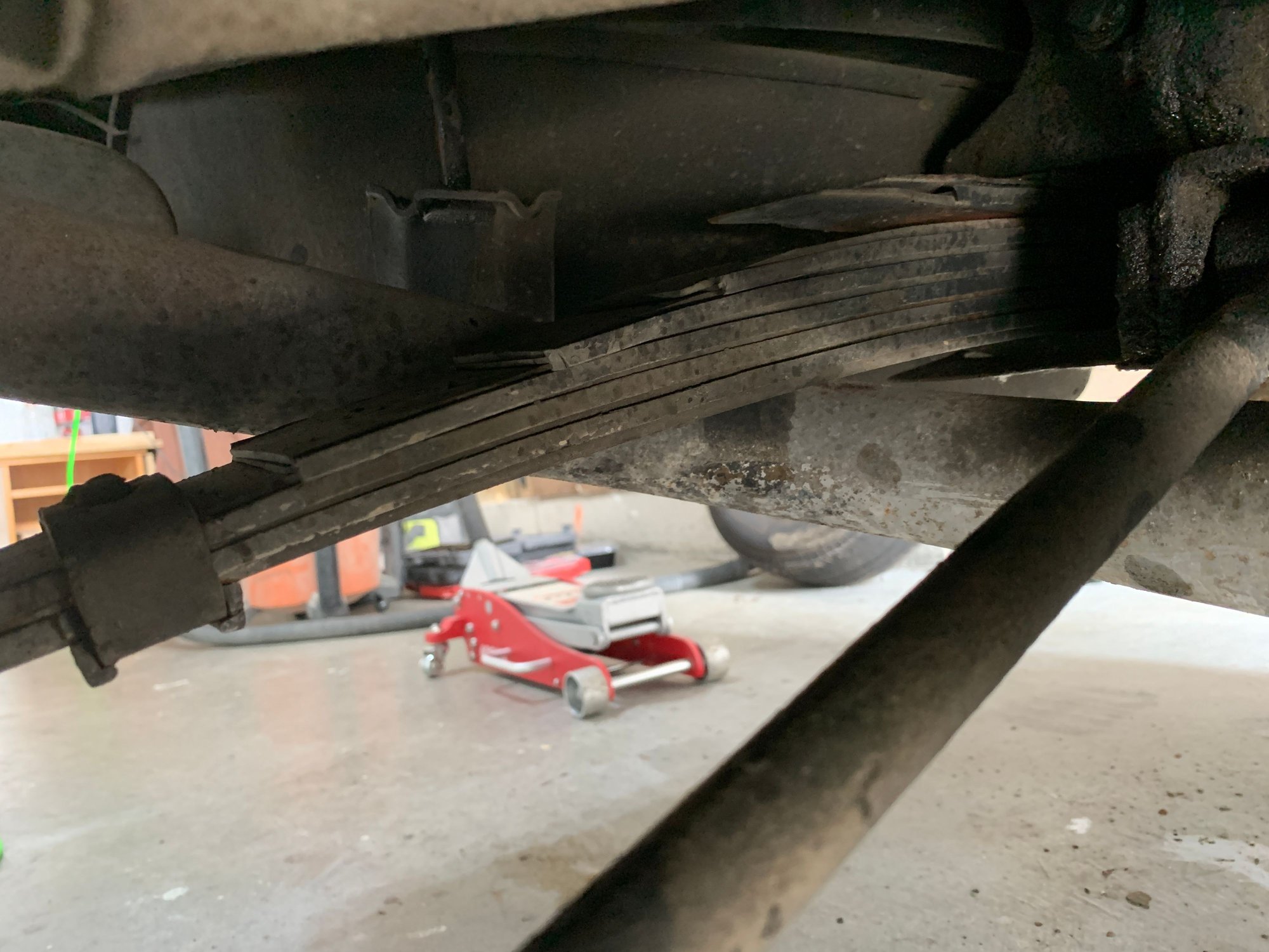

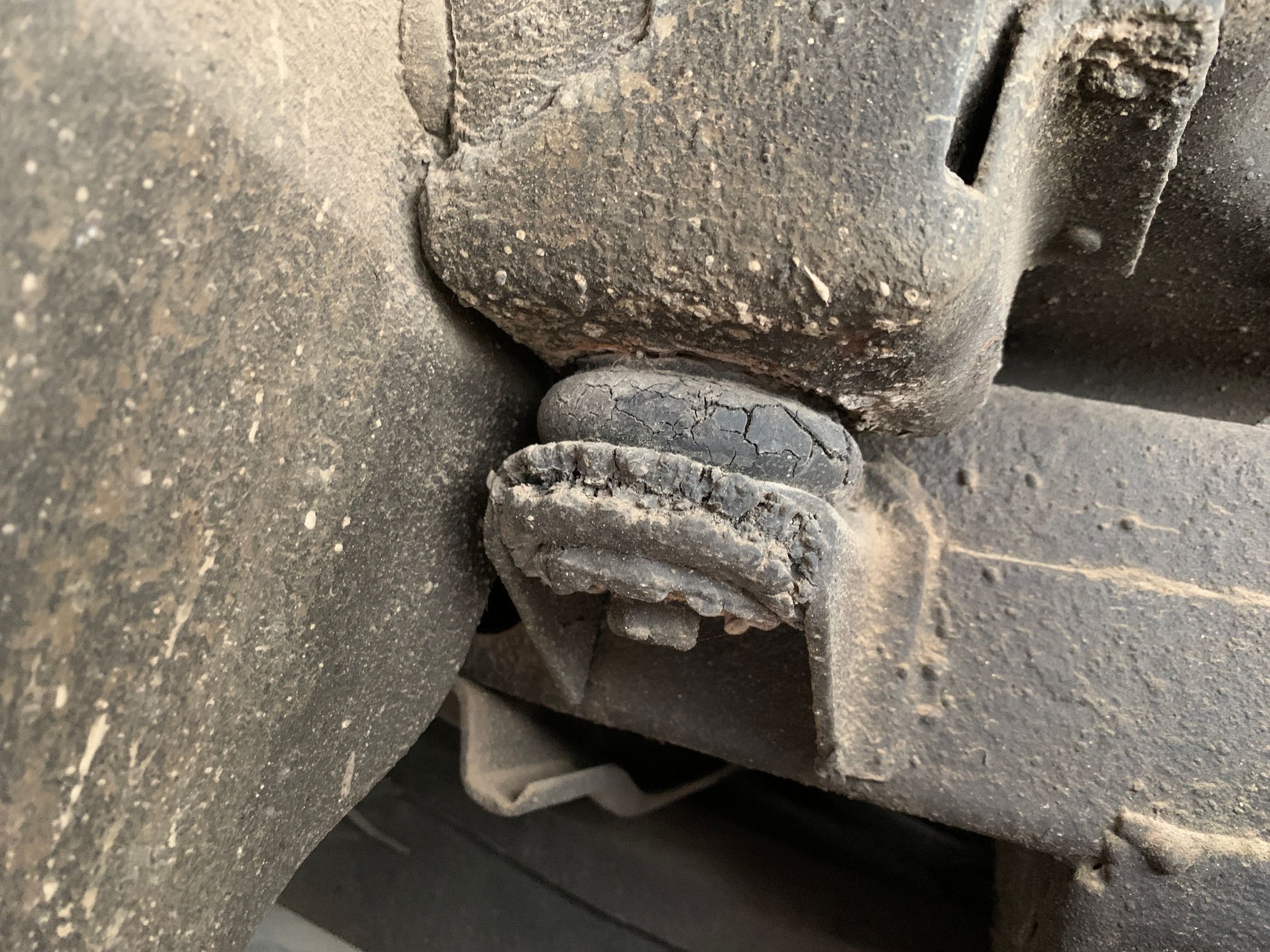

Lots of rubber to be replaced
Is it time for a monoleaf?
and finally, exhaust - i'll post my conundrum in a separate reply

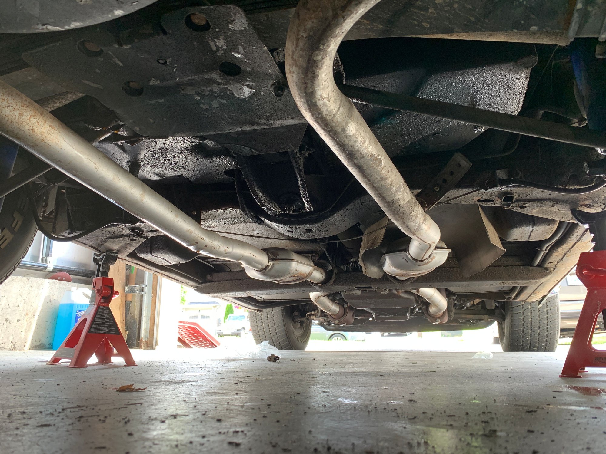

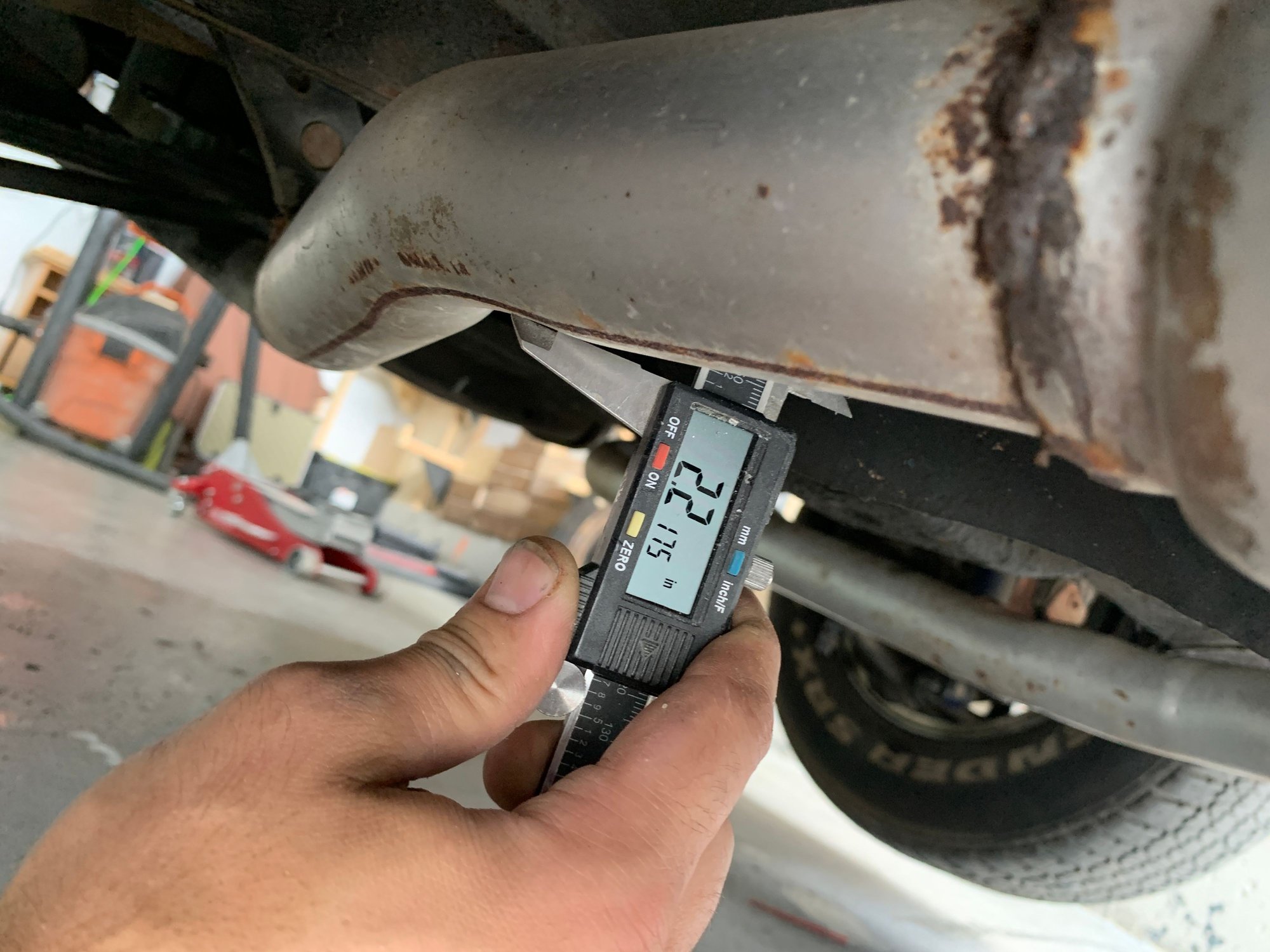

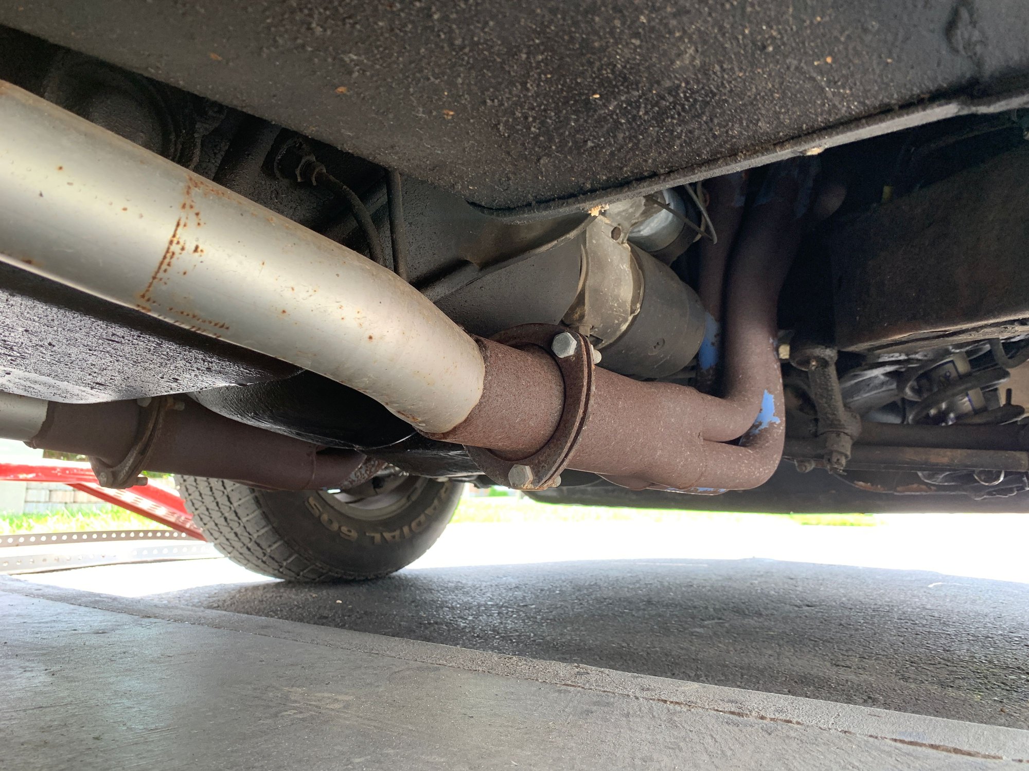

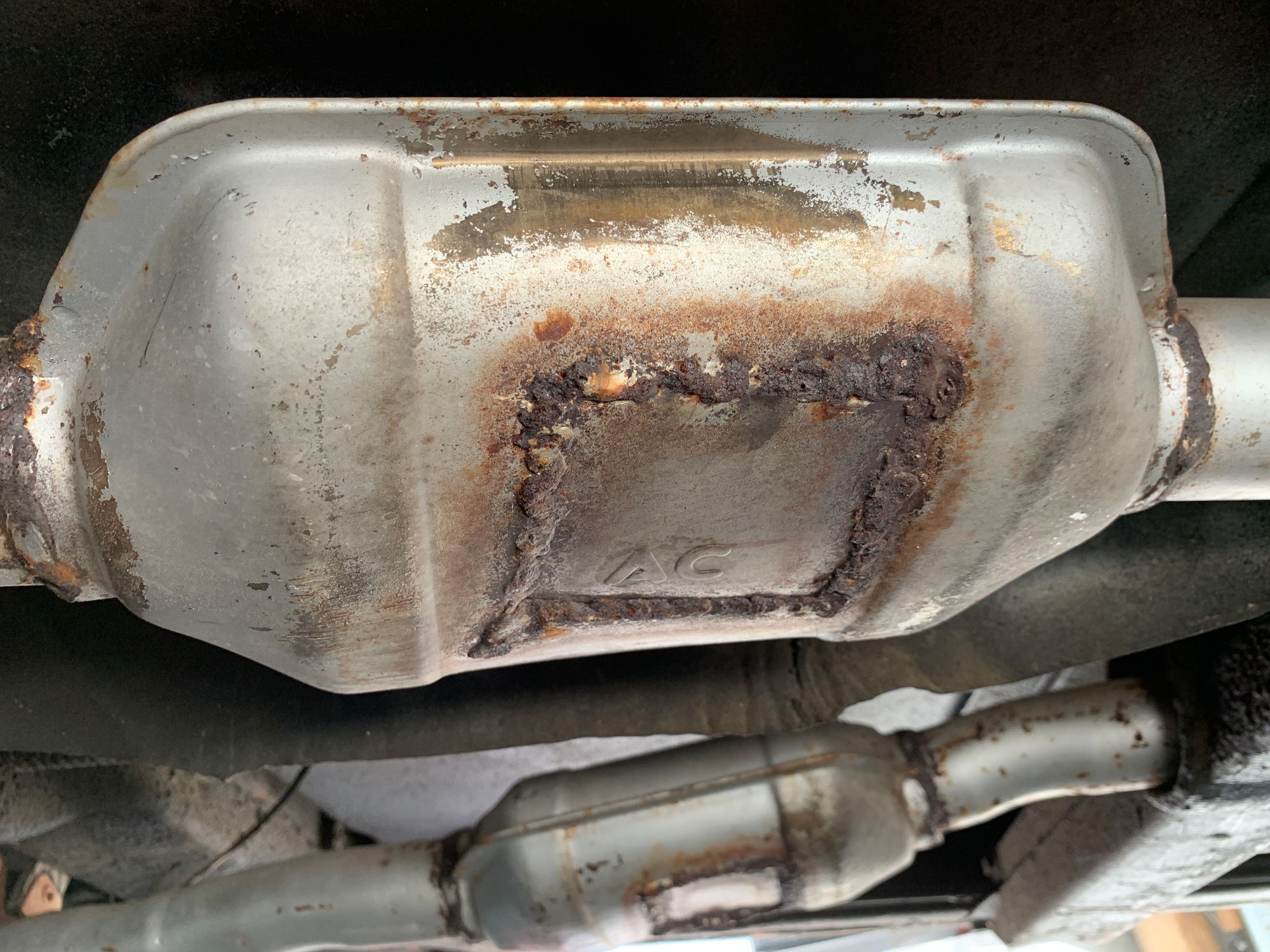

I want to change my headers because these honestly look like garbage.
That said, I keep toying with the idea of putting side pipes. Suppose I didn't:
  • Should I still replace the whole exhaust system with true 2.5" pipes? (These ones have an outer diameter of ~2.2175in and the catalytic converters have been hollowed out)
I'm also not sure whether the leaf spring needs replacing right away or not. I ordered B6's for the front but would super appreciate your input on getting a monoleaf spring for the back. From what I've read, it seems like if i did that, I could/should get B8's for the rear?

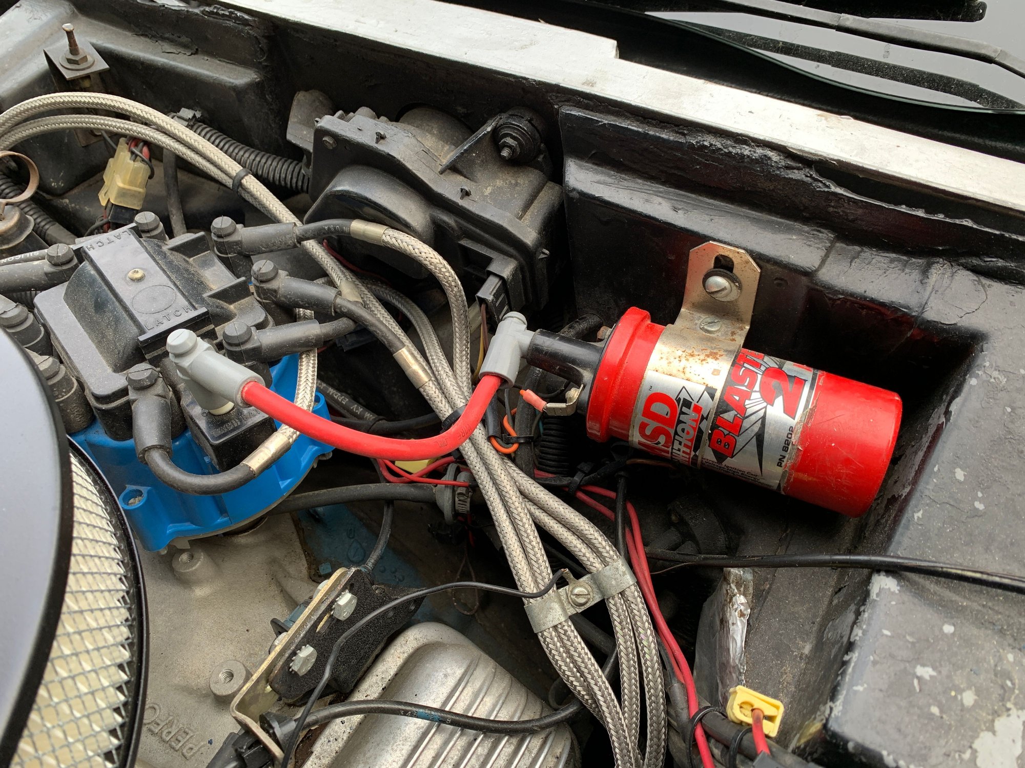

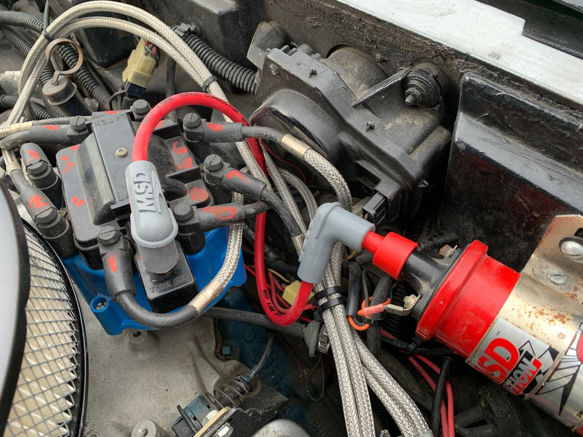

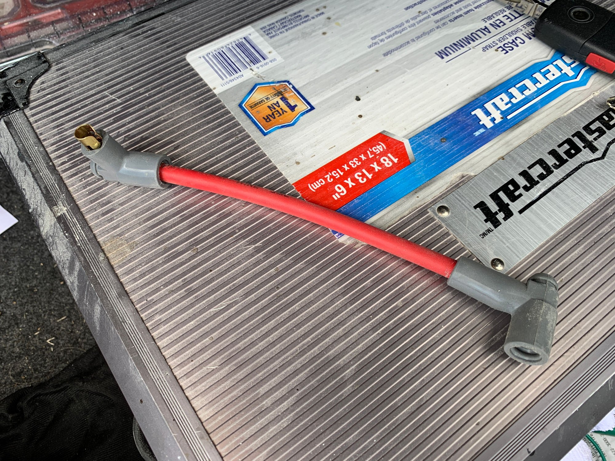

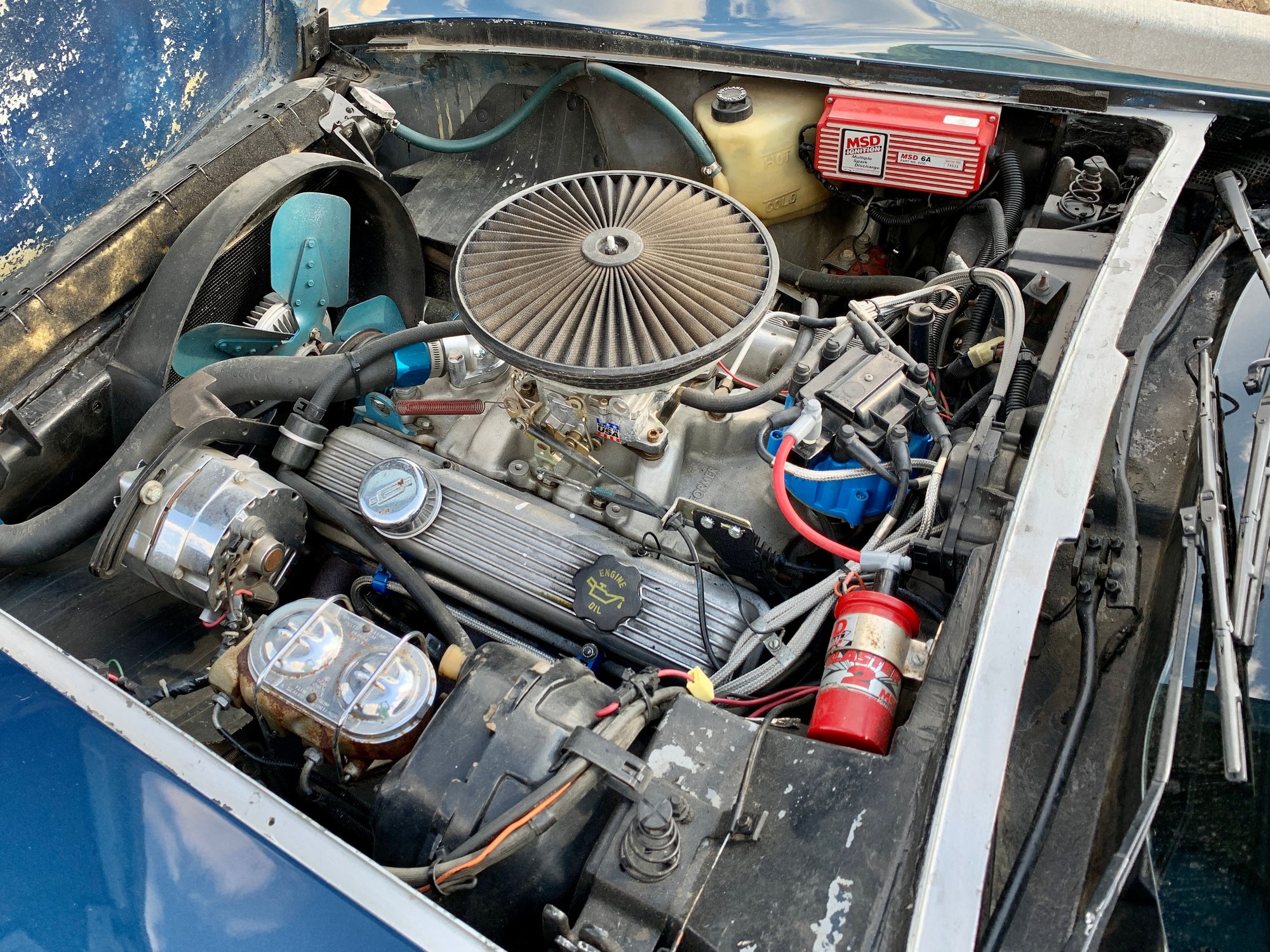

Got around to swap the sketchy cable at the ignition coil for the proper one with the tower connector (still unsure if this is part of the issue that broke the Vette last week but alas, better safe than sorry)

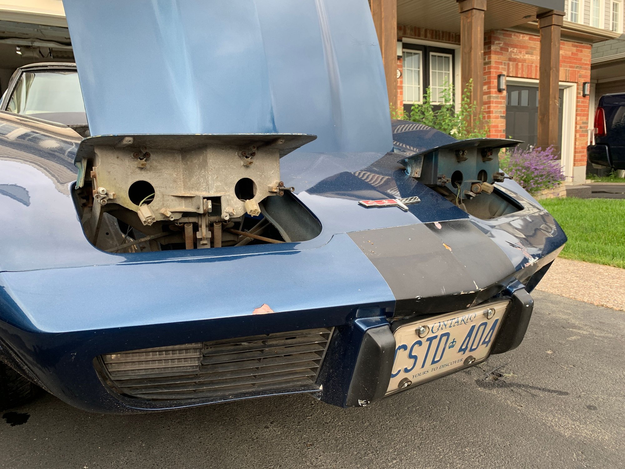

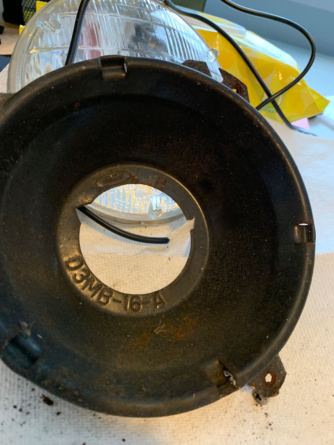

Started disassembling all the headlights to replace with LEDs (was initially only going to do the front but I realize I have the bubble taillights which I do not like so those will be coming out too)
In the process, I found out that apparently I am the proud owner of the mythical Ford C3

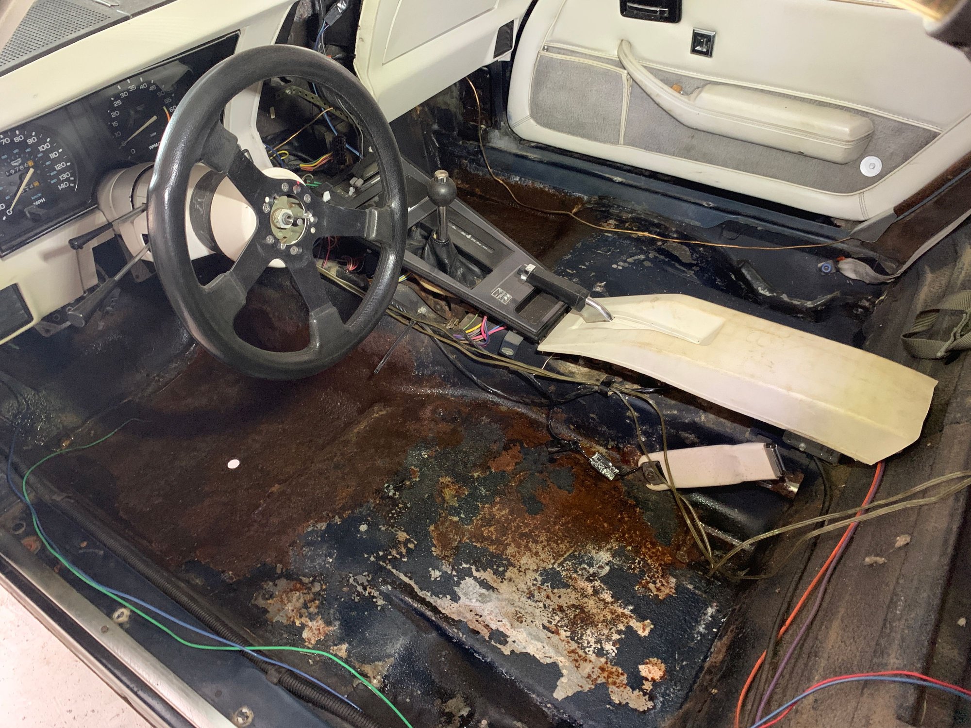

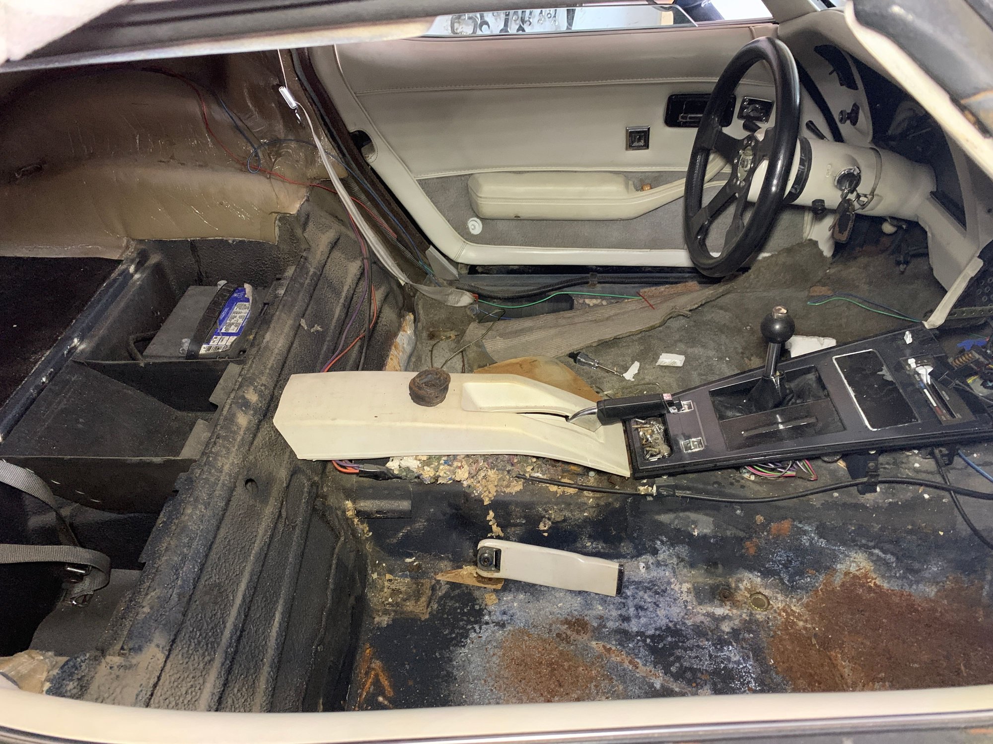

Been a while since I posted any updates but that doesn't mean I haven't been busy! Been learning lots in the process of taking the Vette apart and really excited to do an overall refresh on all things rubber, suspension and interior!
Some pics of what I've been up to:

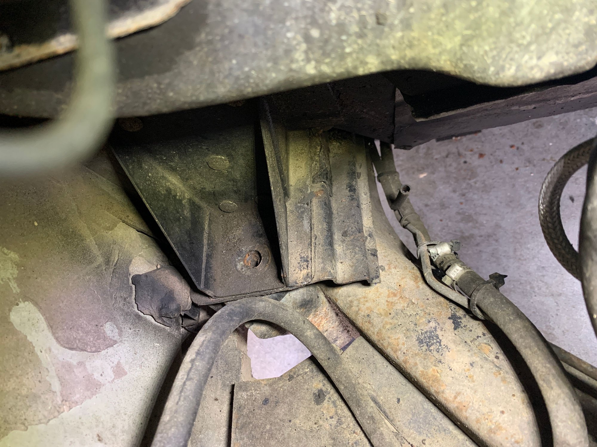

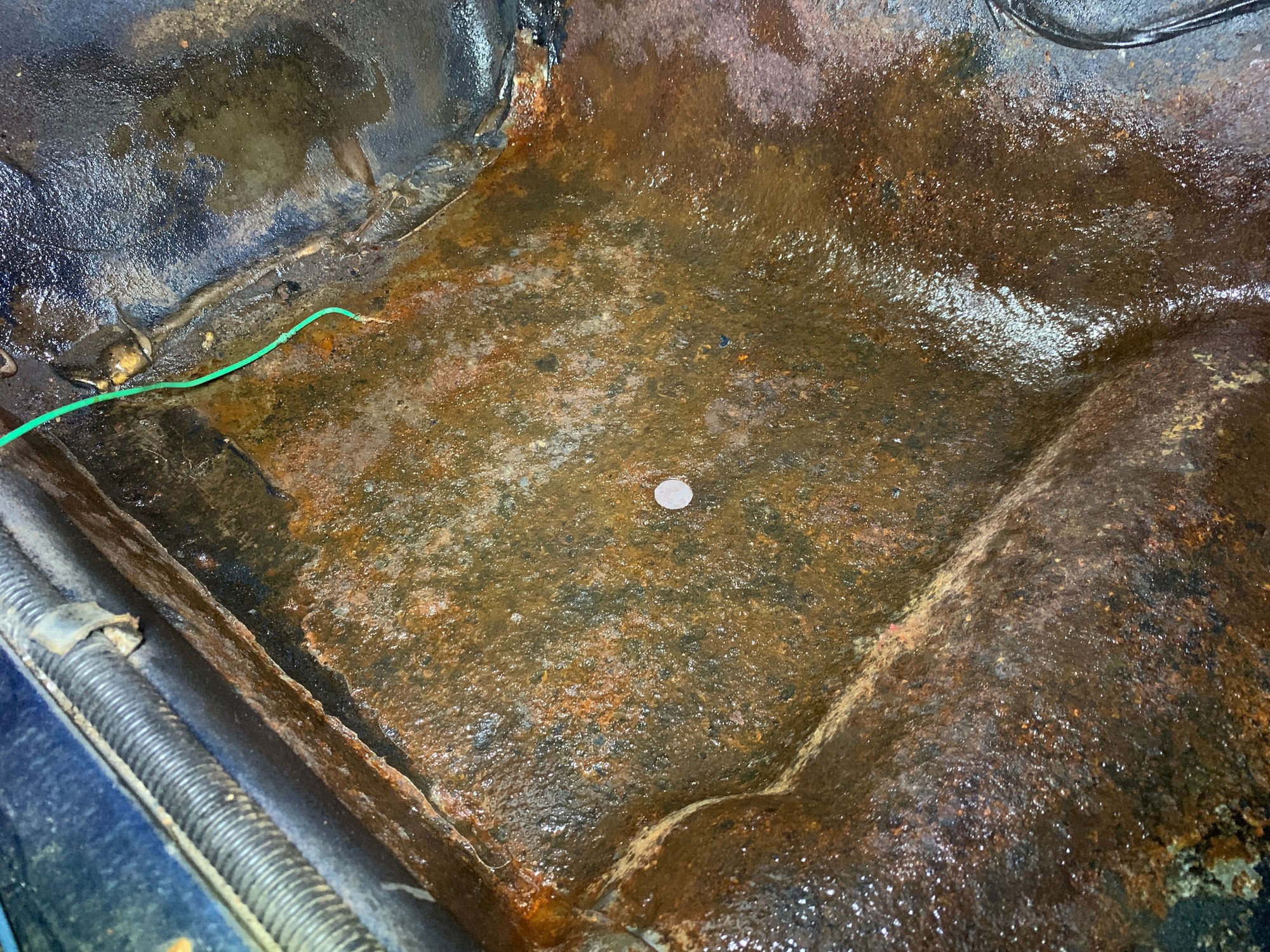

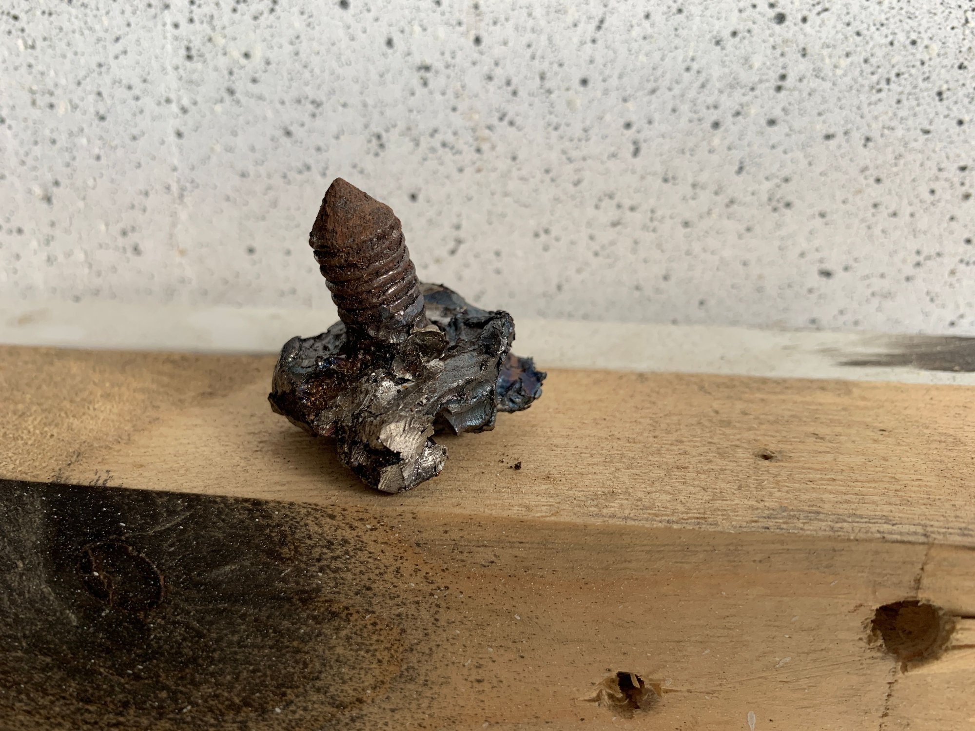

Managed to get all the body mount out (#4 cage nuts need replacing and so does #3 driver side which took me about 4 hours to get out and made me want to invest in an actual torch (it broke on the wrong side of the nut i guess)

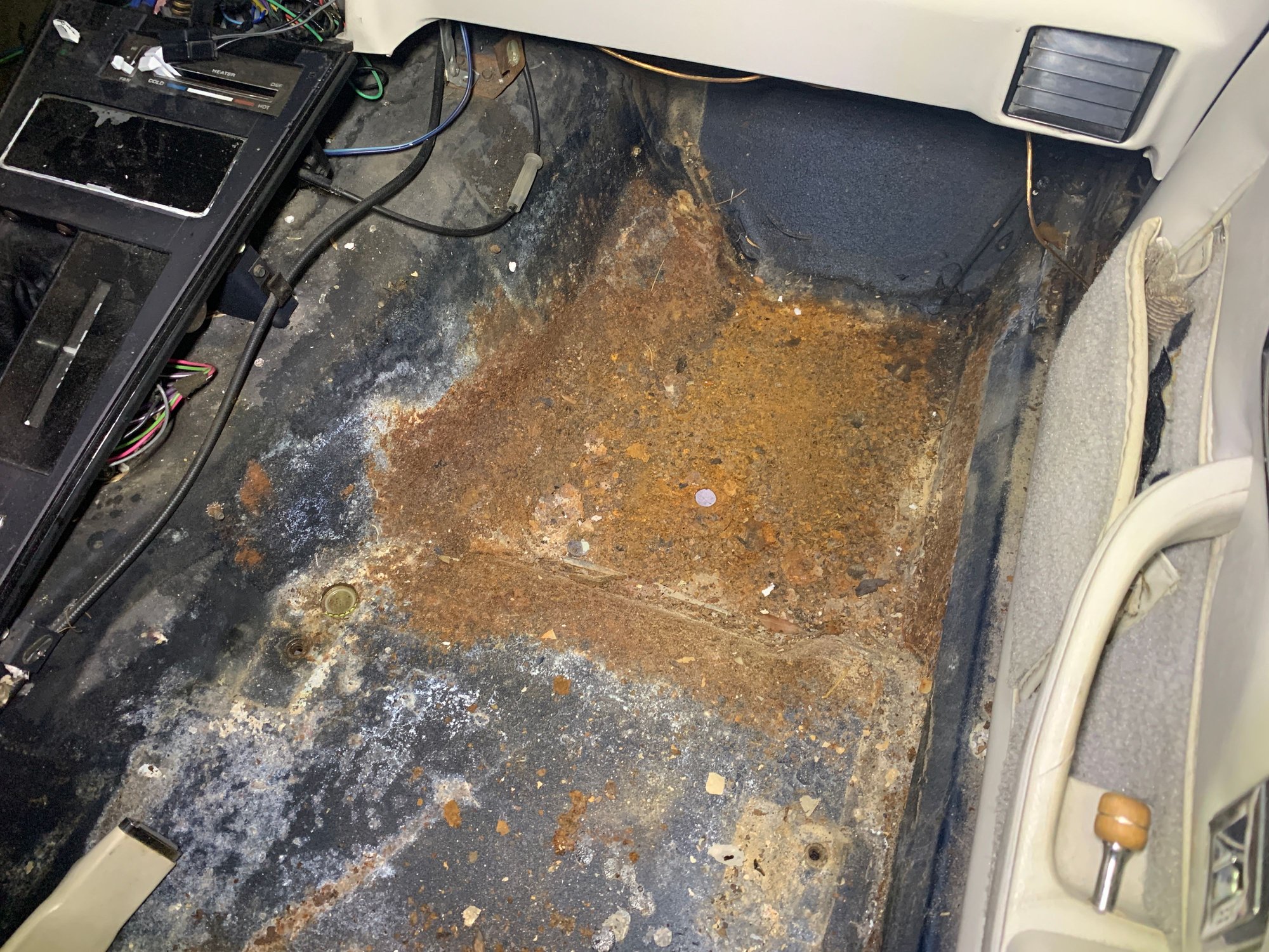

Floor pans didn't look so good but having taken a wire brush to clean them up a bit and spraying with rust check, they are solid

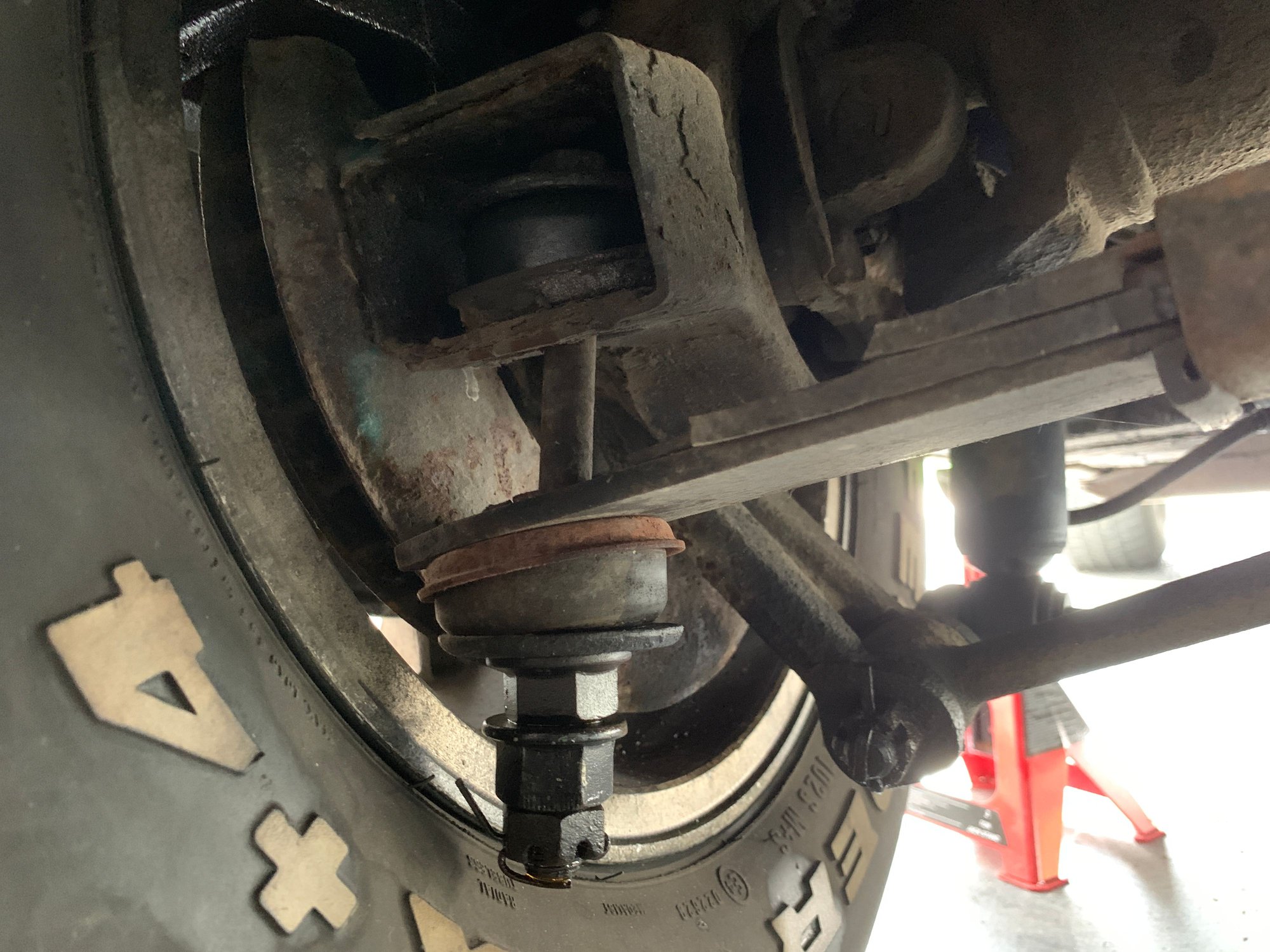

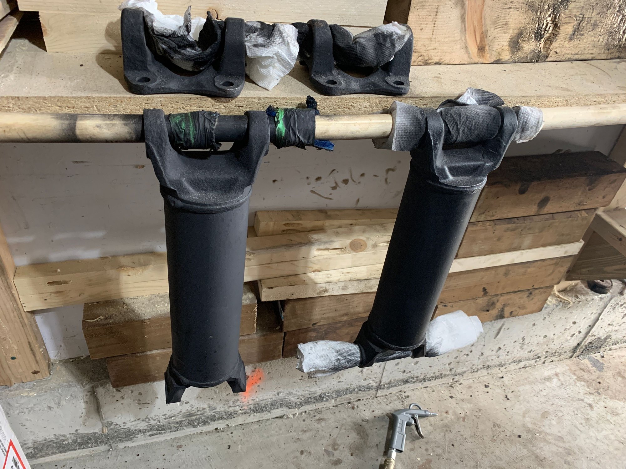

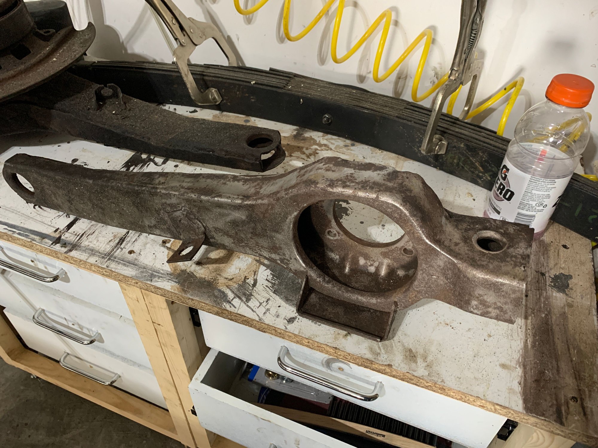

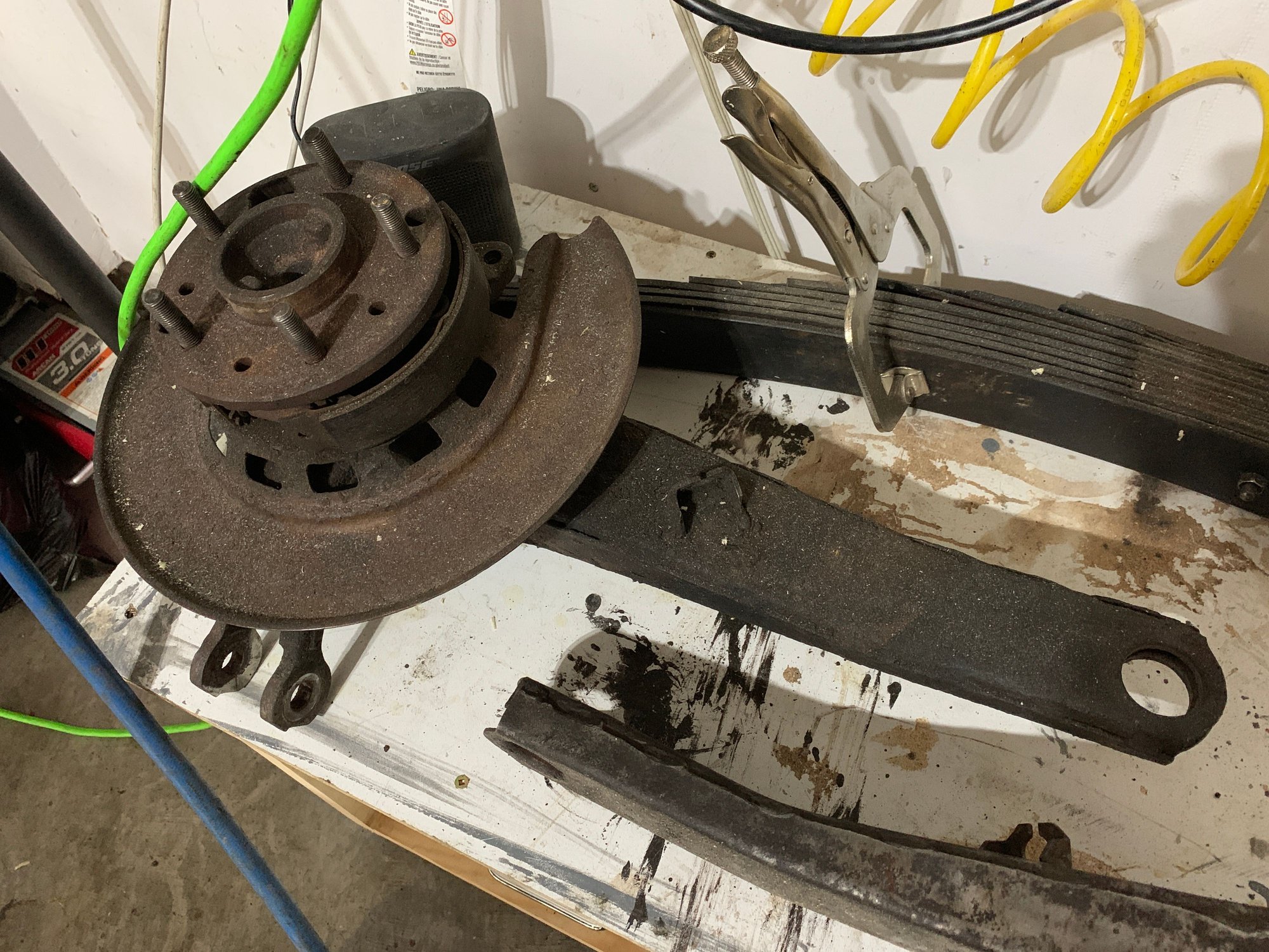

Still debating on whether I attempt to do the trailing arms myself or just get new ones...inclined towards the latter although i do need to get the tools
Ujoints are coming along nicely

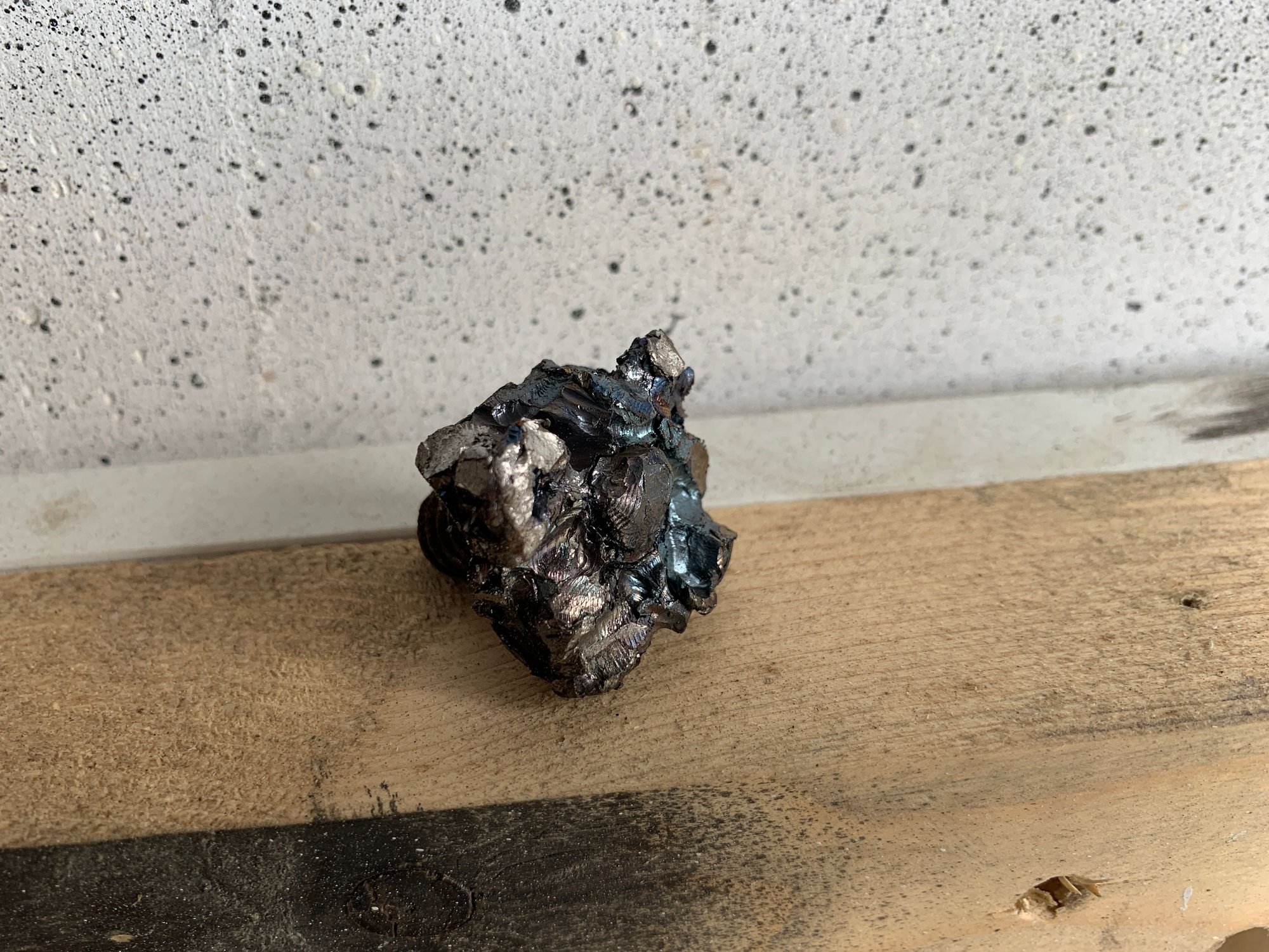

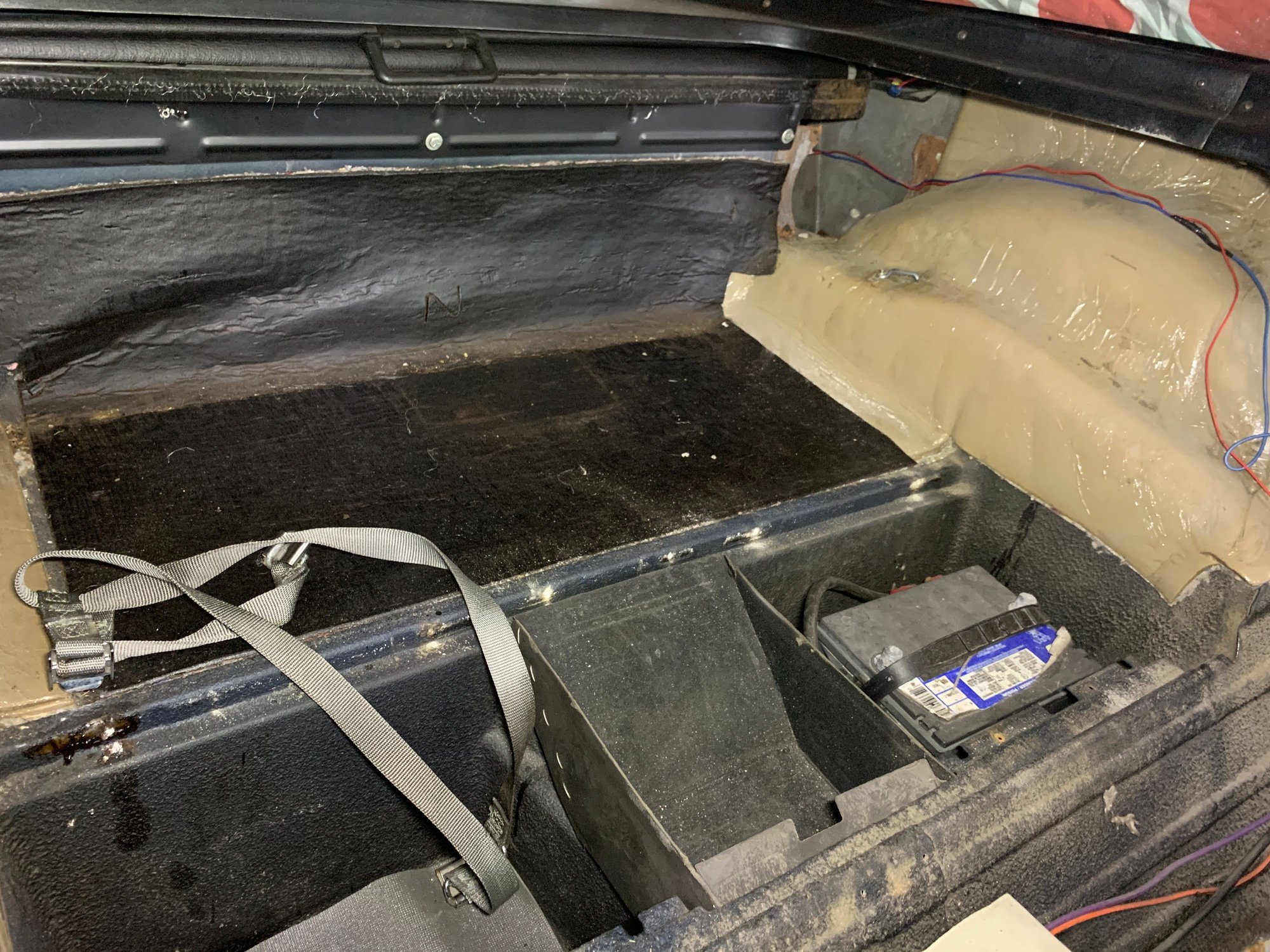

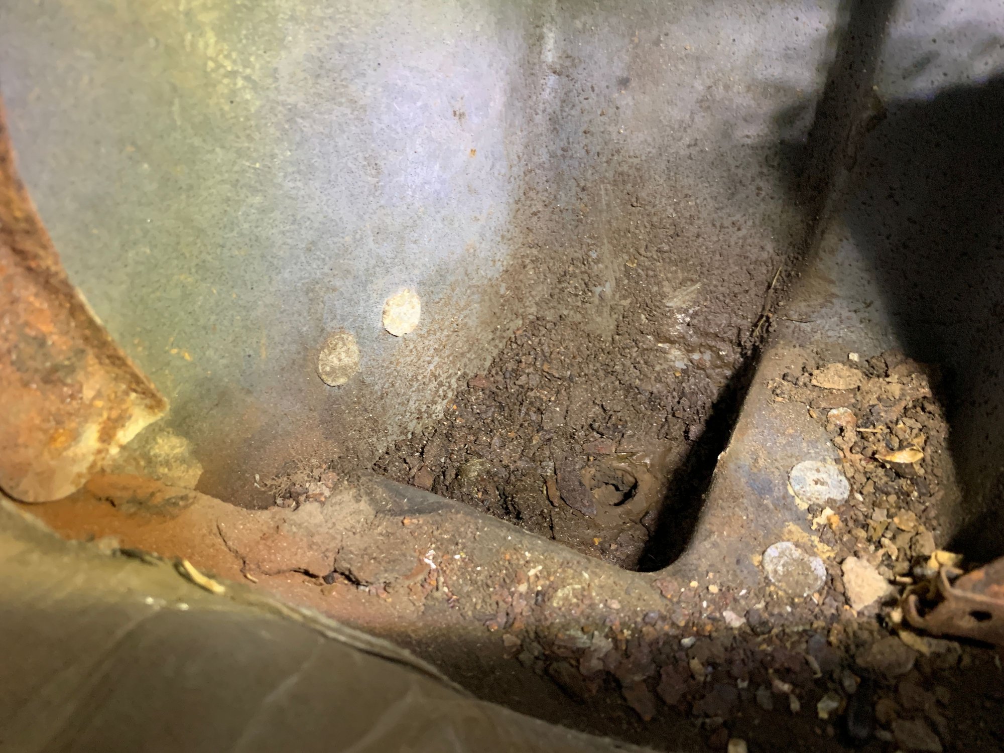

And finally, I found this under the carpet in the back...l/m guessing it's a factory thing?
