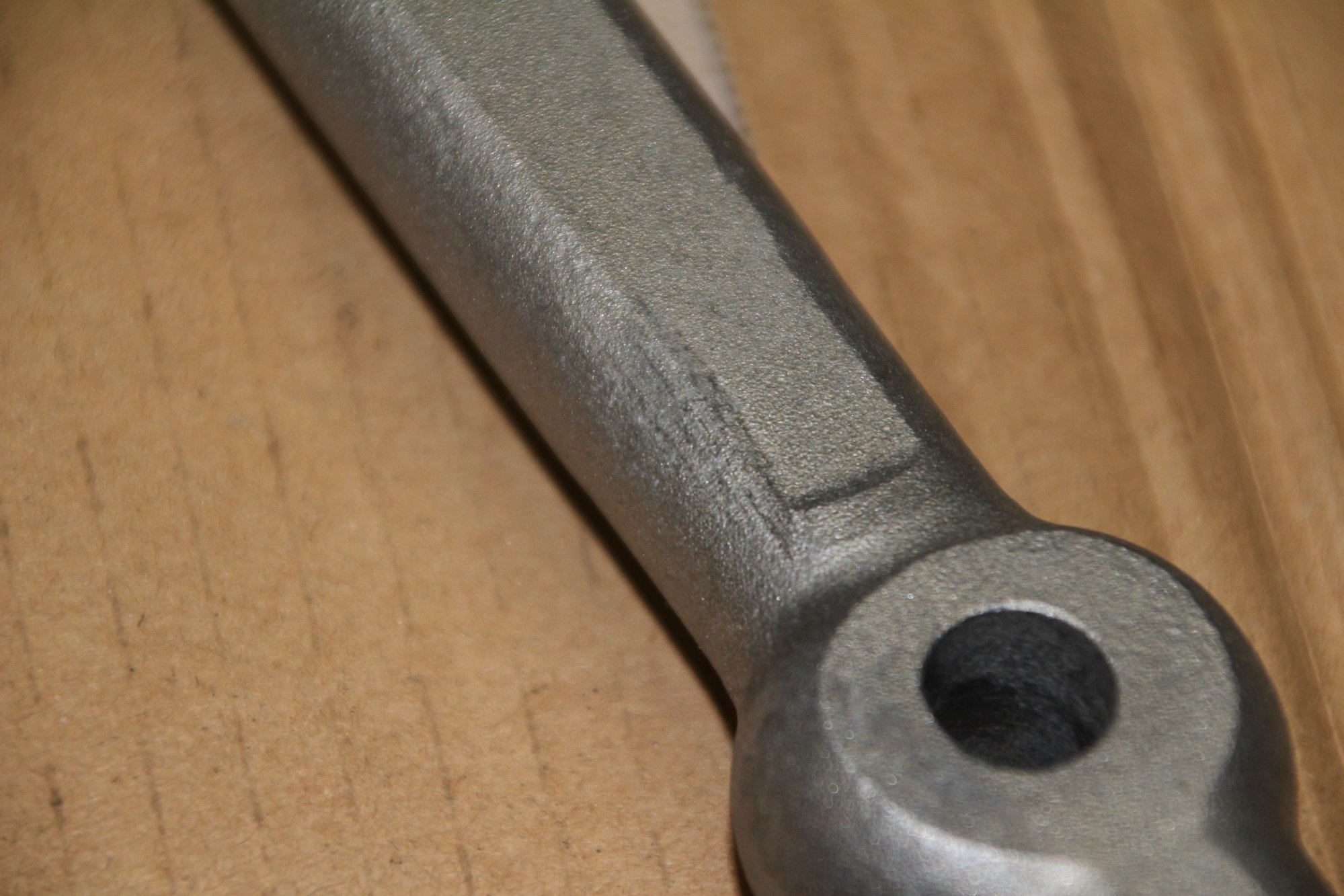

A few questions to answer. why do I feel need for more caster. Simply put, with my wide tires and the rough roads here in Australia. my steering feels very light. I have a stack of shims on the rear bolts of my upper A arms and none on one side and one on the other. Still inadequate caster. Also no budget for aftermarket A arms. would like to get some caster to put some "feel" into steering. The budget method is to use offset A arm shafts. Big name brand super expensive parts cost 3 times as much for me over here so please spare me. So far part numbers supplied have given me replacement bushings. (No good) And parts that I can not find through google or Summit . A part number that can be found with a Google search or from a company that ships to Australia for a reasonable price would be greatly appreciated. And truthfully, I am still trying to understand how a downward offset can work. really need rearward offset to get more caster. Thanks Guys for any help. I really do have a limited budget. I can pull this apart and put it together. would just like to get rid of this super light feel.
I copied this pic from another forum member BUT forgot what the Red and Blue lines represent....it has to do with machining the upper control rods to increase caster.......any info is appreciated
Found it, I think: https://www.corvetteforum.com/forums...-question.html

Originally Posted by sunflower 1972
Ahaaa.....thanks sunflower 1972.....I have access to a machine shop..good thing with a C3! (OOOOPS..I think I said it wrongly)
Red = Remove ADD metal-spacer (1/8").........Blue = Add metal Remove metal equal to amount added on the other end of rod.
Also slot the holes (1/8") would give 1/4" total adjustment (I would prefer to Not slot the holes 1/4")

I had my Moog offset shafts milled 1/4" to one side. They seem to have plenty of extra "meat" where needed.
If you milled this stock shaft hole another 1/4" IMHO it would be dangerously thin. But doorgunner's 1/8" mod above may be fine.
Thanks...that's what I was concerned about....
