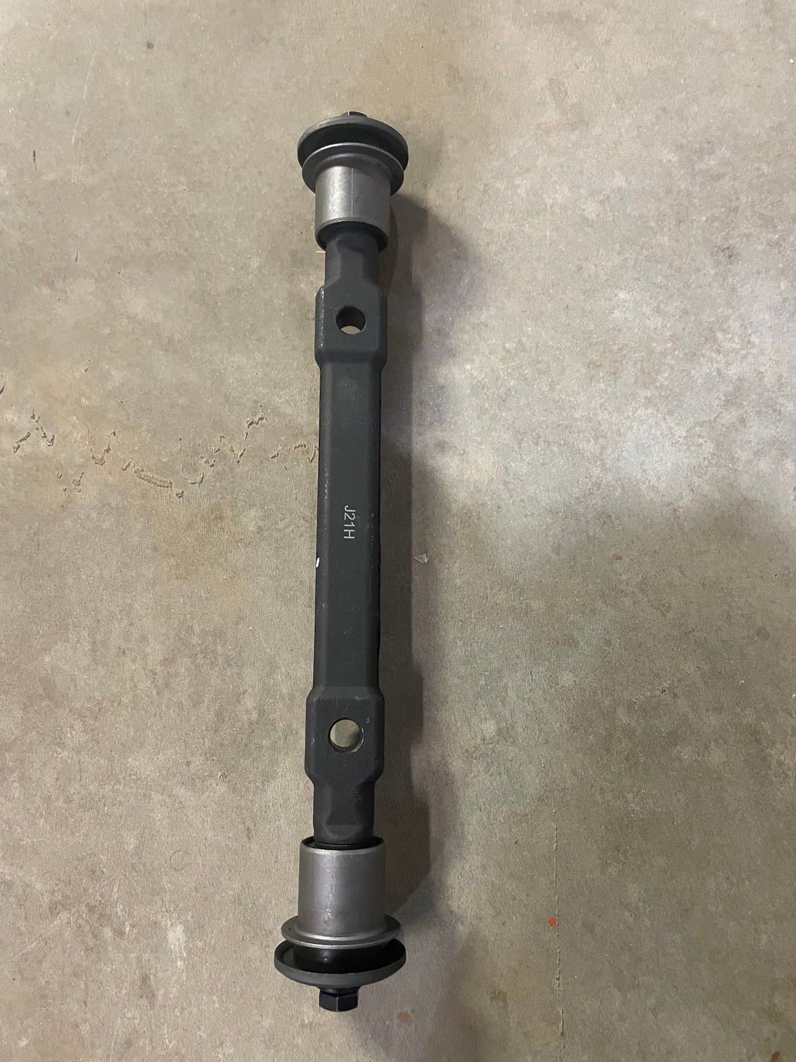

FWIW. Just ordered moog k6184 upper control arm shaft from amazon. definitely a different shaft from OEM. Does not fit!

I believe 6104 is the correct # for C3s.
See post 36.
Currently not even listed on Moogs website.
May be discontinued.

I found another source for the offset shafts, they are identical to the Moog 6104.

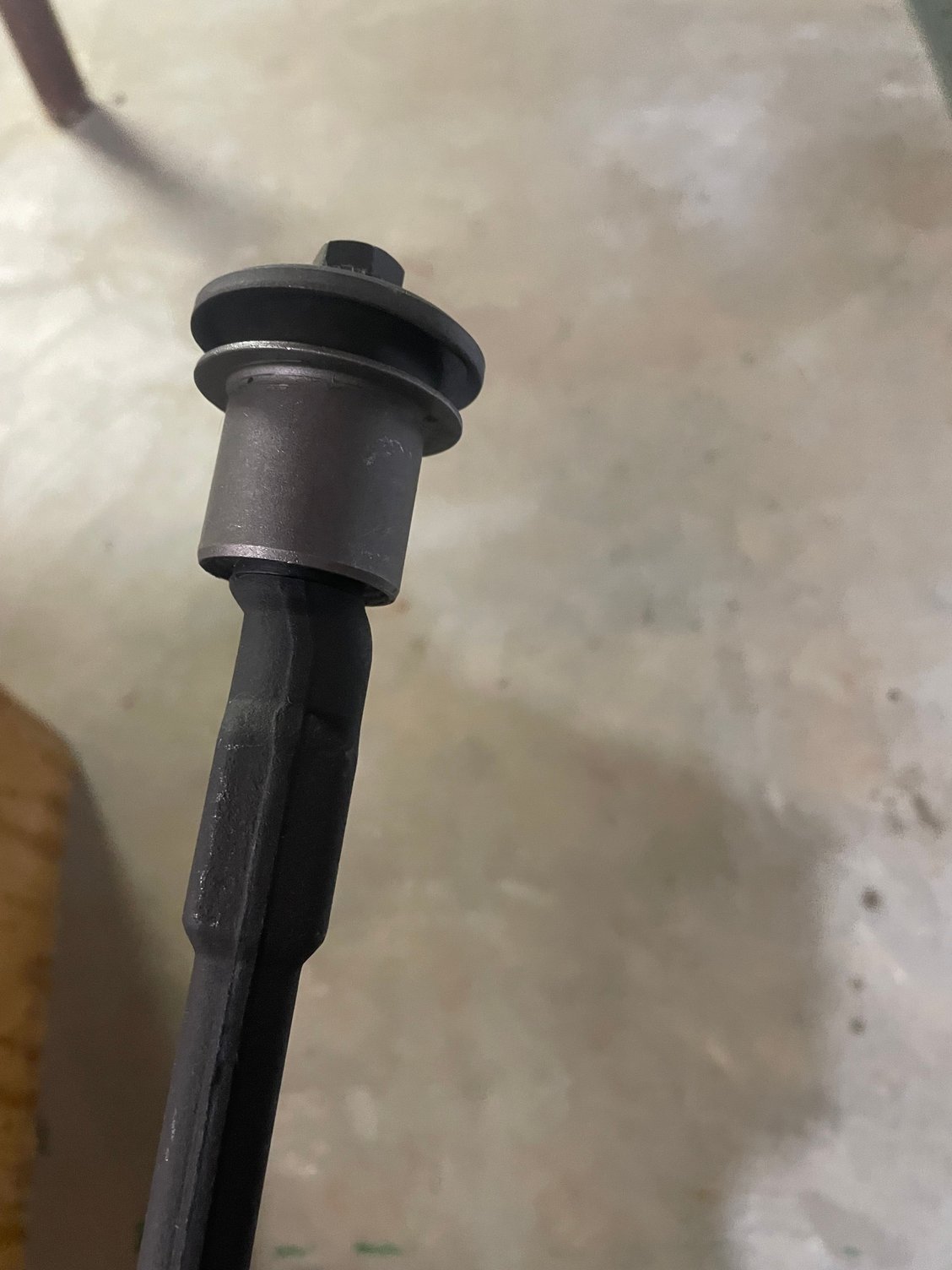

I guess this is the first time I've really paid attention to the image of the offset shaft. I thought that the "offset" would be in the mounting hole location so that you could add more caster without also adding more camber. At any rate, it looks like these do have more material around the mounting hole to slot it like some members have suggested.

Yes the offset is to adjust camber. Which can help some with caster, as you add shims the the rear. But if you have read this entire thread I started a couple years ago. You will read that I purchased these offset shafts. Had them shipped to Leigh. He at that time had access to a proper milling machine and was able to slot the shafts for me and then shipped them off to Australia for me to install.
fast forward now a couple of years. WOW! This is a truly good modification. The car still handles great. But doesn't feel so light on the wheel at high speed. With power steering I don't notice any difference at parking lot speeds. I have had her on the track and am extremely pleased with the handling.
as per kicking that wheel slightly forward if your rubbing on the rear opening of the wheel well. Yes it'll fix that. If your rubbing on the forward opening of the wheel well. Not a good plan.
I run 255/60-15's all the way around. Never had a rubbing issue. But all these cars are slightly different.

And yes, those shafts from Auto Accessories of America look exactly like the moogs.
