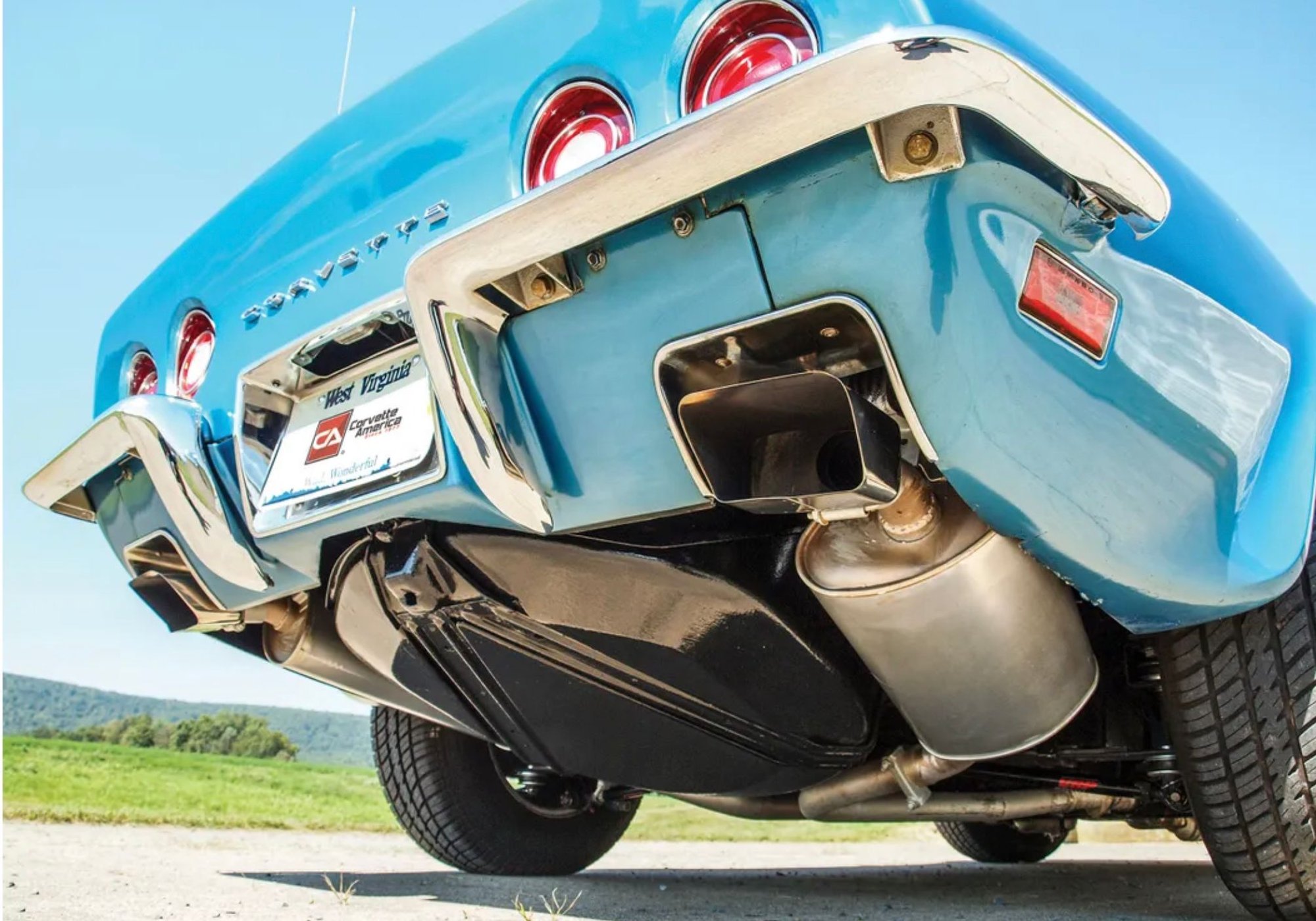

The other big thing to consider is you will be leaving gaping holes in the rear valance and 1/4 panel when you remove the mufflers. You have 3 choices: 1. Leave them alone (horrible looking) 2. Use a “filler panel” thats designed to plug the hole and clean things up… this is better than not doing anything and probably best as you are going to have a very modified look with the Hookers anyway, so you wont be trying for a stock look. Its also very reversible.
The 3rd option isnt even an option now that I think of it. Adding GM pipes to a ‘69 causes people to do the filler bodywork on the 1/4, and add a sidepipe original valance to the back for a stock look. You dont have that option for a ‘73 as there was not stock rear valance other then the one with the exhaust cutouts.

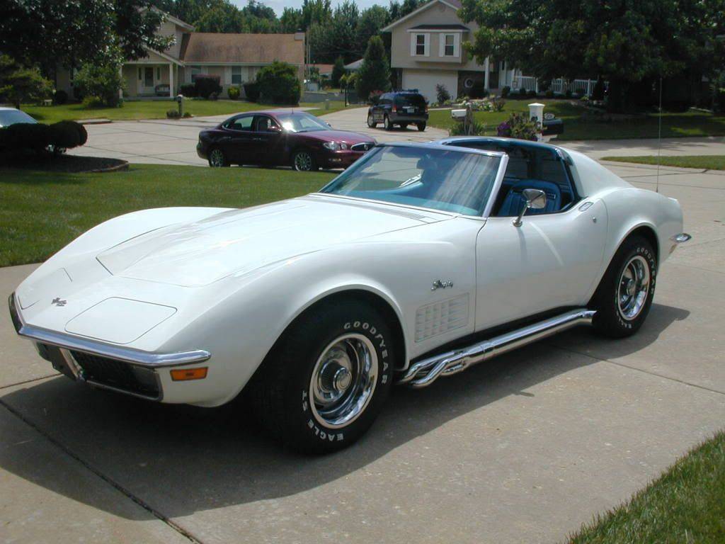

So, look for a filler panel. This is the area Im talking about:

Heres a picture of the filler panel part you would need:
