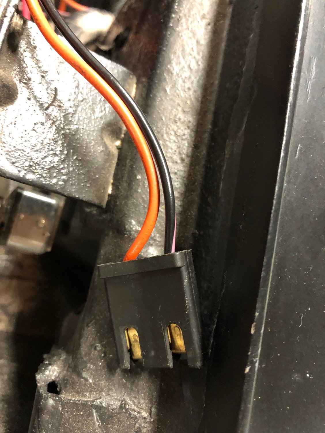

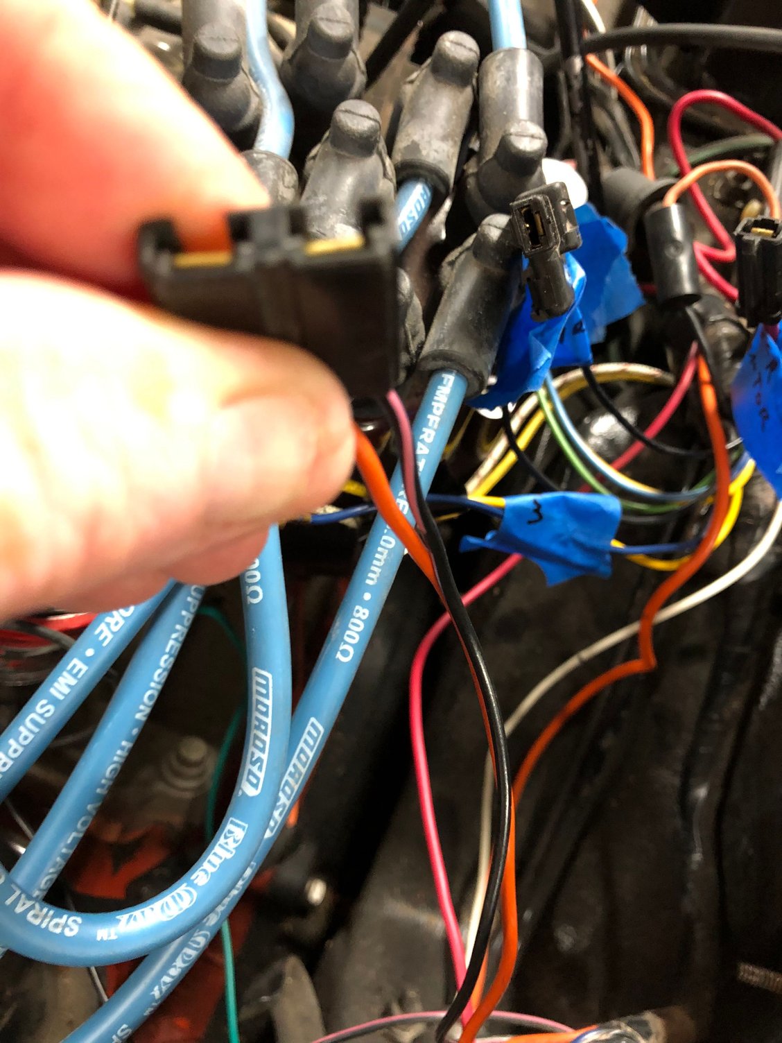

i am building a 71 big block vette and redid the wiring harnesses with electric limited harnesses all new i have wiring diagrams also but i have a 2 prong black flat plug located in front of the wiper motor that has a orange wire on one side and a black with a purple stripe on the other could anyone tell me where these wirers go? this wire is the only wire i cant find on the schematics any help would be great thanks all

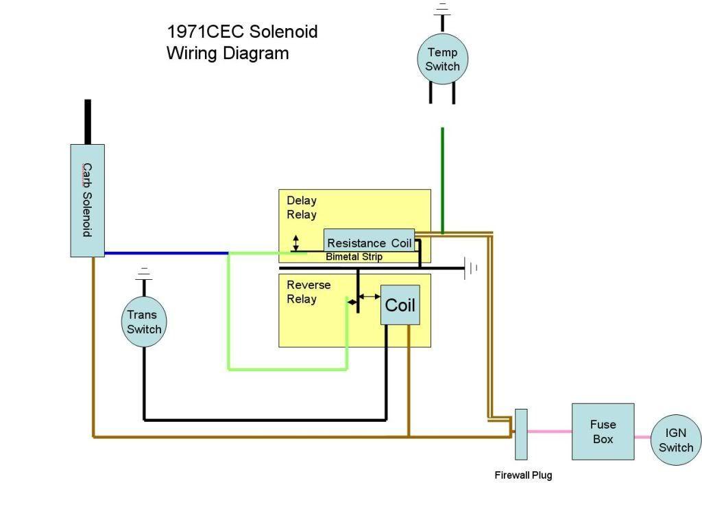

On my 71 small block, the only thing I see in that area is for the CEC solenoid......

Can you post a photo of the plug/wires?

Since it does not show up on wiring prints. I would contact Lectric Limited and ask what it connects to as they made the harness and should know.

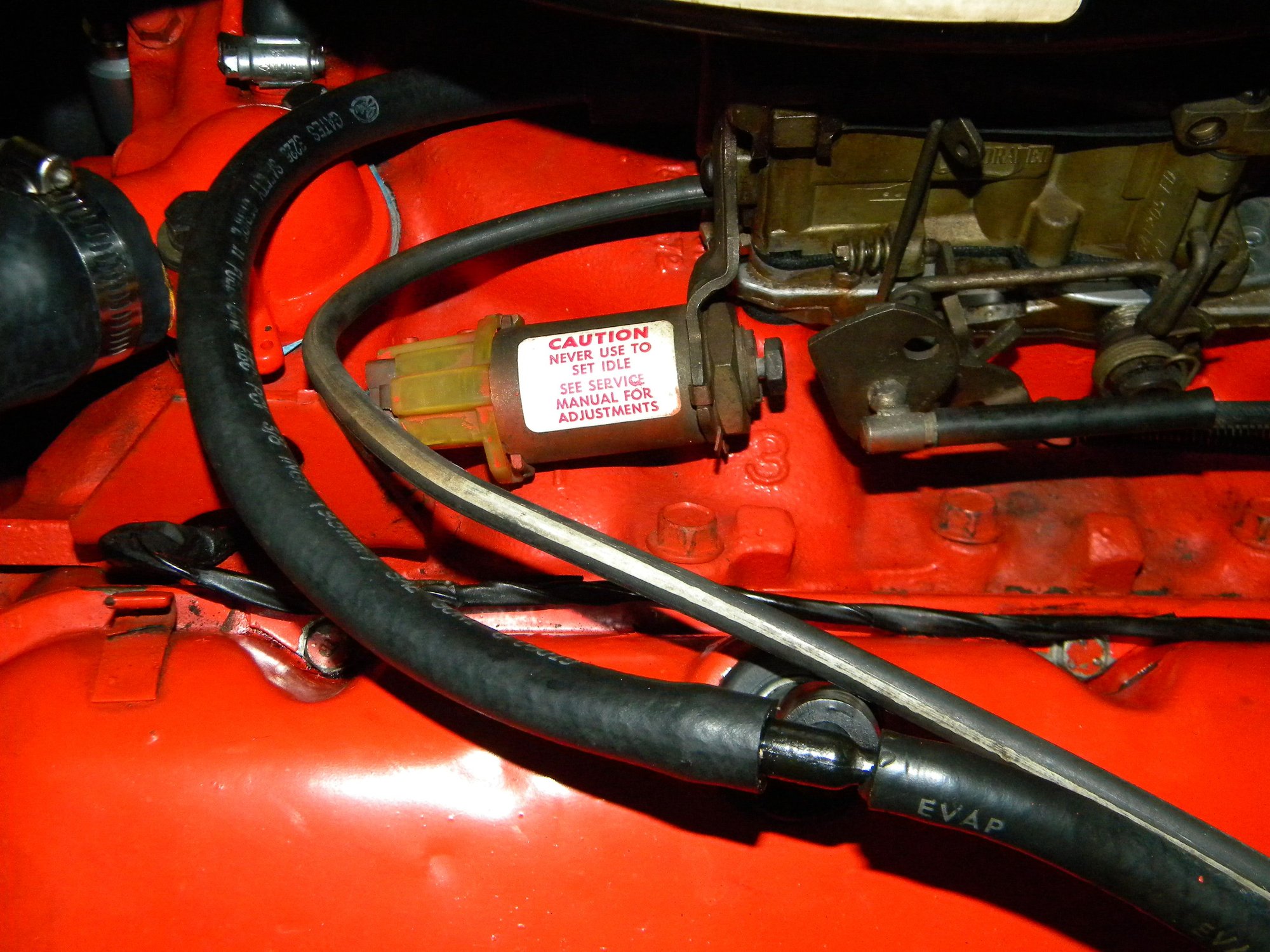

I should have also asked if the plug would reach to the front of the carburetor.
Unless you have already connected a 2 wire plug to the CEC Solenoid, the only thing I can think of is the CEC Solenoid on the front of the carburetor, which is a 1971 model year only.
Does your engine have the original Quadrajet carburetor?
From Alan 71:
Mine came with black tape around the 2 wires and it goes into the 2 top clips on the valve cover to the front of the carburetor.
My original plug is black and the orange wire looks beige after 50 years.

Looks sorta like the one that goes to TSC solenoid

i agree i think its for the tsc solenoid which i dont have anymore i replaced it with a holley but i want to thank all for the help much appreciated
