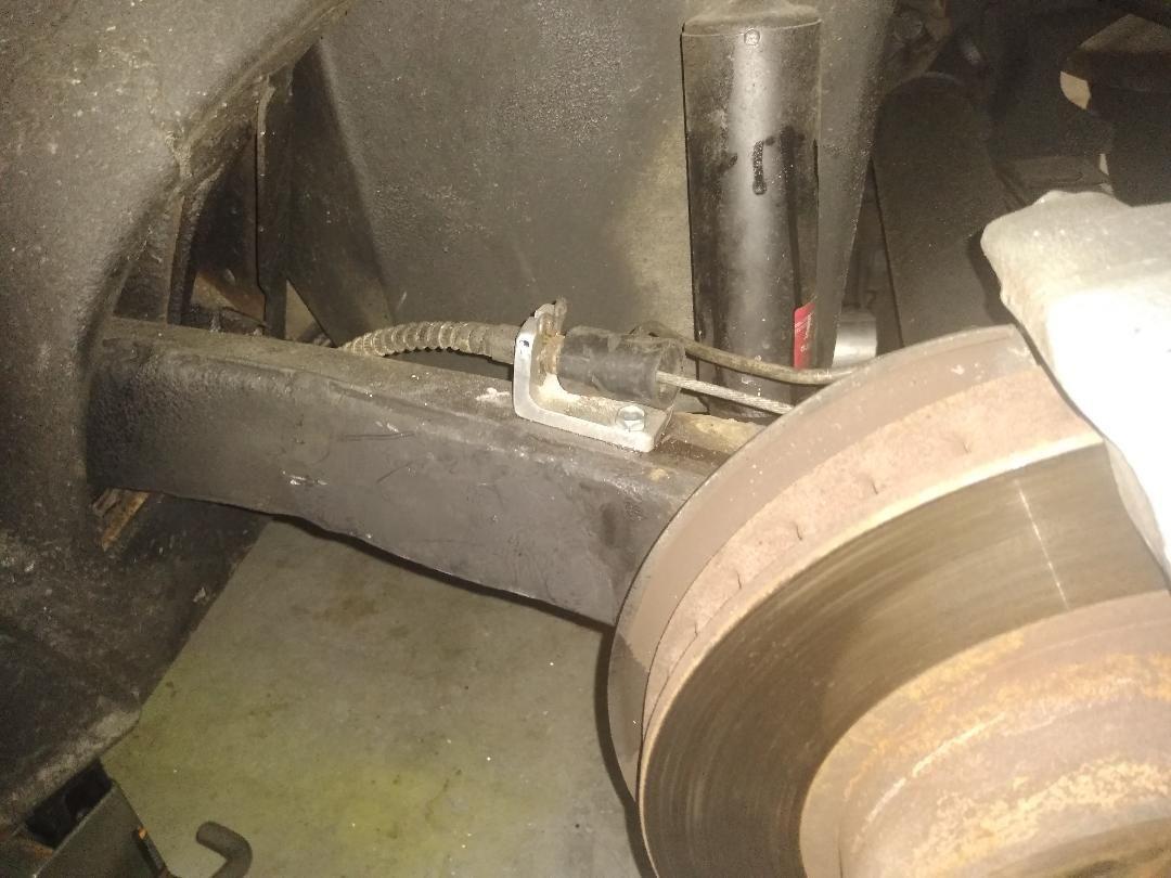

I recently put 18 X 9 wheels on my '71 with Michelin 255/45 -18's front and back.
To do this, you'll have to relocate the parking brake cable bracket. Cut off the bracket and and weld it on the top of the trailing arm. Or... not having access to a welder, I made an "L" shaped bracket and fastened it to the trailing arm with two tapped holes. You can't see it in the picture, but I slotted the bracket to receive the cable after mounting.
