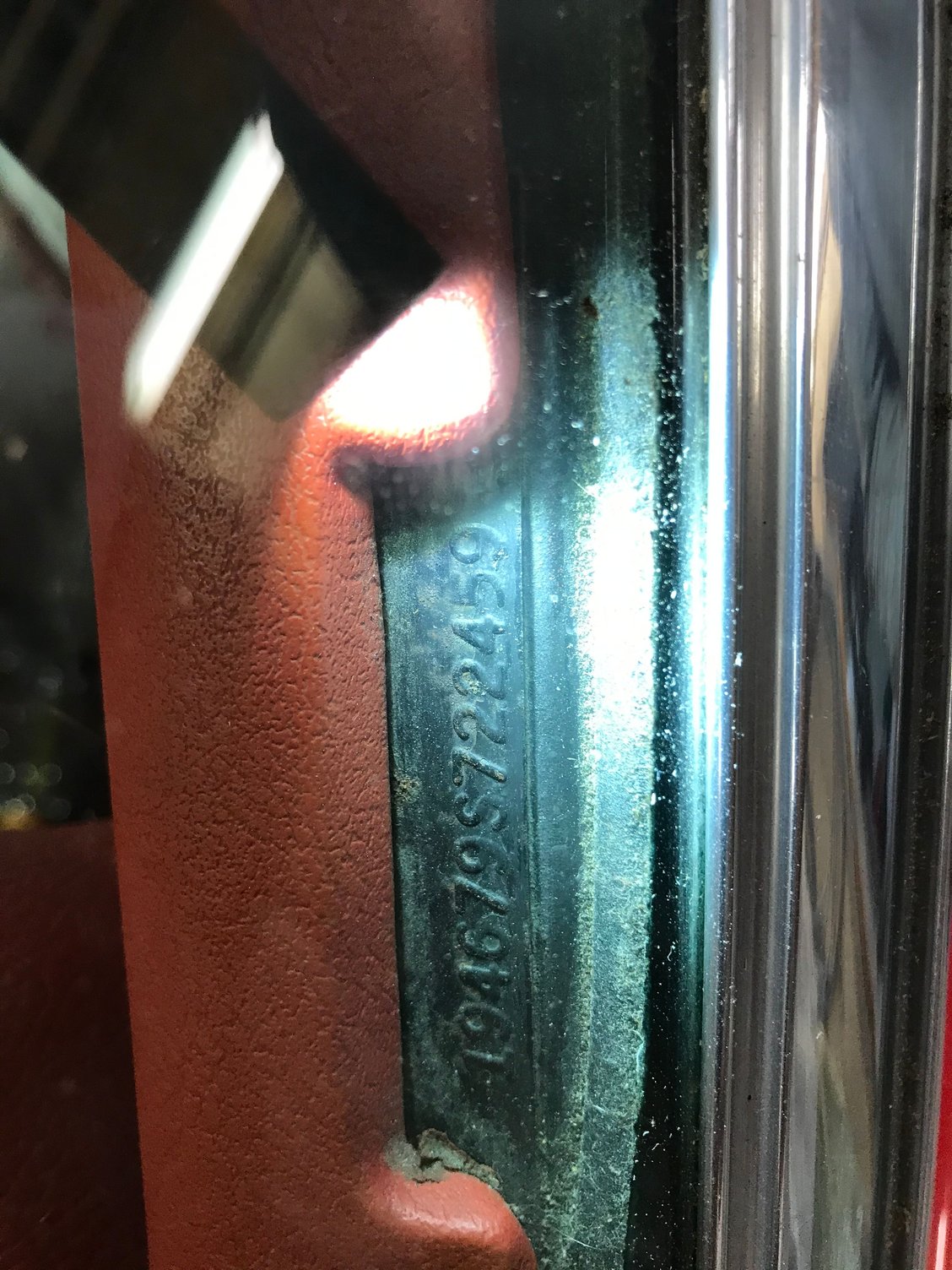

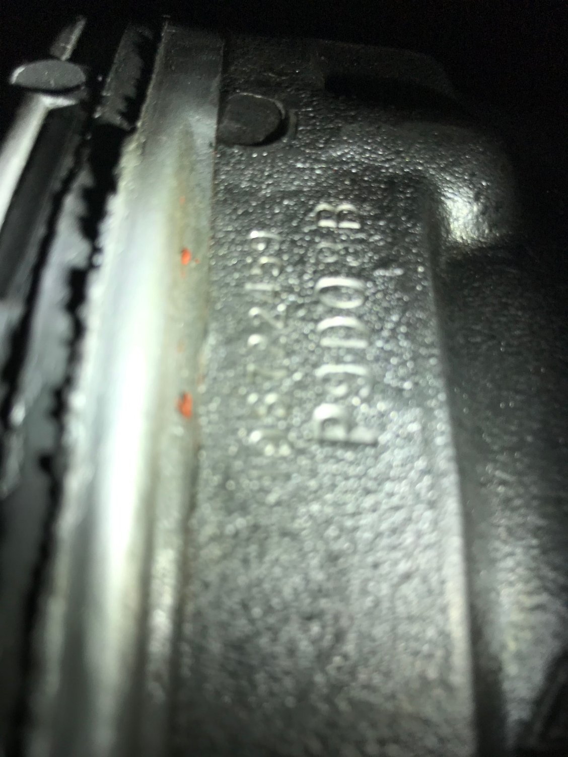

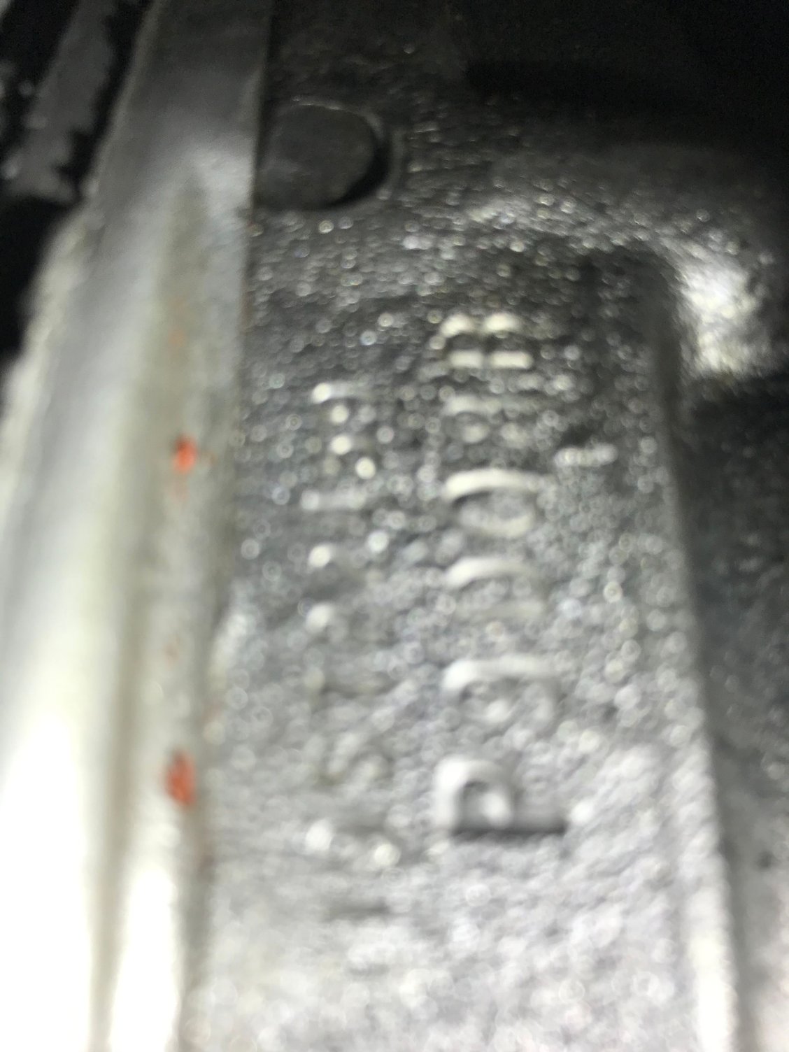

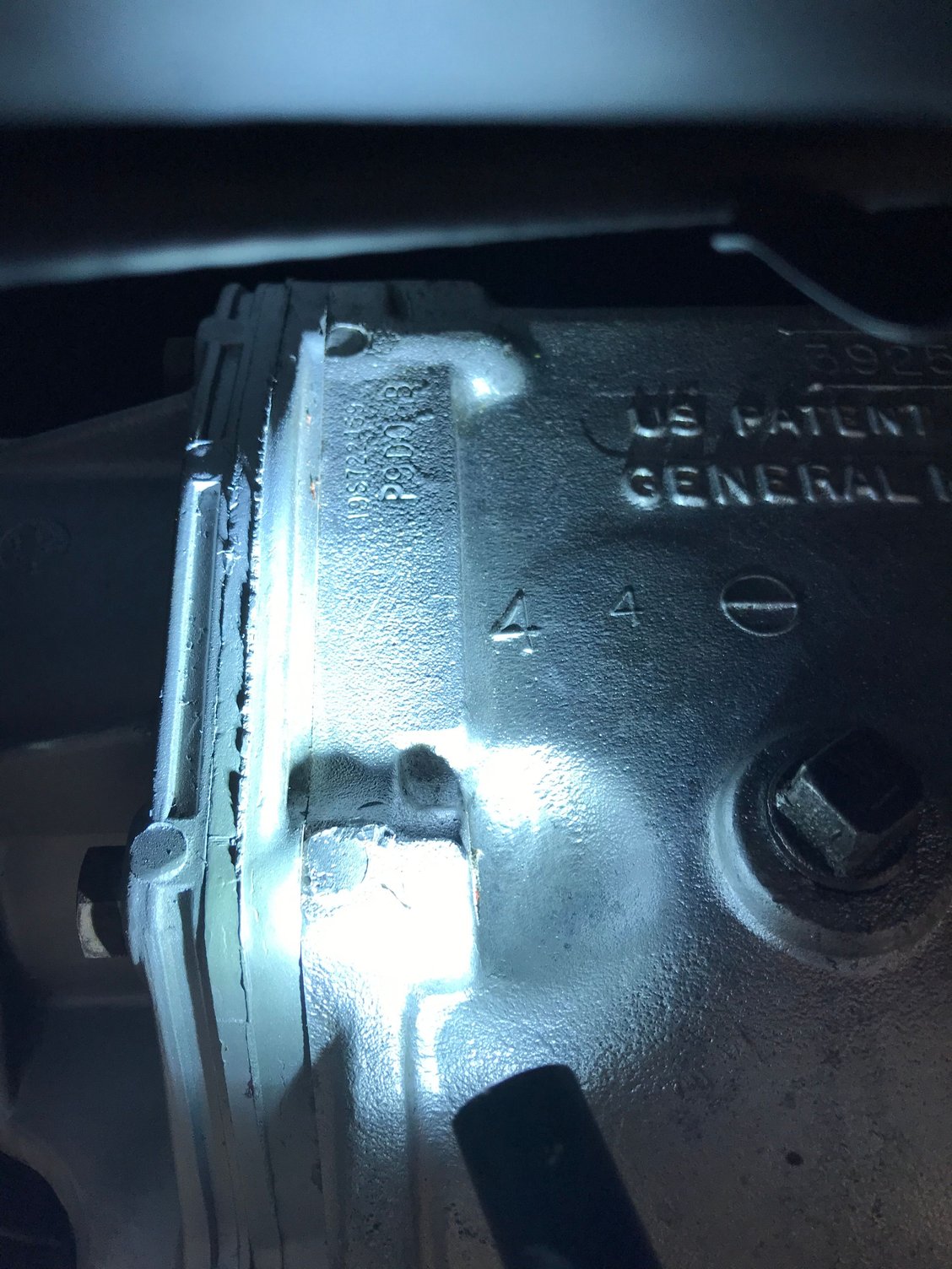

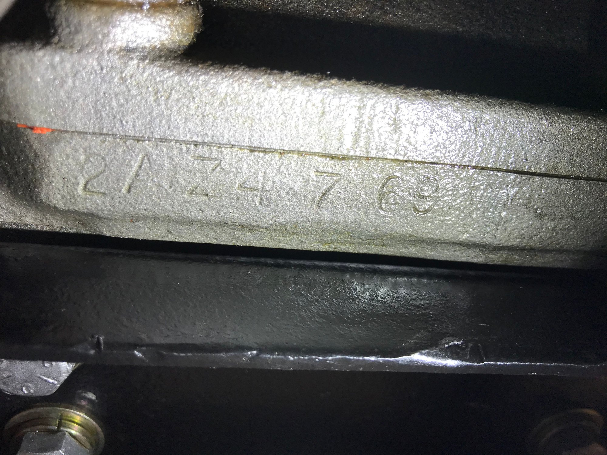

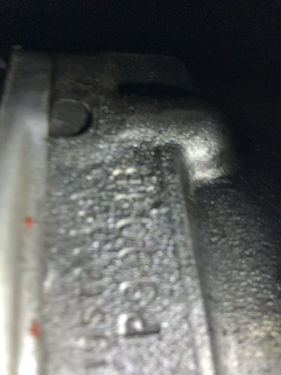

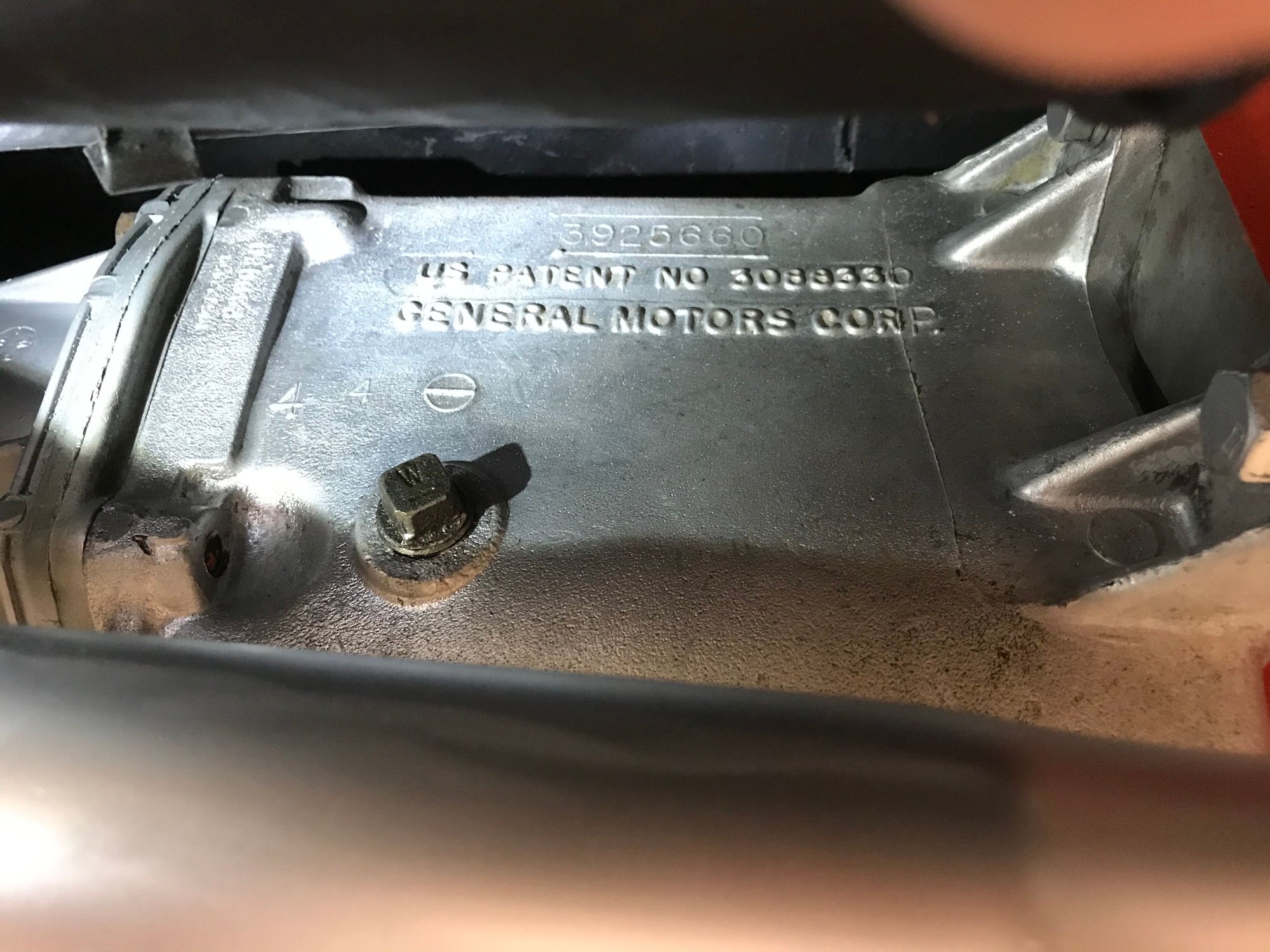

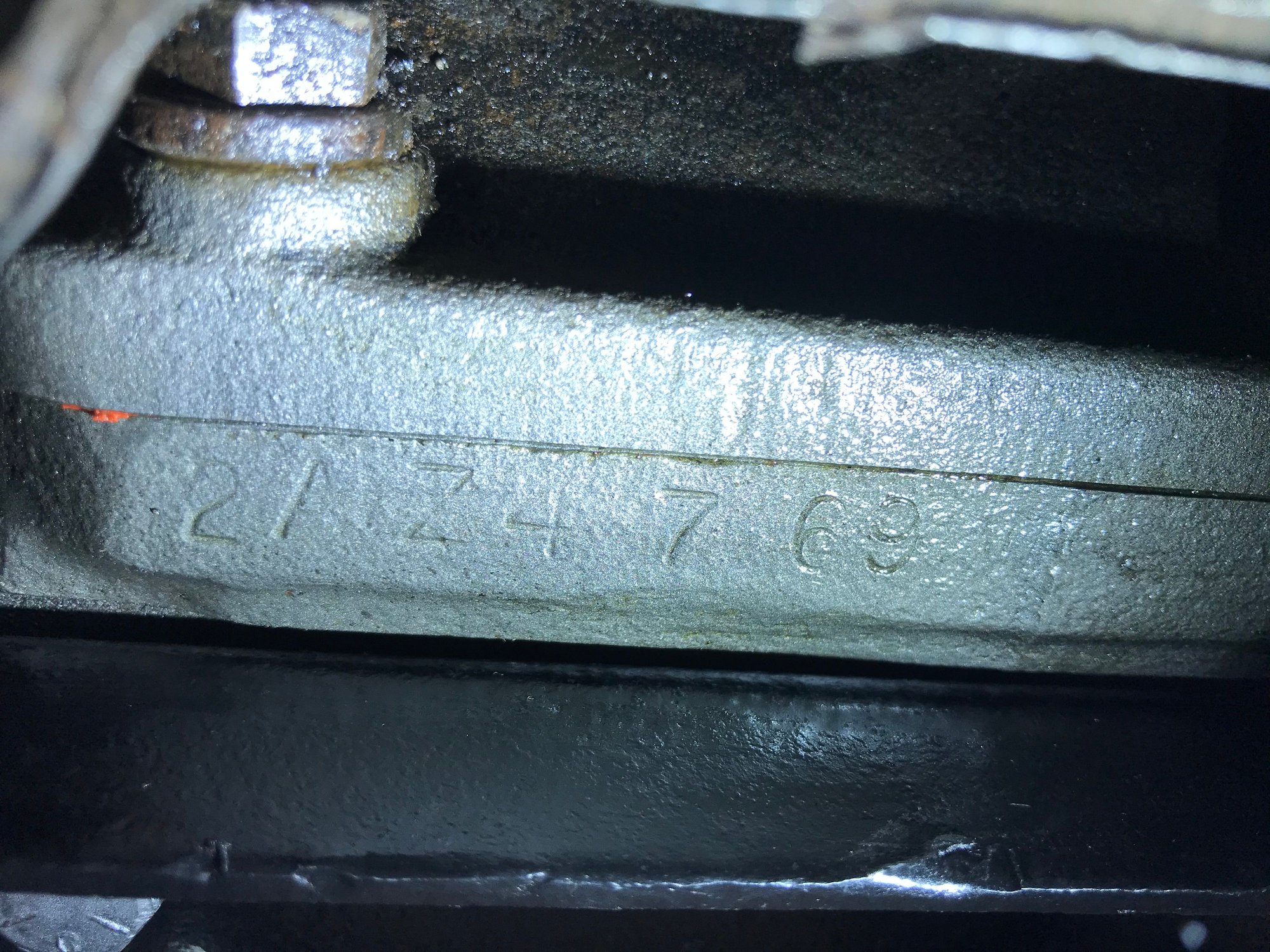

Here are the engine, tranny and rearend pics and their numbers. VIN also. Some duplicates due to the difficulty in getting access. From these I believe the engine stamp and VIN match, the tranny is a Muncie 4 spd but not an M21 and the rearend is the HD 355 as listed in the tank sticker. Block casting number is 3963512. I'd appreciate any input, thanks

The trans has the code for the M21 close ration. The letter B on the end means M21.
The engine stamp is hard to read and since it is painted you can’t see the broach marks. It should be unpainted. It’s probably original, but I like seeing the bare metal. I hope it wasn’t partially decked where they smoothed over the broach cuts. Everything else looks real good. I like this car.

Thanks for the input! I need an explanation of broach marks. Would not the 2459 stamping and also the same on the last 4 of the VIN satisfy the originality question unless it was restamped?

Broach mark's are lines on the block made by the cutting tool.
That is correct. But, if it was restamped, they would have to remove the original broach marks along with removing the original stamping that didn’t match. Of course you could replicate the broach marks as well. Chances are it’s probably good. But if the deck was lightly shaved from a rebuild I would just want to see it. You can’t see it with paint. Some guys might try to cover a bad restamp with paint so it’s always best to see the engine with no paint on the pad. The pic above is a nice example of an original pad.
ALSO!! If you do buy the car and want to remove the paint on the pad, DO NOT SAND OFF THE PAINT!!! Or use anything abrasive like a wire wheel. Use lacquer thinner or some gentle form of chemical paint remover. Then lightly wipe it with a soft cloth. Preserve what is under the paint.

i can see 2?459 and the ? is 2 or 7 odds are legit. fake stamps are usually quite clear.

Was going to check on progress within the next few days and I'll try and see the stamp bare. The number in question is a 2 matching the VIN's 2459. As a side note and am curious, a previous post shows what I would describe a clear stamping that is said to be original. Fake stamps clearer than that? Thanks for the input.
