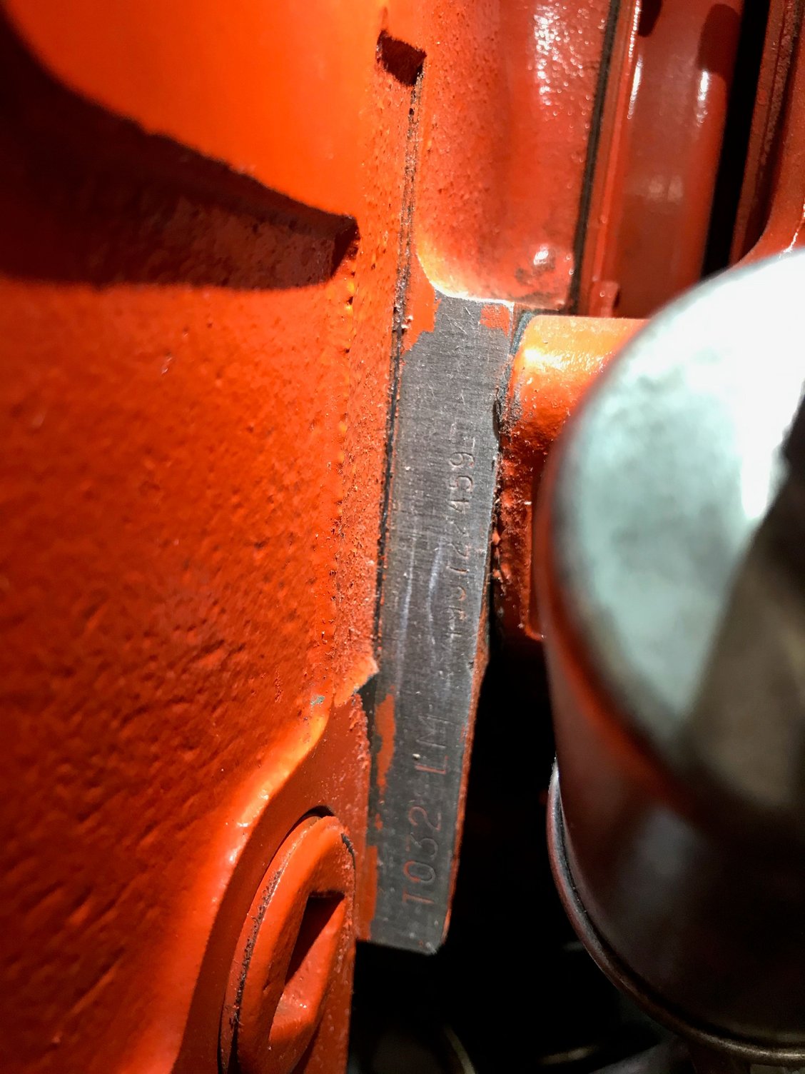

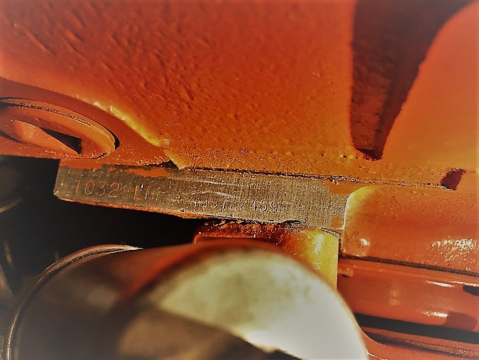

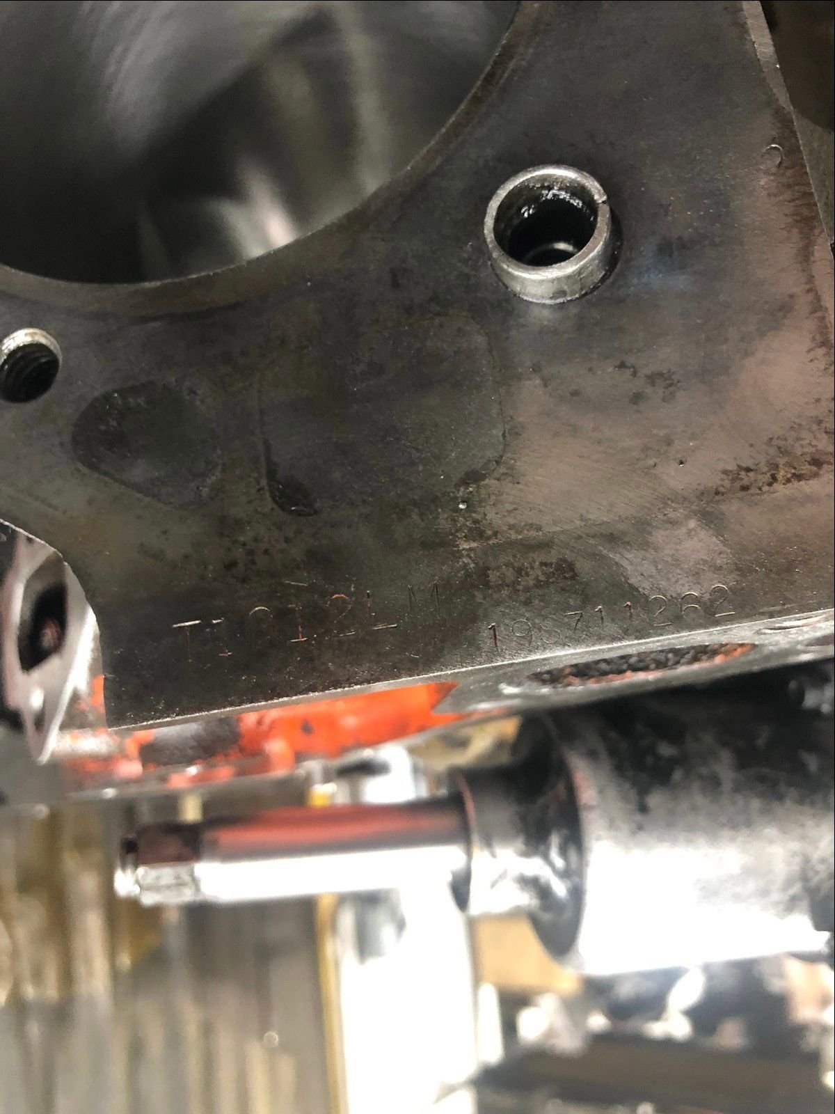

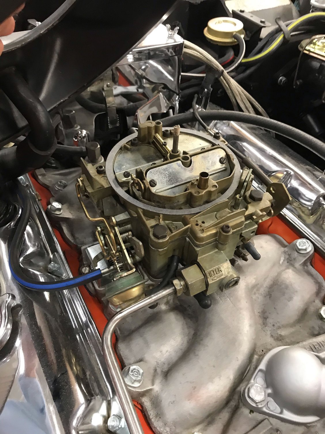

Here are pics of the stamp and carb

IMHO the trim tag is typical factory production. As for the engine stamp, the picture is hard to read all the vin derivative numbers. If you put a dab of motor oil on a rag and wipe the front engine pad it will help with the glare from the camera.

The pad stamp looks good. The 4 is very correct, that’s usually another number they don’t stamp correctly. That’s a nice pad. Nice broach marks. If it was intentionally faked they would have NEVER painted over it as they would have wanted you to see the nice broach marks.
The carb isn’t original but honestly that’s fine because very few cars out there have an original. Unless you want to get the car judged it’s not a big deal. The carb is a correct one but I can tell it’s not a 7029215.

I agree with Ed, the engine stamping is typical factory production. If you enhance the pic you can see the numbers better as well as the consistency in the broach marks. Like mentioned before, red/red big block convertible with the original trim tag, motor and a 4 speed is a highly desirable car.
