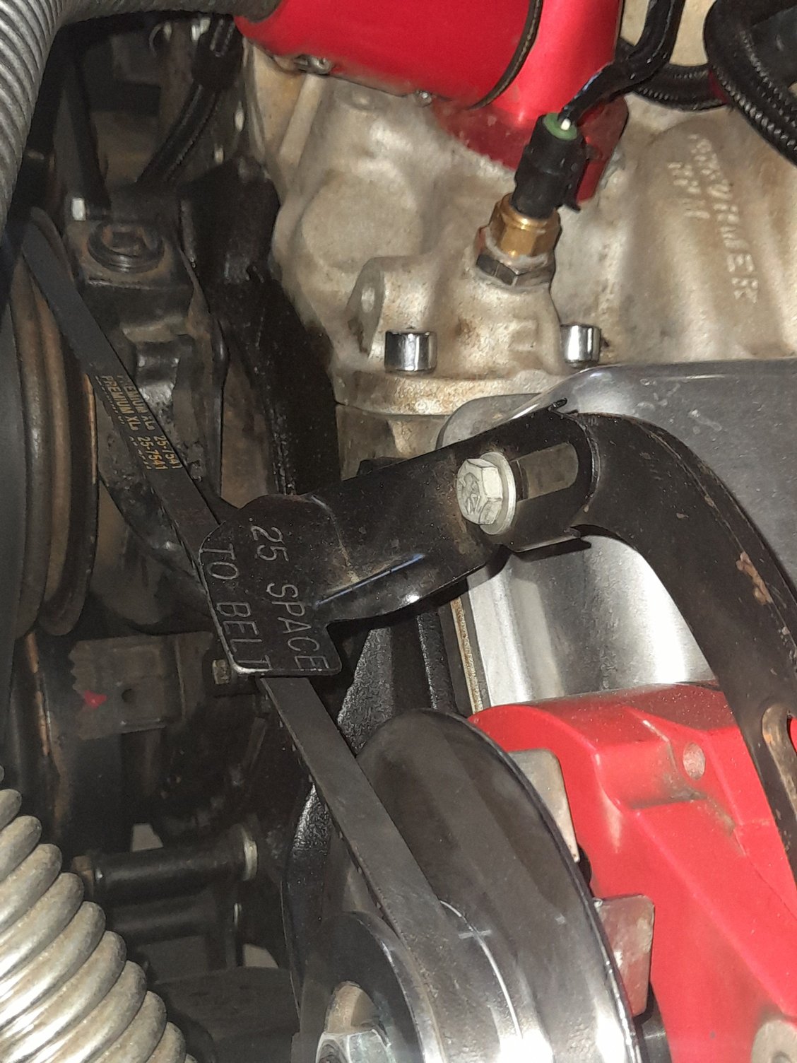

Whenever the alternator was replaced on my '81, this bracket was not refitted correctly.
What is its purpose, what does the text refer to and what is the correct orientation of fitment as I can't make it fit in a way that looks and feels like it is serving a purpose.

The bracket attaches to the alternator bracket. I do not know what it is for.

Thanks - I'll have another crack at fitting it, but from what I remember, in that position it hit the belt, but I'll double check.

Belt guard..should be 1/4 inch away…

It's there to prevent belt "whip". If a whip develops between two pulleys (more likely at higher rpm) it can make the belt jump off the smaller pulley. In this case the alternator pulley. When adjusted down to 1/4" from the belt it stops the whip.

Ah, worked out what the problem is, I can't fit the bracket without it touching the belt, even on the end of it's travel - I need to rotate the alternator away from the engine and therefore down a touch to create any clearance, but I guess that's limited by the length of the alternator belt? I.e the only adjustment is the curved slot on the mounting bracket?

perhaps you have the wrong belt. As you can see by photos supplied by myself and others. should work fine.
I was suspecting that.
What is the prescribed belt length for a '81 and does this also drive the smog pump?
Looks like I need to remove all the other belts to get to it - might be one for later down the line and the belt is pretty new.

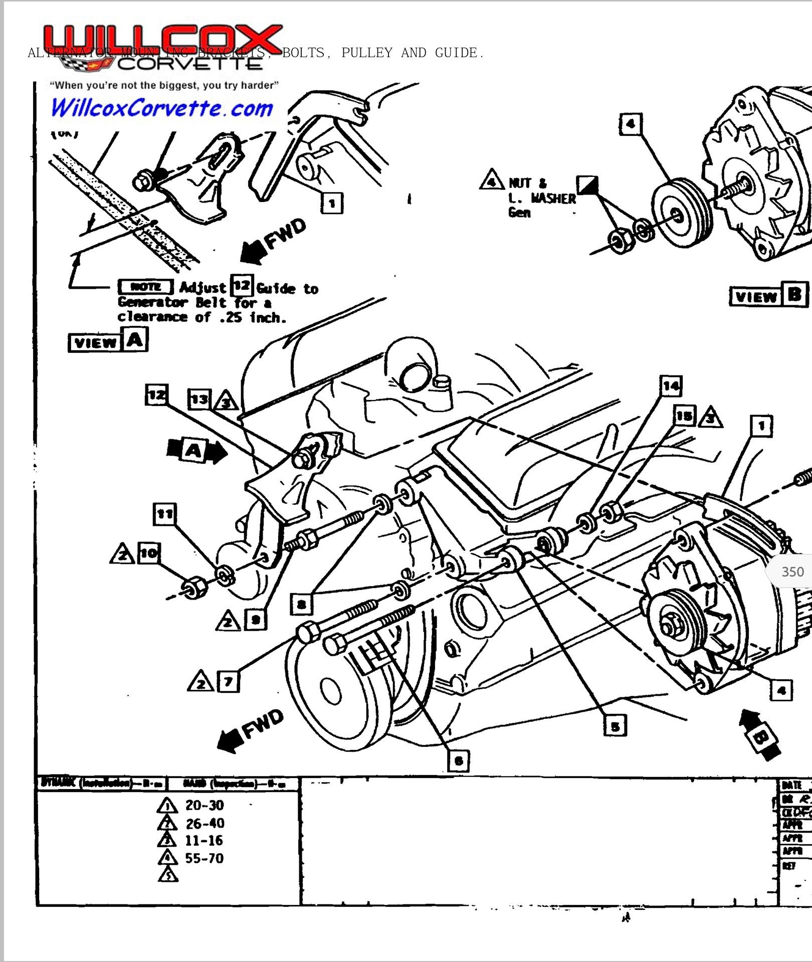

1953-1982 parts and illustrations guide c3 corvette lonk - CorvetteForum - Chevrolet Corvette Forum Discussion
page 137
To What does this bracket do and how does it fit?
