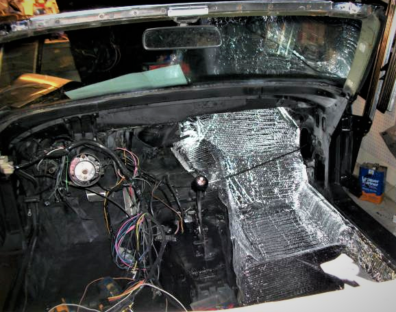

Be sure to take pictures of each old harness before you remove it....you must put the new dash harness in the same way the original harness was installed or else it will take hours to put all the dash components back into place because space is very limited. Below is a pic of what happens IF you do not take "Before Removal pics".......
wise man learns from the mistakes of others. good dude posts his mistakes so others don't have to make them too...
Do you have a bigger picture?
