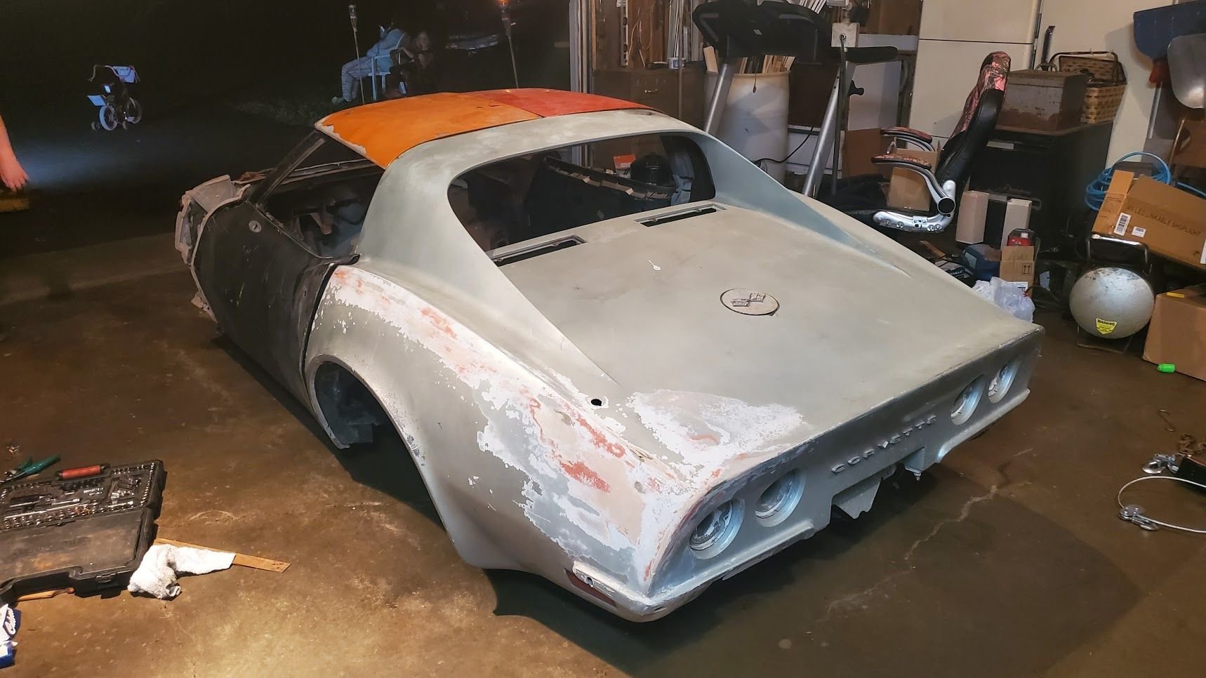

I've always wanted a Corvette, but haven't been able to convince the wife that financing a car that was only usably 4ish months of the year has not worked yet. Thankfully I just found one that does not require financing, and I never wanted a restored garage queen. So this husk should allow me to do with it as I please without much guilt. Supposedly it is a 69, and the VIN seems to confirm that. But with how much there is of the car I am not sure it's possible to confirm this VIN matches the remains of what I have (VIN: 194379S717198).
I was was told this shell came from some famous drag racer out in PA 20 - 30 years ago. I can't remember what the heck they said the guys name was, I think the last name started with an S. And they just had it since then with plans to make it into a drag car, but finally just had to let it go.
It looks like something was dropped on or hit the top corner of the pass side windshield frame and the A-pillar was buckled at the pinch weld right at the dash level. I spent a good portion of the day today with heat and some pulling and got it in a far better spot. The bird cage is in a lot better shape than I have seen on running and driving cars. It is far from mint, but should be more than savable, so I will be working more on straightening out the windshield frame and T-top bar. But for now, it is much better, also hung the doors on just so it felt like a bit more of a car. I thankfully did get all of the front and back bumpers with it too. But that's pretty much it plus what's in the pictures.
Now to pick a direction for the frame. I already have an LQ4 and 4L80E. I see frames with suspension and rear axle for 3-5k. I don't really want to go with a stock frame, but with that I could theoretically have it up and running next summer as a sort of rat rod. I would never want to keep it that way, eventually most likely a Dynamic Corvette's setup. But spreading the money out over time, I wouldn't mind doing the rat rod thing for a year or two. But we will see, with the minimal amount I have this seems like a blank canvas.

I hope you have the necessary skills to address the birdcage problems. Also, the rear of the car is not a 69, unless flares were added. The 68 and 69 did not have them. I would hate to see you put time and money into a car you may not be able to register. Good luck. Jerry
The clip is from a 1970-'73 Corvette. Like Jerry said, it is possible to add the flares but I don't think anyone would bother to do that and also change the '68-'69 style side marker lamps to the later style '70-'74 lamps.
But who cares? If you have a VIN tag affixed to the A pillar, nobody in the world is ever going to check up on this.

Although it does seem like both sides were replaced. The side pictured you can see the top of the quarter is stripped and there are huge glue type runs down the back inside of that. The pass side has a crack that goes right with the same angle of the curve. So to me it looks like they had been replaced. It seems like most replace them below the body line, and that's right where that crack is and you can see a huge seem past that crack. But I am new to the C3 game, so here's a few pictures showing these things, let me know people's opinions.

that glue strip is on every c3 front and rear fender. that is where it is assembled. the pic with the kid and dog? we currently have a vettes n dogs thread that absolutely belongs in. bird cage condition. decide if it is worth doing this much to. at least you don't have to pull the nose to get to it. best way to make a start on this guy is to find at least one parts hulk.
I think the OP is commenting on the resin drips/runs on the inside of the fender at that body seam. As far as I've seen, the factory did a much cleaner job than this affixing that panel. I'd agree that the panels were replaced at some point due to that. I'm thinking the car was in a pretty bad accident and wonder if it got upside down in order to bend the windshield frame – the t-tops are likely replacements to the original pair on that body.
