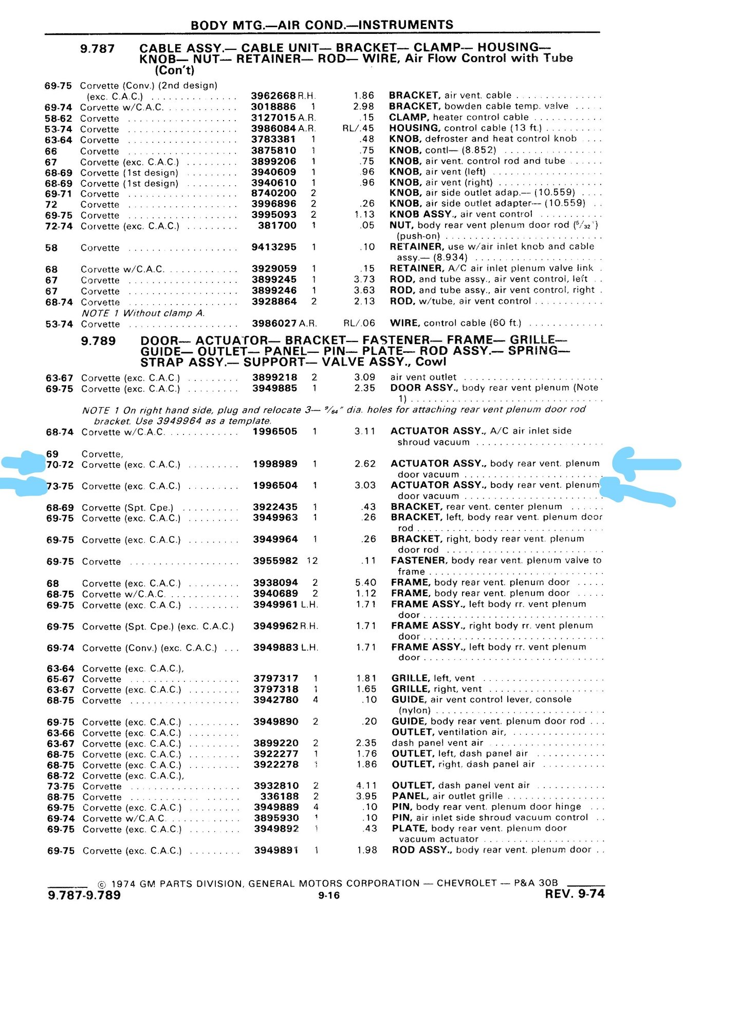

Interesting thread. Thanks, Pegan, for posting. Does anyone know if the Astroventilation vacuum canister is being reproduced? I’ve never seen one offered but wasn’t looking very hard either. This part and the thought of replacing the steel tubing from the control valve in the console all the way back to the rear bulkhead seems like a very tedious project with little benefit unless doing it for originality/judging purposes.

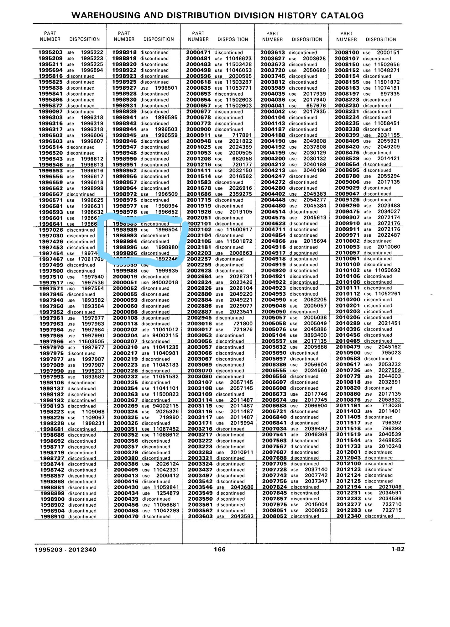

Here is the original part number to help with your search 1998989 then part change to 1996504 in or about 1982. No known reproductions made.
