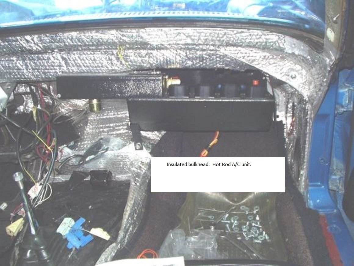

I sealed mine off on my 68 when I installed a/c. Worthless hot air is all that ever came in. The upper ducts from the wiper trough I can be glassed over, or you can get a round plastic/fiberglass/pvc cover and glue it in. I got some with my a/c kit and I actually remove the protrusion on the passenger side and glassed it in because I didn't need it in the way of the a/c work I was doing. For the lower doors I just closed them and sealed them with RTV. No more hot air. I also insulated the whole bulkhead with that aluminized bubble stuff from the hardware store. Seems to work quite well.
What about outside air for the A/C, or is it just recirculating air?

Just recircs the air inside. Not that it matters much since I usually use it with the top down and blowing cold air on me. If I put the top up it cools the little cabin quite well even with that uninsulated fabric top.
